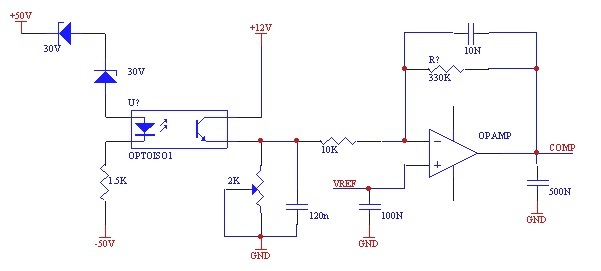

Hello all.
Ghemink, you seem to have gained a lot of experience with your modification to the A&T labs supply.
I have just put my DIY SMPS to work. It is a half-bridge, with ETD44 transformer, intended for +/-60V at 600-800W.
By the moment I have only tested at up to 450W for several seconds and seem to run quite cool. Let's see when I leave it that way for hours!
I also use a SG3525 control IC, and my feedback is implemented as in the attached schematics. My concern is what happens with light loads. I don't know if the compensation is ok as it is now, but it produces a strange ripple (and even some noise) when output current is below, say, 100w.
What can I do to improve no-load (or very light load) behaviour while preserving fast enough transient response?
Thanks!

I don't think I can help you here. The feedback loop of the A&T labs supply is completely different. I remember however that with very light or no load, that supply also behaved a bit strange. However, a load of 100-200mA of a few amps connected is already enough to make it behave OK. So I have no issue.
Maybe others have some tips?

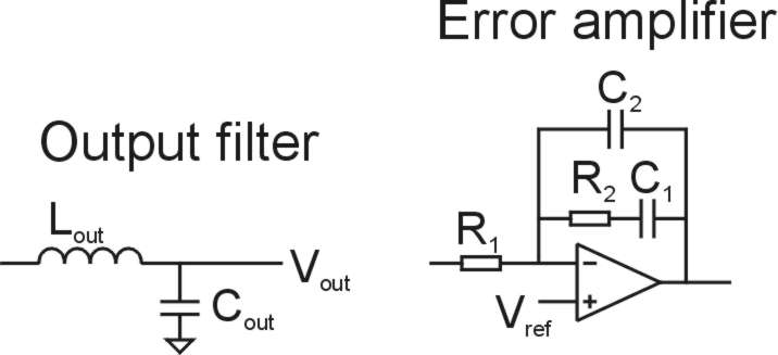

Hi Pierre,
With extra caps, the SMPS became unstable under some conditions. The reason is that the compensation network in the feedback network (error amplifier) is designed for a certain output filter. The output filter in the SMPS should consist of an LC network (see attached figure). The error amplifier in the feedback loop may look like the one in my attachment. If that is the case, then if you increase Cout by adding caps, you have to increase C1 of the error amplifier circuit. If you increase the Cout value with a factor x, than C1 should be increased by a factor sqrt(x) to be sure that things stay stable. This would be a conservative and safe approach.
However, one can get more out of it. when Cout is increased, the Q factor of the LC output filter becomes lower, this allows us to increase the gain of the error amp by increasing R2. Of course, if that is overdone, the SMPS becomes unstable again. Adding caps and increasing the gain is very beneficial as it would reduce the output ripple of the SMPS strongly. I tried all this in my SMPS and it works great.
Good luck
Gertjan

Hi Sovadk,
Thanks for the remarks.
Yes, I know it is a PI network, the SMPS came default with that network and I modified it increasing the cap and also increasing the gain. I know the theory (at least some of it) of PID but in case of a lot of additional caps in the LC filter, the Q-factor of the LC filter becomes very low so that it starts to approximate a 6dB drop off instead of 12dB with a higher Q-factor. With a high Q-factor output filter, PID is probably the best solution to get a good phase margin, but for a low Q roll-off it does not work well. I actually tried a PID configuration but quickly dropped it after I realized that the Q-factor of my modified LC filter is too low for a PID configuration, it can become unstable (it actually did). If you make the 2nd cap smaller, the phase margin with PID can be improved, but then the gain at high frequencies becomes very high and I did not like that as the whole thing may become more sensitive to noise.
On top of that, the extra caps that I hooked up at the output of the SMPS are connected in a T configuration with R-C-R and R=0.1Ohm and a couple of those RCRs in parallel. This lowers the Q-factor of the LC filter even more so that I get a very smooth 6dB roll-off and get very stable operation with the PI network while I can increase the gain as well. For a supply for audio use, I like to have smooth behavior and this works great.

It's right that you can change the Q factor of the open loop by increesing the output capasitors (Q=sqrt(L/C)/R), but then roll off freauency change too, which you have to conpensate for. f0_LC=1/(2*Pi*sqrt(L*C)) has to follow the poles of the feedback network where f0_RC=1/(2*Pi*R*C). Therefore sqrt(L*C)=constant*R*C should be fulfil (the LHS is LC filter values and the RHS is feedback network values). As stated earlier, if you only choose to change capasitor values sqrt(C)=constant*C.
If you tune your pid control, you can make the closed loop slope a 1 order (including the LC filter) with a Q factor of 0.7. This will be independent of the Q factor of the output filter.
A LC filter will always have a phase shift of -180 degrees and will cause instalillity of osccilation if the gain in a closed loop is close to unity at this -180 degree freqyency. If the Q factor is large, then the -180 degree frequency will be the same as the roll off frequency of the filter. If the Q value is smaller then the phase shift will reach -180 degrees at a higher frequency. The point is that It'll will always reach -180 degrees.
A differential network will give you +90 degrees of phase shift and give you a 1order rising amplitude slope. Adding such a network after the LC filter, will reduce it to a first order (-180+90 degrees=-90), which will always be stable in a closed loop.
The SMPS here is not a special case. PID control is possible and will work much better than a PI controller. A PI controller removes steady state errors but increese instability.

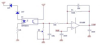

I've attached a schematic of the PID controller I'm using in my Class D design. I've got the abillity to add 20dB more feedback at 10kHz and increese stability by adding R53 and C24 to the feedback network. I've found the values by trail and error in pspice.
