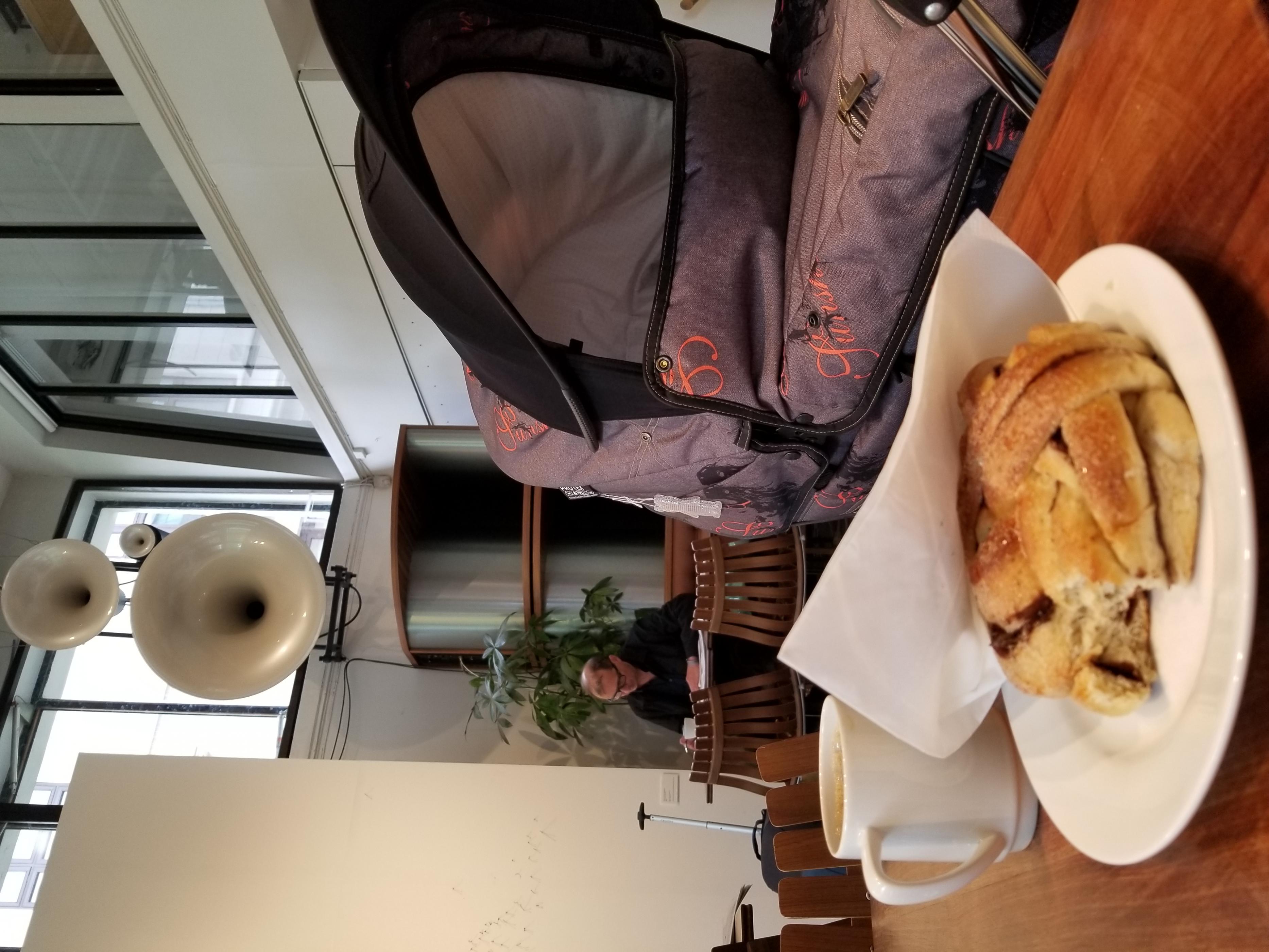

I had a listen to this system again today. BASSHORN XD - Avantgarde Acoustic Hornloudspeaker
TRIO XD - Avantgarde Acoustic Hornloudspeaker
Previously I found the basshorn a bit boomy, but today I asked them to increase the volume and it is just the lack of lower midbass from the Avantgarde Trio. The sound from the basshorn is crisper than a regular subwoofer, but not much detail is left after it has been folded several meters. So it behaves just like a regular subwoofer, with not much usable sound above 80-100Hz, just slightly more snappier och crisper, but maybe also muddled from having such a long folded horn. Someone can probably explain why, better than me.
The Trio itself is fine, I just prefer my version which can produce a full midbass without the help of a subwoofer/basshorn, crossed a little too high.
This is a cafe? where is it?
- A 4-way Horn speaker
