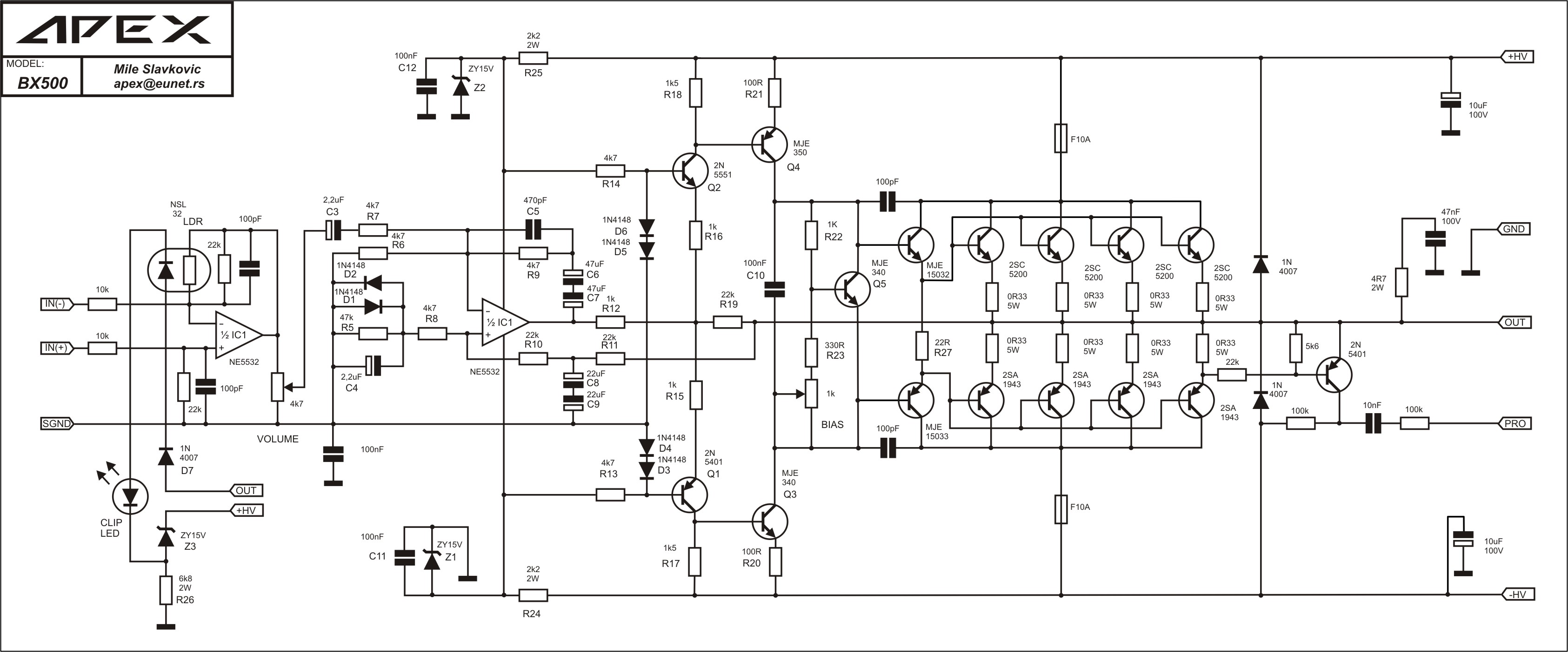

This is BX500 with balanced input, your schematic is only for bridge two amp channels.
sir mile,
can you just clear once,andrewt issue of R23 and biasing
the 4 pair h900 is pre bias with resistor,how is it this time guys are following 3 ef,nazirdigi 5 pair and how about soerdjanto,all in all please guide us in biasing 3 ef

TEF H900
Follow schematic with darlington BD681 and 10k preset for biasing, and I suggest balanced input like in BX500 with volume pot.
Regards

Hi Apex audio
greetings any particular reason for using BD681 AND balanced input
like BX500 in TEF H900 and is it safe at 70 and 120 volt dc supply rails please
what will be power in 4 ohms and 2 ohms load thinking of making it
warm regards
andrew lebon
Regards

sir mile,
If you can't set bias R23 relace with 7k5.
Regards

I not suggest to use 2 ohms with 4 pairs, on 4 ohms 1200W is maximum power.
Finally, accepting that 15k for R23 in that post does not allow the correct range of bias voltage.
My mistake, for B500 and H900 R23 is 15k, but for B500TEF and H900TEF R23 is 7k5.

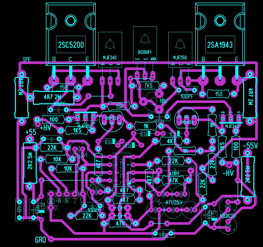

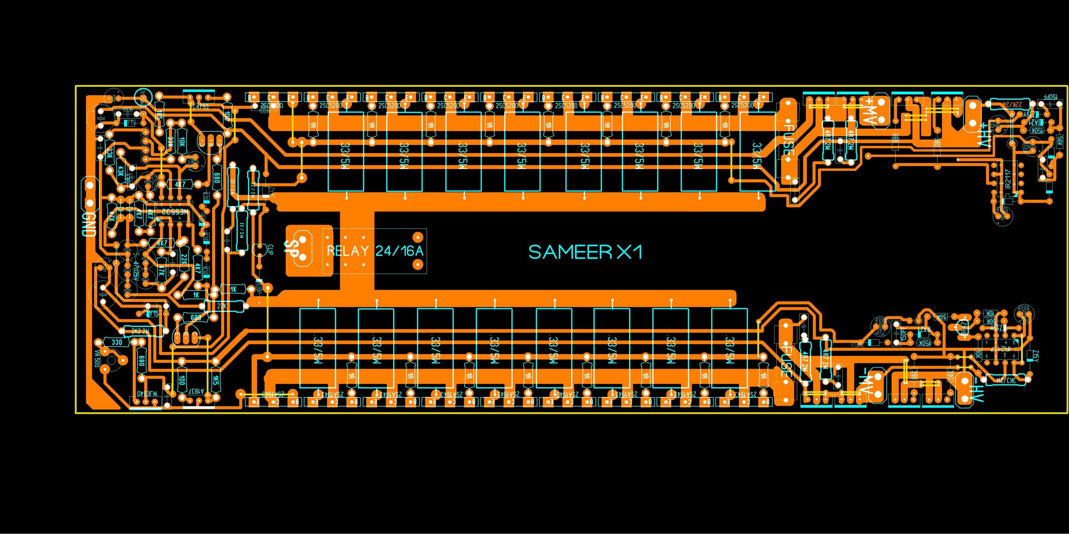

H900 TEF TRIAL DRIVER PCB
Dear Sir Apexaudio
hello i have designed TEF driver pcb as you told me
1 Q5 is now BD681 instead of mje 340
2 R22 is 15K
3 R23 is 7.5K
input is balanced following BX500 schematic is it ok now or do i have to do any more changes have 8 output pairs LV is 70 volts dc HV 120 DC are these voltages safe please
can you help me
thanking you
sameerx1

You have some mistakes on your pcb on balance input layout routing.

WWAAAHHHHHHHHHHH.....Amazing pcb,i like it 😀Hi vedmitraa
greetings sir pcb has to be checked if any faults
thanking you
sameerx1
