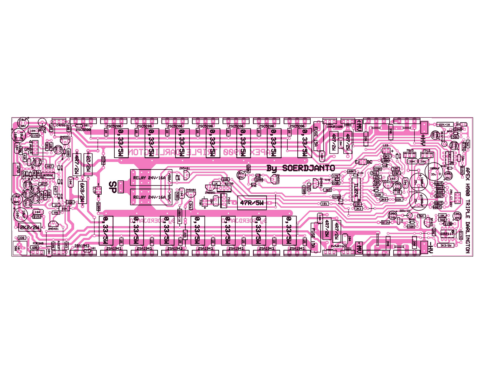

POST 1823

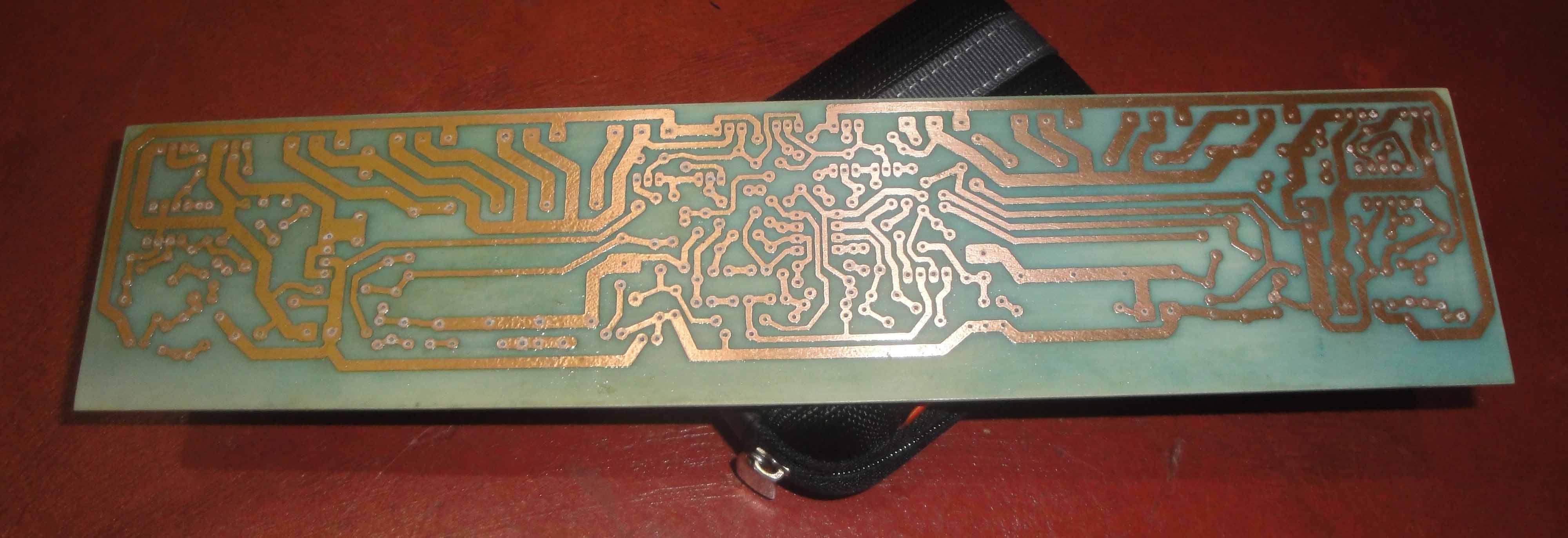

how did BD 681 COME its darlington transistor i think final pcb design be like soerdjanto TEF PCB but no protection on pcb
warm regards
andrew lebon
warm regards
andrew lebon

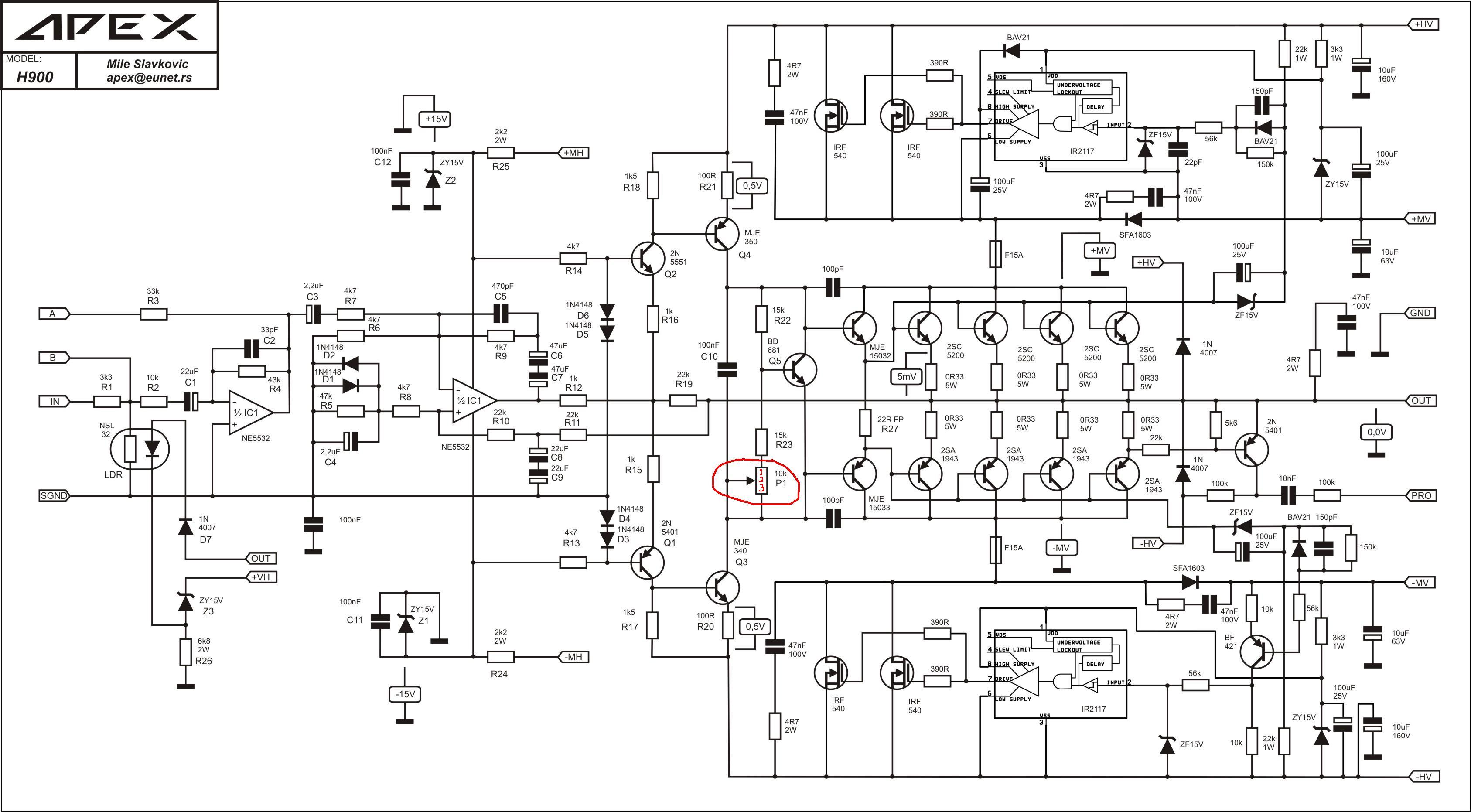

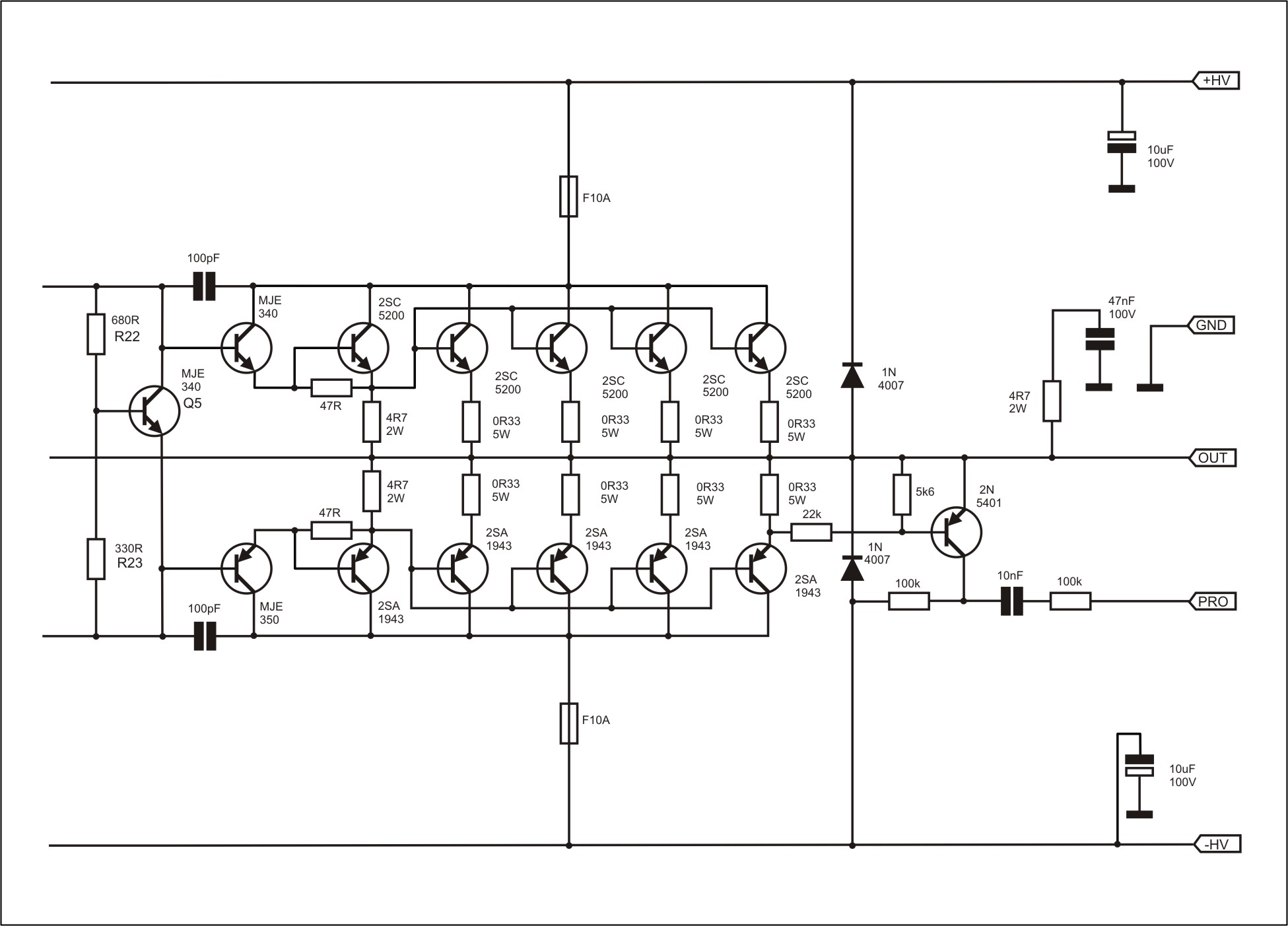

post1823
R23 must be wrong. 2k2 could be a better value.
The Vbe multiplier output voltage should be around 2400mV, when output bias is set 5mV.
post1823
R23 is OK, the Vbe multiplier output voltage with darlington should be around 3600mV max.

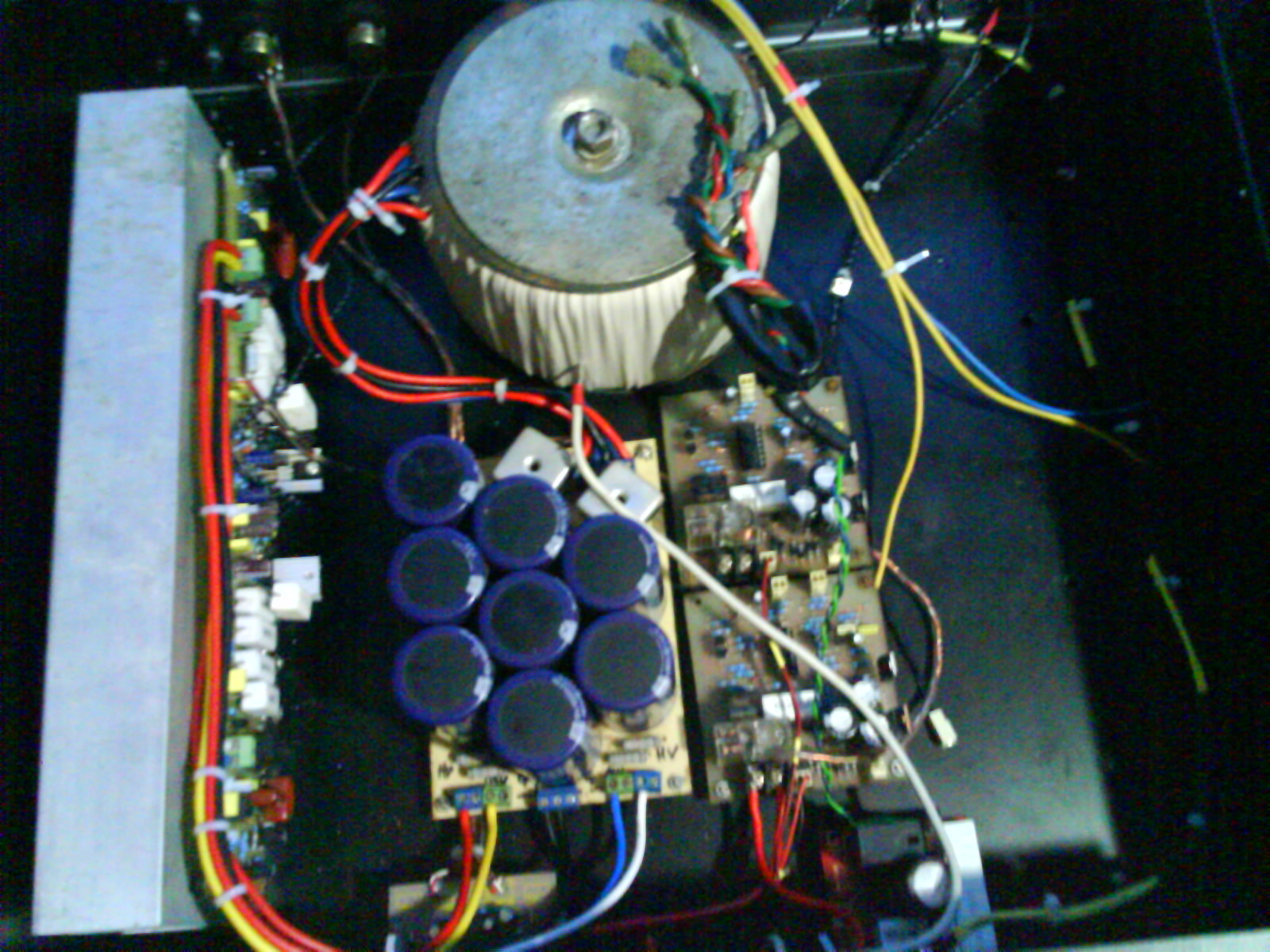

I mean ''BETTER LATE TAHN NEVER" 😀 😀 😀"BETTER THAN NEVER".........
hi yosie48f,
what this mean "BETTER THAN NEVER".
how is ur h900? mean sound and power?
I mean "BETTER LATE THAN NEVER"...my h900+tl071 is great, powerfull & sound is clear.hi yosie48f,

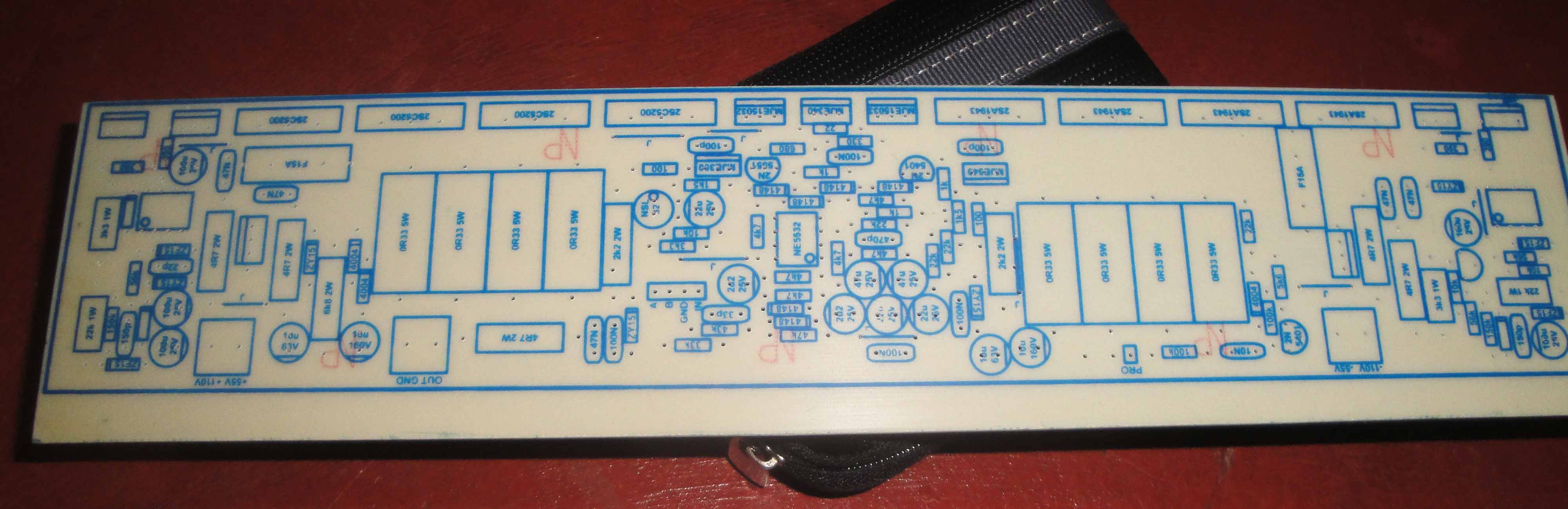

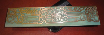

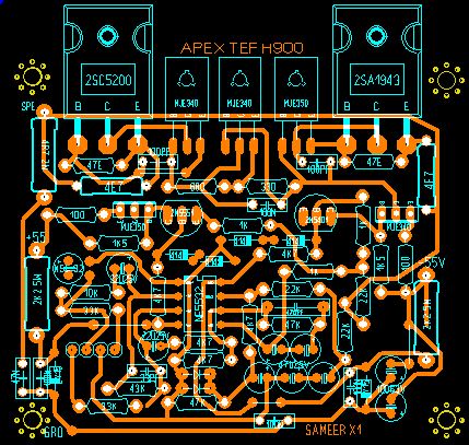

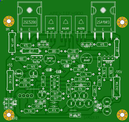

H900 TEF TRIAL DRIVER PCB
Dear Sir apex audio
hello just want to ask you few points on h900 tef
1 which schematic i must follow one with darlington BD681 and 10k preset or the MJE
340 bias transistor without preset personally i would like to have preset for biasing
i plan to have 8 pairs in output pcb i post is for trial only i will design pcb with output and drivers on both sides so please can you help me
thanking you
sameerx1
Dear Sir apex audio
thanking you
sameerx1
Dear Sir apex audio
thanking you
sameerx1
Follow schematic with darlington BD681 and 10k preset for biasing, and I suggest balanced input like in BX500 with volume pot.
