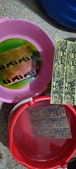

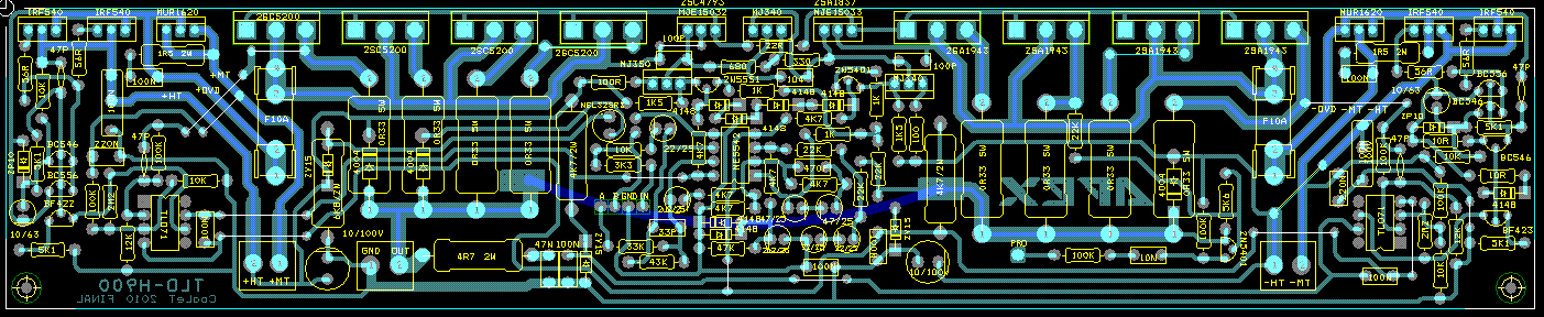

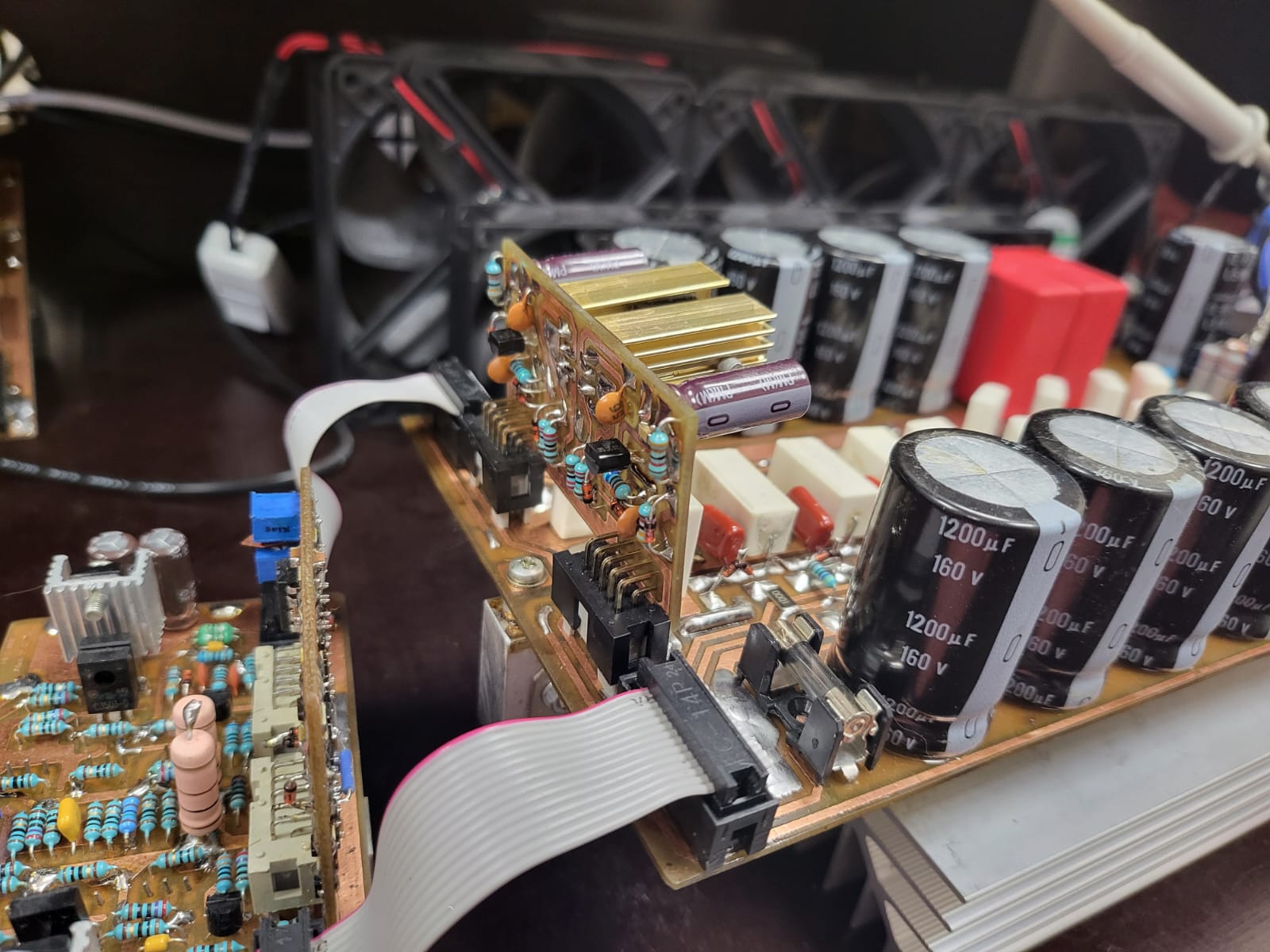

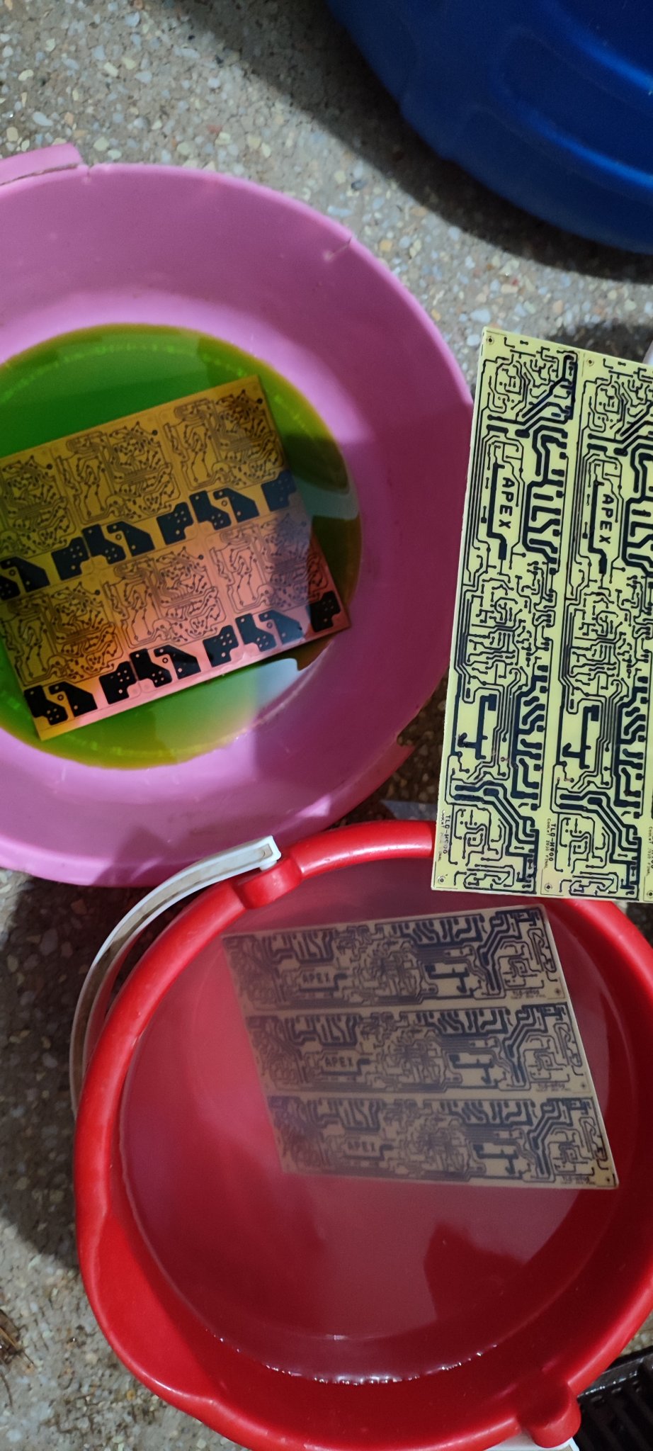

hi all before i complete the apex lm311 version , let me make the below apex 900 using tl071
below are photos of projects made and discussions
the discussion is at page 500wts forum and 900wts forum #659 , #975 , #1,055 #2527 , #2584 , #

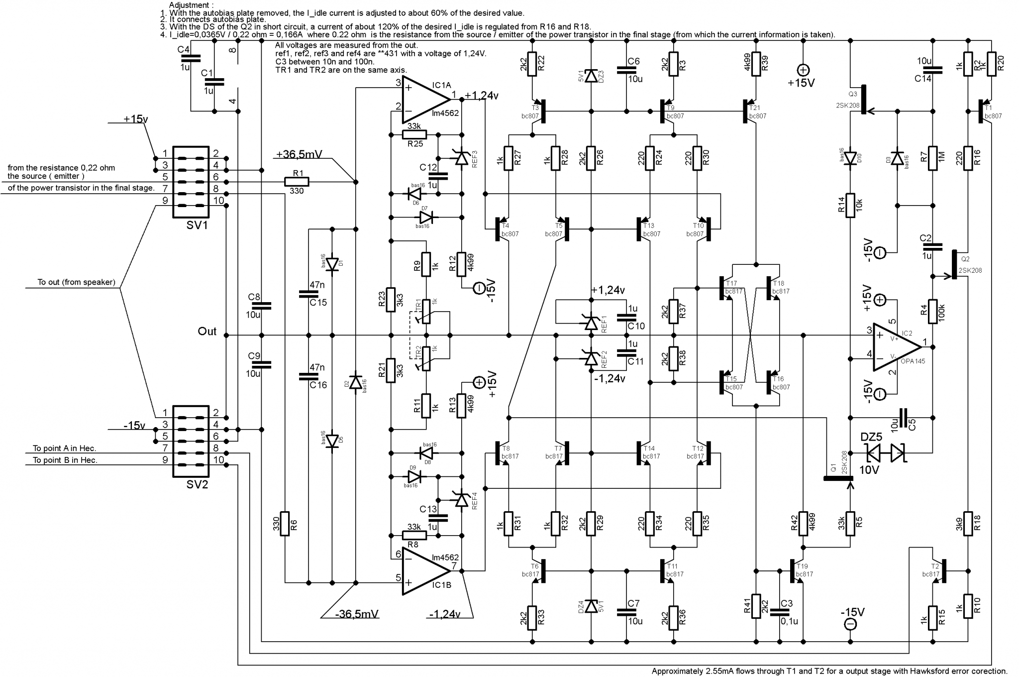

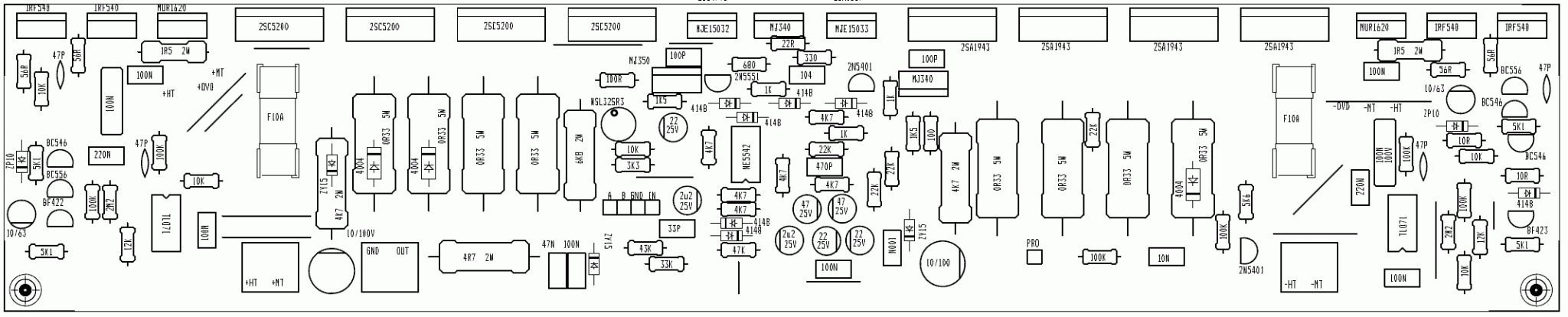

500W PA amplifier with Limiter pg66 B500_TO_H900@_LAYOUT.PNG164.3 KB · Views: 1,666
500W PA amplifier with Limiter pg83 PARTS_LATEST recheck modification.GIF110.3 KB · Views: 1,708

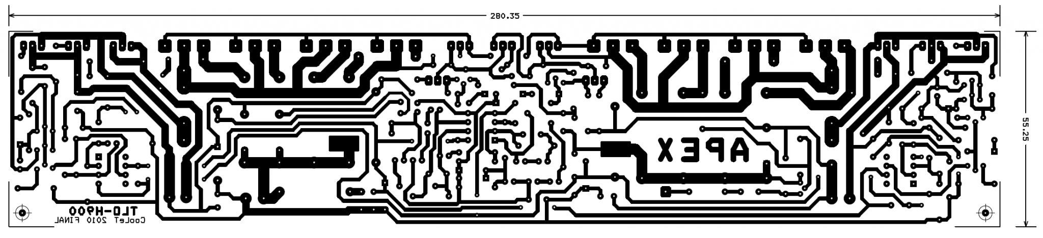

APEX H900 by coolet tl0 280.35x55.2mm x 3pcs pcb bottom.jpg.pdf138.6 KB · Views: 836

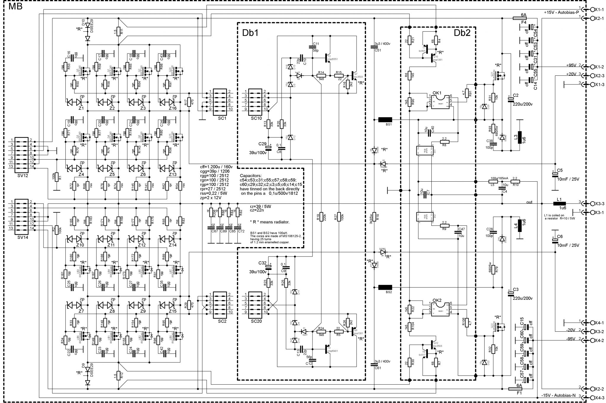

900W H-class PA Amp with Limiter pg255 -900w-h-class-pa-amp-limiter-solidwire.gif58.2 KB · Views: 3,039
hi @vars
hi @vargasmongo3435 have you done apextd1800 pcb kindly share filesthe files are on post number #3903
please is for diy build and enjoy 🙂 I sometimes tweak the files and this is the last thing I did to it and is here

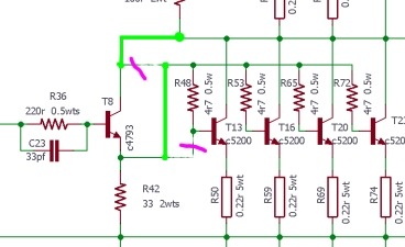

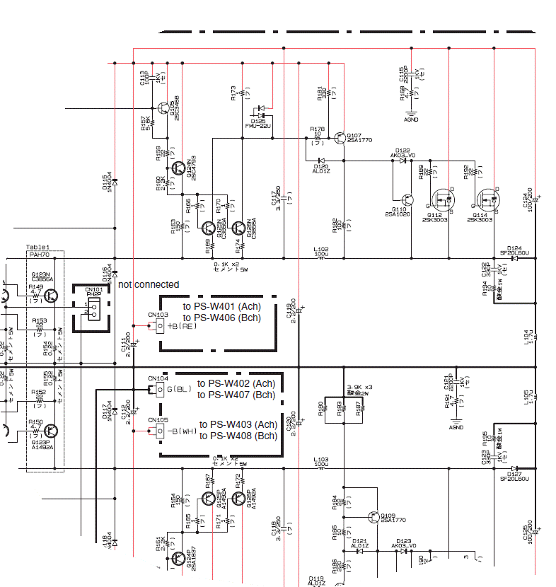

please help, my broad h900 follow the original schematic. The circuit works normally, but when the volume is reduced to min, use a metal bar to touch the mass of the speaker signal, there is still a rustling sound and sometimes even radio waves are received.

hello sir can u plz shear which layout you use .and pdf plz shearMy TD 1800

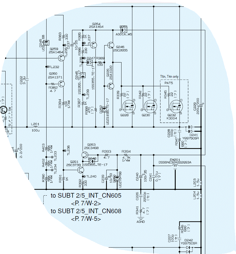

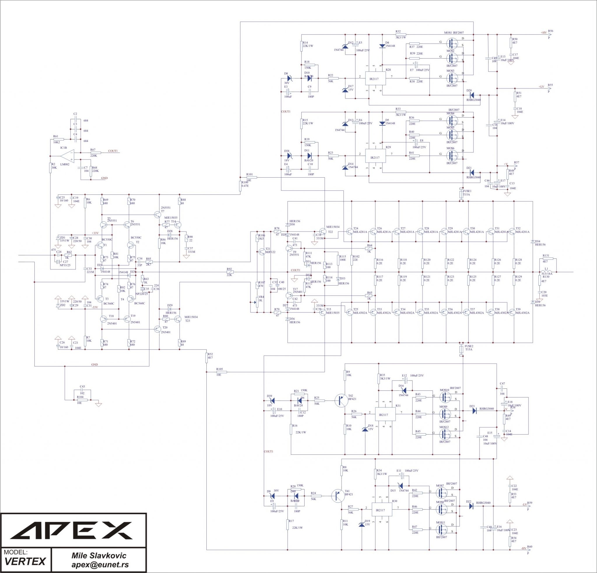

IR2117 memberikan sirkuit dengan stabilitas terbaik untuk mengemudi MOSFET. Digunakan dalam amplifier konser industri.
why does the input zener diode use 18v and 30v?IR2117 give circuits with best possible stability for driving mosfets. Uses in industry concert amplifiers.
hi aguswhy does the input zener diode use 18v and 30v?
those zeener diodes are for the switching class d stage
oh yes , thanks printnik for pointing it out , i have rectified it .Stewin, I think you have a mistake.

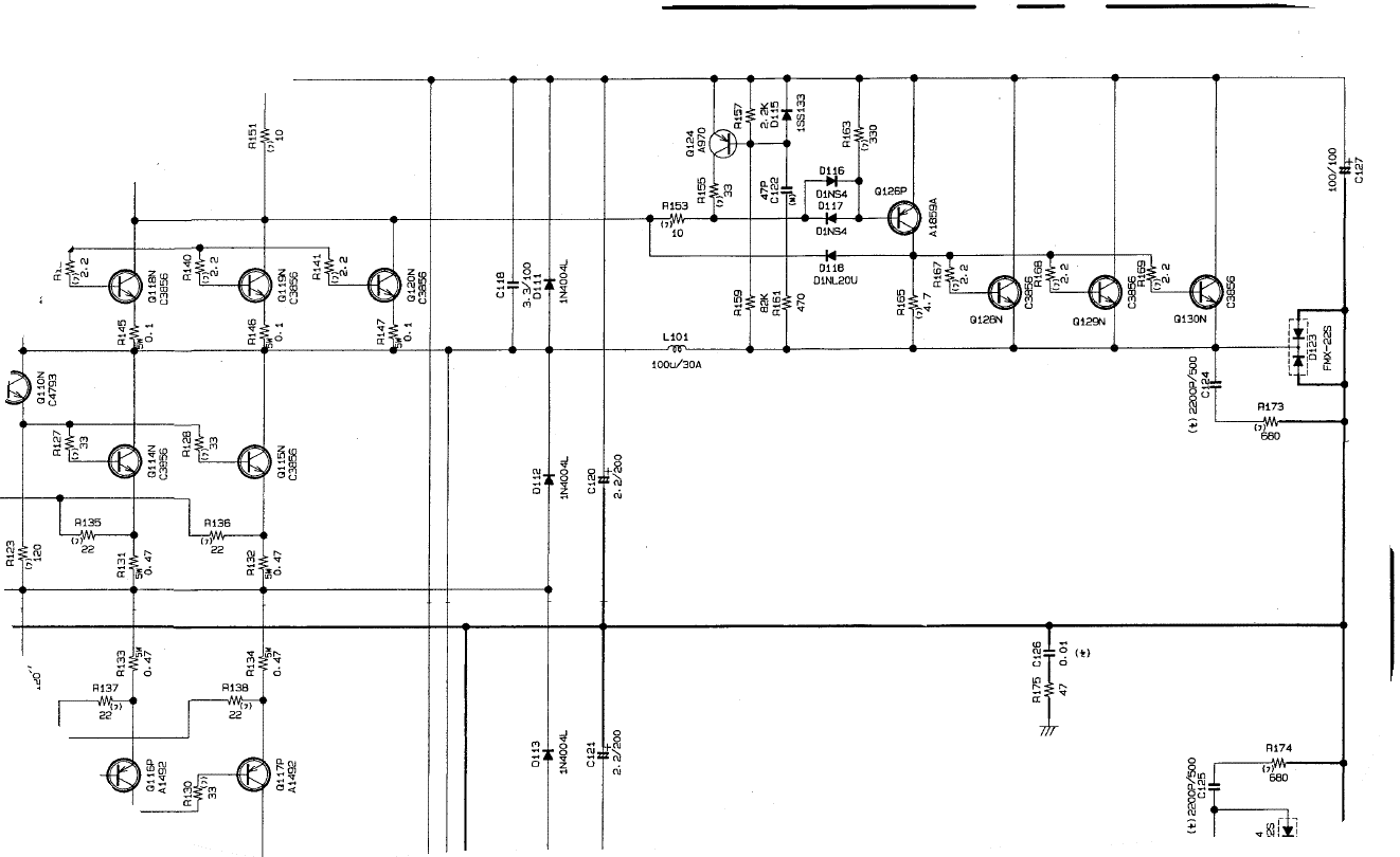

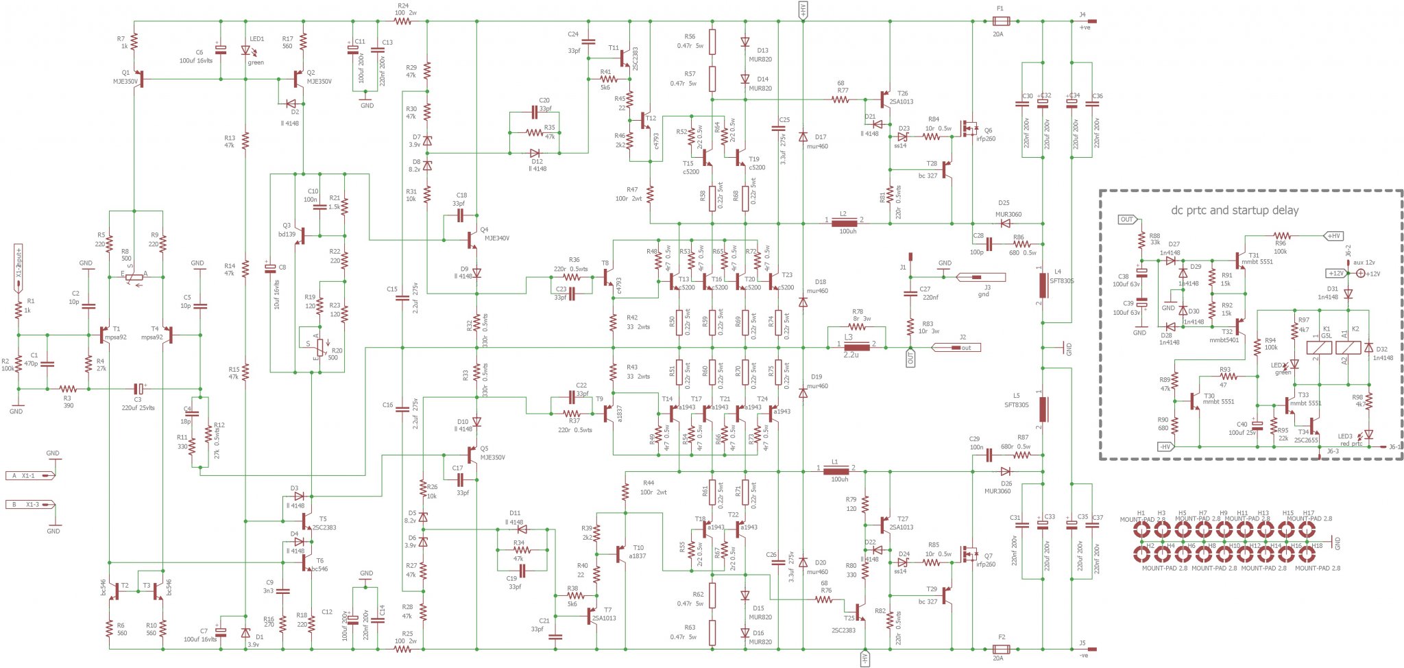

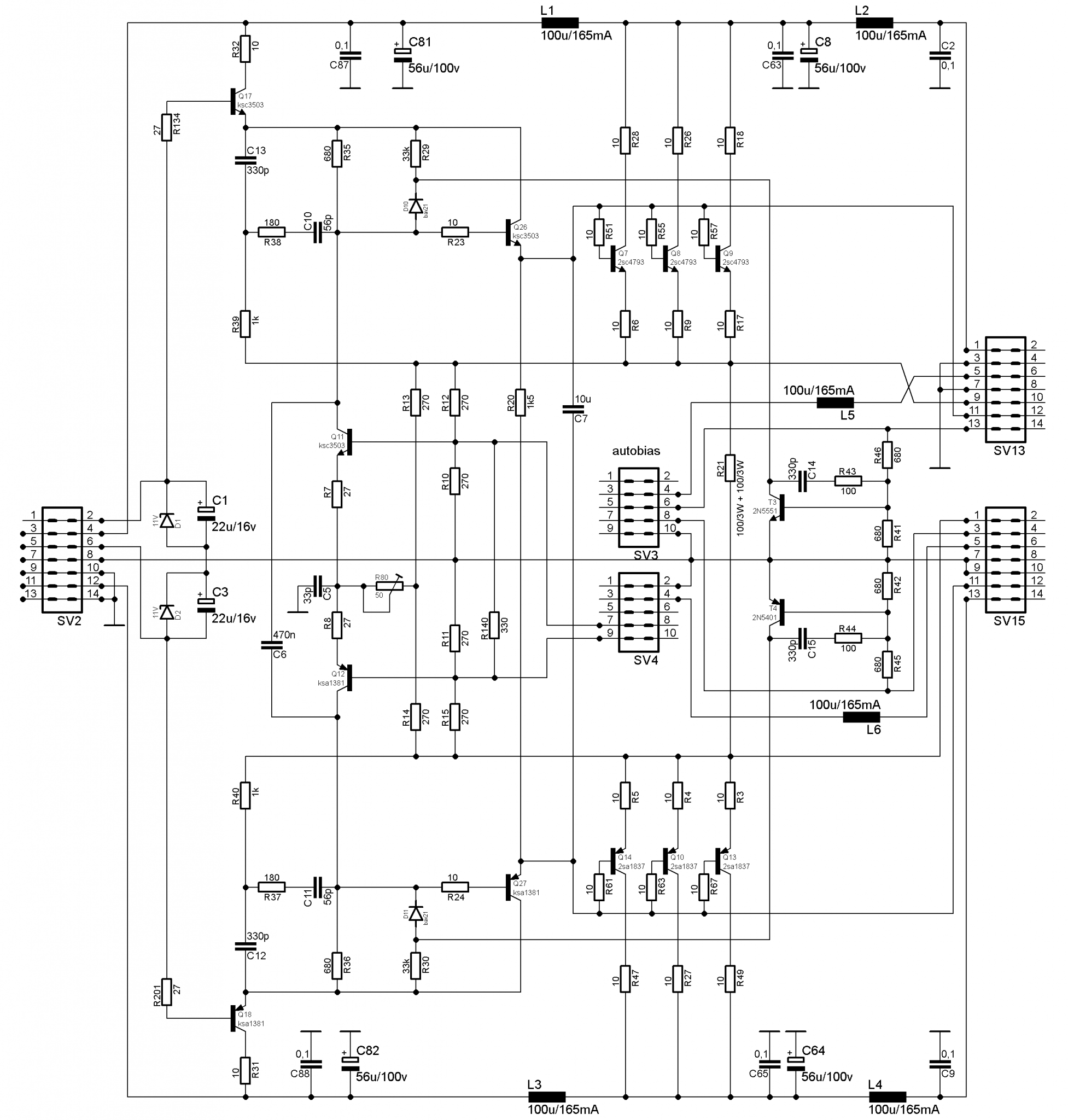

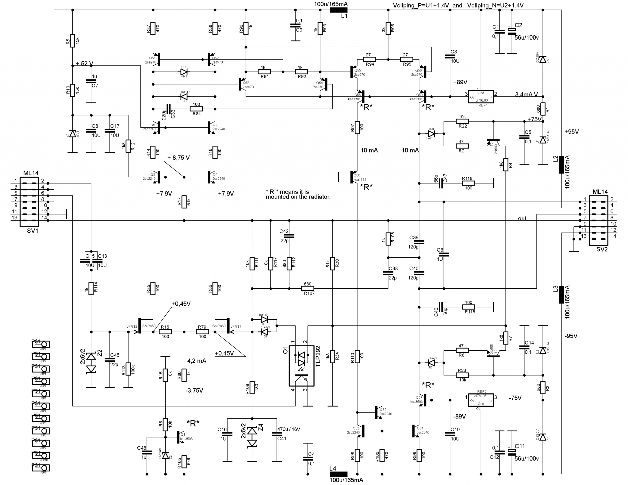

because it's a class ee engine configurationWhy is C35 / C37 connected to L5-1 and not to L5-2 (respectively C34 / C36 to L4-2 and not to L4-1)?
Like this one?
or like this one?
or like this one?
it is kartinos design, i don't understand why myself. but below is the link to a working prototype at youtube .Why is C35 / C37 connected to L5-1 and not to L5-2 (respectively C34 / C36 to L4-2 and not to L4-1)?
you can use youtube translate , to translate the captions to english

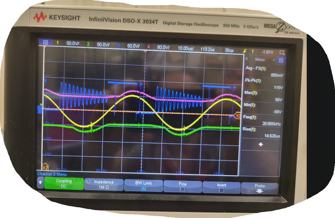

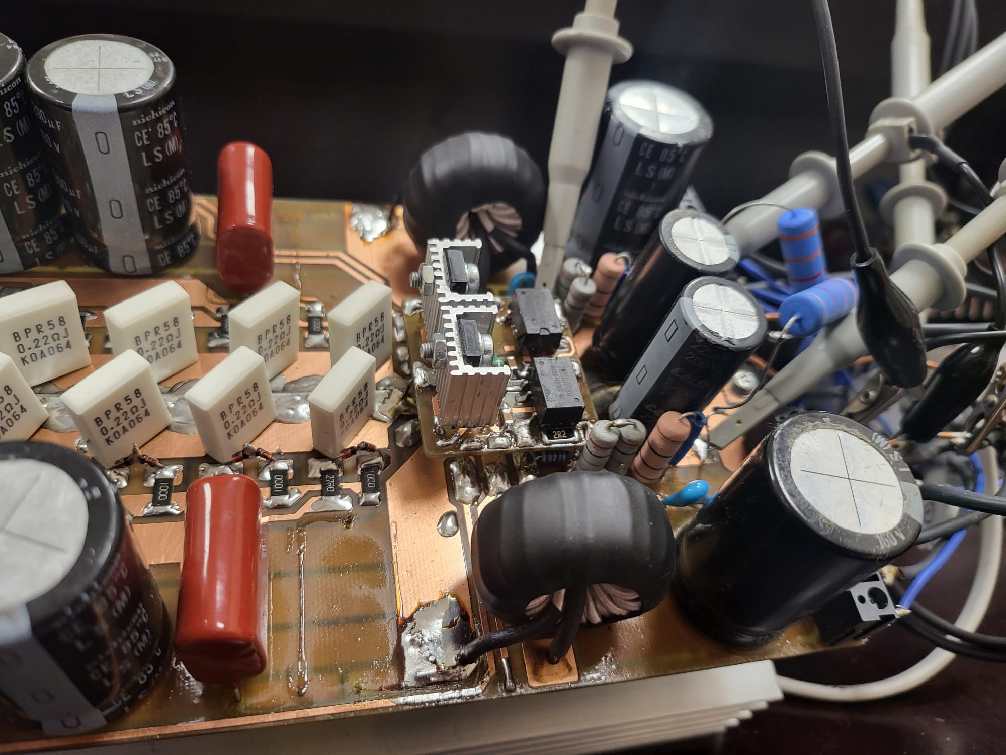

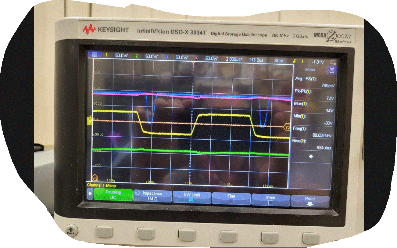

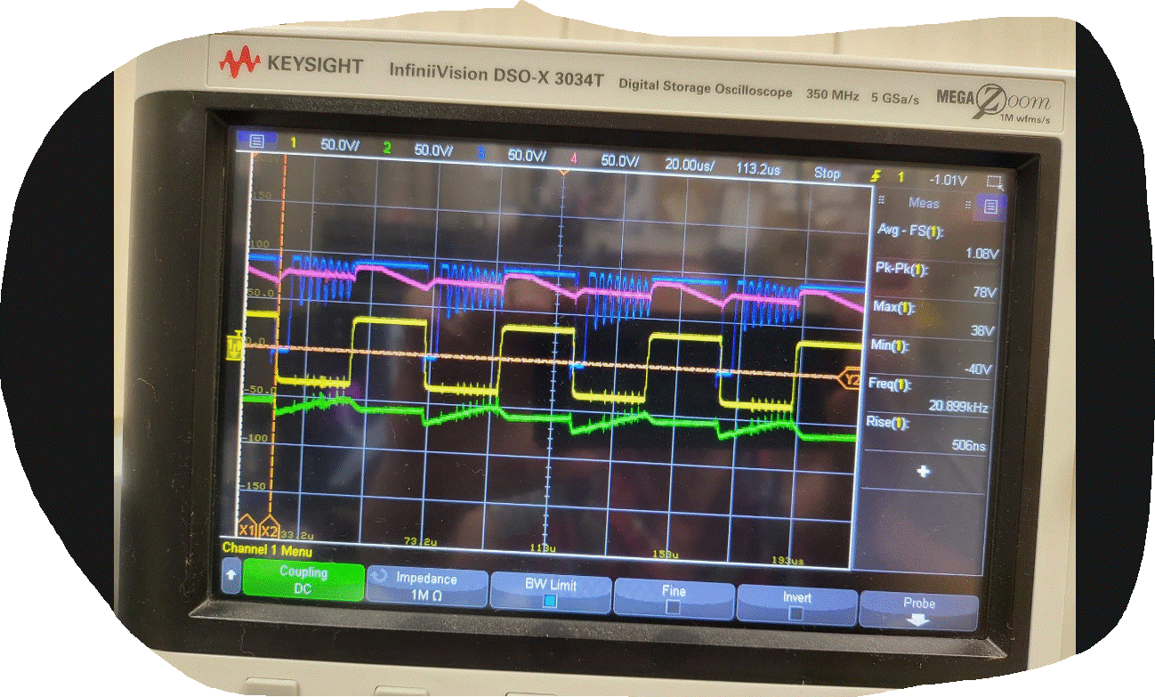

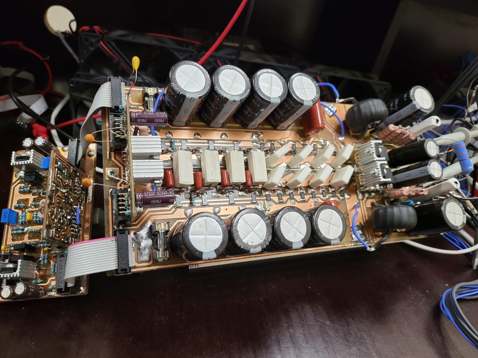

It's actually my mistake. I confused C34 with C32. The amplifier in the video looks good. But it showed tests only at 100 Hz. What do you think of the following oscillograms, which were made with my recently built amp? It is powered at +-95V.

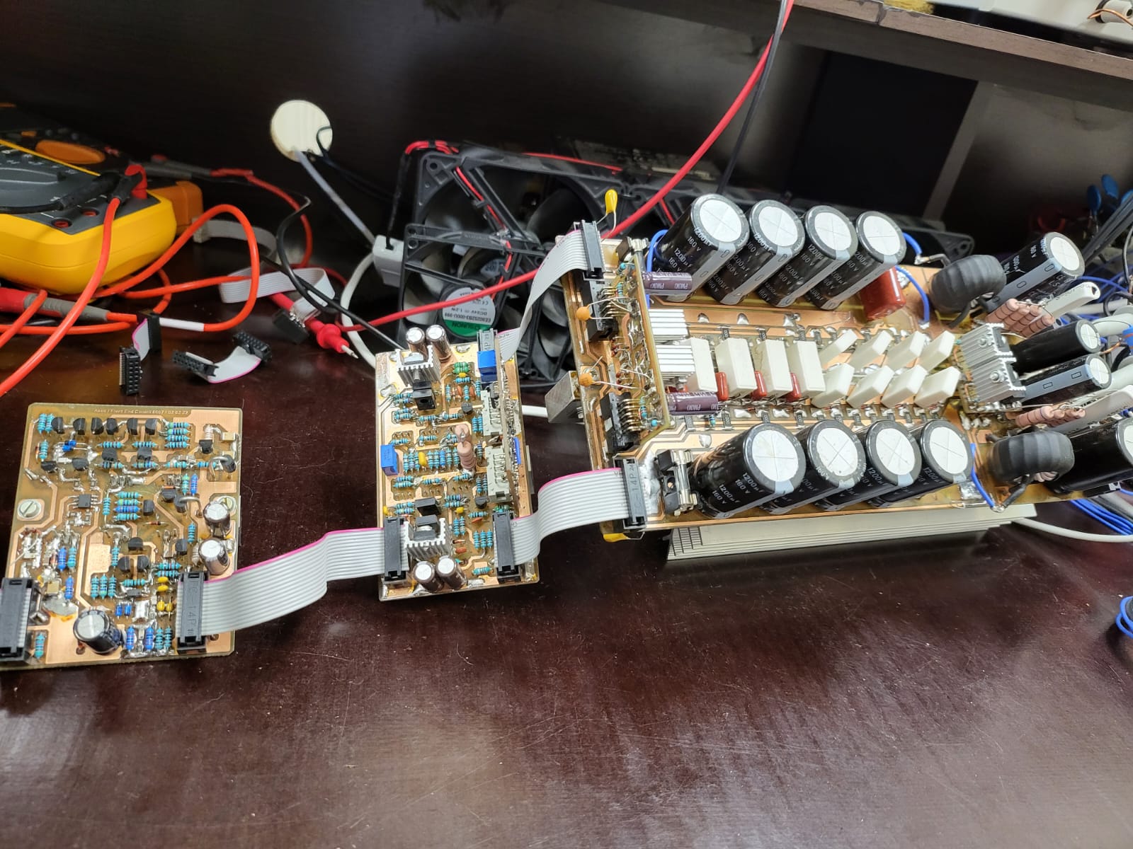

which class , kindly post schematic and build photos
which class ? kindly post schematics and build photos .It's actually my mistake. I confused C34 with C32. The amplifier in the video looks good. But it showed tests only at 100 Hz. What do you think of the following oscillograms, which were made with my recently built amp? It is powered at +-95V.
My amp is eengine. The oscillograms above are on the 4 ohm load.

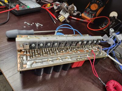

The amp isn't finished yet, it's a work in progress.
oh this is a great project ,nice job .My amp is eengine. The oscillograms above are on the 4 ohm load.
why did you opt for fets instead of bjts?
also what is the max rail voltage you have designed it for?
and finally what is the lowest impedance it can handle?
