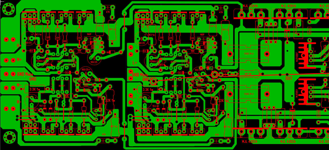

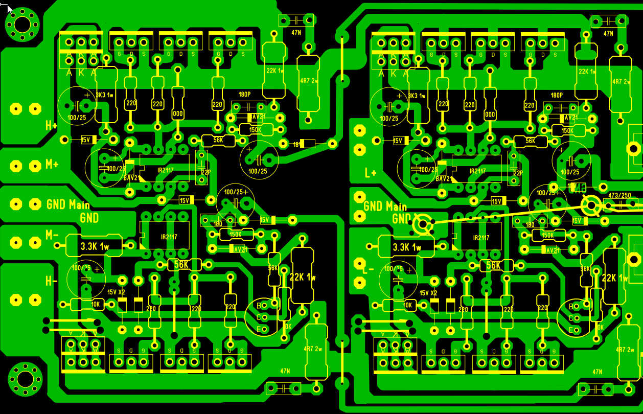

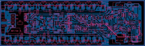

@wattaniya,
Some tips:
use yellow color for the top overlay. It's more eyes friendly. 😉
Edit: btw, your top overlay is overlapping the multi-layer / pads. Also, never put designators inside the gabarits of the component.
Use thicker tracks/polygons where the current is higher or use 2 oz FR-4 boards.

Thank u Hightech for the tips. i" ll change it.

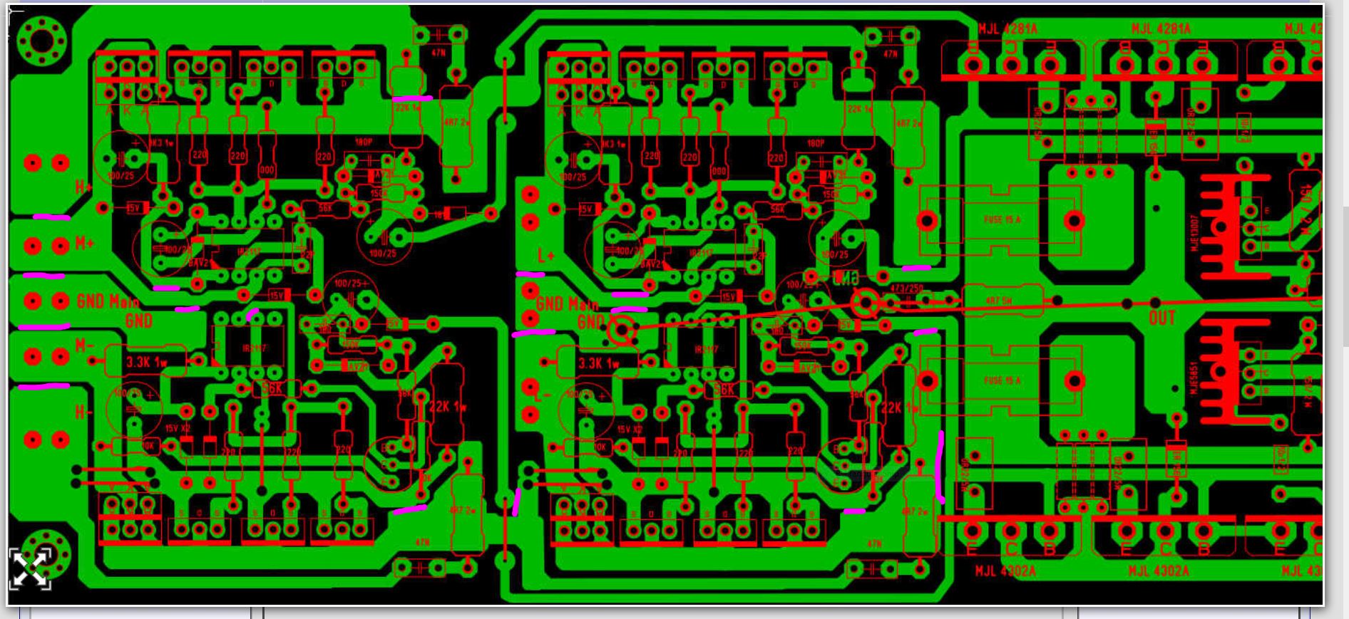

wattaniya hi try to avoid this too close gaps, keep at least 4 mm if you can 🙂
This VERTEX AMP already made BY Irvyinjay.
ok I"ll Redraw that.

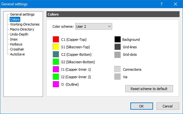

hi bro change the color to this is better for the eyes see example C1 red, S1 yellow, C2 green and background black 🙂 if only single layer use C2 green S1 yellow
Just like that. Red overlay (silkscreen) pokes your eyes.

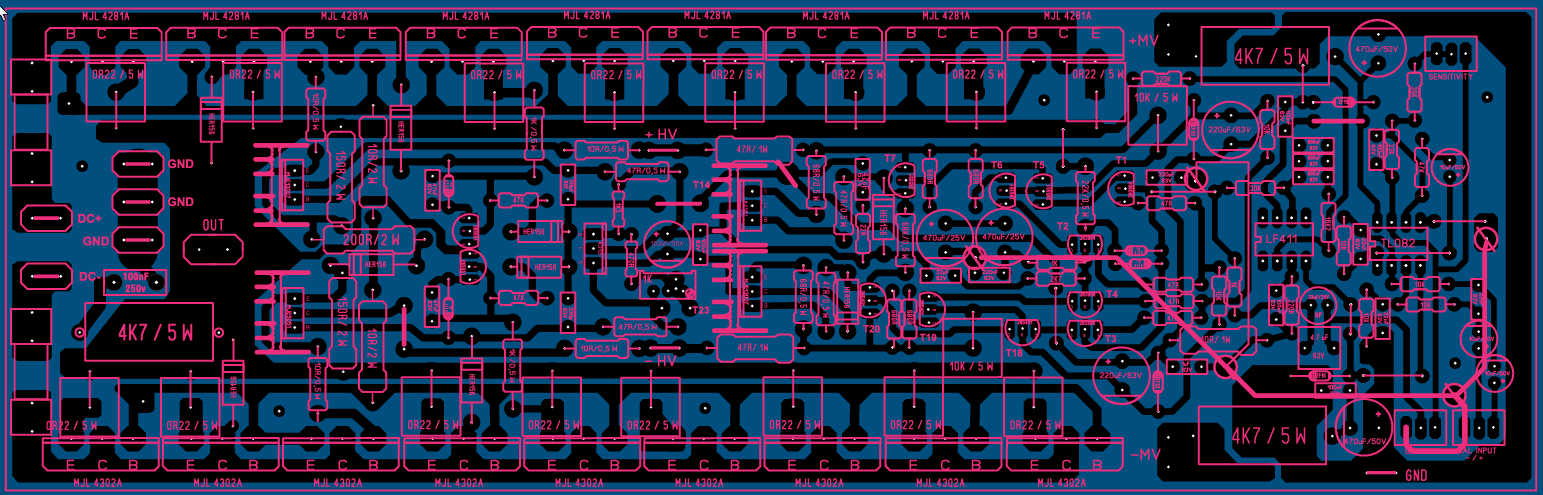

hi all the new td version by kartino .
have fun all 😀😀😀
TD (TRACKING DIGITAL) & E-ENGINE AMPLIFIER

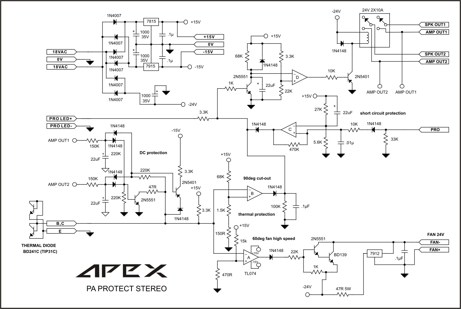

I am thinking of ocp and dc protection circuit for Apex h900 and its derivatives.

Hey folks, I've built the stereo protection circuit from Apex, I have a couple of questions.
What do you think could be causing the DC protection to only work when both channel outputs are connected together and DC is applied but if I apply DC at either 1 or 2 channel input the DC protection doesn't work, relay stays on.
I built my board according to the schematic attached to this post. It seems to me that in the DC protection circuit there is a 220k resistor value written for both inputs but it seems to me only one 220k resistor to ground is needed there and I seem to have only one.
Also can the board be configured that the fan doesn't start spinning until some set temperature instead of being always on and at full power after 60 degrees?
