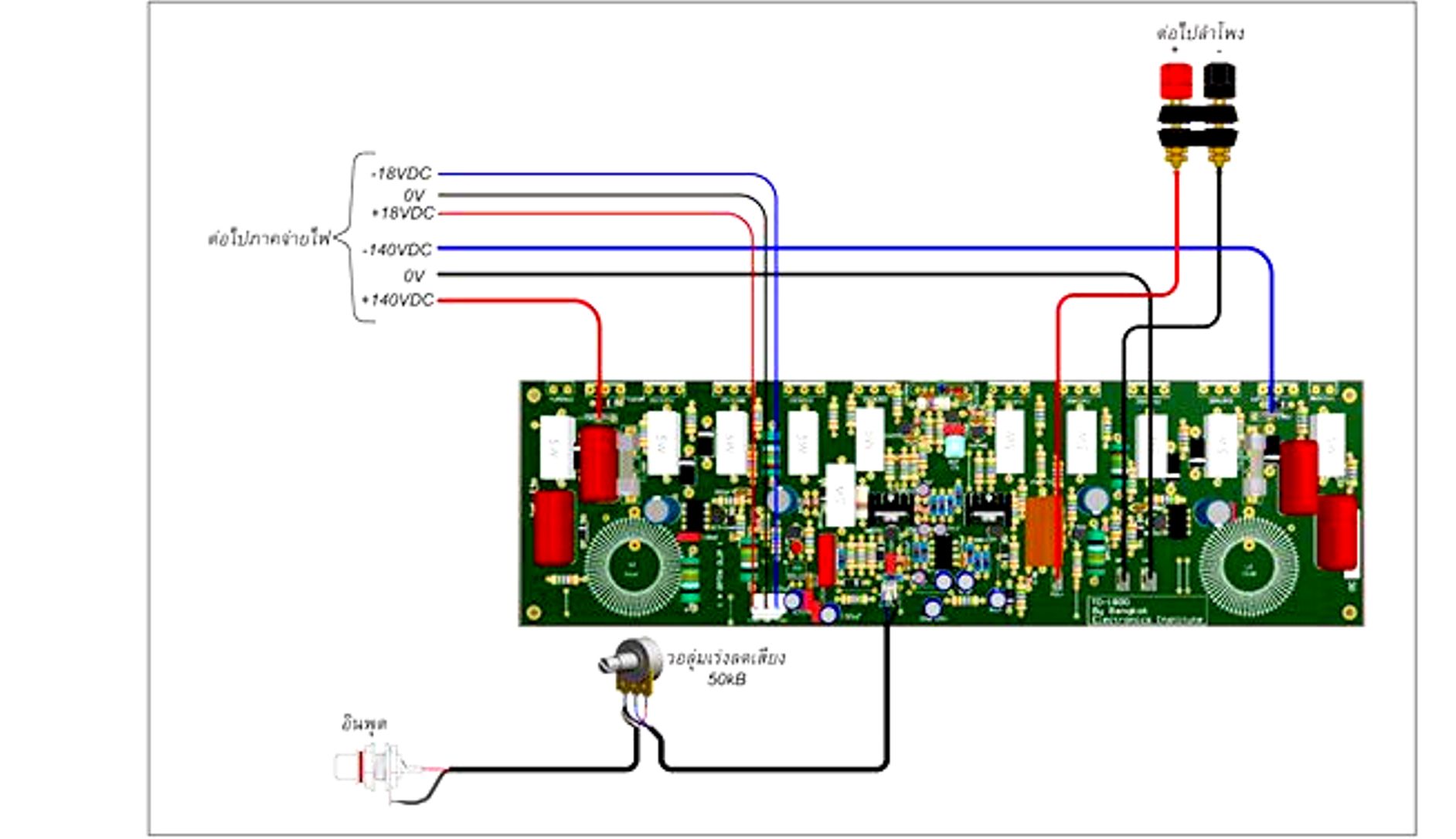

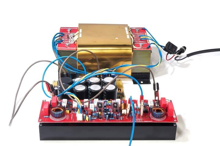

Please see my wiring
Above this diagram when i connect sgnd to ground ampl.stop working(song stops).please give me what to do.regard

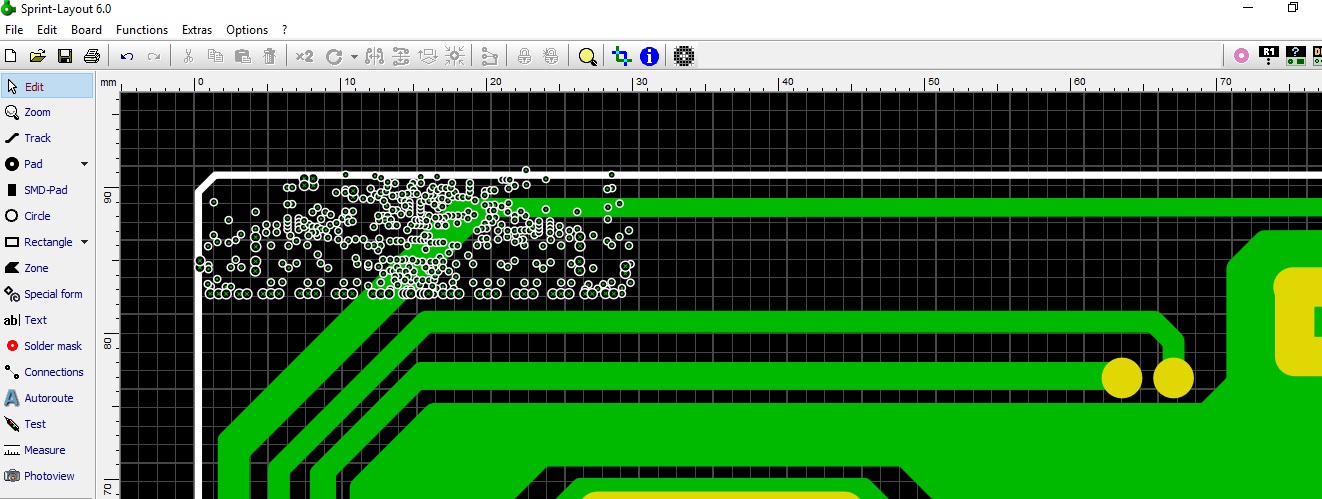

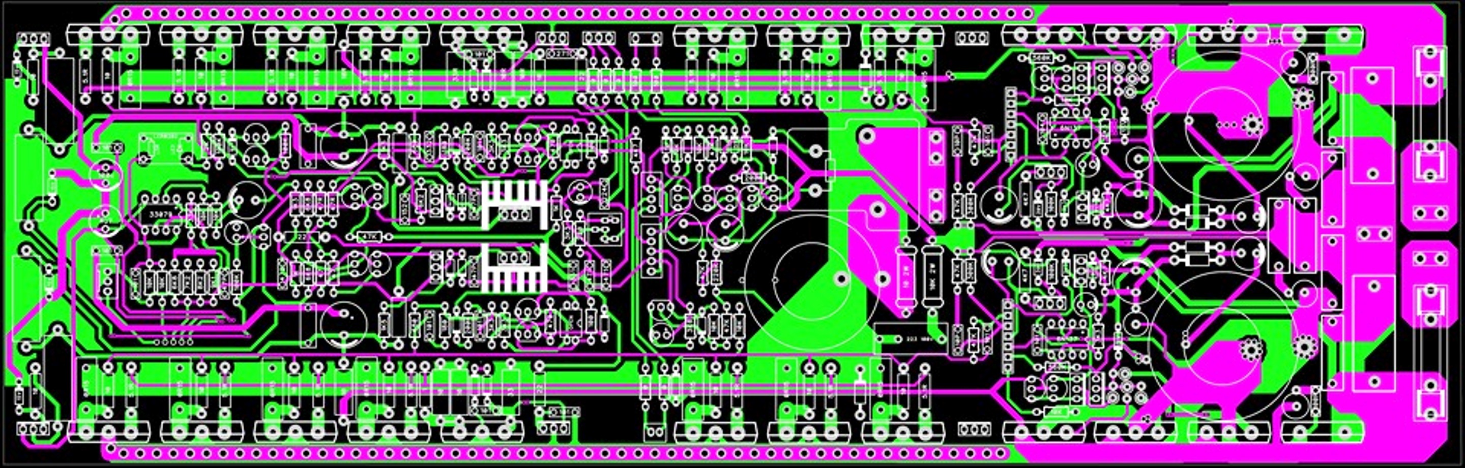

No *.lay files, gerber in ZIP file. Sprint Layout import gerber.

I downloaded zip file and import files to SprintLayout 6 but i have some problem with drill file ....
lm324 , thank you very much for your answer !
When you import drill data, change Unit to "mm" and "numeric Format" to 3

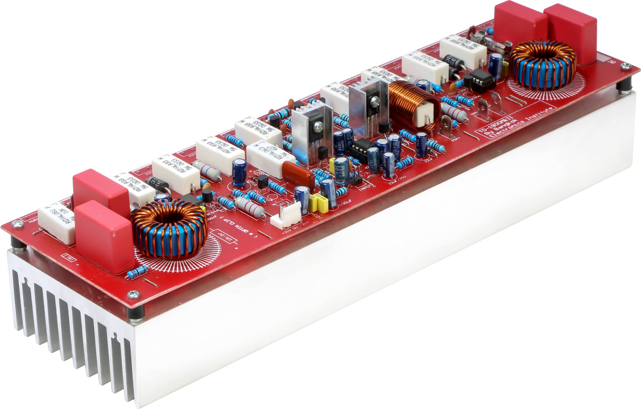

look like chinnese pcb clonesomebody posted this photo on facebook as labgruppen TD class p.c.b. clone

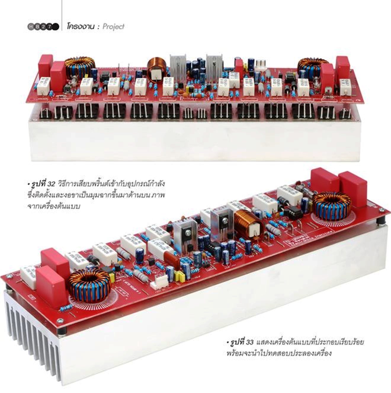

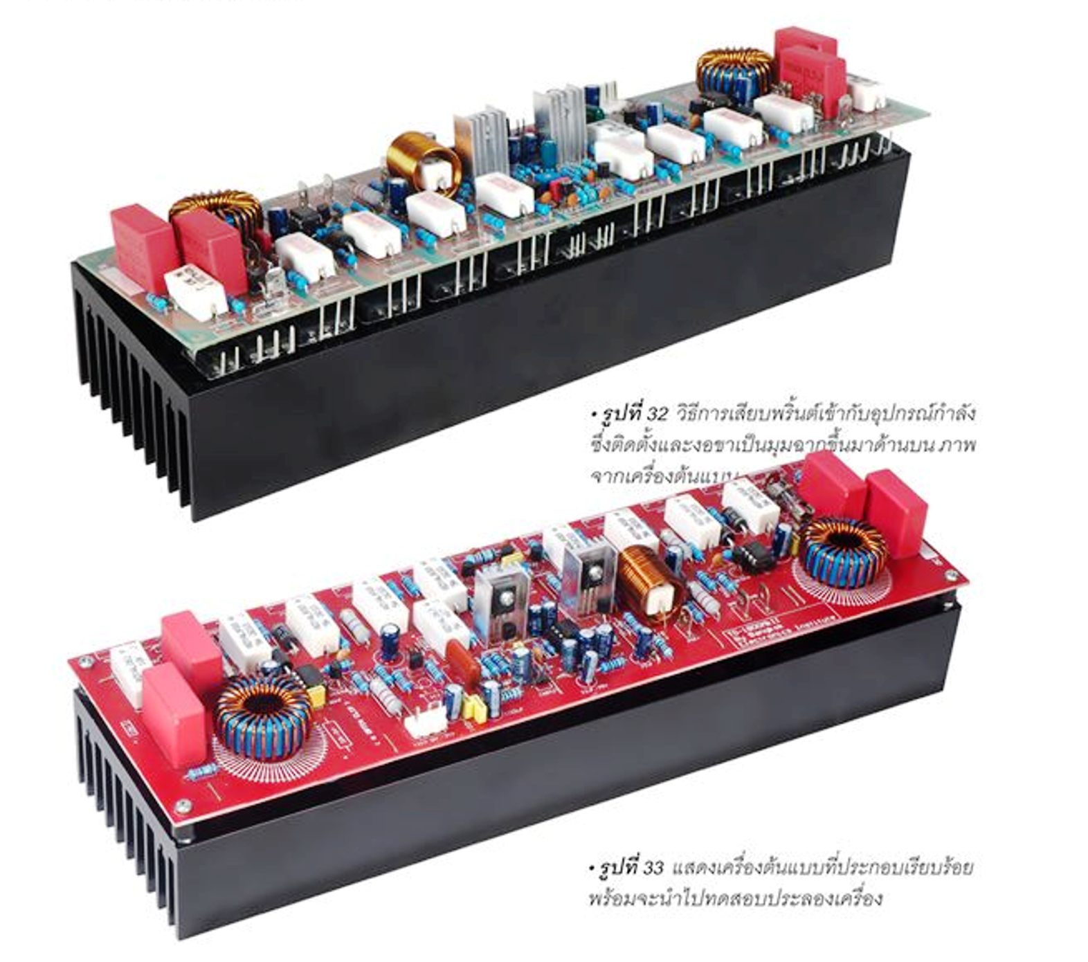

class TD more photos
here are some more photos of class TD from Electronics Handbook
thanks vedmitraa for the pics posted . please post photos of your project of this class hd or td amp .

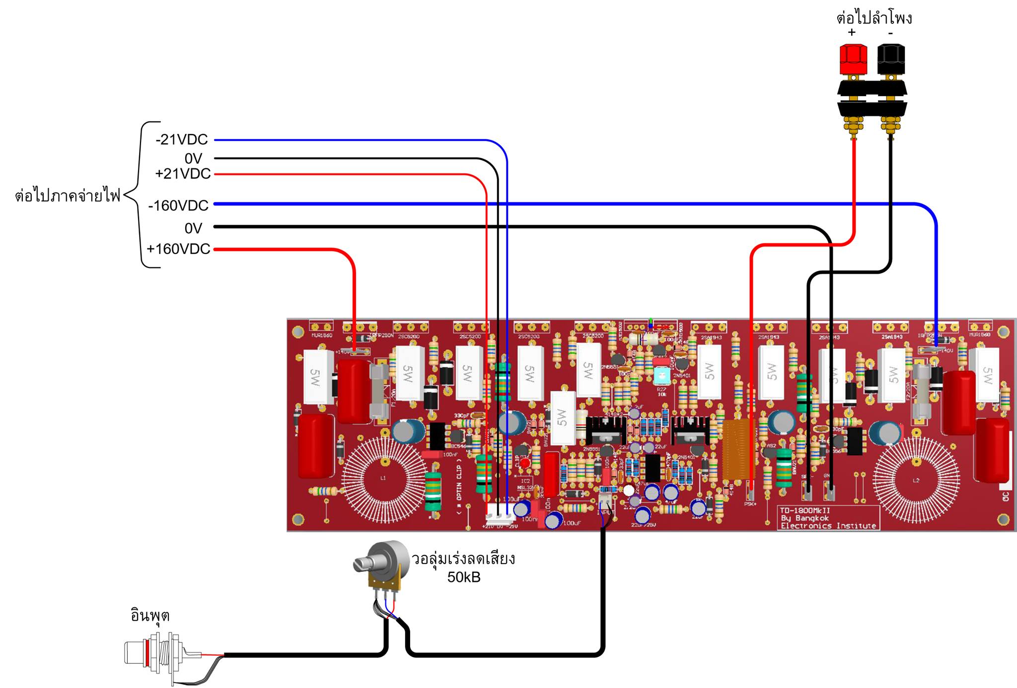

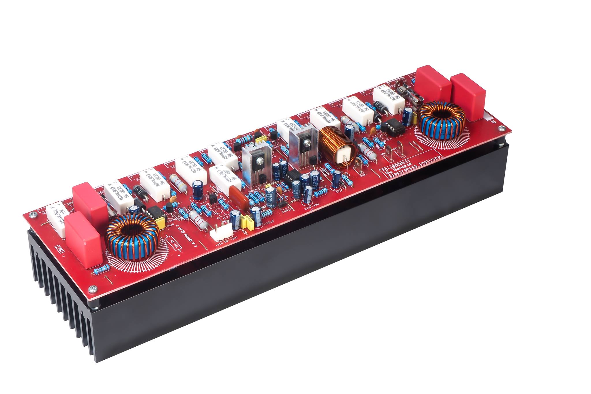

It looks like Thailand Electronic engineers have designed TD1800
published May 2019 in Thailand Electronic Handbook
I cant find this in english
It is clone of APEX TD1800 designed by me and published 20th February 2019 in this thread post #3688
