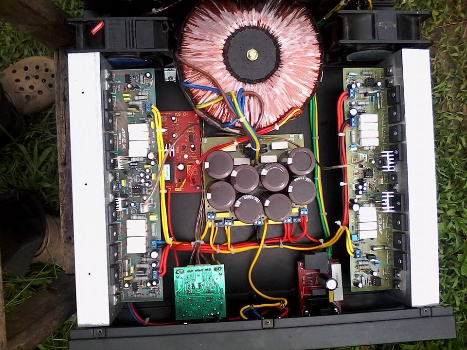

Hi APEX
Where are the 2 Rail Output Filter, cant see the 2 T157 Output Filter ?
your internal not look same like schematic

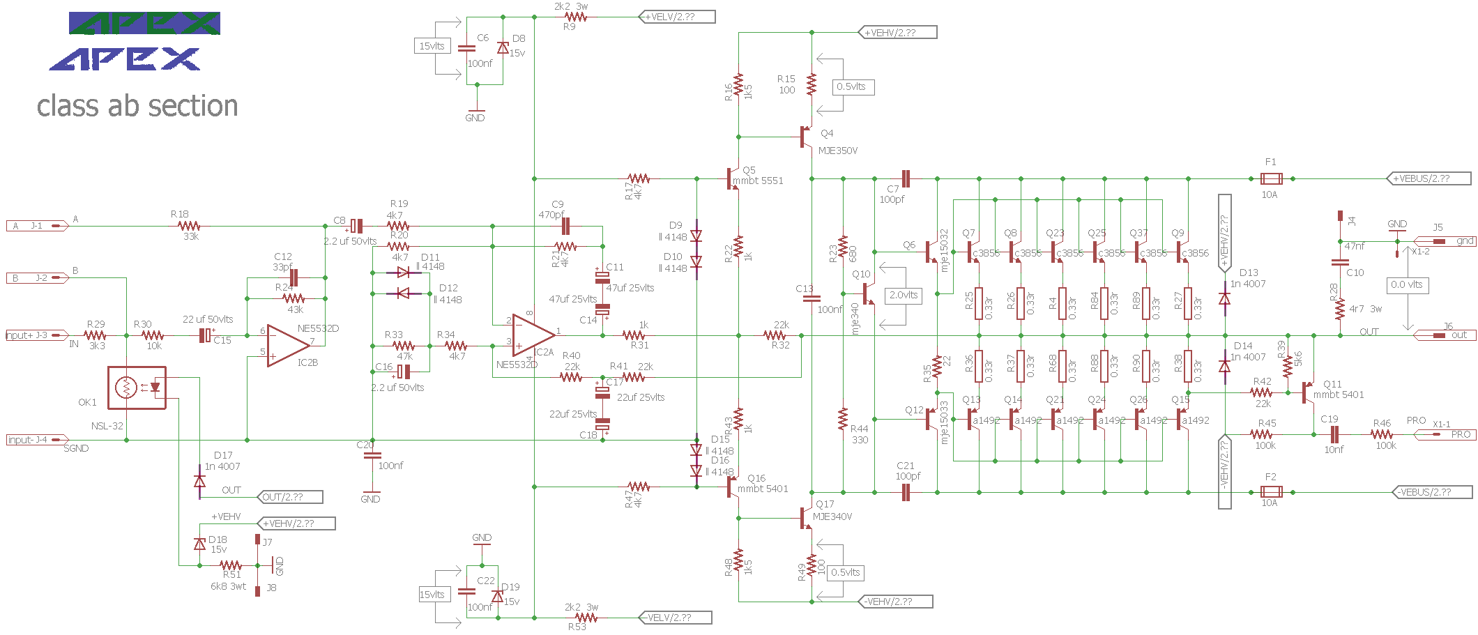

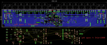

hi all , i have finished drawing the schematic 3tier using lm 311
please check all and point out erors if there be any .
i have also uploaded eagle files 😀😀 have fun all and thanking you all in advance for your contributions
Why dont you use TD1800 ?

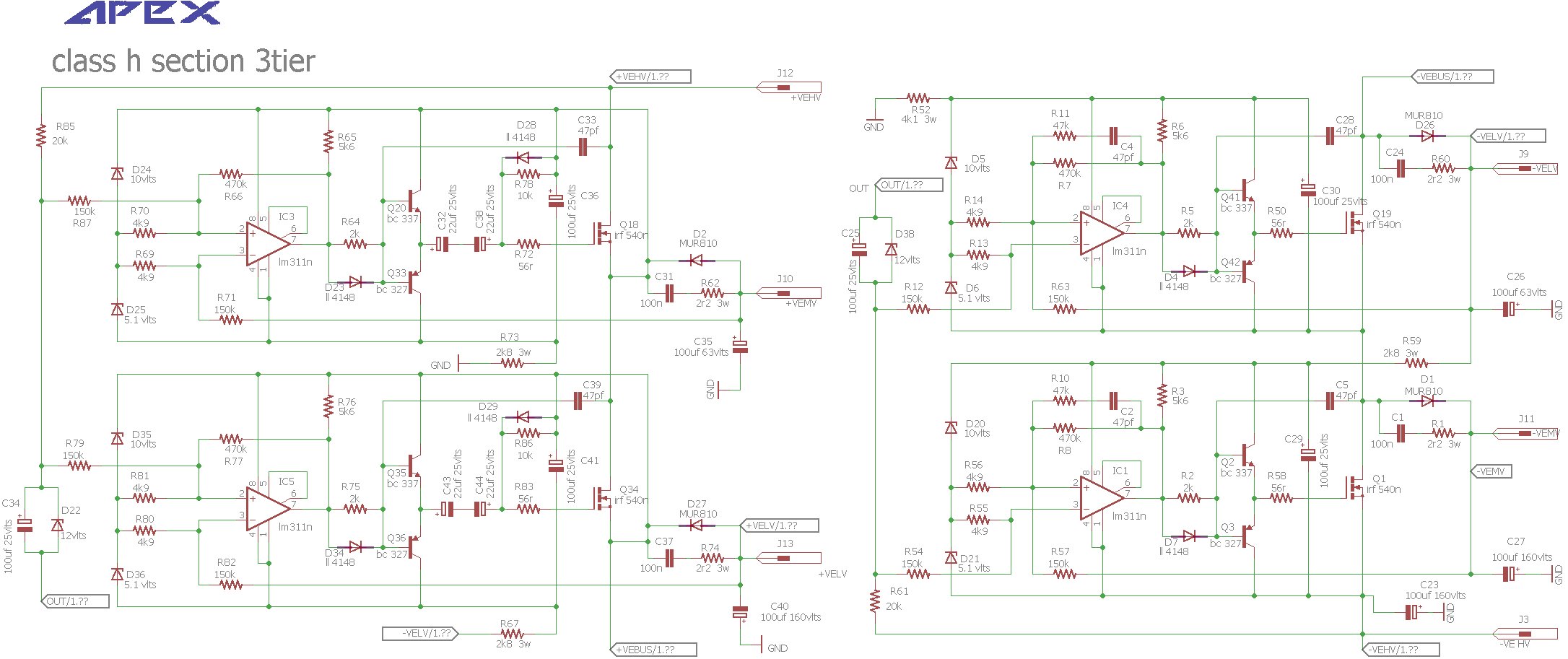

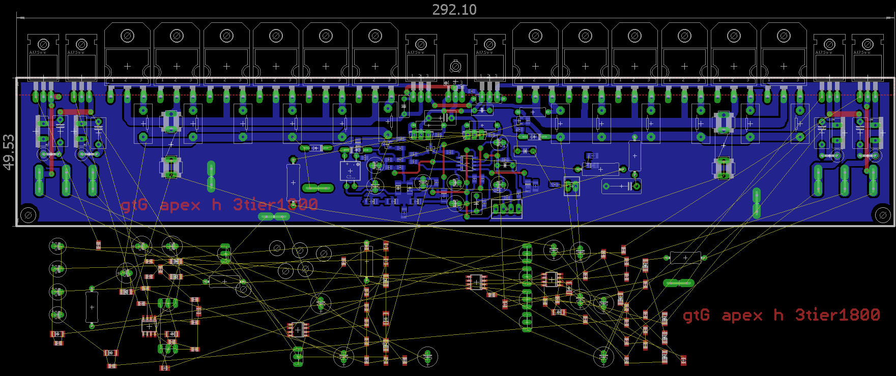

simple apex h 3tier 1800 layout loading ..... ......... ........ ..... comments views and suggestions highly appreciated .thanks all😉

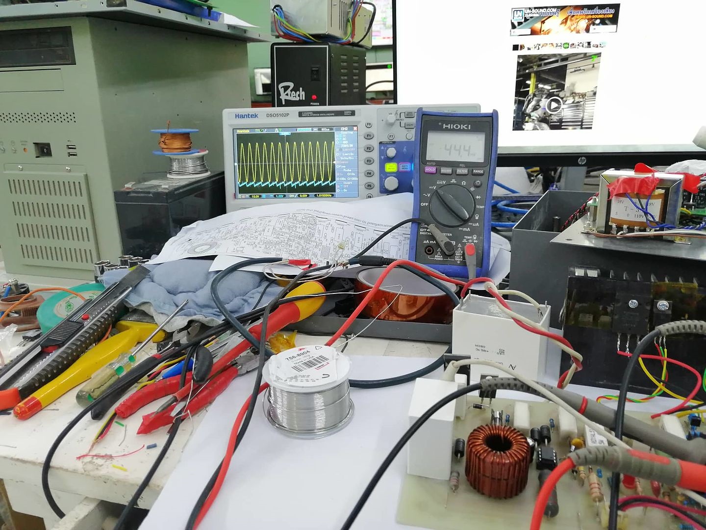

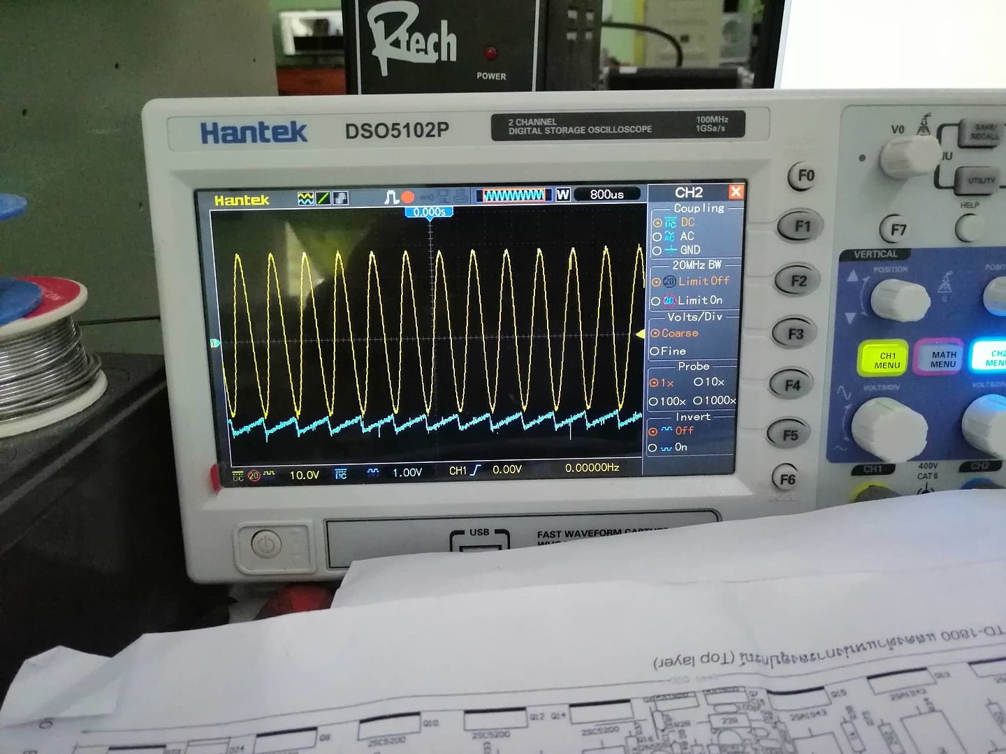

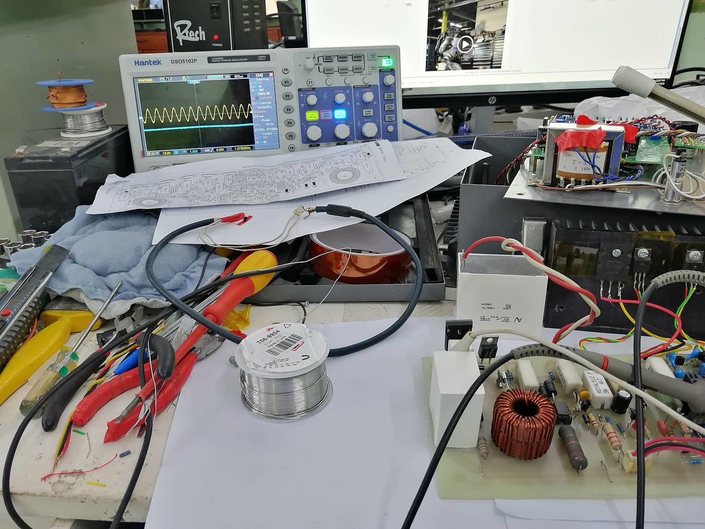

initial test,,,,

initial test,,,,

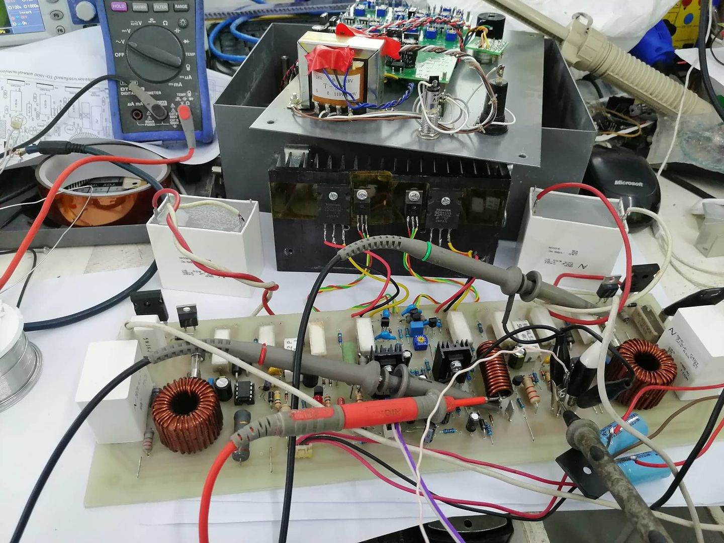

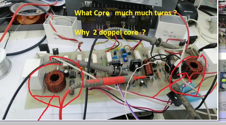

which inductor do you use ?
2 pcs. per Rail ?
how much turns ?
copper 0,8 ?
2 pcs. per Rail ?
how much turns ?
copper 0,8 ?
look PIC ?
how do you generate 18 V ?
separete PSU or from 140 V VCC / VSS with Resistor and Zener ?
