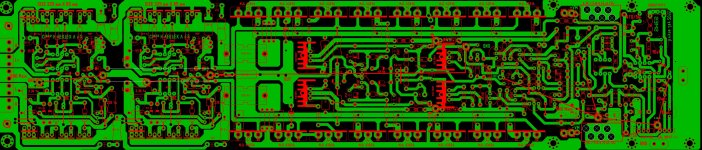

900W H-class PA Amp with Limiter

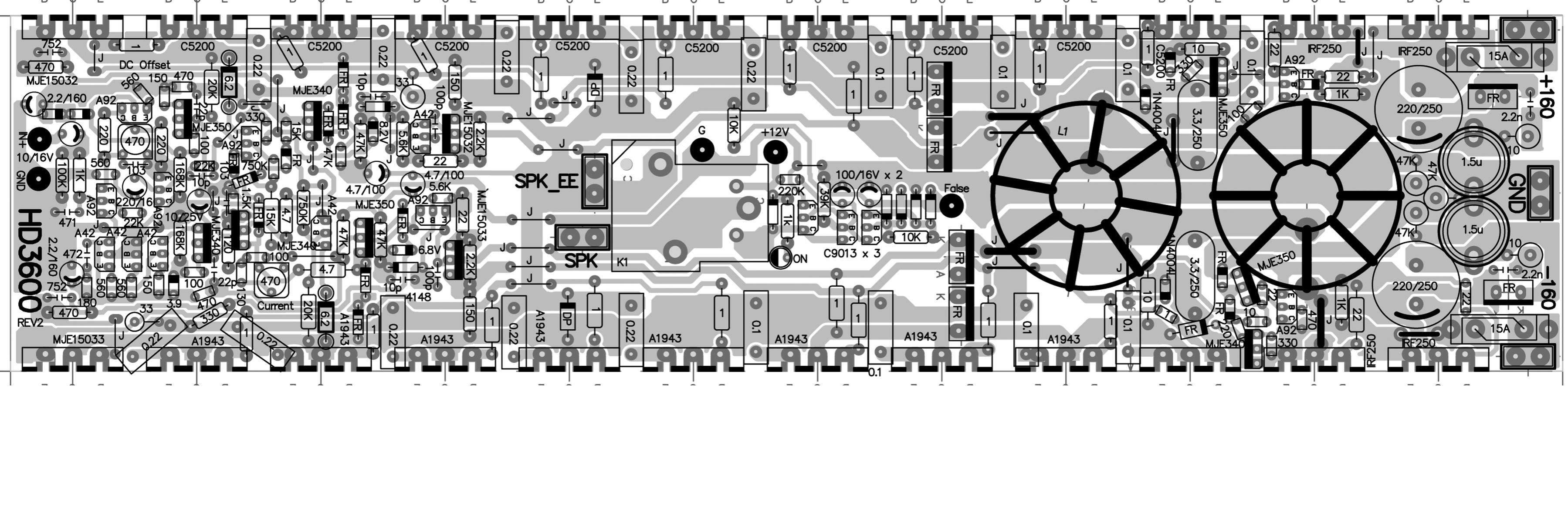

Anyone tryed this HD3600?
and when you look at the figures more closely you see that the output voltage has collapsed trying to put out the current that a 2r0 resistive test load demanded.
500W into 8r0 is equivalent to 63.2Vac & 7.9Aac
800W into 4r0 is equivalent to 56.6Vac & 14.1Ac (-0.97dBV ref 8r0 loading)
1000W into 2r0 is equivalent to 44.7Vac & 22.4Aac. (-3.0dBV ref 8r0 loading)
The results posted show that this amplifier is not able to properly drive a 2ohm reactive load.
It may be reasonable driving a 4ohms reactive load. But based on those numbers I would be tempted to test it into a 6r0 load and possibly rate it for loads no less than 6ohms.
