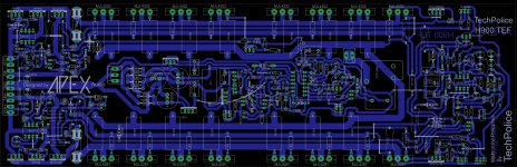

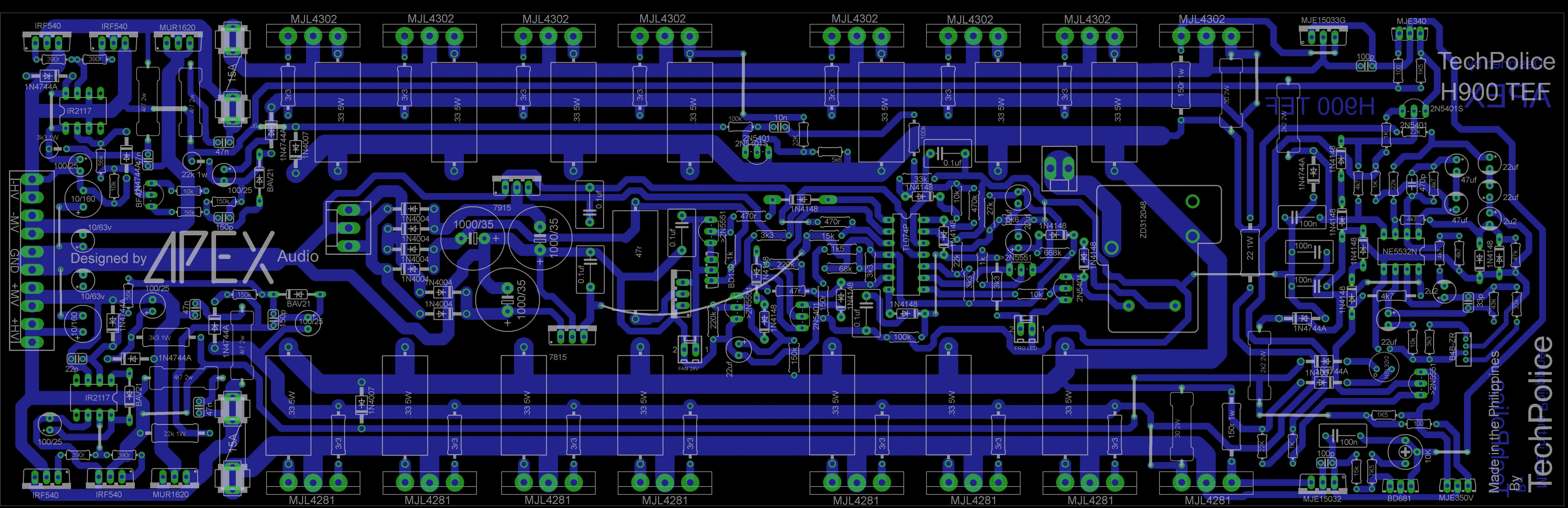

900W H-class PA Amp with Limiter
h900 tef
sir mile pls check for errors pls
hi techpolice,good to see h900 tef pcb with 8 pair.only apex sir can help and willy too because he already made tef but with 4 pair. after mje 15032 and 33 add one power transistor then he send signal to all output transistor.not so expert i am.some one surely will help you.will you share you tef h900 pcb?

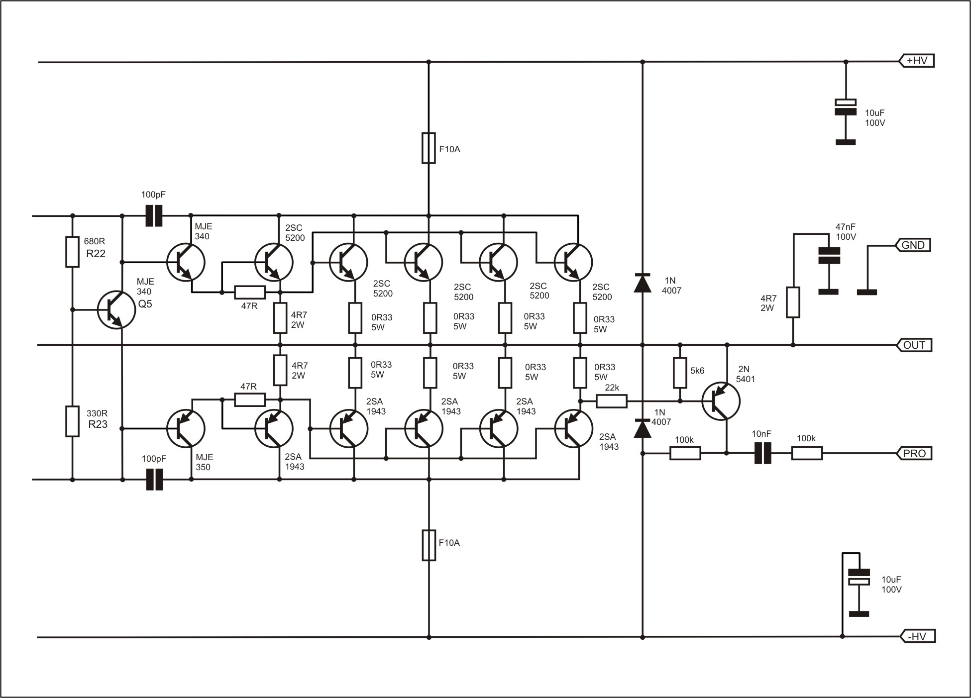

if someone gives me the complete detail of schematic i will surely share the pcb design.
hey engel.do you have the full schema for the h900 tef with 8 output?if you give i'll design the pcb for you.
same schematic
only the output tef arrangement
here
adding more output need to change driver transistor
this modification is old as this thread and b500
but nobody share pcb after all of triple ef
hope you make it this time
