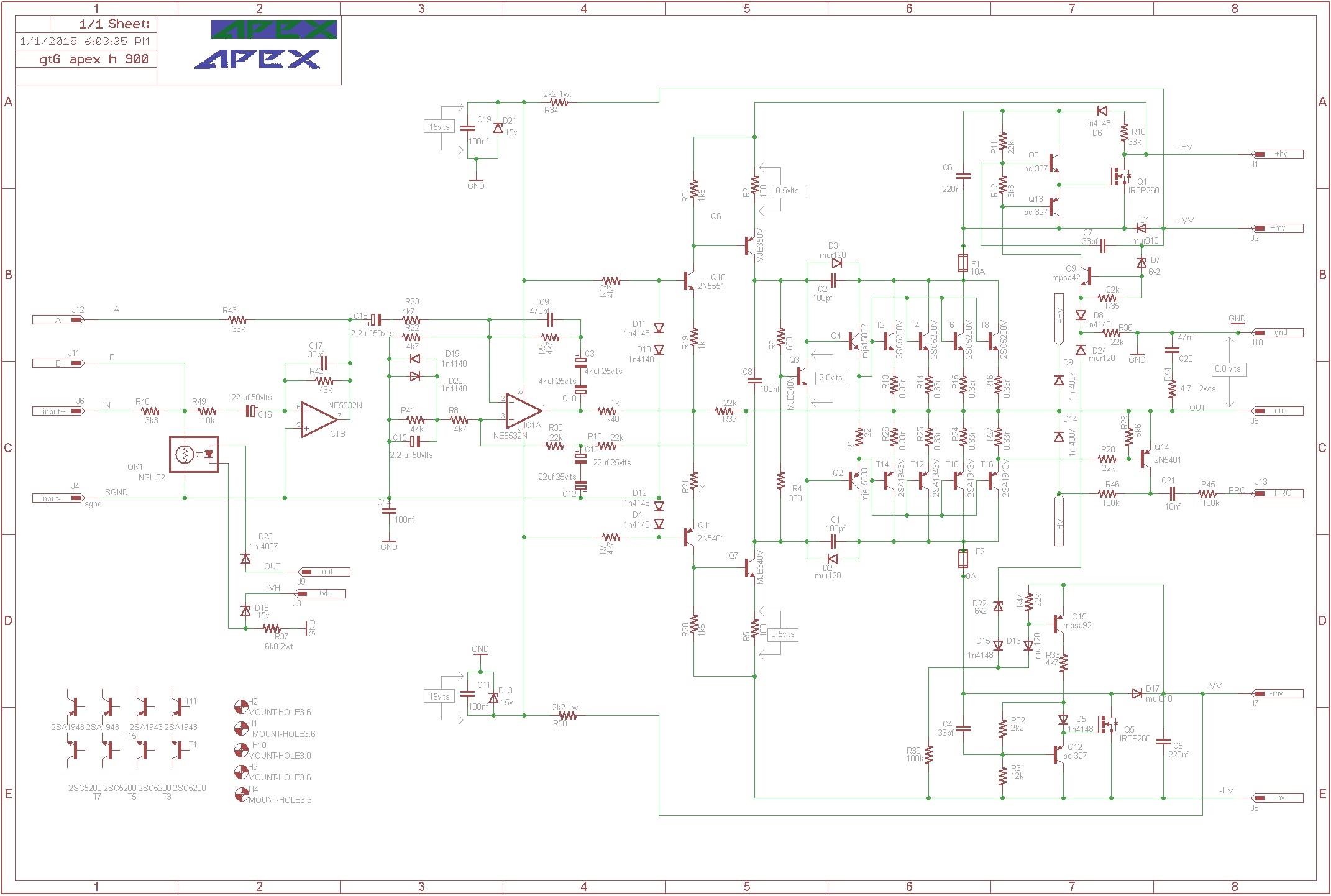

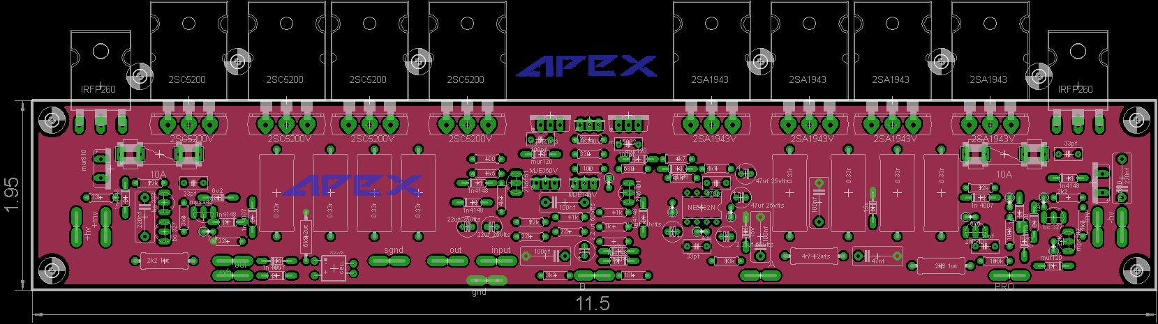

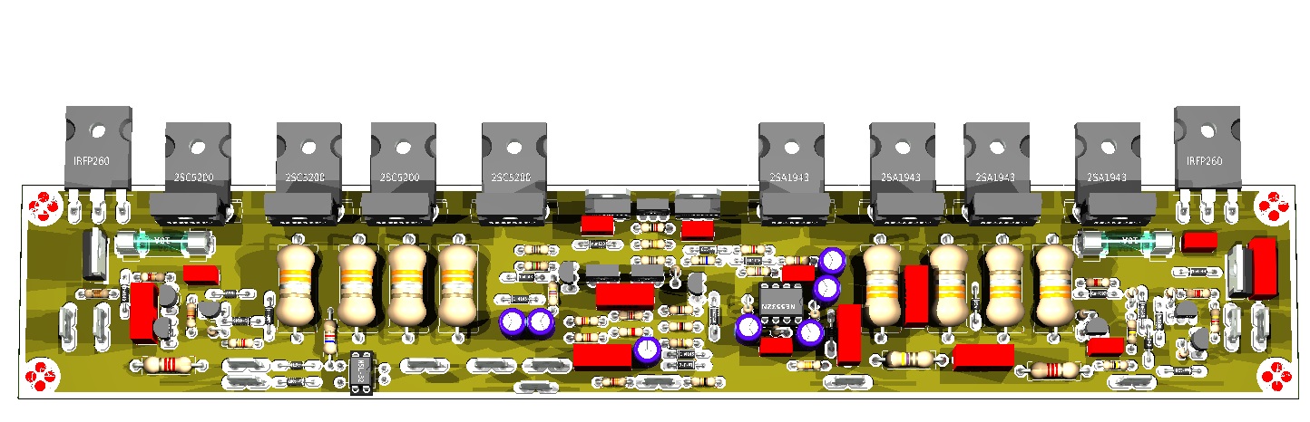

900W H-class PA Amp with Limiter
hi all my layout of apex h with transitor drive please check and add comments or compliments
  • gtG apex h 900 schematic.pdf
