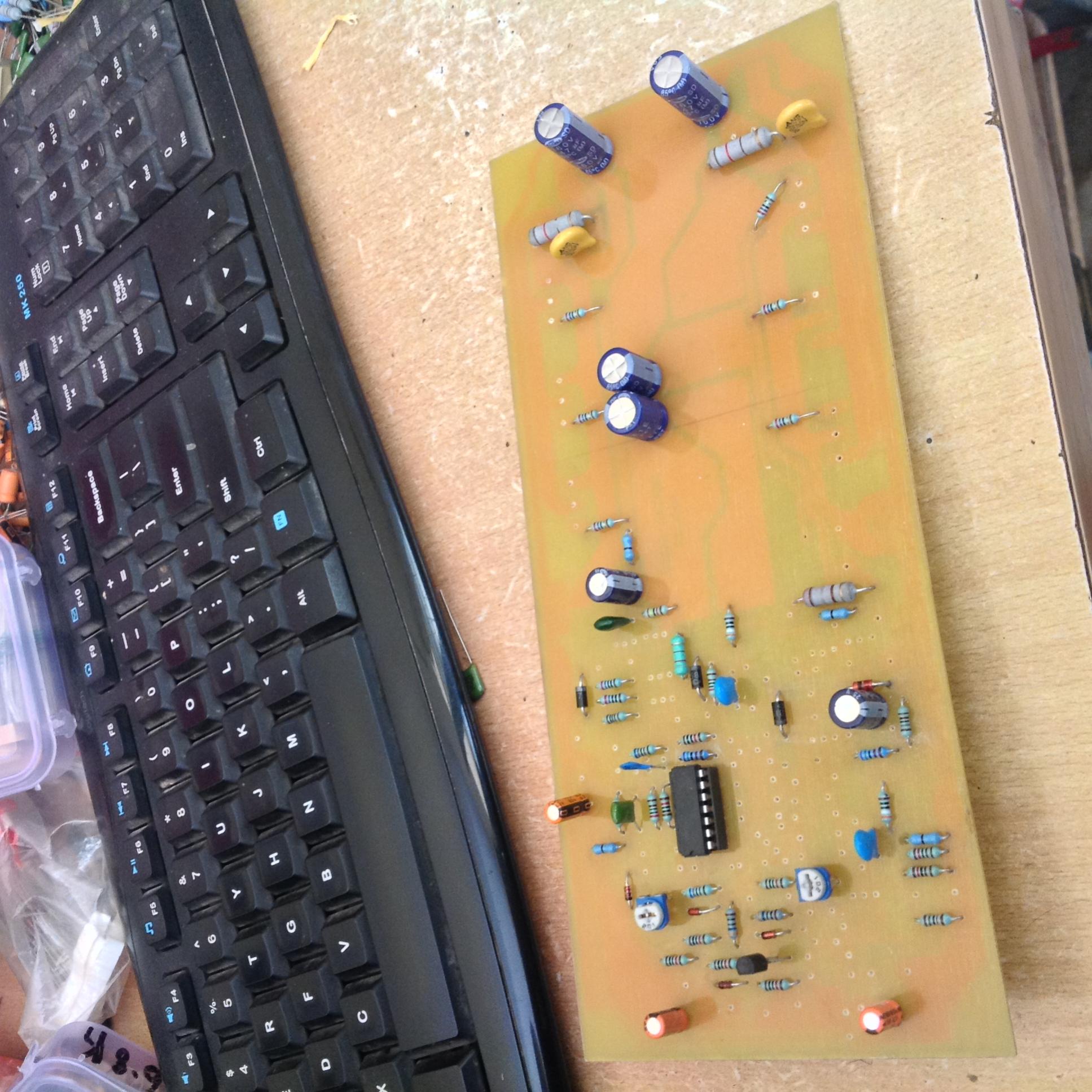

900W H-class PA Amp with Limiter

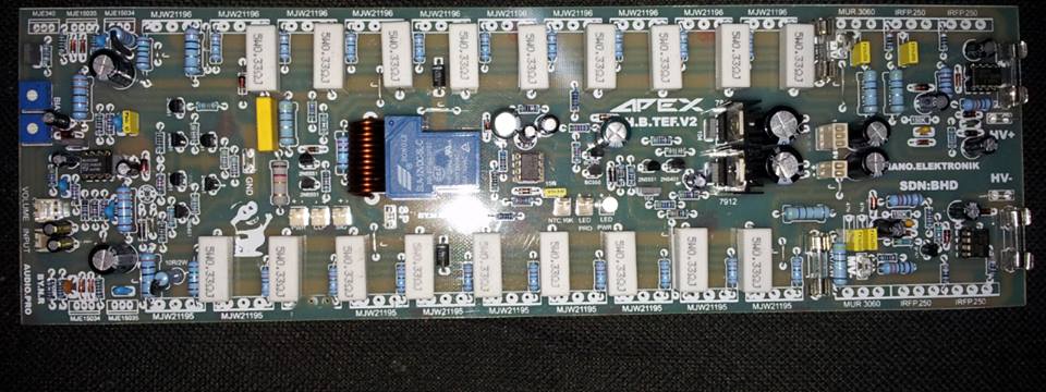

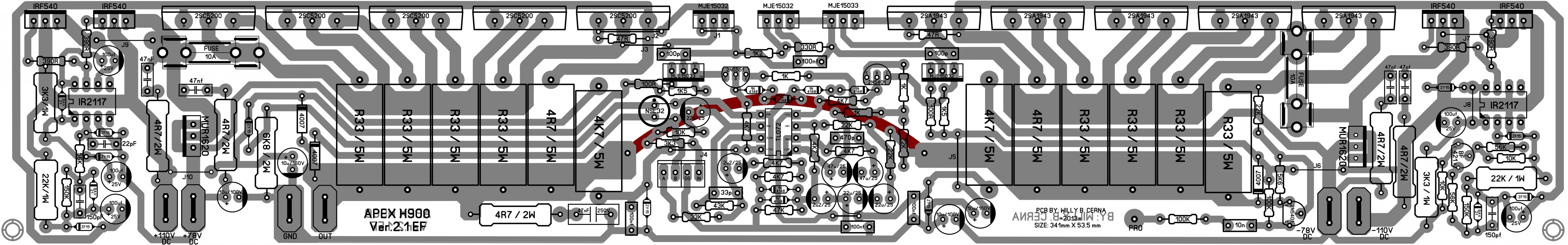

I found the difference, rail (+) v to 4k7 / 5 from 110v (HV). but rail (-) v to 4k7 / 5 w from 78v (LV) NOT FROM HV.
GREETING..
Arif SMD
Corrected files...
  • APEX H900 Ver. 2.1 EF-Gray.pdf
  • APEX H900 Ver. 2.1 EF-PCB.pdf
