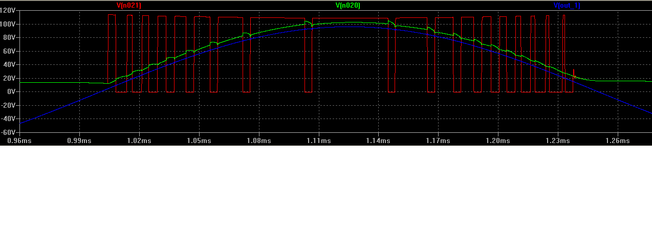

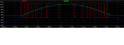

Class TD/Eeengine amplifier under simulation.
Blue trace is the output signal
Green is the supply voltage of the output devices
Red is the output of the class D output voltage.

This is new class of an amplifier? Can you share your simulation file?

Not a really new, and it was developed to get the highest possible power with the highest possible efficiency.
I will post the asc file as I will finish the planning. It's working quite good up to 5kHz only.

If it can have low enough distortion, may be less than 0,1%, never mind it can only work up to 5kHz. It can be use sub-woofer amp.
The share of high-frequency components in the real signal is small, so the envelope is formed mainly low and middle frequencies. High frequencies are well practiced G-class tracker, which is an ancillary element.

It gives about 1200W/4ohm with about 0.009% distortion, using +/-120V supply voltage.
Of course this is just a simulation, but I plan to build some...

The HF drivers need not too much power, so we can use class AB, of modulated rail class H for the HF.

Is the principle of power supply modulation like class AA amplifier from technics?

I don't think. The amp did same performance with modulated rail class H, but using about 12 pairs output devices.
