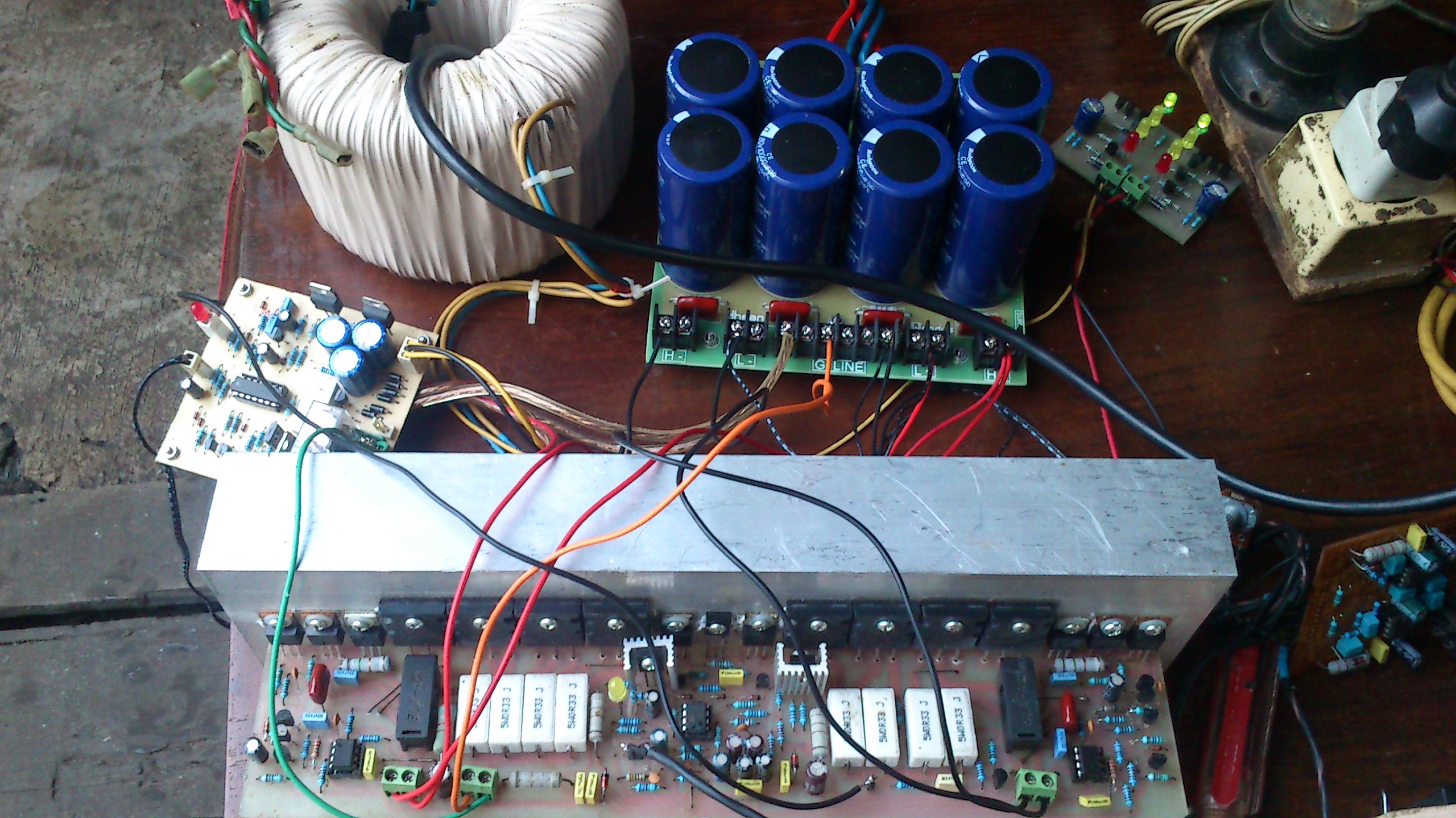

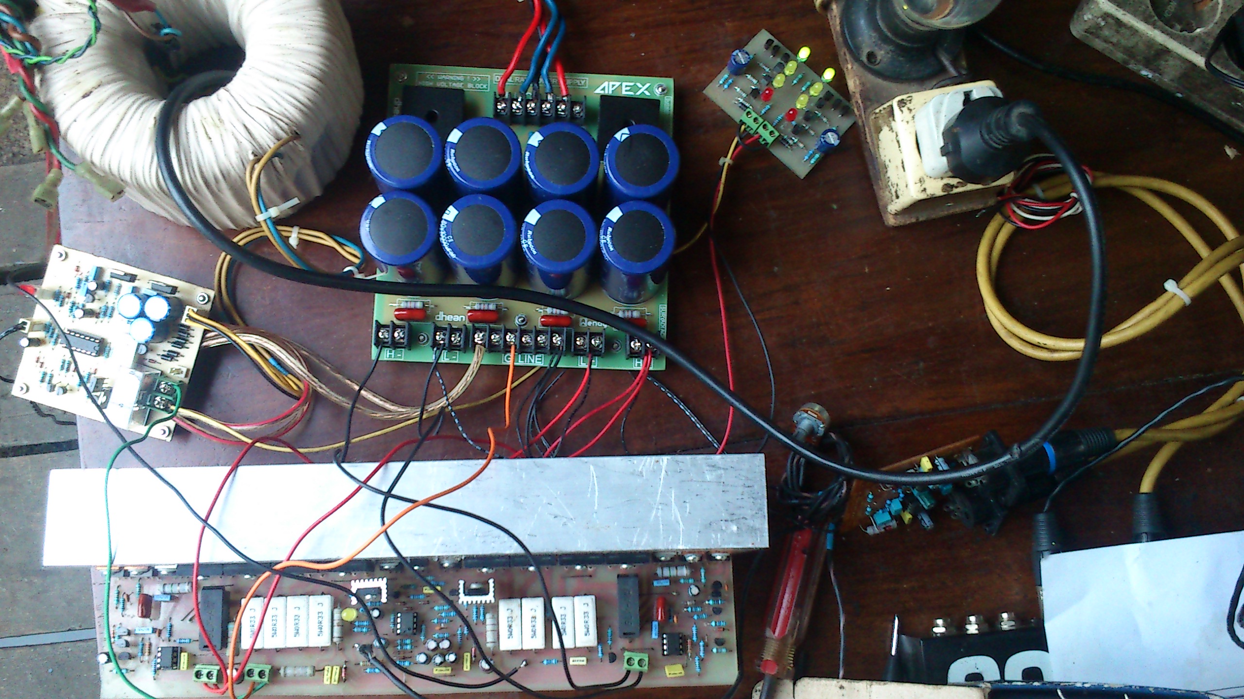

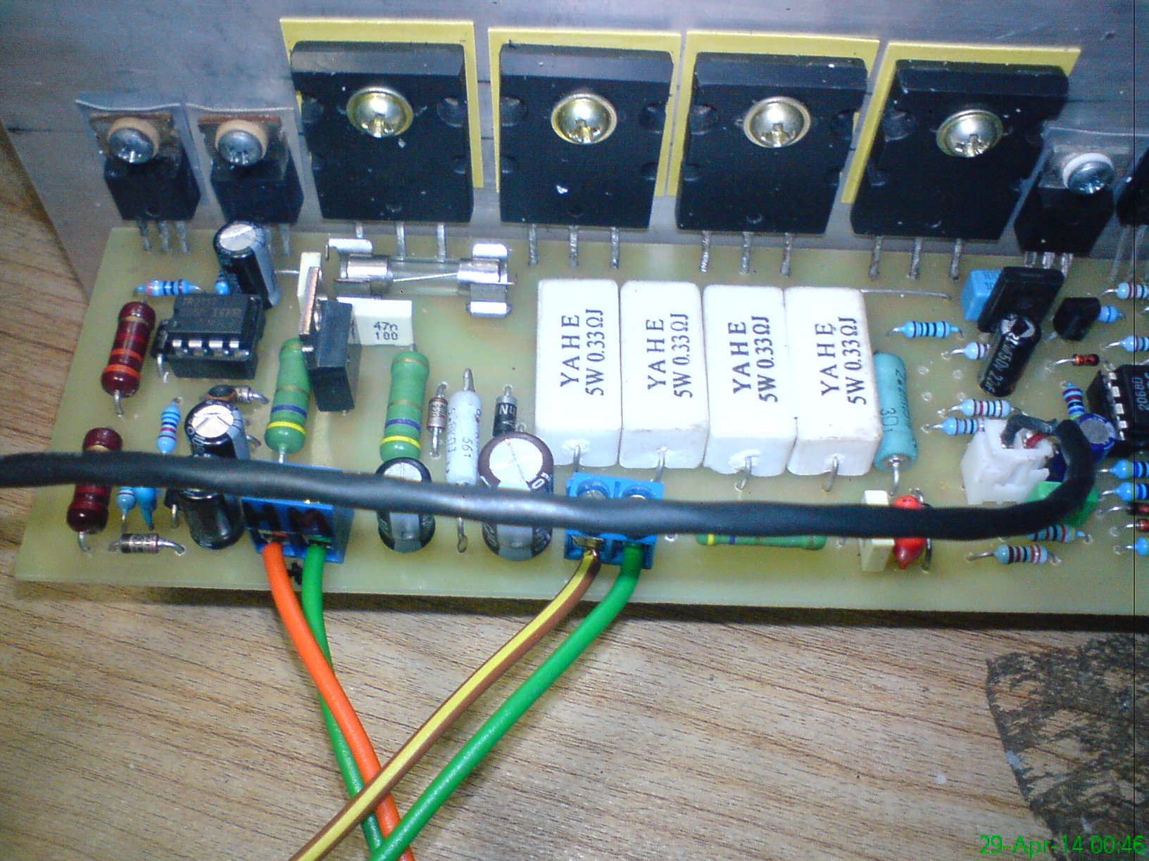

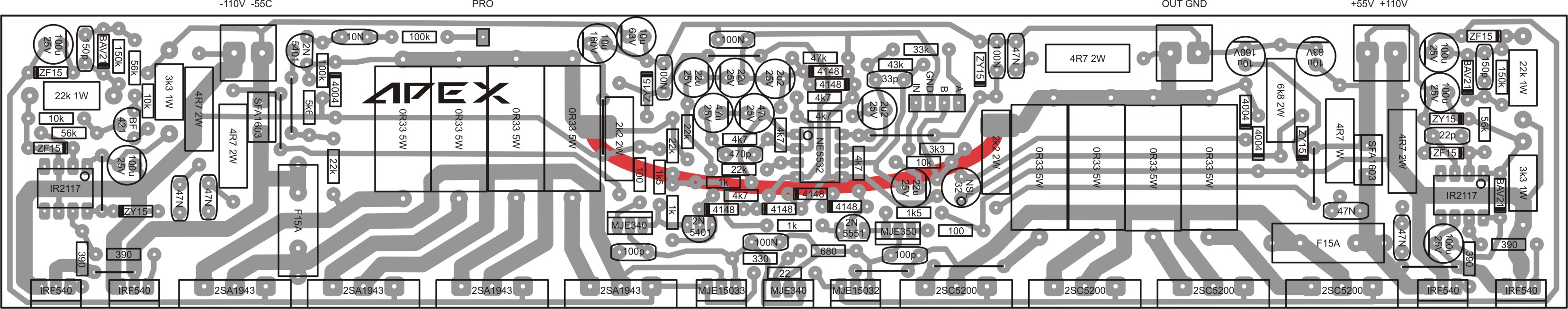

Hello sir Mile!
I need a little help!

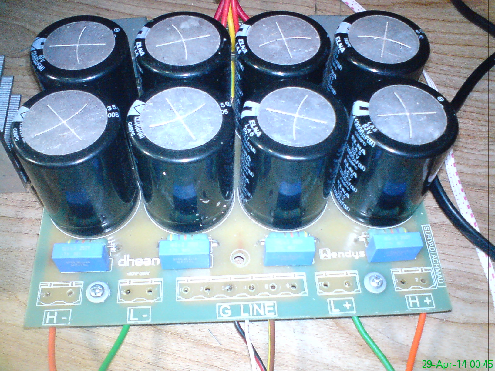

I just finish my Apex H900 but i have a problem,i use a 4kw smps power supply with +/-110V and +/-55V
I put sinusoidal signal on input and when the steppers make a switch from low to hi the sinusoidal form have some spikes (at 32-33Vrms on output)and on square signal if i put up from to 1Khz the the square from goes like triangle...
Please tell me what i must change or what is the problem
Best regards!
Ciprian
Spikes problem
Hello again mister Mile!
I receive an oscilloscope and i test my Apex H900.
My power supply is a 4kw SMPS with +/-110V and +/-55V
All is fine before the steppers make the switch from low to hi
I put sinusoidal wave form on input and on 32-33Vrms on output appear some spikes :(
On square signal after 1khz the square form takes a triangle form
Please tell me what could be the problem or where i must make changes?
Thank you!
Thank you!
how much dc offset without input sinyal?
and im not see caps 100n between input ground and supply ground.
sure,all components are in good position (diodes,transistors and capacitors)
The amplifier sounds ok on speakers (i didn't put volume until 32-33 Vrms on speakers) but oscilloscope say the truth
I use 8 ohms dummy resistors for load and i let him at 40-45 Vrms on output and no component getting to hot,the temperature is ok
Some one tell me to change the zener ZF15V from bases of 2sc5200 and 2sa1943 and try with PL12Z zener and PL18Z zener to see what is happens
Another thing,if i shortcut the source with drain from mosfet's ,amplifiers working great but then i have only Class AB :(
In my case the step up translation is not working well that is clear...
