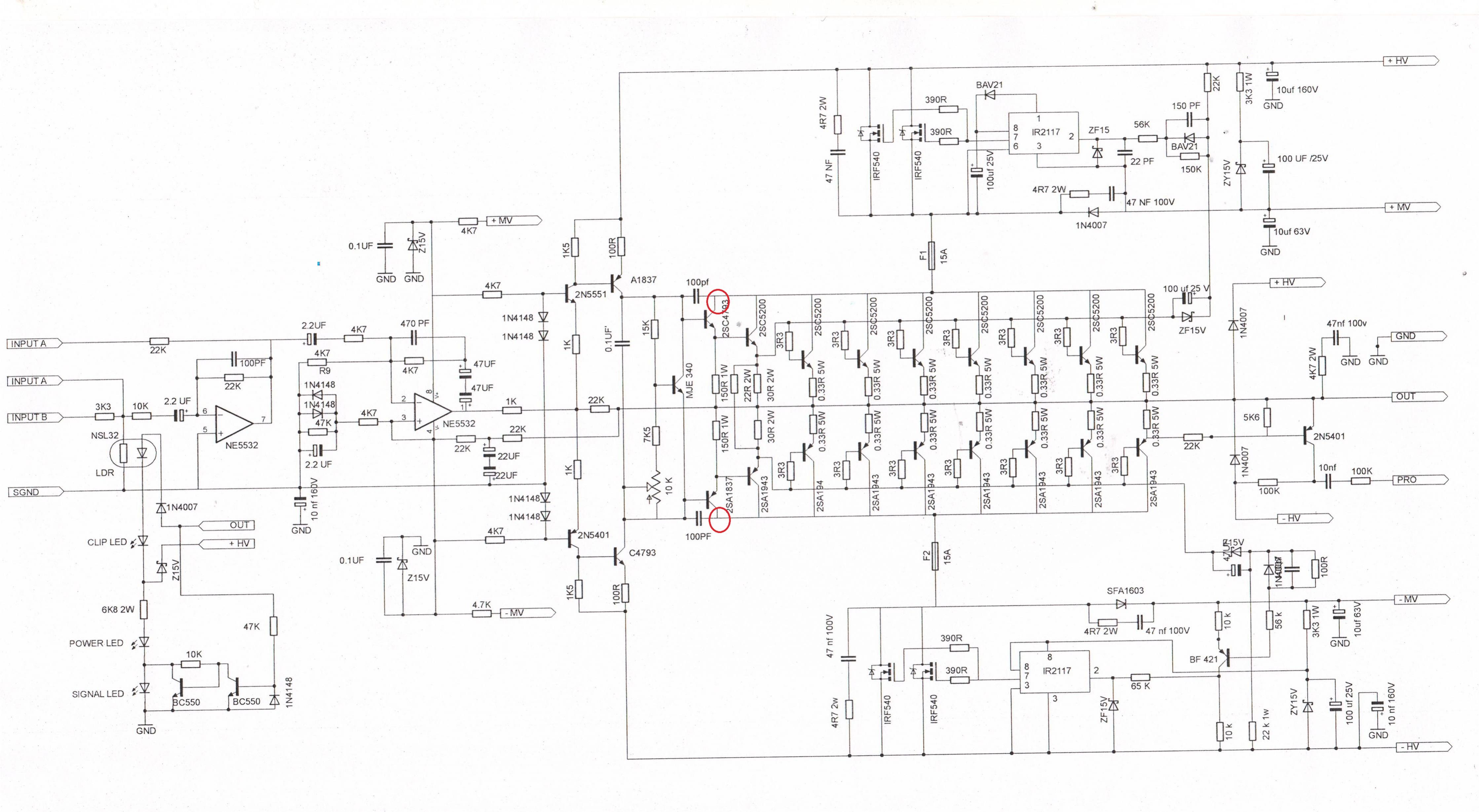

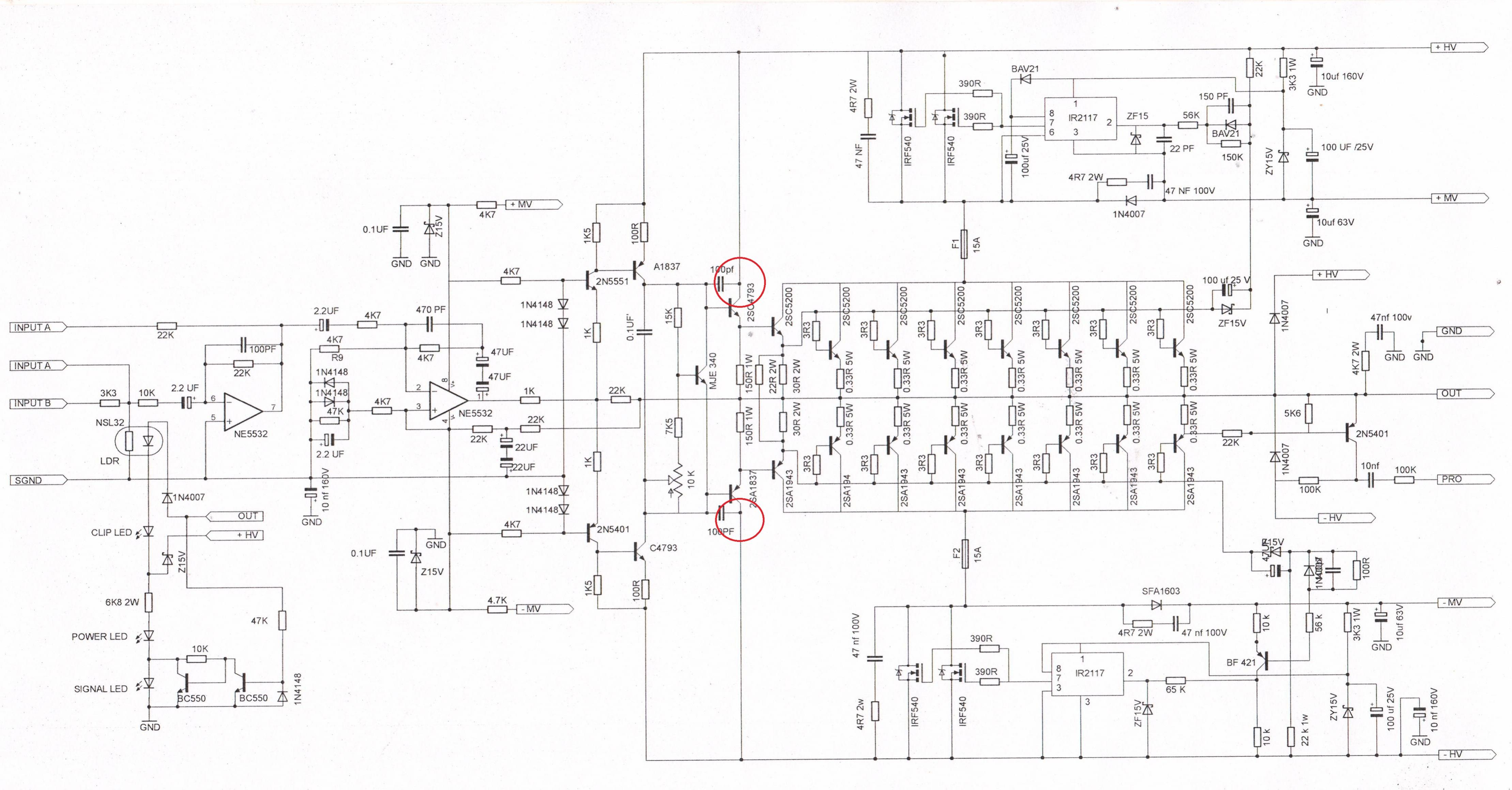

Hello Mr. Mile... and others who is willing to help & clarify about which among these two schematics is correct. The specific question is the connection of driver C4793 & A1837 collector pin which will be the proper way to connect. Is it connected to +-HV or to +-MV. What will be the difference between these two connection if they are both correct. Hope this can be clarified so i can proceed with this project.
Many thanks & Regards

Proper connection of driver collector is to step rail.
Regards

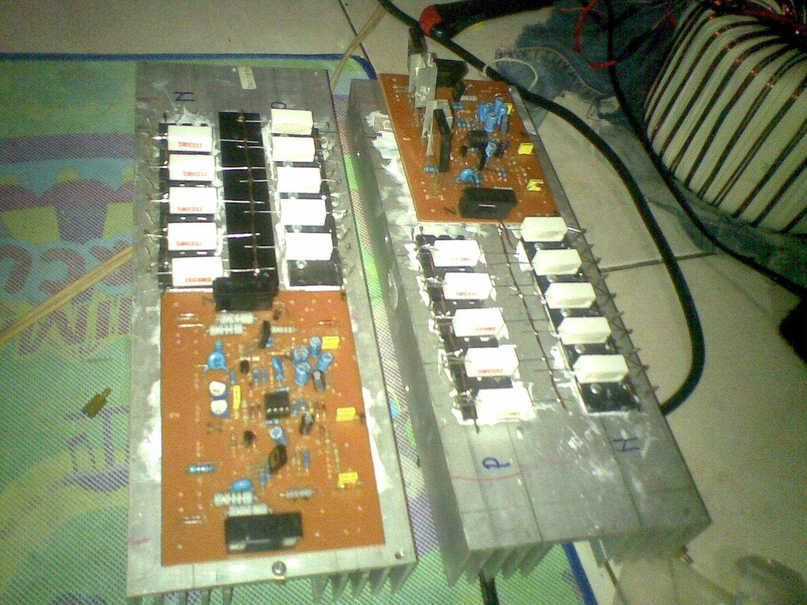

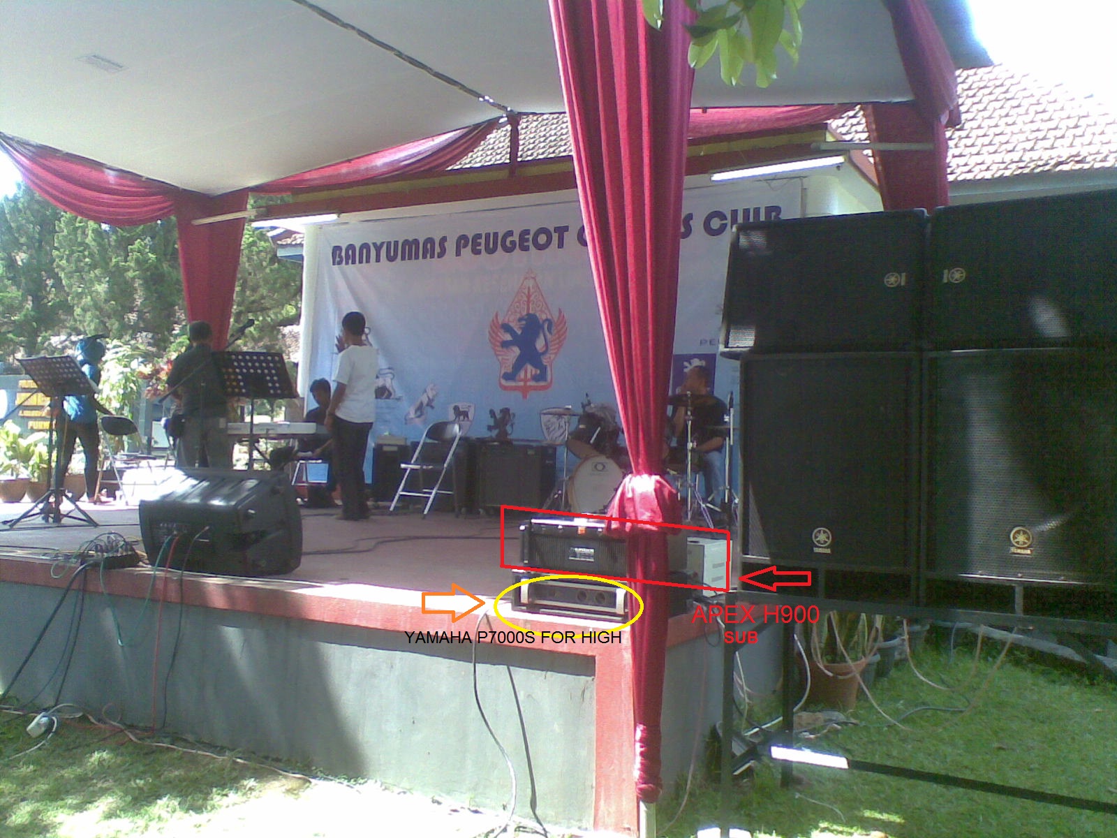

I wanted to ask to Mr.Mile or the other could answer, even fellow DIYer may experience the same thing with this problem, .. why the H900 standard when playing a kick drum, bass disappears (PA as SUB) ... the 4R or 8R load. but if for a bass guitar no problem, voltage regulator 45ac-90ac-ct ... 4kva. and I do not use nsl 32. where is that must be repaired or is there any other damage?
sorry my bad english
thanks and regards
