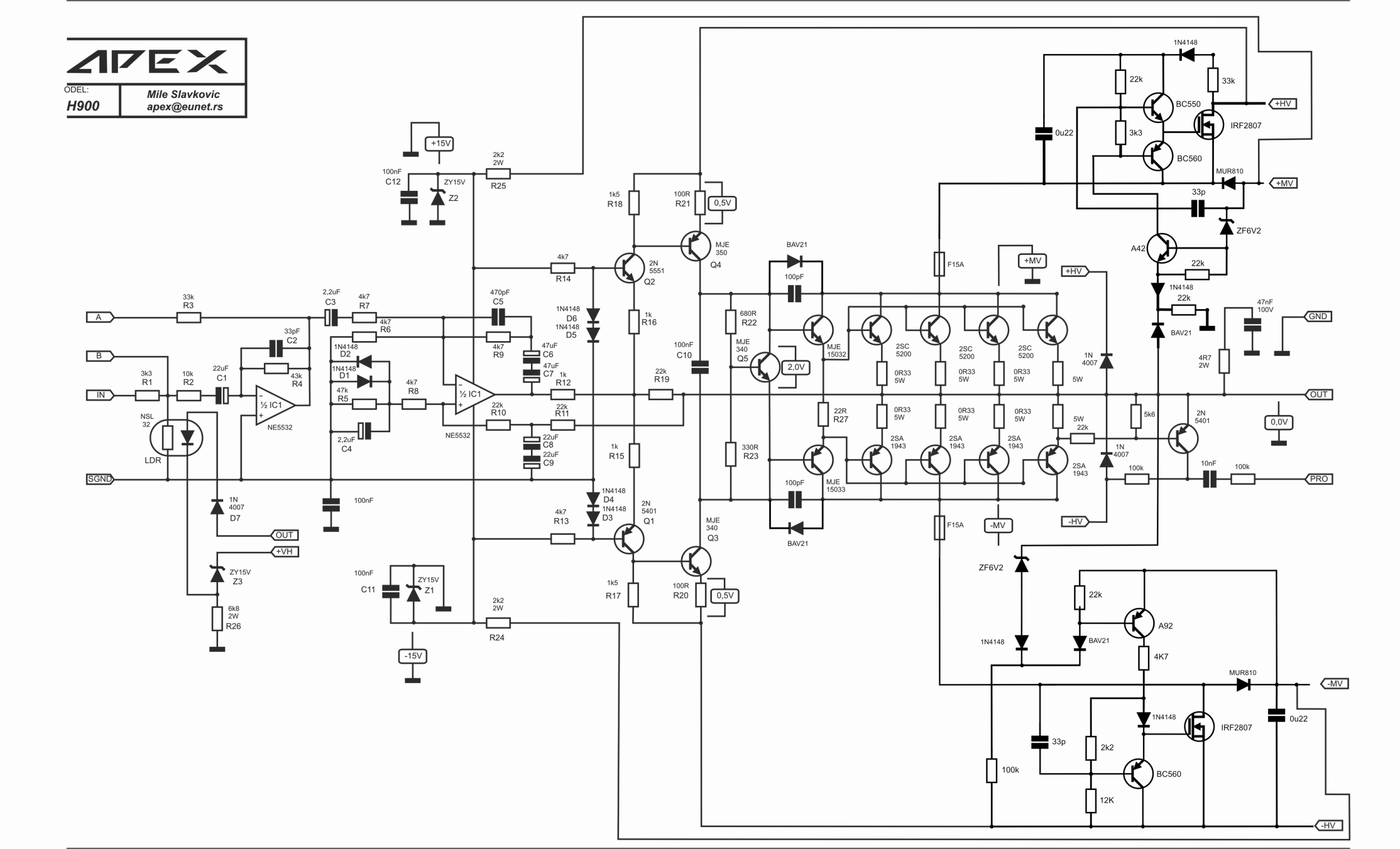

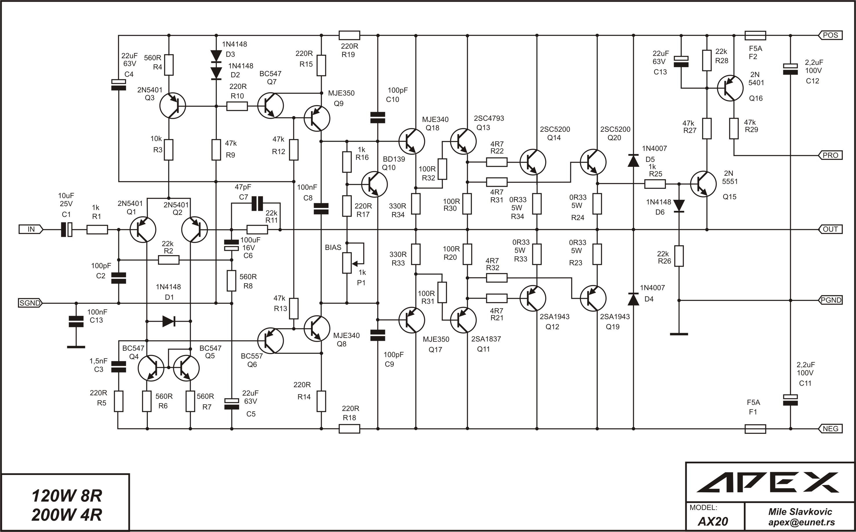

1:is it H class this amplifier H-900?
2: if it is (H class) why entrance voltage is not set step step?
3:Or section ir2117 of the voltage regulator to operate a simulated class H?
Which of these would you be doing?(H-900)
no value mentioned.

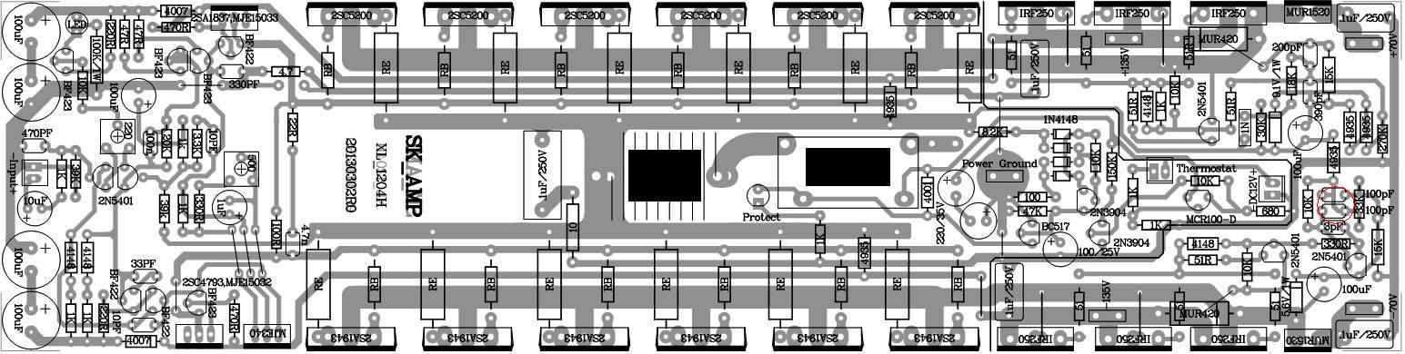

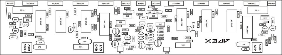

Thanks Andrew for posting component layout, 2 nos. component value is missing marked in red circle, Please post Schematic & p.c.b layout for benifit of of all Diyer's and those 2 component value.
