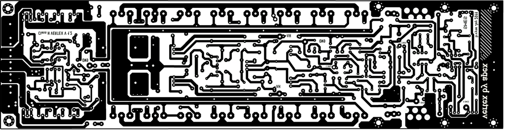

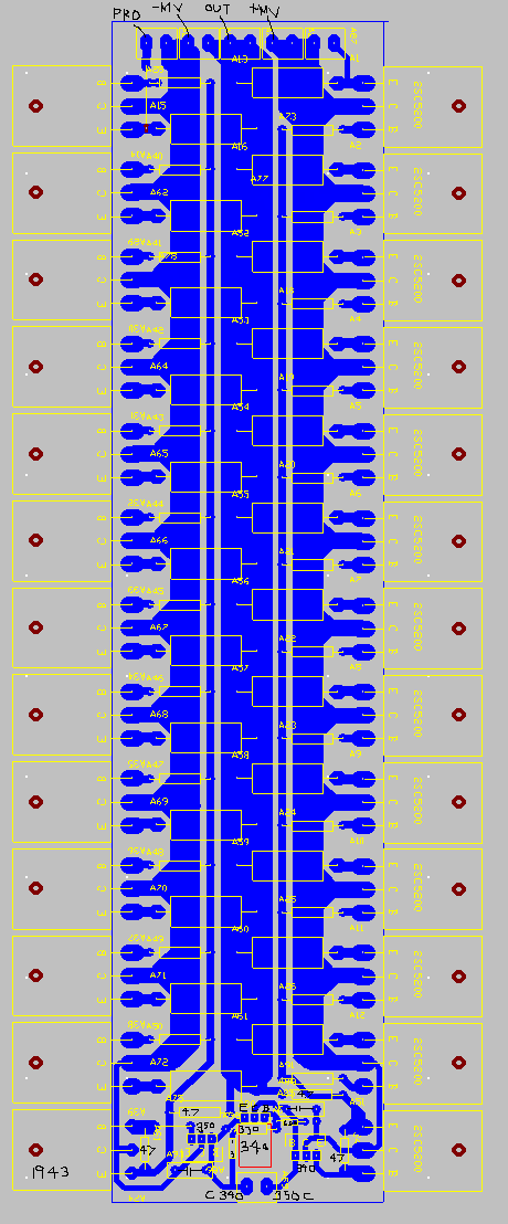

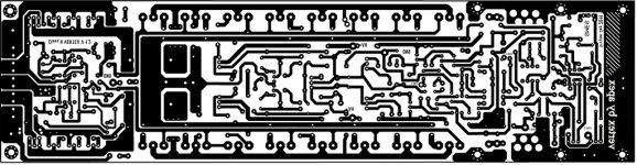

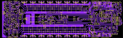

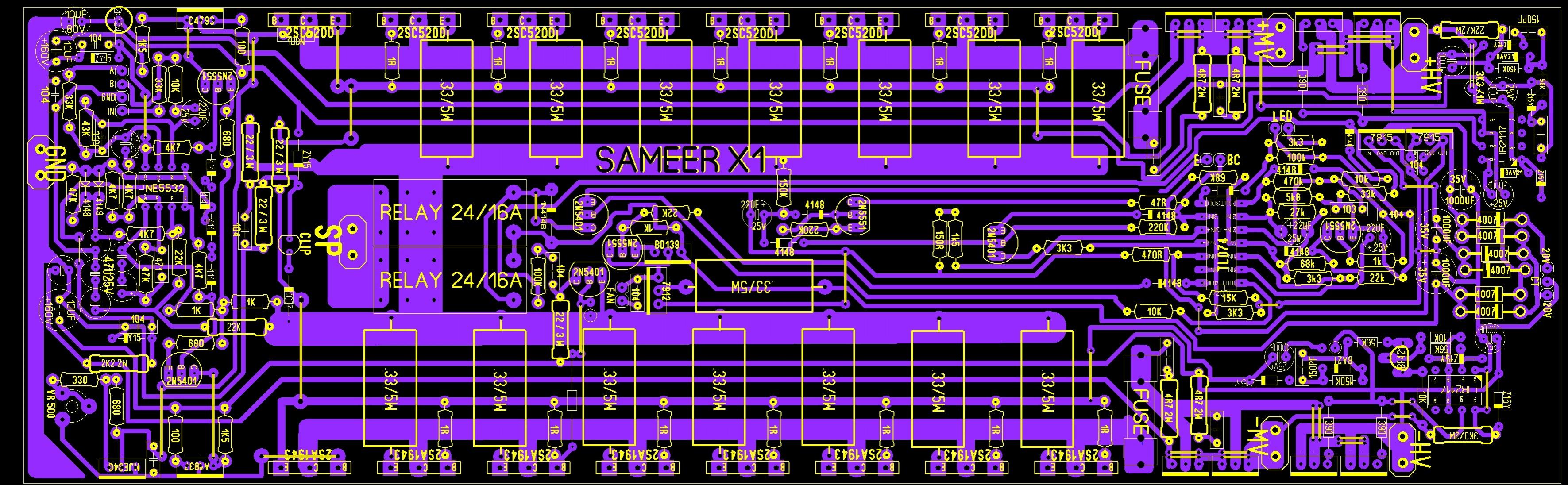

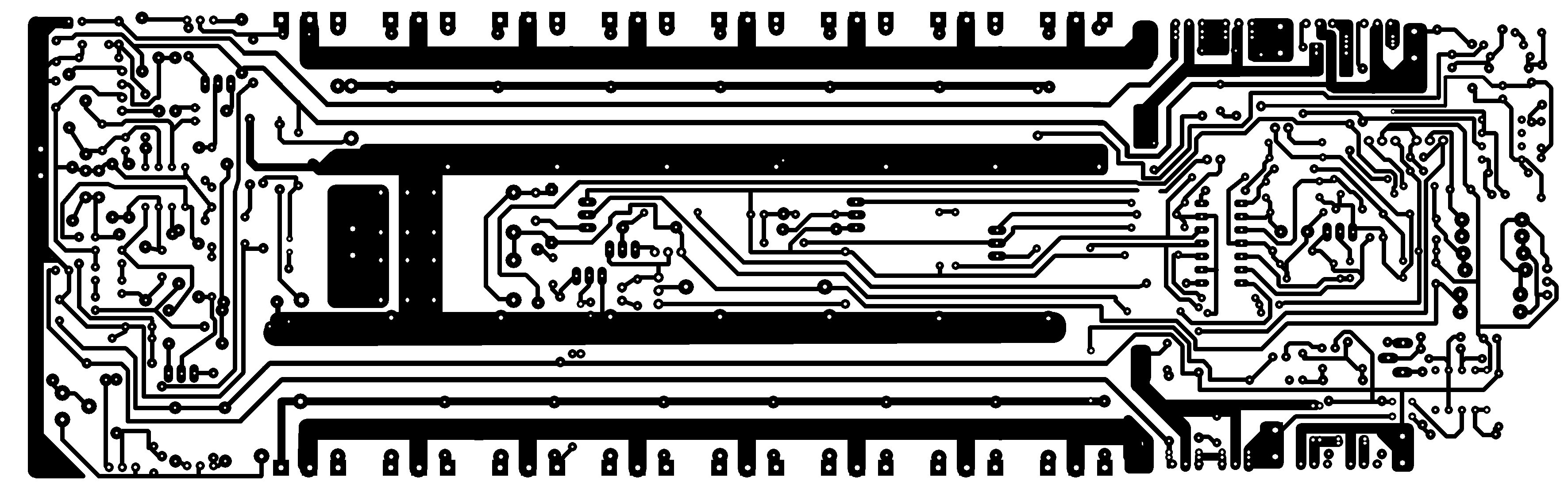

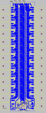

hello all diy people
for us all,all interested to 3EF h900
hope somebody help this time
this will surely work,sir irvynjay lay out of ir step + this output pair and + sameer driver pcb
just please....please somebody help this time

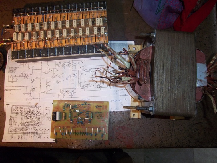

TEF?
Hi Engel dela pena
greetings here it is send e mail i send you one of chestaps special amp TEF
warm regards
andrew lebon

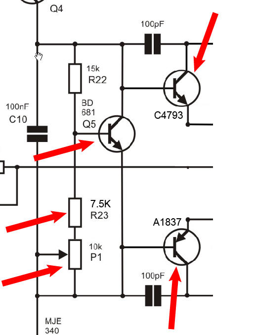

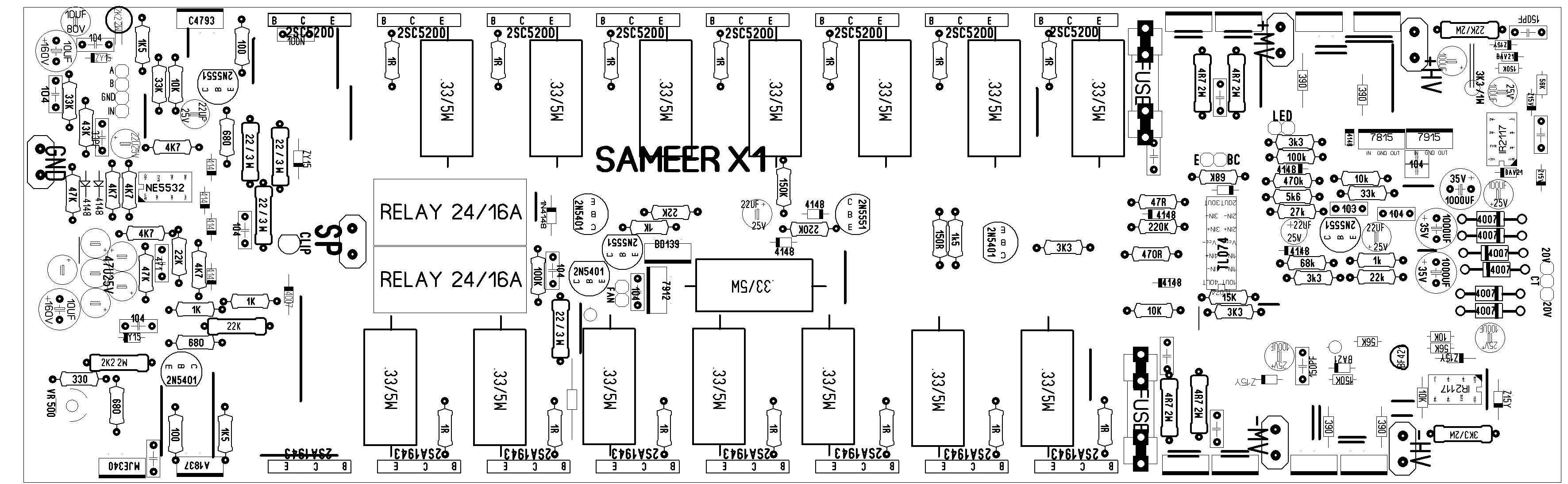

is this 3ef???
where is pair of predrive 340/350?
i thing this is H900 7pair output with pair of 4793/1837 as predive instead 340/350 and pair of 5200/1943 as driver instead 15032/15033.
or i"m wrong???
sory my bad english...
