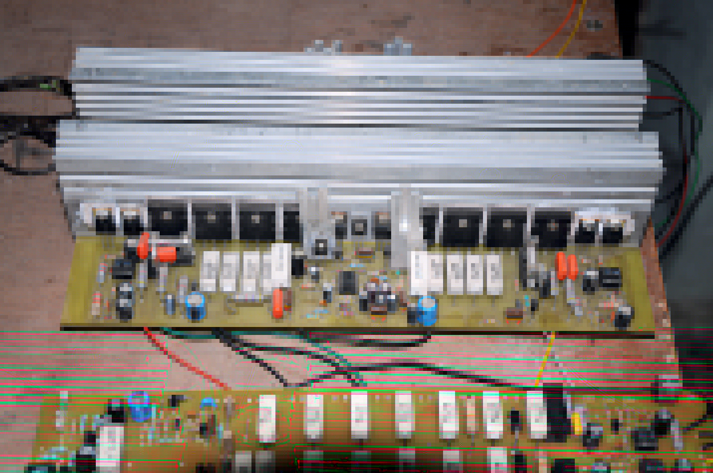

Sir mile, My H900 takes too much time to get normal. i mean when i power up amp and protect it makes loud hum for a second and then calm.
is there any problem?

I want to ask how much power can i get from H900 if i use toroidal transformer with specifications like this - 2x55V AC ; 1000VA

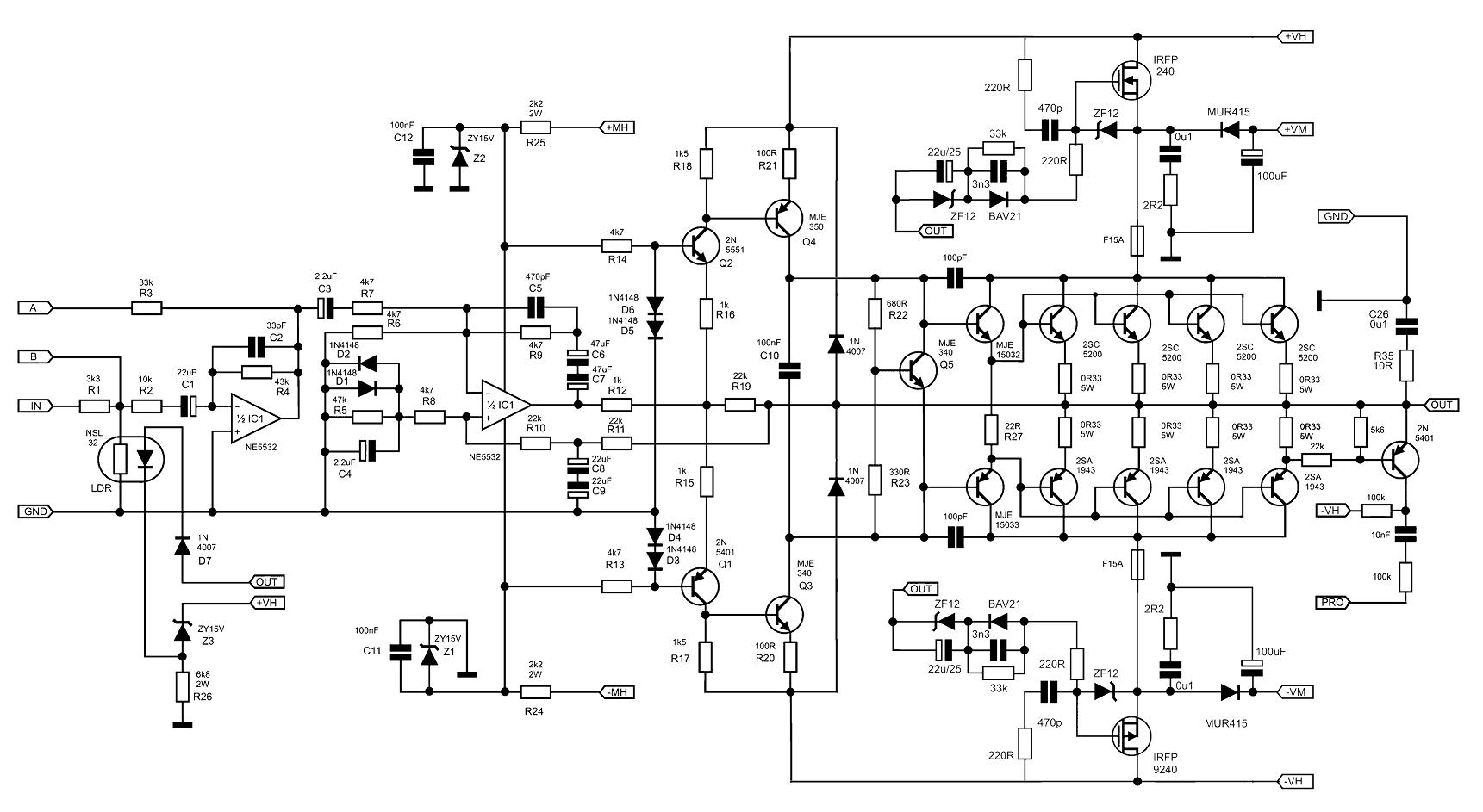

H900 work in class H and need 4x40V AC, use your transformer for B500.
is this correct sir?
psu is 120-60-0-60-120 dc
i add h200 step driver for h900,
any change or replacement for this schema?
Step driver from H200 can be use for H900 but with 4 pairs of IRFP140/IRFP9140.
Step driver
can i add 2pair of IRFP250?Step driver from H200 can be use for H900 but with 4 pairs of IRFP140/IRFP9140.
Use 4 pairs IRFP140/IRFP9140 in step driver for 4 pairs of outputs 2SA1943/2SC5200.
Can i use IRF2807 for this sch
ga bs kang...,you must add MOS N&P channel in this step driver...Can i use IRF2807 for this sch
