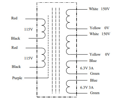

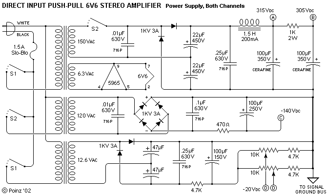

If I was to try the music machine with the power supply shown here:
would this transformer work for the B+ and heaters:
Outputs 4x
Power 100VA
Output Voltage Current
150V 0.33A
150V 0.33A
6.3V 3A
6.3V 3A
with the 150v output paralleled
and this for the -140 and 12.6 supply:
120V 0.2A
6.3V 2A
6.3V 2A
with the 6.3V in series

Are you looking at Antek transformers?
You don't have to use a voltage doubler. I think Poinz did that because he wanted to use a cheap transformer he happened to have.
To get roughly +300V DC you can use a 460VCT (230-0-230) power transformer, or a single 230VAC secondary with a full-wave diode bridge. (That's 230VAC under load.)
These numbers are all going to be approximate. You will need to adjust parts values to get the exact voltages you need from any transformer.
Your proposed 150V 100VA transformer with its two 150V secondaries in parallel will be capable of 330mA current (with a voltage doubler). That's far more than you need, which would be perfectly fine.
250V * 200mA = 50VA
A bigger than needed transformer with a light load will supply higher than expected voltages, but you can compensate for that in various ways. It's much more difficult to squeeze higher voltage out of a transformer than what it was designed for than it is to burn off a few extra volts.
Antek makes a 280V 50VA (with 260V tap) rated for 200mA, with 6V secondaries.
That particular power trafo runs about 440 V no load and 360 V at full DC load (160 mA, 60 watts) with cap input filter. I would ditch the doubler, just to make life easier on the caps. Dropping voltage on a class A design is easy. Class B has to deal with the swing in applied DC voltage. The Anteks are a very good value for the money - the only real issue people have with them is they are butt-ugly compared to most other solutions. Some people put a metal can around them - often costing much or more than the transformer itself. They do have a belly band around them, eliminating the “need” for a can for shielding. But that’s part of the reason they’re not so pretty. They do run cool, so they can be internally mounted in many cases.
That’s a full wave doubler and won’t result in DC in the core. It does result in 60 Hz ripple rather than 120 and much poorer power factor compared to a 4 diode bridge. But the secondaries can be wired in series so it’s not needed. You CAN use two caps like with a doubler if the connection between them is connected to center tap. That lets you use two 250 volt caps.

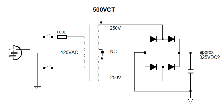

Since we're on the subject, and I haven't found a direct answer to the question, what happens when you take a transformer with a center-tapped secondary and rectify it with a full-wave bridge, leaving the center tap disconnected? (This is with the negative-going diodes grounded -- not a bi-polar supply.) Do you get a higher rectified voltage from it, or just the same DC voltage out but with slightly more current capacity?

But what is the value (in DC volts) of B+?
If the secondary is 500VCT, and you put a full-wave bridge as shown in the schematic attached to my previous post (across the entire secondary with negative output grounded), then is the positive DC output 500VAC * 1.414, or is it 250VAC * 1.414?
(I suspect it is 250VAC * 1.414, just like the full-wave rectified secondary with grounded center tap, but without the copper and iron losses of the transformer -- but I don't understand why that is so.)
That’s a classic 4 diode bridge, the most efficient kind of rectifier aside from the 3 phase version. If you only use “half” of it, with the negative pair not used, and ground from the center tap (like a classical full wave vacuum rectifier) you only get 70% of the transformer’s capacity compared to the 4 diode bridge. RMS current goes up by another factor of the square root of two. Think about it - only half the secondary is connected at any given point in time - so half of it is contributing nothing at all times.

Differences between Full Wave Bridge & Center Tapped Full Wave Rectifier
Using a transformer with 500VCT 200mA secondary, if you use the center tap grounded and two diodes for full wave rectification the PIV of the diodes will need to be 2 times the voltage across the secondary (so >1000V rated diodes required for the 500VCT secondary). Also, the maximum load current before the transformer saturates will be 0.693 of the transformer's full current load rating (0.2A * 0.693 = 0.139A).
Using the same transformer with 500VCT 200mA secondary, if you leave the center tap disconnected and use a four diode full wave bridge with negative end grounded, the PIV of the diodes will need to be the same as the voltage across the secondary (so >500V rated diodes required for the 500VCT secondary). Also, the maximum load current before the transformer saturates will be 0.812 of the transformer's full current load rating (0.2A * 0.812 = 0.162A).
In both cases the DC output voltage will be 2Vm/pi or 2*500V/3.14159 = 318V DC
954536d1621904937-8k-10w-pp-output-transformer-build-ct-transformer-wave-bridge-question-png
If you don't connect the center tap to ground then that is a 500VAC winding so B+ will be x1.414 in DC, hence 707VDC without load.
