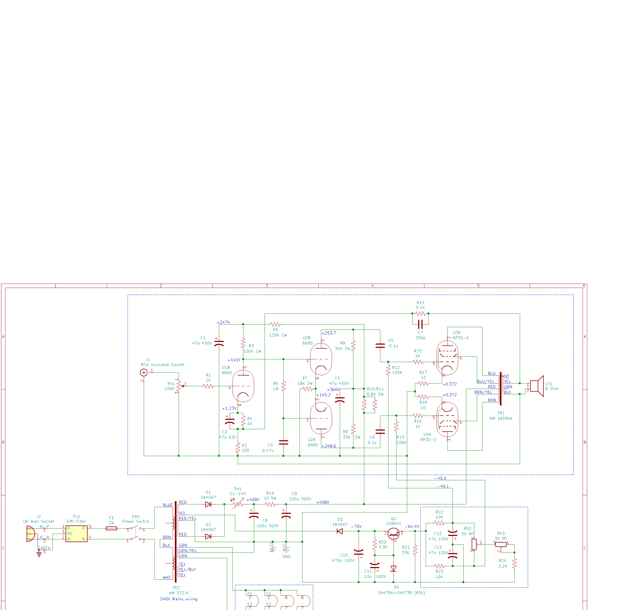

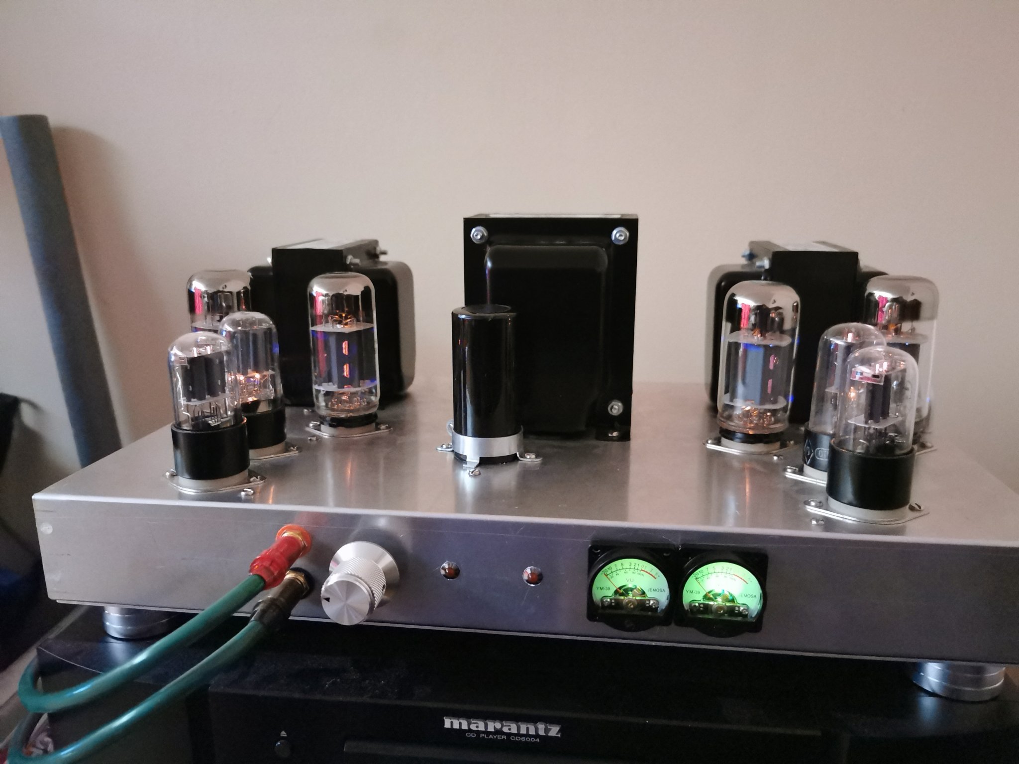

I built a variant of an Eico HF-89, fits your requiremet. It's a very classic schematic, no tricks, I get 28W average before clipping. The ouptut tubes 6P3S-E can be replaced by 6L6GC or 5881, or EL34 adjusting the bias.

The low B+ and 8K combitation is not a good recipe for high power. I did a quick simulation of my schematic, replacing the 6H9 with a 12AX7, 6H8 with a 6DJ8, B+ 380V, got 22W before clipping.
@jcalvarez I took another look at the schematic and ironically the PT specified there, 372JX, is the one I have on hand that I planned on using. (not sure if thats what you actually used).
12AX7 instead of 6H9, OK.
For the 6H8, is 12AU7 adequete? The mu seems closer to a 6SN7 than a 6DJ8.
Do you mind sharing a pic of the internals of your build?

@itsikhefez Yes, I do use the components specified in that schematic, it is up to date. I have never used a 12AU7 for LTP. There are some concerns around here about the difficulty of balancing the LTP without a CCS in the cathodes. You can try and see what happens. I did some simulations, and you may need to increase R3 to 120K to avoid grid current in the 12AU7 at maximum power. With the 6DJ8 I also get lower THD. This is the result of simulations, I have not tried either tube for real, therefore your mileage may vary.

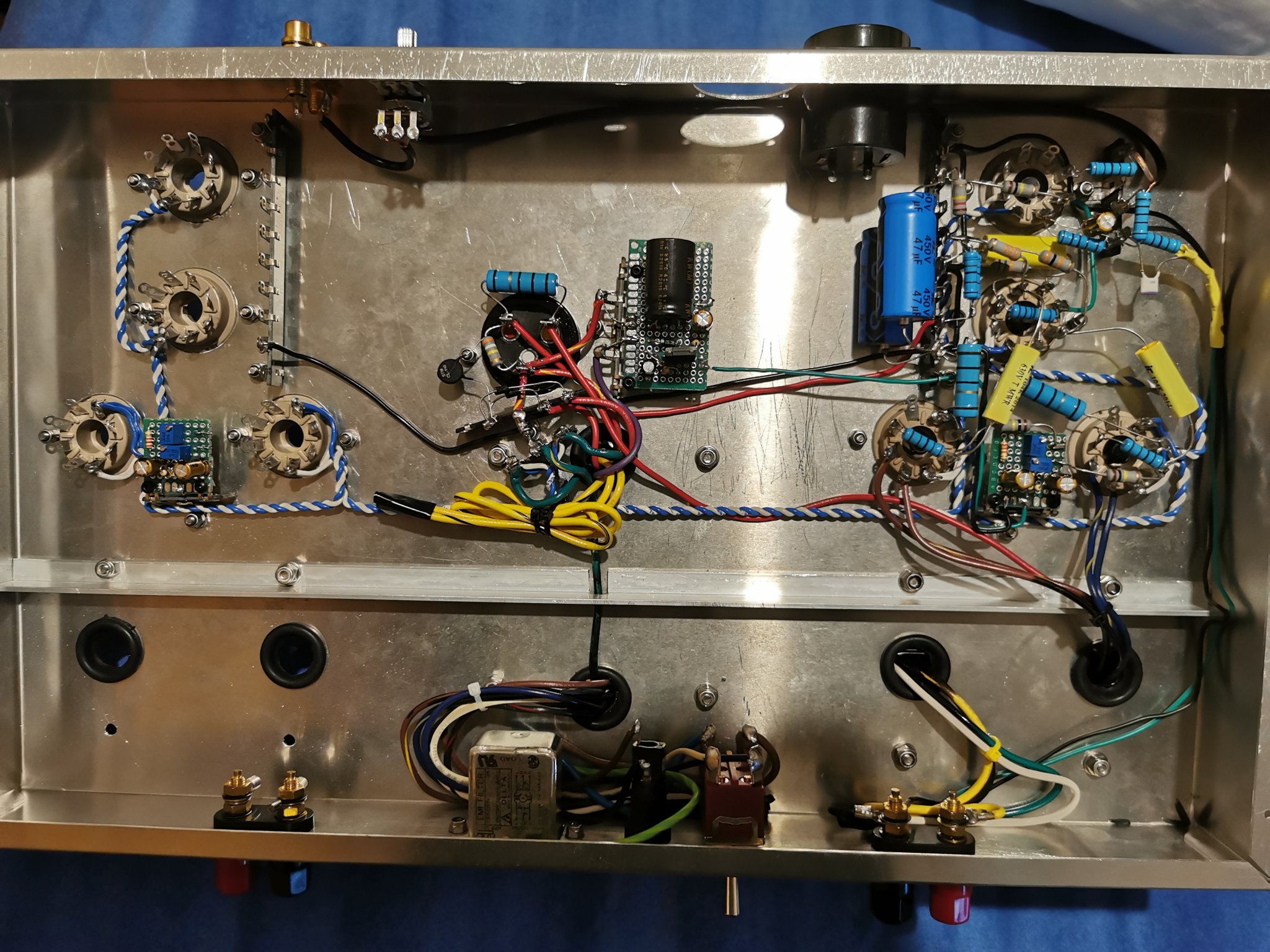

Here is a picture taken when one channel was built, I have none with both channels. Not a work of art, but it works 🙂

I do not have detailed step-by-step information about the build, here is some information:
  • Loosely follows Eico HF-89. The manual is pretty useful: https://www.audioservicemanuals.com/e/eico/eico-hf/eico-hf-89/234716-eico-hf-89-owners-manual
  • Hammond transformers: Power transformer 372JX, output transformers 1650HA (Digikey UK)
  • Hammond Aluminium Chassis 1444-30, 432 x 254 x 51mm (e-bay UK). The chassis is reinforced with an angular aluminium strip to be able to handle the transformers' weight.
  • Tubes: 4x 6P3S-E, matched quad, 2x 6H8C (matched pair), 2x 6H9C (matched pair). (in reality you only need one 6H9C, but originally I had plans to add tone control, then I decided against it, that is the reason you see two 6H9C in my build)
  • Belton octal sockets https://www.hotroxuk.com/belton-8pin-socket-vt8-st.html
  • 100+100uF 500VDC capacitor can. Chosen just for the looks, there are better options.
  • Rubber grommets for transformer cables.
  • Binding posts for speaker connection.
  • Insulated RCA input sockets.
The rest can be seen from the schematic, together with some pictures of the build in the archive here (https://drive.google.com/file/d/1iVY7IOD-ofe_KCSBb2Ul3BNMuNoIye_a/view?usp=drive_link).
I was a bit paranoid about noise from the power supply, I put both channels too far to the sides. If I would built it again I would put them a bit away from the sides. Also I would include just one 6H9C shared between channels, and of course, improve my point-to-point wiring skills 🙂.
