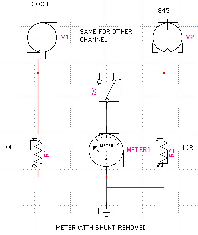

I have what is probably a very simple question. I will be using fixed bias on both the 300B and the 845. I have a nice Simpson 0-150DC mA meter which I want to use to test both tubes currents. So, what is the best way to employ one meter, and two circuits.
Is there make-before-break SPDT toggles that I can use to switch the ammeters in and out of the path to ground? I think this would be the easiest way to do this. Two switches, one for each tube. Suggestions?

...better yet, one DPDT switch. This would need to be a shorting type, no?

Not necessary to be "shorting". Remove the shunt from the meter(s) and use a low value cathode resistor in each valve equal to the shunt resistor. Then switch between them.
You could also use a different value shunt in the 300B cathodes so that the meter shows a reasonable deflection. On my OnRyoku amp I used this scheme.
BTW The degeneration caused by resistors this low is negligable.

Hmm, the shunt resistor on the ammerter is internal, so I don't think I can just pop it out. I should say, these meters are VERY nice. Retro style, easy on the eyes. If only they were illuminated.

So, if I use a switch, and have an equivalent resistance of ~10 ohms in the alternate path to ground from the cathode all would be well? I guess I just thought that if I switched the live circuit all hell would break loose when the connection was broken and then re-made resulting in bumps and thumps at the speakers....

The scheme I am suggesting is a shunt resistor in each cathode (4). That way, each cathode never switches away from its ground path.
When you choose a cathode resistor, make sure it's a type that can't go open circut, or bypass it with a diode or 2 to protect the meter under valve fault condition. The value will be close to 10 ohms, as you say. Probably it's best to buy 10 ohm resitors and add some "fudge" components to tweak.

The cathode is ALWAYS sourced to ground through a dedicated hard line. Additiontally, there are two shunts to this line, switchable between the meter and an equivalent resistance (of the meter) to ground?

There are two resistors inside the case of the meter. Onoe is the shunt, and connects directly between the input and the putput of the meter, while a second resistor goes from the positive terminal to the movement via am insulated lead.
I assume I should just pull the shunt resistor and close her back up?
Also, with respect to the switch diagram below, can I simply use the salvaged resistor from the meter in place of R1, or will there need to be some change of resistance. It seems to me that it should be a direct drop in???
