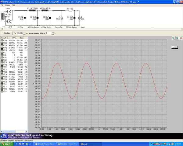

I've thought about dropping the capacitance as a means to lower the B+, and in fact one of the reasons I went with the higher VA PS tranny was to be able to go between both topologies (CCL or LC) depending on what the final opperating points needed to be.
So, with PSUD modeling it appears that I need anywhere between 0.47 and 1.5uF depending on where I want the B+ to end up.
What type of caps should I be looking for here. The max voltage spike is about 500V. I don't want to break the bank for this position, and all other caps in the PC sircuit are ASC POI.
Thoughts?

Be careful with the "partial choke input" approach. It is not necessarily the free lunch it seems.
I have used it before on a pre-amp and it can cause instability.
You have a single cap charging time determining your B+. Is this totally stable every cycle? It does not have the natural regulation of choke input.

Any good film/foil cap should be fine in that position. I have used ‘orange drops’, Solen and Wilma.
If you need >.47 a 630v Solen is a good choice…John
