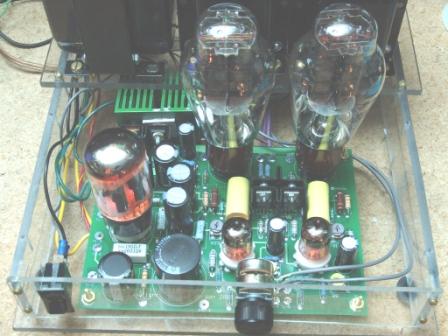

I am using the heatsink - fan cooler from a P1 chip. I run it off of about 7.5 volts. Rectified and filtered 6.3V. It makes almost no sound. I just drilled and tapped a 4-40 hole in the center of it and screwed the regulator to it. I only need the fan when running 2A3's in a closed box that has no airflow. The regulator is dissipating over 10 watts plus the heat from the rectifier.
Note the green heat sink in the picture.

Lookin Good my Friend!

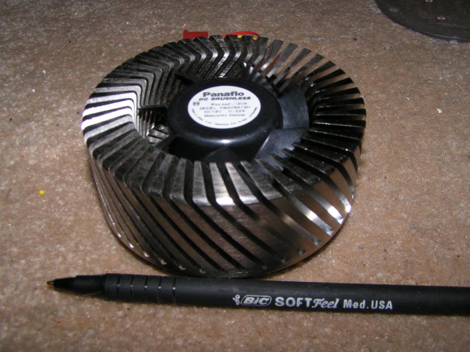

I suggested the slot 1/2/A coolers because they are the biggest that can be had dirt cheap. Some were designed not to need a fan on the unit, depending on case flow. Fan speed needed would be minimal with the better ones, some of these chips dissipated 70 watts plus. Some of the more recent large socket cpu heatsinks might be getting cheap too, I havent looked lately.
If you want something that looks really neat, these solid machined aluminum gems from old servers can often be found cheap. HP Polar Logic aka Panaflo Orb, spawned many pale imitators. Theres two holes drilled all the way through stock. This unit cost me $10.
People often run CPU fans at 7V or even 5V (values easily obtained from thier pc switchmode psus) instead of 12V to make them quieter.
Photo, this time with the heatsink not sitting on confidential documents.
