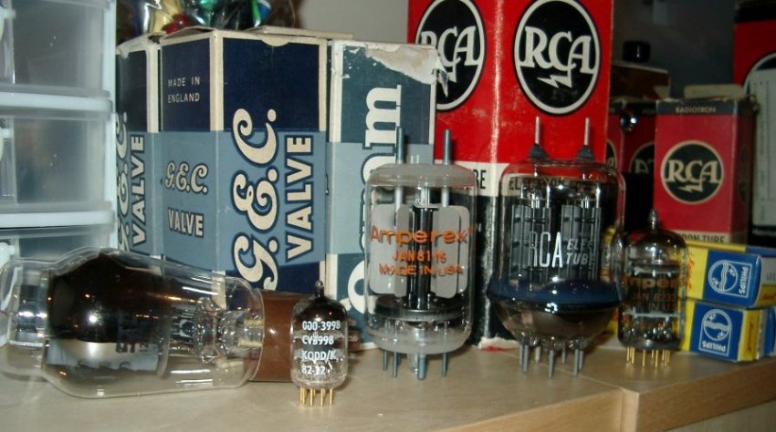

I was very happy to receive a parcel this morning, so here is a picture of some valves sitting on my very crowded chest of drawers. All of them are pentodes or beam tetrodes and were not intended for audio (not that we care 😉)- the leftmost one is a regulator pass valve, and the rest are RF types.
From the left to right we have 12E1 (35W), E180F/6688/CV3998 (3W), YL1071/8116 (60W), 829B (30W), and E55L/8233 (10W).
This is not a completely gratuitous post, the point I'm trying to make is that the 8116/YL1071 is physically very small for its rated maximum anode dissipation.The suggestion somewhere here of mounting the valve base into a computer fan guard for convection and directing some forced air at it is probably a very sound one for the YL1071/8116. As you can see, the thing is physically around half the size of 12E1 and slightly smaller than 829B - while having around twice the dissipation rating! This is one hot little valve :hot:

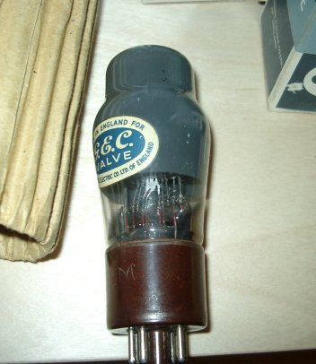

Yl 1071
Yes I think that the likes of YL 1071 would get warm. One feature I like is the fact that the heater requires on 11W - few 60W valves can match that!
However, note the finning on the anodes which would help - compare and contrast with an old-fashioned type like 12E1.

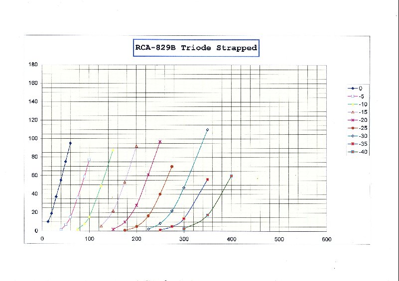

5894 is QQVO6-40; this is one of the few double beam tetrodes for which I have not prepared triode curves.
If you are intending to run these as beam tetrodes then driving them will be very easy - just download the curves from Frank's site.
If yoiu are planning to strap them as triodes, then somehow you will have to make triode curves; however they are very similar to 829B (I have tested them as triodes in the past) so in case it may be useful I have attached a set of 829B triode curves. I cannot upload Excel files so I have had to scan a set sorry about the scan quality - email me for the Excel if you wish.
Ra will be about 1k so for push-pull I would go for about 6k or so.
Many beam tetrodes/pentodes have considerabl capacitance when triode-strapped, so I suggest something that can pass a bit of current with lowish Ra: depending on the gain you require look at 12B4, 6BX7, 6BL7, 6463 and so on. ALternatively you could opt for a6SN7 cathode follower and the valve of your choice in front to get the voltage gain you need. You will need to swing in the region of 65v pk-pk.
I would not run 6-40s or 829s at more than about 35W Pa total.
