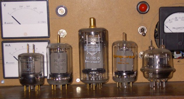

YL1071s & friends pictured
Here's a nice snap of some of our friends complete with their relatives.
Left to Right: EEV QQVO3-20 (as used in my tweeter amplifier), YL1071 branded Philips, made in U.S.A. but in a Miniwatt box!, Mullard YL1150 (France), 8116 Amperex (U.S.A.) RCA 832.
They are waiting for something to happen in front of the QQVO7-50 Dashboard amplifier.
