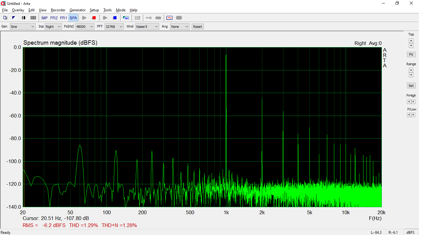

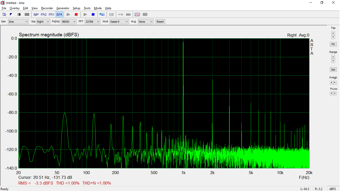

I made a few observations this morning.
For one, using a resistive load, open-loop gain of the EF37A stage seems to be optimum with around 220K, with a voltage gain of around 110. This results ~0.8% THD H2 dominant at 1W into 8ohm, similar to what is seen in the measurements of my first post. I'll try a few different loads between 200K and 300K to find the best result. In previous iterations, I was unable to generate enough gain in the pentode stage for a suitable output Z with a resistive load (without using an electrolytic bypass cap on the cathode). Now that is not a problem using the PMOS buffer and higher performing output transformers.
Next, I revisited the CCS loaded pentode and took some distortion measurements.
Here is 1W into 8ohm with a FET CCS load and 220K resistor paralleled to ground. As you can see, H2 falls dramatically. However, as observed in previous experiments, the other harmonics are reduced disproportionately and the profile becomes H3 dominant, even more significantly at lower outputs. This had a negative effect on the sound, subjectively, I'll give it another listen before I throw out the idea.
Just for kicks, here is 1W into 8ohm with a FET CCS load and 470K resistor paralleled to ground. In this iteration, open-loop voltage gain of the EF37A approaches 460 and bias drift starts to become an issue, which is something I would like to avoid dealing with.
So, despite the impressive distortion numbers of the CCS, I think the resistive load will end up being preferred, but will give it another listen to be certain.
We'll see if any improvements can be made by altering the cathode follower load, that will be next.

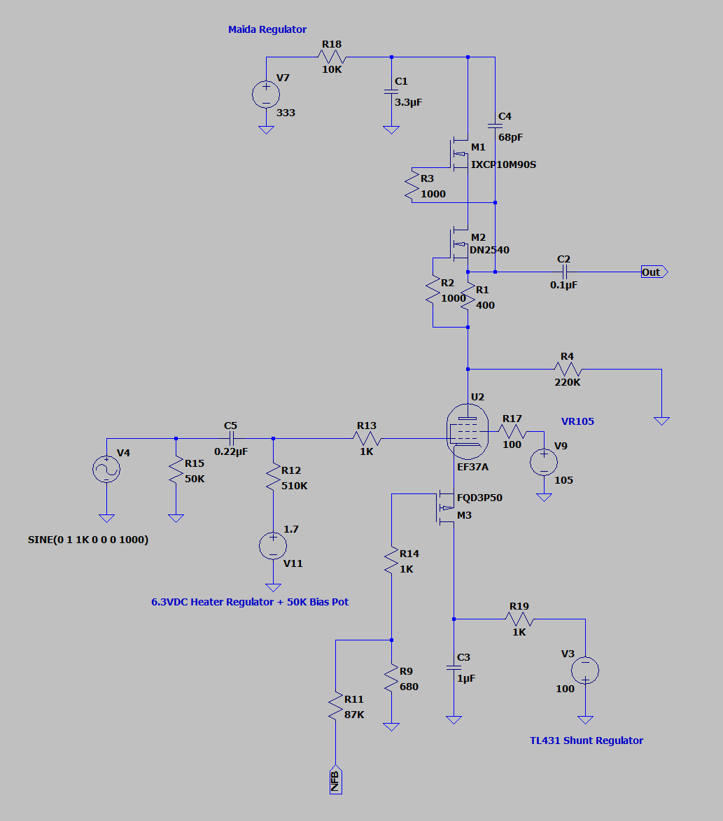

I replaced the 3.3K 6BX7 cathode follower load with IXCP10M90S / DN2540 current sink set to 28mA. I recognize this is overkill but had the boards filled already, the IXYS FET alone would work very well I think.
There were no measurable improvements in terms of distortion, but I did A-B against the resistive load and did feel the sound was improved with the current sink in place, so I will likely make the change and include it in the final circuit.
The advantage of the resistive load is the 801A is biased into cutoff by the negative supply during startup, until the 6BX7 is heated and begins to conduct. Using a CCS instead, in order to save the 801A grids from flopping in the breeze during startup, I put a relay-switched 30s time delay circuit in between the reservoir cap and the Maida regulator. The regulator has built in soft start as well, so full B+ isn't applied for 45-60s, at which point the 6BX7 is heated, the CCS is switch on with B+ application, and the 801A can come gently up to bias.
I have continued listening while doing A-B testing with 220K resistive load on the EF37A, and I must say the amplifier really does sound fantastic, trying to reconcile that with 1% THD at 1W 😛 maybe I like the sound of distortion.
Sorry, I read superficially, and I think, that CCS implemented as CF load.
If there use -large- resistor paralleled with CCS, the output tube grid has enough negative bias to shutting down while CF tubes not conducting completely, and after it biasing neatly.
It's also the safety solution, if CF tube defecting and not properly biasing output tube.

Thanks, euro 21, I'll give it a try. Any reason to be concerned about bias drift due to grid current with this high value resistor in parallel?

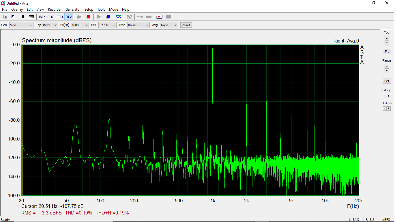

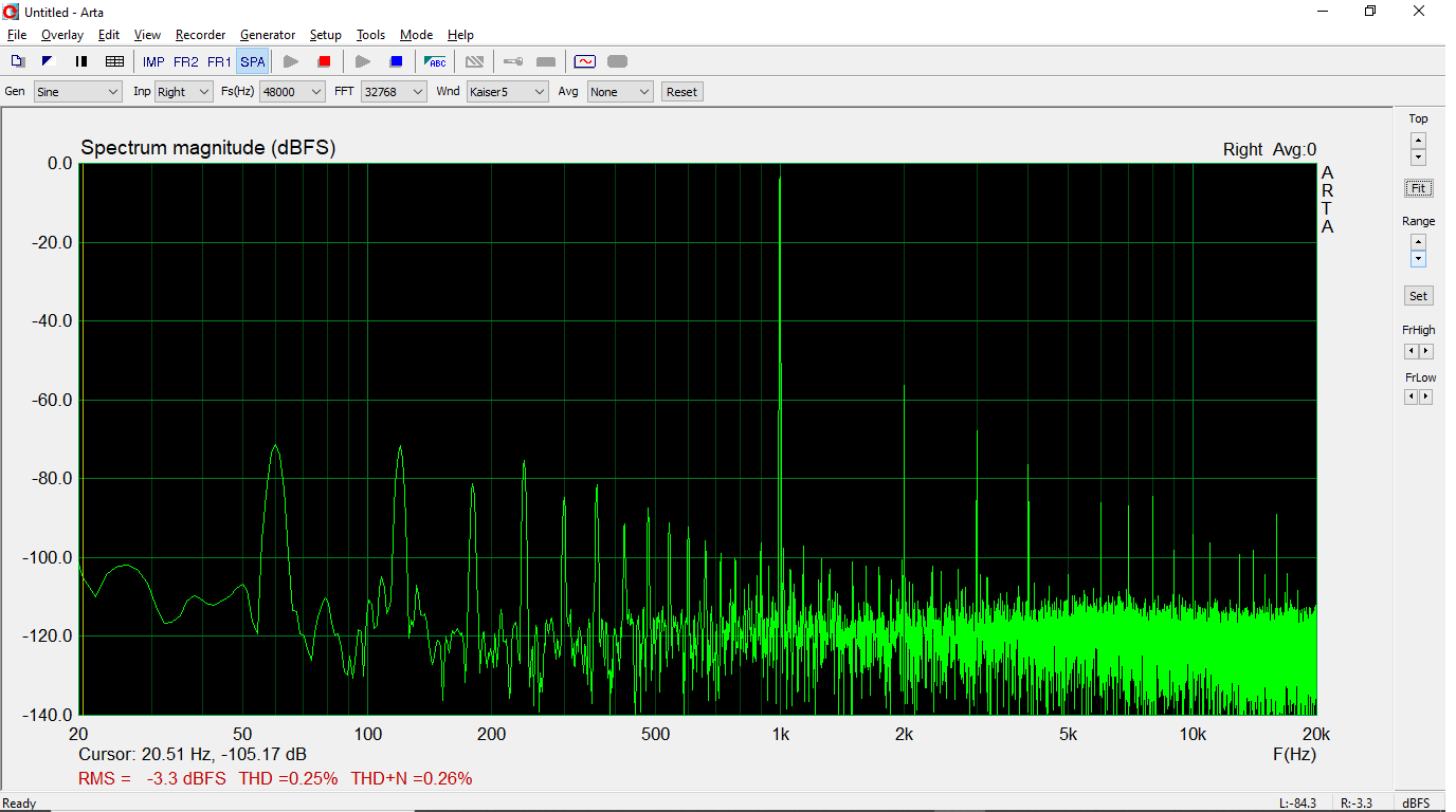

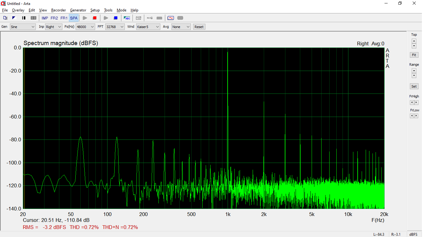

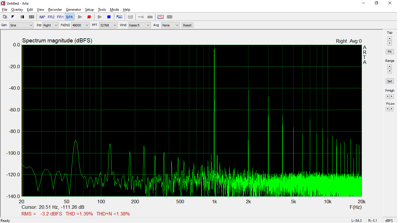

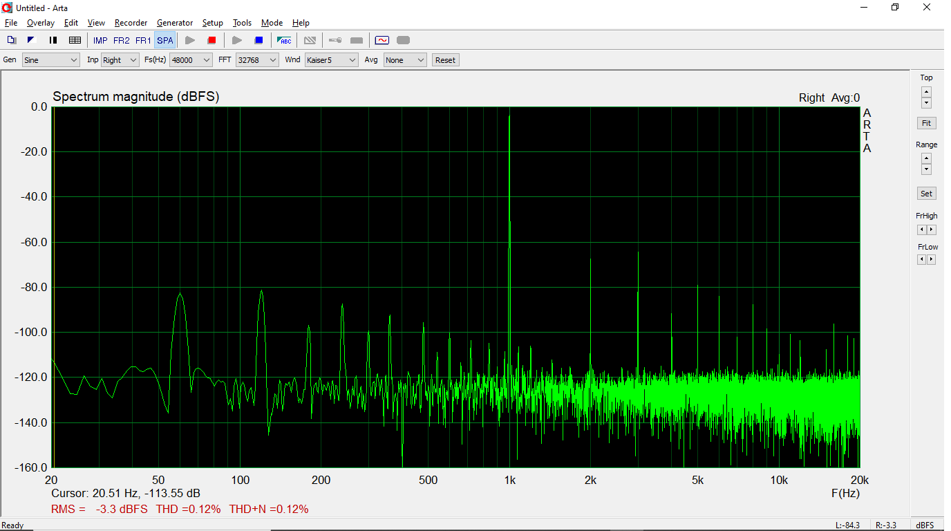

I changed the EF37A plate resistor to 270K, seemed to give a hair more open-loop gain over 220K with diminishing returns over 270K.
Here is THD into 8ohms at various output levels.
100mW
500mW
1W
2W
4W
While distortion is high at lower outputs, it is predominantly H2 and doesn't seem to get excessive at higher outputs. I think I can live with these numbers, it certainly passes the ear test.
The effect of the parallel resistor is marginal (few hundred uA peek through the resistor) versus the 801a grid current in A2 mode (few ten mA peek)...if the CF is working properly (low impedance output).
BTW I prefer source follower in this situation, because it's exempted from (CF) tube aging -bias shifting- and output impedance only few Ohms.
Disadvantage, that if FET is dead, mostly shorting.
I use only slightly larger (for example +80..100V) positive supply for FET as targeted A2 peek grid voltage, and usually use small, low wattage "grid stopper" as a fuse.
801a sustain -for a short time- even 40mA grid current if grid voltage +100V (at about 300V a-c voltage), so -for example- small size 100R grid stopper resistor hopefully smokes earlier than tube destroys.
