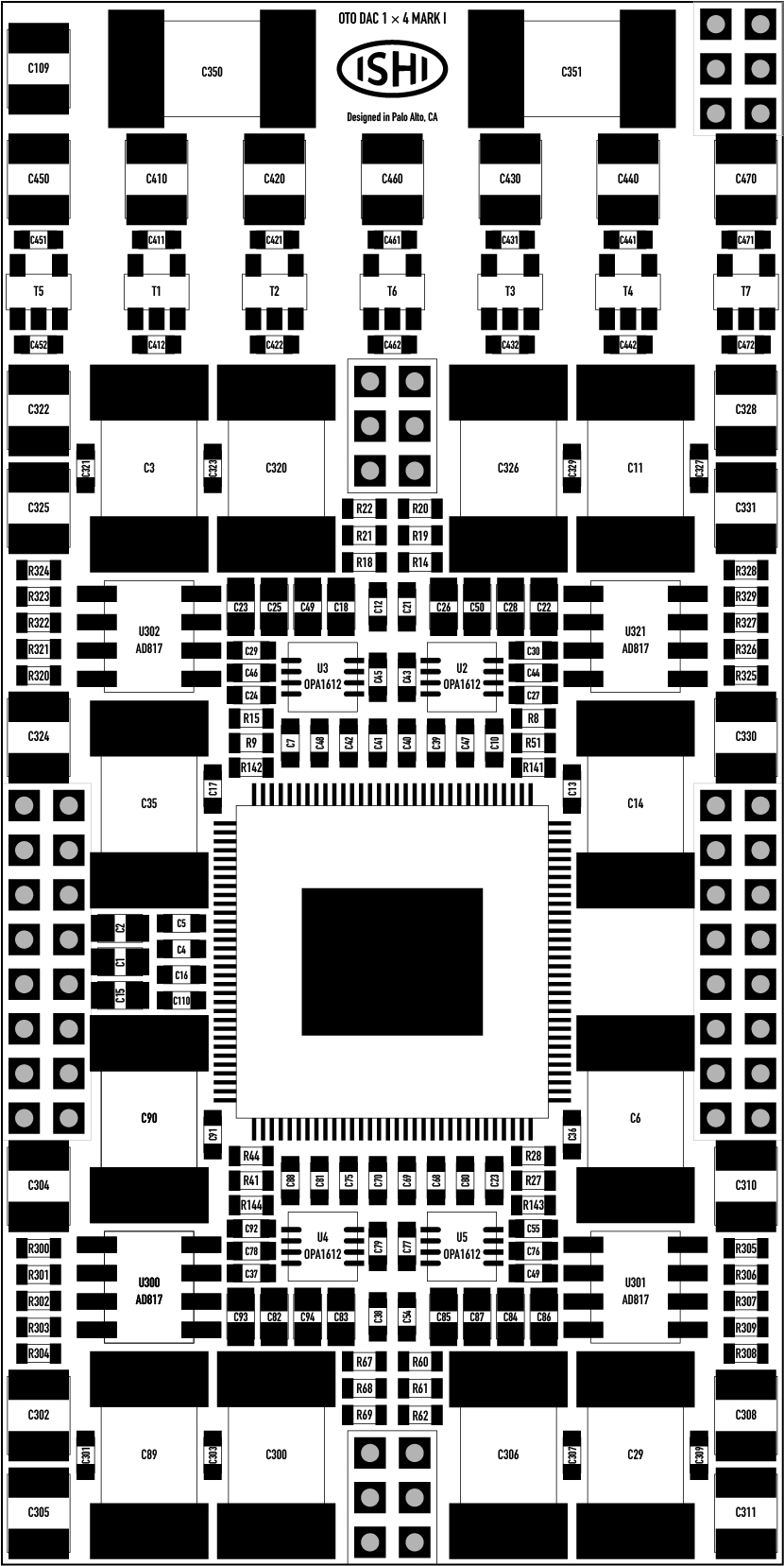

DAC PCB Layout
After a couple of days of work, here is a first PCB layout for the 70mm × 35mm DAC board. It was designed as a proof-of-concept using Adobe Illustrator, simply because it allows us to focus exclusively on component placement. Obviously, things might change once routing is designed in KiCad, but the overall design isn't expected to evolve much from now on. The only question that still needs to be answered is wether we can stick to a 4-layer routing, or whether we need to upgrade to a 10-layer design (there isn't much point doing anything in between). We will try with a simple 4-layer design, and switch to 10 layers only if we can't find any reasonable way to make it work.
Obviously, this is a very high density board, and we might have to move some components to the board's underside. Nevertheless, we've managed to cram pretty much everything on the top side, at the exception of all diodes and transistors, plus eight 180pF capacitors, and a single resistor (similar to what is done for the AKM evaluation board, at the exception of the diodes). This strategy will ensure that all the underside components have a low profile, and that we have plenty of underside room to expand the design.
The board's layout is highly symmetrical across two dimensions, reflecting the fact that the AK4499EQ is a four-channel DAC chip. Therefore, we've updated our BoM to take this underlying structure into account, grouping most components into quadruplets. This method allowed us to catch and fix many bugs in our design, and we intend to continue using it all along.
The top quarter of the board is dedicated to seven power supply regulators (L1, R1, L2, R2, +5V, +3.3V, +1.8V), while the remaining part is centered around the AK4499EQ DAC chip. The five connectors are placed as follows:
- North-East: Power inputs (connected to underlying PSU board)
- North: L2 + R2 balanced outputs (connected to overlying XLR board)
- South: L1 + R1 balanced outputs (connected to overlying XLR board)
- West: Control inputs (connected to underlying USB board)
- East: Audio inputs (connected to underlying USB board)
For the time being, we're assuming that the PSU board will provide +15V, -15V, and +5.5V. That being said, we've made sure to use the SOT23-5 version of the NCP161 LDO regulator so that we have enough room to switch to another regulator that could support a higher input voltage. For example, Markw4 is playing with +8V, and we'll test different options once we receive our evaluation board.
Next: moving all this to KiCad...
Note: A PDF version of the design has been attached to this post.

Looking really good! And I love the quality of the documentation.
Thanks a lot Mark!
The top quarter of the board is much less dense than the remaining three quarters, and I am wondering how we could put the empty space to good use. One idea is some debugging LEDs. But instead of just a couple of them, how about a 16-segment VU meter for each of the four channels? Since we have an I²C input, we might be able to implement each VU meter with a single chip and 16 LEDs. This would be totally gratuitous of course, since these VU meters will be masked by the brick's cover, but OTO is 20% engineering and 80% art...
This sounds like a cool side project...
The top quarter of the board is much less dense .
How about leaving some space to separate components a bit where capacitive coupling between adjacent devices could use a little reducing?
Happy to do that, but I'm not sure where this will make a real difference.
I still need to read the engineering book you recommended. I'm just back from 5 weeks on the road, so I should be able to dive into it as early as next week.
Also, we have a ton of space available on the board's underside. Therefore, for the signals that are not badly affected by vias, this is definitely an option that we should consider if we need to give our components some breathing room.

Best to keep the smallest decoupling caps as close to device pins as you can possibly get them. Some good advice in the book you mentioned. Rearranging parts a little to accomplish that might also reduce packing efficiency. Study first, design later may be better than the other way around.
That's what I tried to do on this design, but I certainly could use some additional study time.
Also, it should be relatively easy to add additional decoupling caps on the underside of the board, especially in relation to the seven regulators that are located at the top. And for the L1, R1, L2, and R2 regulator circuits, we also have the option of moving them to the board's underside. But if we can achieve similar results by just adding underside decoupling caps, I'd rather keep the board's underside as sparse and low-profile as possible, because it will face the underlying PSU and USB boards, which will need some vertical space in order to accommodate the use of WE-SHC shields.
...it should be relatively easy to add additional decoupling caps on the underside of the board...
Inductance from that depends on how the board is layered.
Obviously. So, what is your recommendation? 4 or 10 layers?
