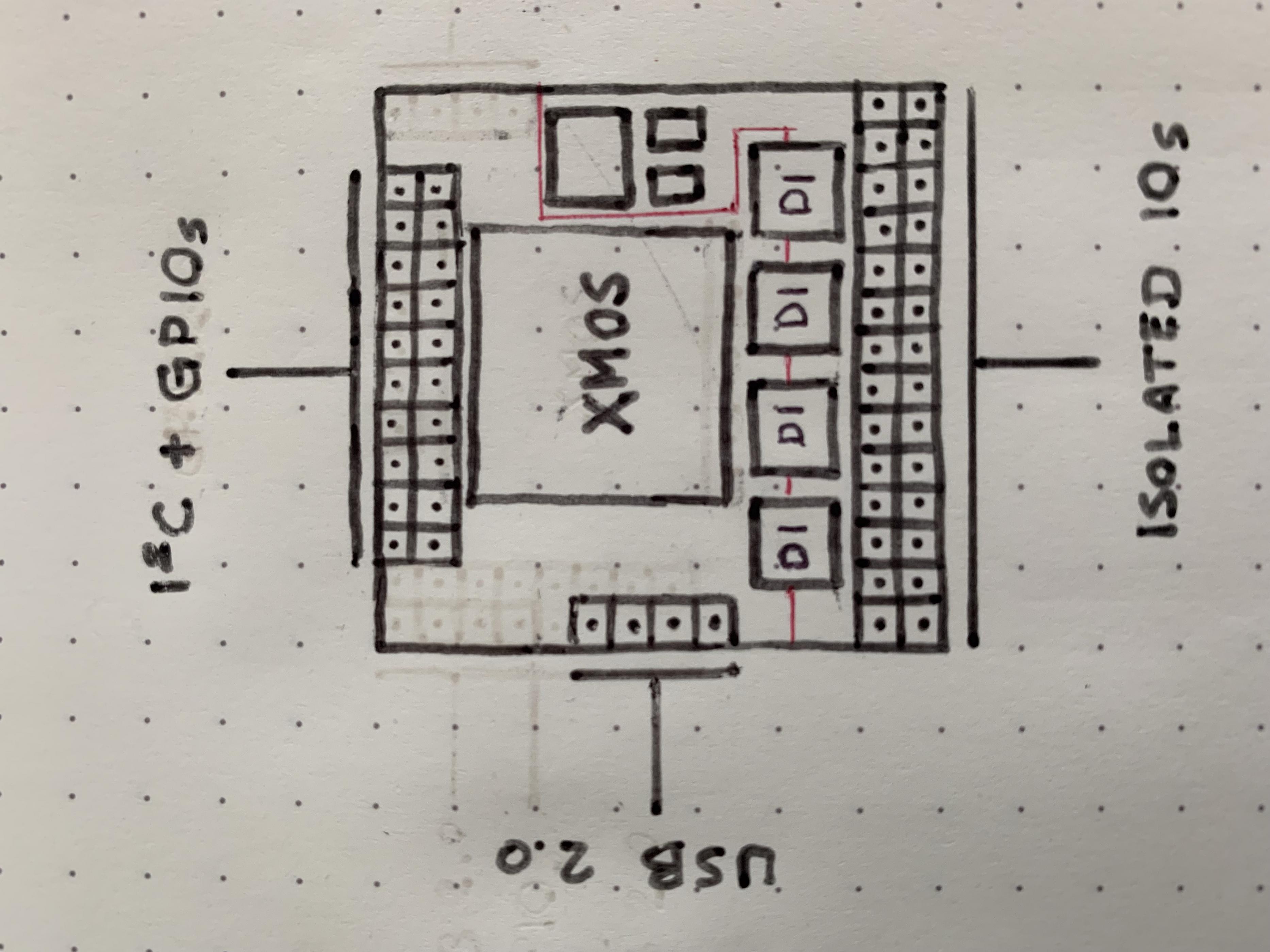

USB Board
Here is a very crude sketch of the USB board. It's 35mm × 35mm so that we could put two of them alongside the 70mm × 35mm PSU board within a 1 × 1 brick (aka "unit brick"). It is designed around the XUF232-1024-FB374, which is currently the most powerful chip offered by XMOS (32 cores). It also includes three Si866x low power six-channel digital isolators in order to get up to 18 isolated channels. The red line on the chip outlines the boundary between the two isolated sides of the board. In fact, there will be three isolated sections: one for the XMOS chip, one for the ADAT and S/PDIF outputs, and one for the oscillators (currently shown on the right hand side).
At the top, we have 14 pins (if we stick to exactly 35mm, we'll be limited to 12), and 28 at the bottom, for a total of 42. As a point of comparison, the MCHStreamer Kit has 44 of them, while the DIYINHK has 66, but these do not include the USB input. Therefore, we'll probably need more pins, but we should have space for them on the top left and right sides of the board.
Of course, this sketch does not show any of the capacitors and resistors that we will need. That being said, it's hard to say how many of them are really necessary, because if you take a close look at the PCBs for the DIYINHK and MCHStreamer kits, you'll see that they are quite different on that front: the DIYINHK has very few capacitors and resistors, while the MCHStreamer has many of them. That being said, we're not too worried about these, because we should be able to mount most of them on the other side of the PCB.
Quite clearly, we're really pushing the envelope there, for I don't think there is any such small XMOS board on the market today, and certainly not one with 32 cores. But this is all part of the fun, so we'll give it a serious shot.
Last but not least, the BoM for this board should be well under $75.

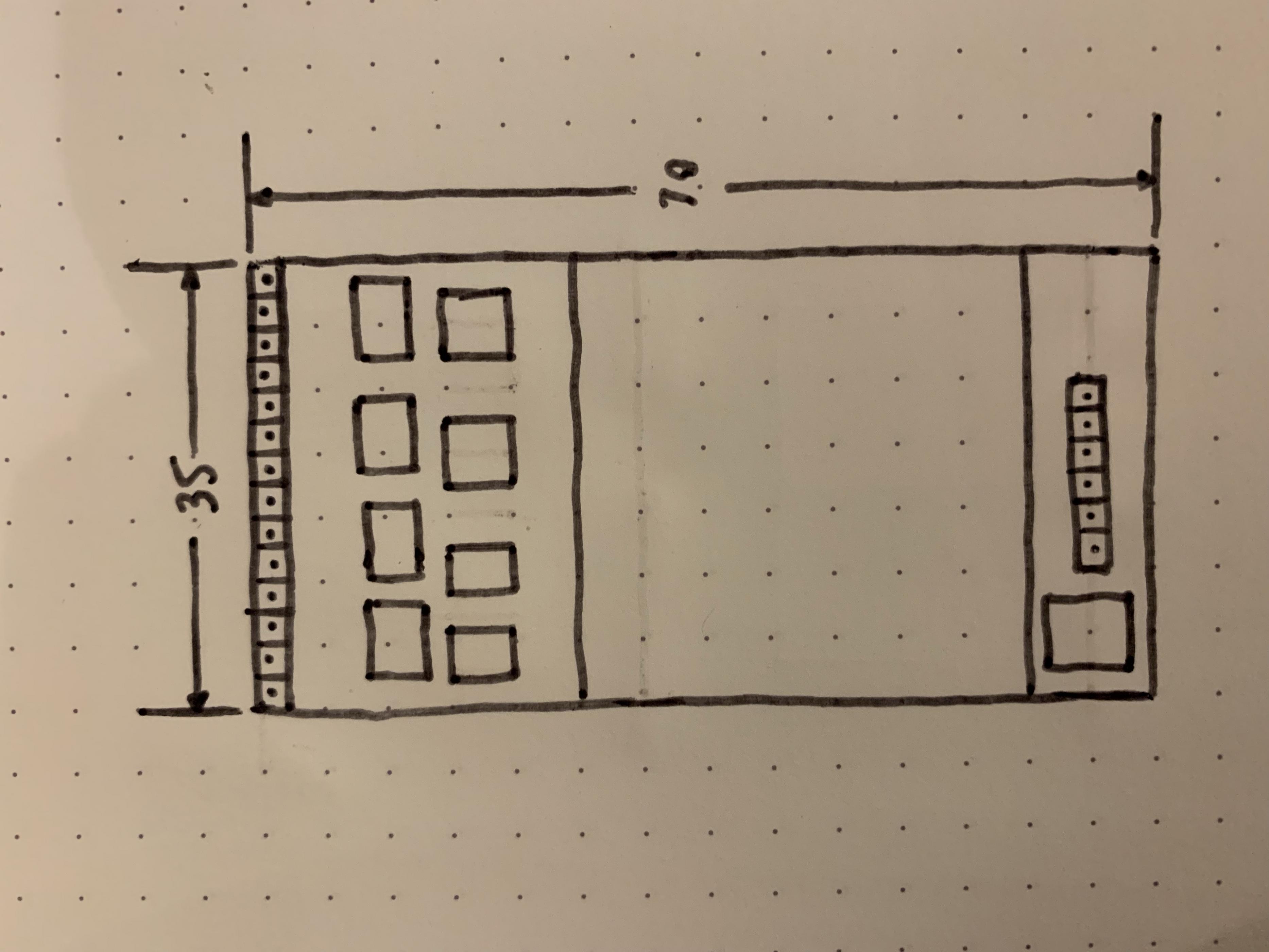

PSU Board
Here is another crude sketch, this one for the PSU board. It is inspired from the OSVA AAPSU01, with an extra LT1965 for the +3.3V supply that we need for the DAC brick. That being said, we'll make sure that our PSU board could be used for many other bricks, including the ADC brick. The board is 70mm × 35mm and has a 35mm × 35mm section similar to the one of the AAPSU01 that is covered by the WE-SHC shield. We also included 6 pins on the input side and 14 pins on the output side. This board is probably the easiest of the three that we have to design, and I am confident that we can fit everything we need on its allocated real estate.

...with an extra LT1965 for the +3.3V supply that we need for the DAC brick...
Why regulate down to 3.3v for a whole dac brick? There may be a good reason, don't know. However, might make more sense to pre-regulate down to somewhere in the range of 5v to 8v, then do the final regulation locally where it will be needed. At the lower end of that voltage range there will be less power dissipation at secondary regulators. At the higher end of that range they may have a little better performance characteristics.
Agree, at least for the digital supplies. For analog supplies, I would say perform listening tests and measurements before finalizing an alteration to the eval board design. If this were a low cost project I wouldn't worry too much, but an ultra-high end part like AK4499 needs some care to enable its intended performance level. An old part like 7805 doesn't actually sound too bad when used for analog audio. Don't know so much about all the new regulators on the market, but haven't had much success so far getting the best sound out of LDOs for analog circuits. That's not for having failed to try either. At the same time, I have not done an extensive effort. There is a paper at Linear Audio you might want to study: https://linearaudio.nl/sites/linearaudio.net/files/v4 jdw.pdf
Regarding capacitor choices, ESR may not be the only consideration. I don't have the desire to scour the eval board schematic looking for each capacitor you might ask about from the BOM. At a minimum, I would want to know where on the schematic it is used.
There is no real external difference between an LDO and a 7805. They are both series regulators, except the 7805 is a design older than I am. The 7805 is not remotely high end and does not belong in a high end product. It is low performance and has a very low bandwidth control loop.
I've read that LA article years ago, it's not very useful.
Edit: I will say, the NJM part appears to be better than an old 7805 according to the datasheet. It's adequate, I am sure. I'd use something else, but it's not terrible.
The AK4499EQ needs +3V (or +3.3V) for TVDD and the T102 LT1963AEST-1.8 producing the +1.8V DVDD. Are you suggesting that we get the required +3V from a +5V to +8V supply then regulate it down to +3V with a regulator mounted on the DAC board?
I so, this might be possible, and it would make the design of the PSU board even simpler.

For the PSU, I was thinking of building something very similar to the OSVA AAPSU01, with a 20V input coming from a USB-C port. Should I add something else?
That's probably fine, if you clone that or use it directly, then add your 3.3V regulator after the 5V output. If you put a USB-C port, you should make sure it's compliant with the USB PD spec as a sink (IMO anyway), which adds extra complexity. Frex is very experienced and knowledgeable, so you can learn a lot from his projects.
Not to dissuade you, but even the power supply alone is a lot of work 🙂.

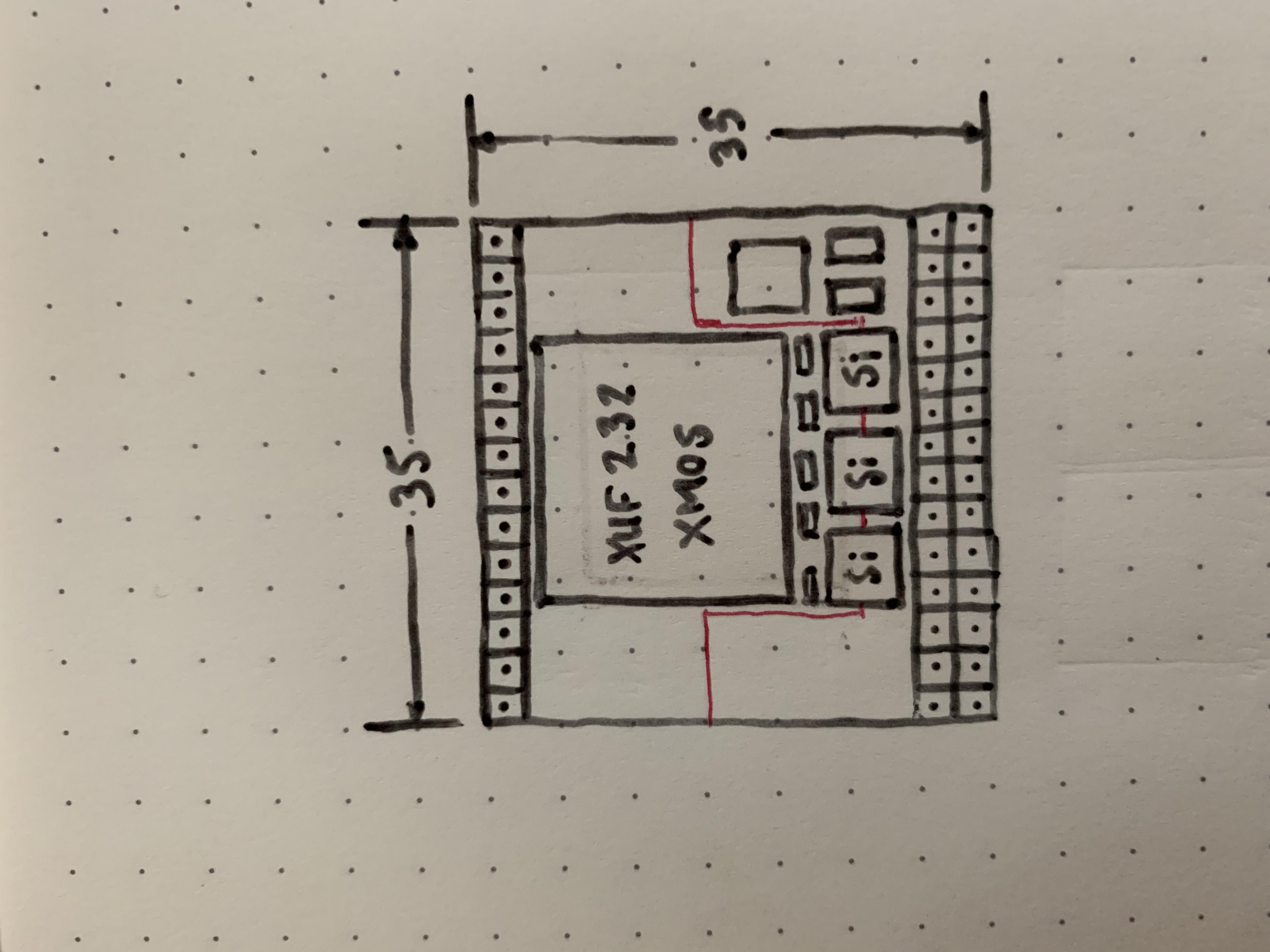

Updated USB Board Sketch
Here is an updated sketch for the USB board. Following our pin analysis, we've concluded that we had enough space to include some I²S and S/PDIF inputs as well. This will allow the board to be used for bricks that expose these inputs, even though our standard DAC bricks will not. In order to make that possible, we went from three to four Si866x low power six-channel digital isolators (marked "DI" on the sketch). Also, we've increased the count of GPIOs from 12 to 14 in order to get 2 spare ones on top of the 12 that are required by the DAC board (better be safe than sorry). And we still have quite a bit of room for the regulator(s), capacitors, and resistors that will need to be installed, even though most of them can go on the board's underside. Most importantly, we made sure to group the GPIOs and I²C interface on a single set of headers, while putting all isolated IOs on another set. This will make it easier to connect the USB board to the DAC board. On the sketch, the red line indicates the isolated area.

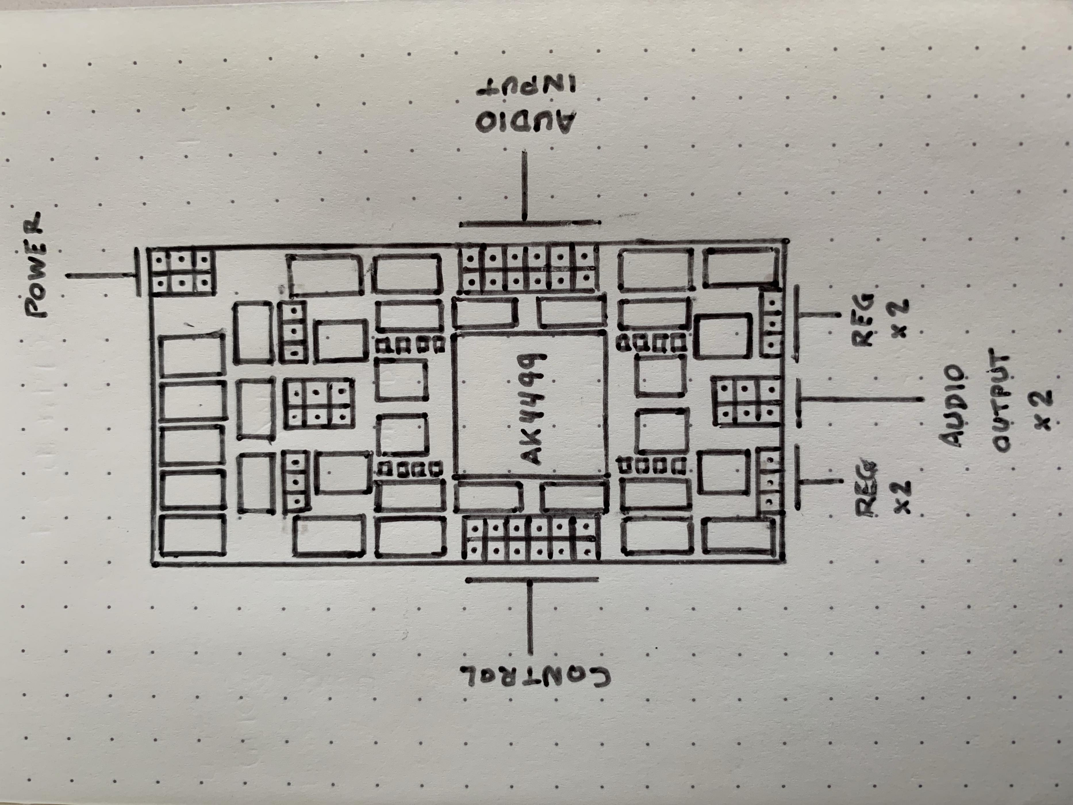

Redesigned Stack
We have redesigned our stack in order to align our board-to-board interconnects with the AK4499EQ's pinout. The new design will significantly reduce the lengths of most traces and makes room for a proper power section on the DAC board.
The attacked stack shows how two USB boards and two DAC boards will share a common PSU board. As a reminder, the USB board is 1 × 1 (35mm × 35mm), while the DAC and PSU boards are both 2 × 1 (70mm × 35mm). With that in mind, the stack picture shows how the two DAC boards are laid on top of the PSU board, but rotated by 90 degrees.
The DAC picture shows the redesigned layout for the DAC board, with the power section at the top (including three 470μF capacitors and three regulators that were overlooked in the original design), plus an upcoming 5V to 3.3V regulator.
In order to make room for all this, the AK4499 is lowered a bit, allowing for a perfect alignment with two sets of 12 headers, with control inputs on the West side and audio inputs on the East side. The pin analysis that we conducted earlier today confirms that this is an appropriate layout, at the exception of the MCLK pin, which is on the "wrong" side of the chip (I'm not sure exactly why AKM engineers did this).
The new design still makes room for the LT3045-78XX and provides two sets of 6 headers for the audio outputs, one on the North side and one on the South side, directly adjacent to their related OPA1612 OpAmps.
This "crossgrain" laminate structure of the 5 boards kills two birds with one stone: it helps reduce the length of traces and it provides structural integrity for the assembly, without having to use any screws. Overall, I like it a lot better than the previous design.
