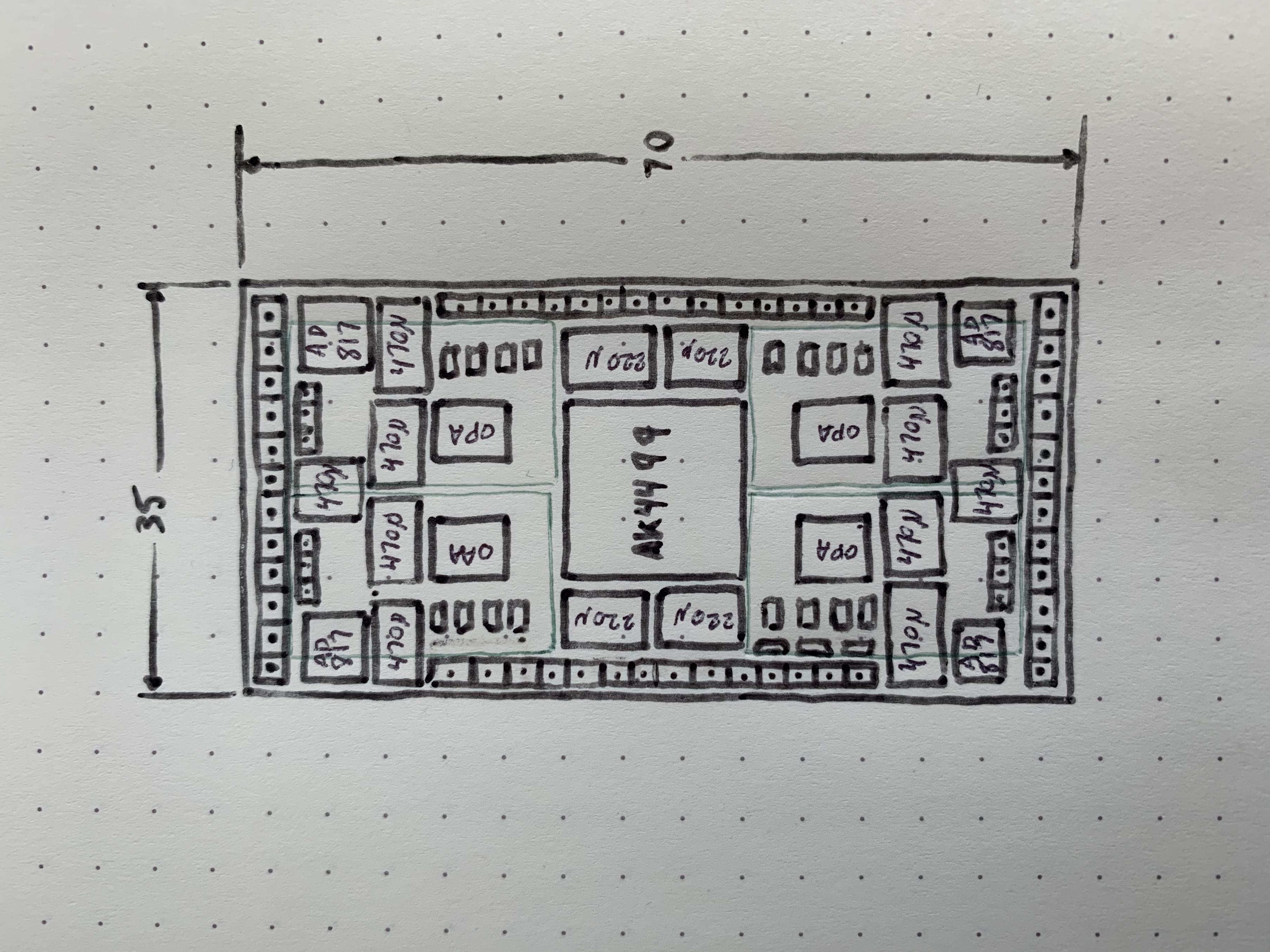

DAC PCB Sketch
Here is a very crude sketch of what the PCB layout could be for the DAC board with all regulators mounted on board (including the Jung-Didden circuits). The board is 70mm × 35mm, which means that 2 of them could be mounted side by side within a 80mm × 80mm brick. And by stacking two pairs within the brick, we should be able to provide 4 balanced mono outputs driven by 4 separate AK4499EQ chips, with 4 discrete power supply regulator circuits. And because we are planning to use low-profile tantalum capacitors, this brick should not be taller than 80mm, including the Sitara SoM, the PSU board (inspired by the OSVA AAPSU01), the isolated XMOS board, and the XLR connectors board. Such a brick would have a $1,200 BoM.
The four green boxes on the sketch outline four LT3045-78XX LDO regulator boards, which remain the simplest option for improving upon the NJM78M05. Again, this is probably overkill, but it is good to know that the design could accommodate this type of upgrade. And if these do make a positive difference, there is probably enough room to use four regulator boards with two LT3045 circuits mounted on each regulator board, thereby going from 500mA to 1.0A on each board, which would remove the need for any heatsink. It is also possible that we could find (or design) a low profile heatsink that would connect the four regulator boards together, thereby killing two birds with one stone: dissipating heat and improving the structural integrity of the overall assembly.
With this design, all transistors are mounted on the back of the DAC board, as done by the AKM evaluation board. Also, with such a densely-populated board, it is quite likely that we will have to go from a 4-layer PCB to a 10-layer PCB, but that's probably for the best anyway, and the cost increase should remain marginal when compared to the overall BoM (the 10μF or larger capacitors alone contribute to a heft $75 per DAC board, and so do the LT3045-78XX regulators if we decide to use them).
The board also includes 4 rows of 2.54mm headers with 2 × 12 pins on the short sides and 2 × 14 pins on the long sides, for a total of 52 pins. We've not done any pin assignment yet, but I am willing to believe that it will be enough. We might also break down these rows into subsections, with some mounted on top and some mounted underneath. And we might use different connectors for different signals and supplies, but it is good to know that we have enough real estate to get electrons in and out of the board.
The overall placement of components also reflects more or less what is done on the AKM evaluation board. The only main deviation are the C350 and C351 470μF capacitors for -15V and +15V, which are mounted on opposite sides of the AK4499EQ chip. These might be brought back together if necessary once we have a more precise placement of all the components (my little Moleskine notebook will only take us this far). I should also mention that all dimensions for the large capacitors were taken from this evaluation matrix.
Luckily, the proposed layout should make it possible to shield the DAC chip, 4 × OPA1612 OpAmps, 4 × 220μF capacitors, and 19 other capacitors within a 37.7mm × 25mm 3600637250S WE-SHC shielding cabinet. I am still not clear whether this would help or not, but it is good to know that we have this option.
Last but not least, this little DAC board should have a BoM of about $350 without the (probably overkill) LT3045-78XX regulator boards. Therefore, it should be applicable to many other DIY projects, which is quite nice.
...you can look at simple fixed regulators like TPS7A80, LP5907, LP2992.
Agree, at least for the digital supplies. For analog supplies, I would say perform listening tests and measurements before finalizing an alteration to the eval board design. If this were a low cost project I wouldn't worry too much, but an ultra-high end part like AK4499 needs some care to enable its intended performance level. An old part like 7805 doesn't actually sound too bad when used for analog audio. Don't know so much about all the new regulators on the market, but haven't had much success so far getting the best sound out of LDOs for analog circuits. That's not for having failed to try either. At the same time, I have not done an extensive effort. There is a paper at Linear Audio you might want to study: https://linearaudio.nl/sites/linearaudio.net/files/v4 jdw.pdf
Regarding capacitor choices, ESR may not be the only consideration. I don't have the desire to scour the eval board schematic looking for each capacitor you might ask about from the BOM. At a minimum, I would want to know where on the schematic it is used.
I have added references to the capacitors on the evaluation matrix, as well as references to voltage levels on the BoM. Please let me know if there is anything else I can do in order to make these documents easier to read. I wish that I could annotate the schematic, but the document is not public yet.
Agreed. And just to make it clear, I am not planning to make any alteration to the reference design at this point. Just planning to mount the NJM78M05 on headers so that we could easily swap them with the LT3045-78XX. And I will try to use the DIP version of the AD817 so that we could try alternative parts, but I am not positive that I will have enough space on the PCB to do that. It would be really nice though, and there is a good chance that we can do it, especially if we can afford to remove 8 pins on each of the 12-pin headers located on the short sides of the board.
You may have to use separate I/V opamps for each of the four channels from each dac chip. If so, then it might be a fairly simple matter to software/hardware configure the brick for 4 mono channels or 16 normal channels. That assumes mono mode would simply sum mono I/V outputs to give lower noise. The connection between I/V outputs and a low noise summing amp would have to be very low noise, but it could possibly be switched in or out with small profile pin jumpers. Given what a brick would have to sell for, you might even sell a few if there are a reasonable number of channels that could be brought out on a small header or something for those that would prefer such a configuration.
Also, is that 4 discrete regulator circuits per brick or per dac chip? If the latter, then it might be more sensible to make 16 channels an option. If the former, you would probably be wise to test a mono dac configured that way and evaluate performance.
That's exactly what I was planning. On the attached picture, the four rectangles called "OPA" are the OPA1612 of the I/V opamps, and a brick will be able to contain four of these boards. So, with a single type of DAC board and nothing more than an Allen key and LEGO-like instructions (or IKEA-like, make your pick!), anyone should be able to assemble 1 × 1 bricks that offer the following:
- 1 mono channel driven by a single AK4499EQ
- 4 mono channels driven by a single AK4499EQ
- 2 mono channels driven by two AK4499EQs
- 8 mono channels driven by two AK4499EQs
- 4 mono channels driven by four AK4499EQs
- 16 mono channels driven by four AK4499EQs
The Sitara SoM will be optional and the BoMs for all the configurations will go from $200 (no Sitara, no LT3045) to $1,200 (Sitara, 16 × LT3045s).
