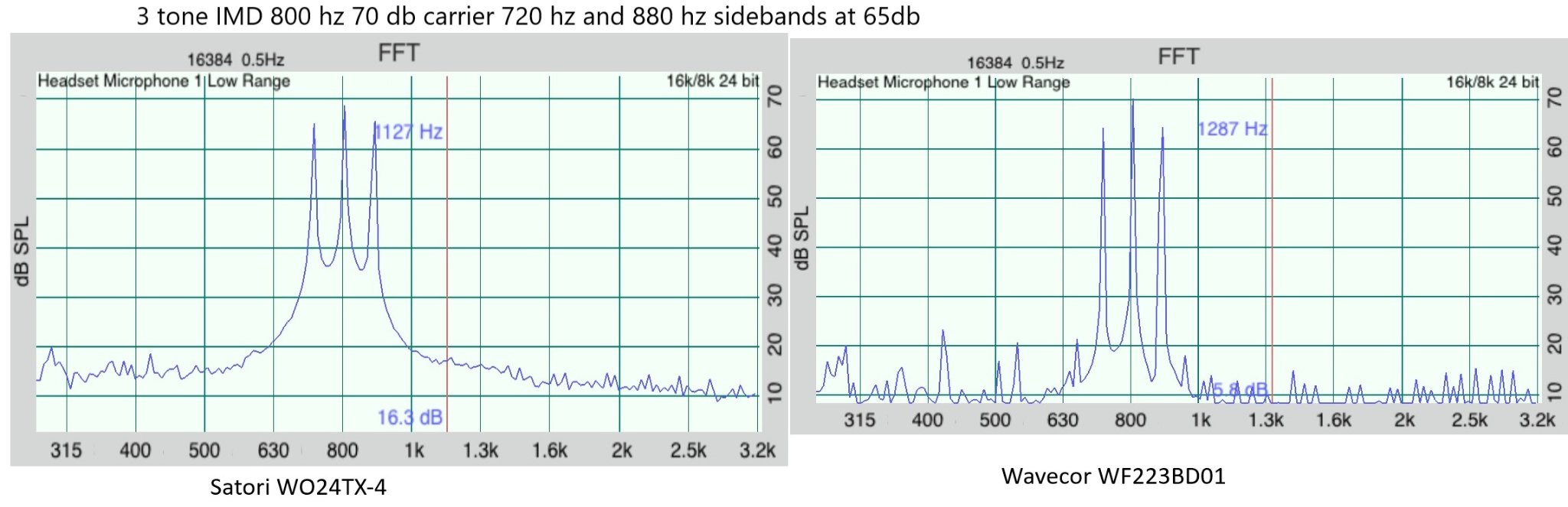

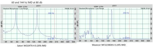

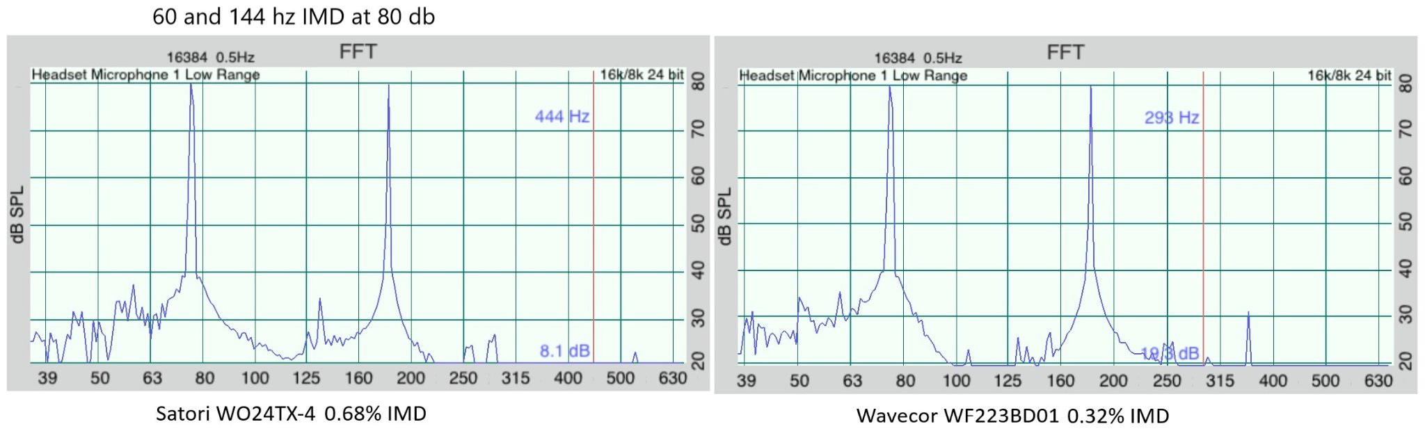

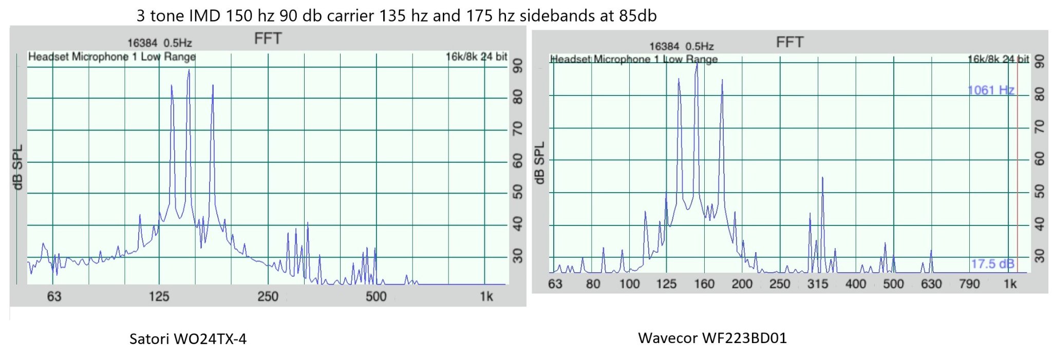

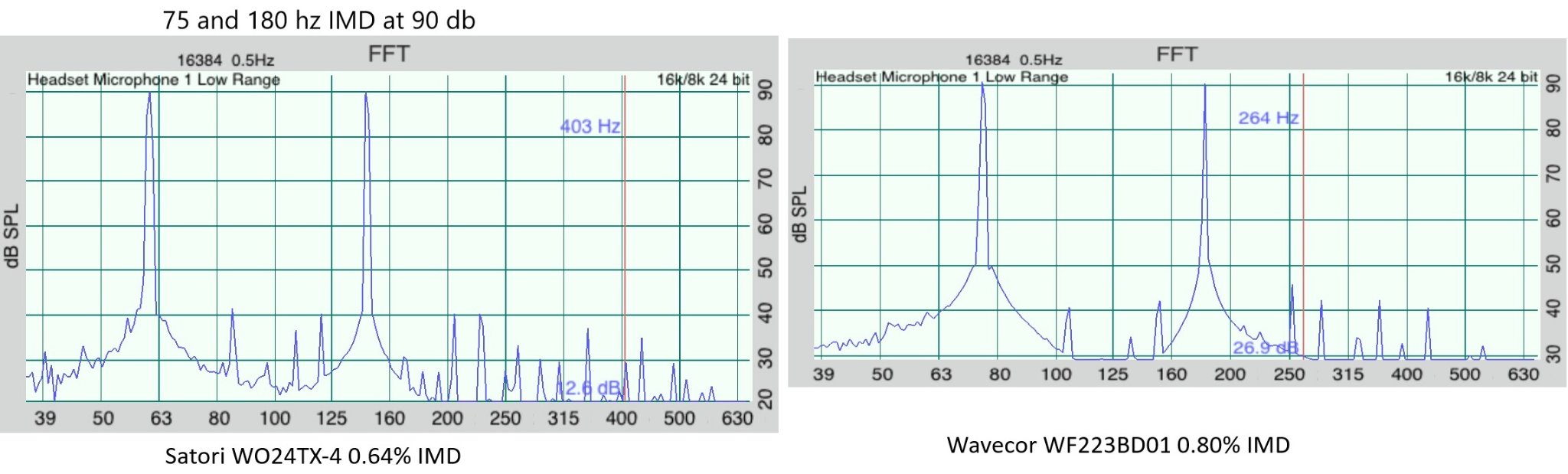

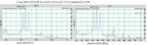

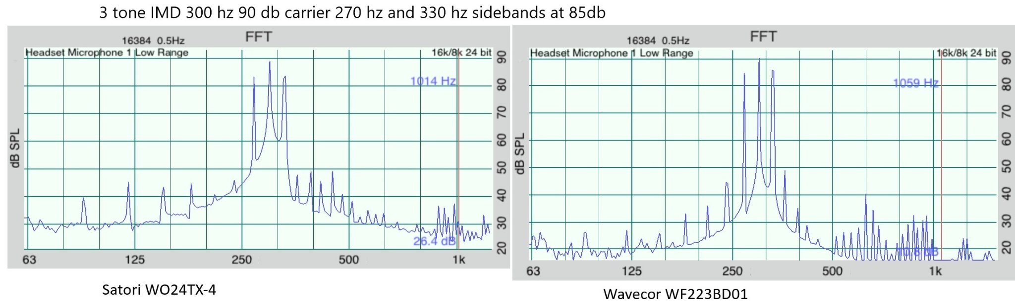

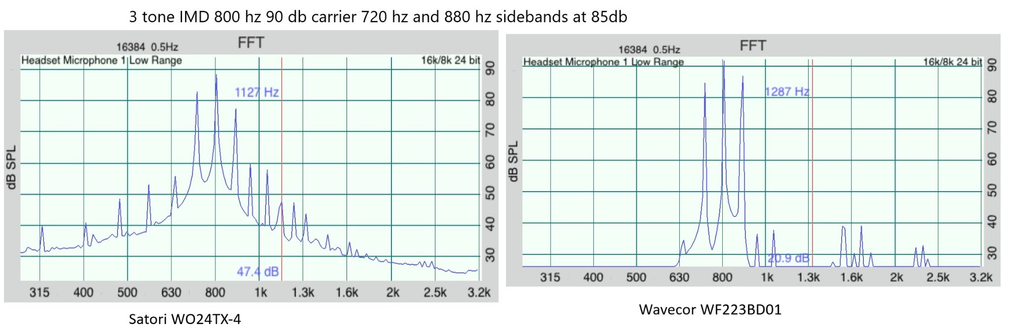

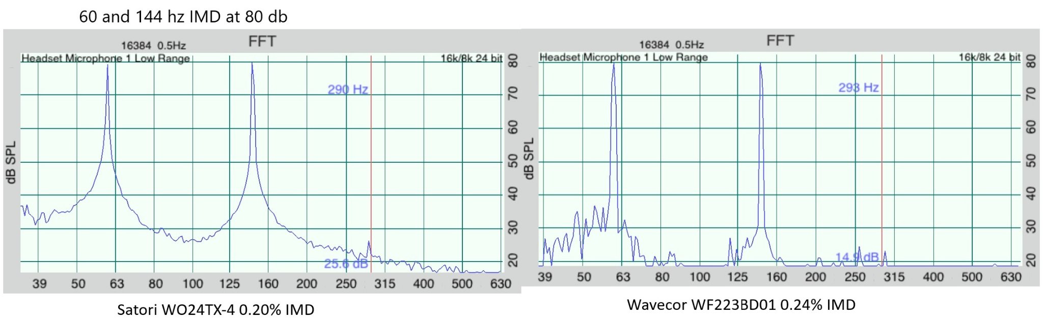

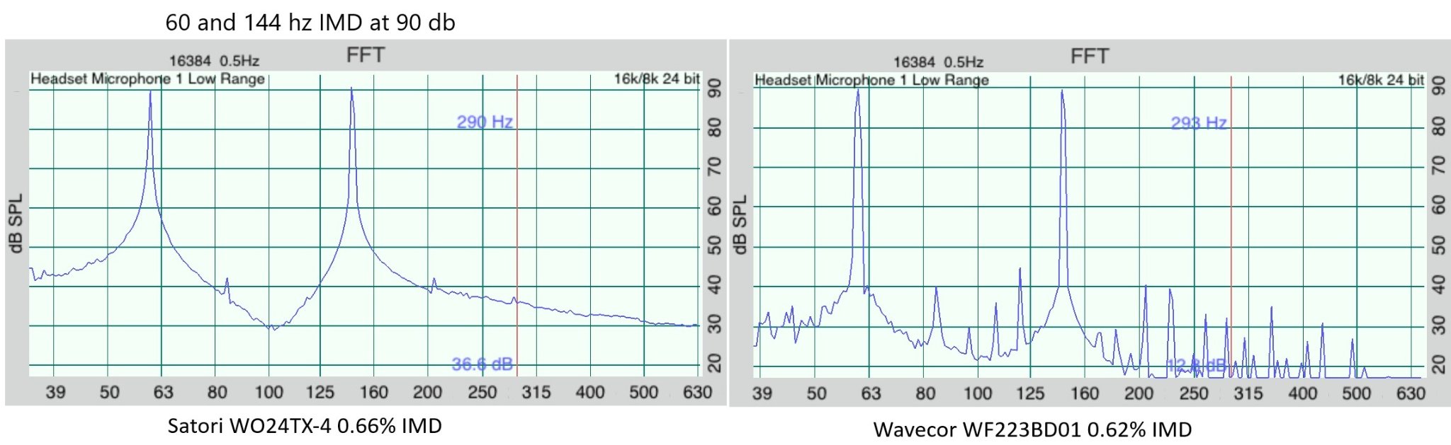

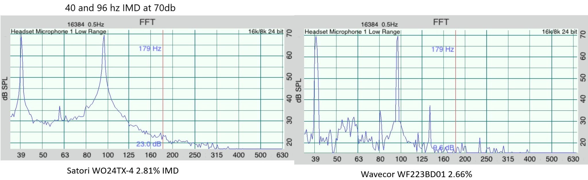

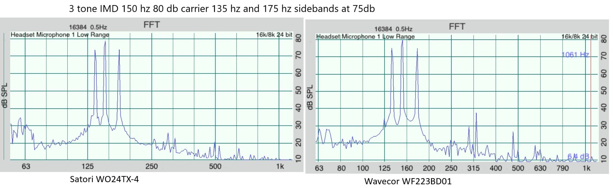

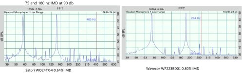

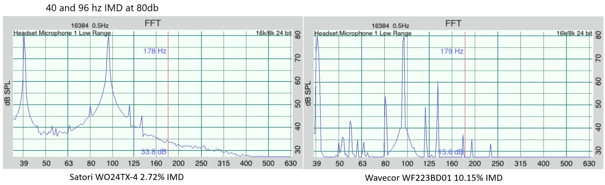

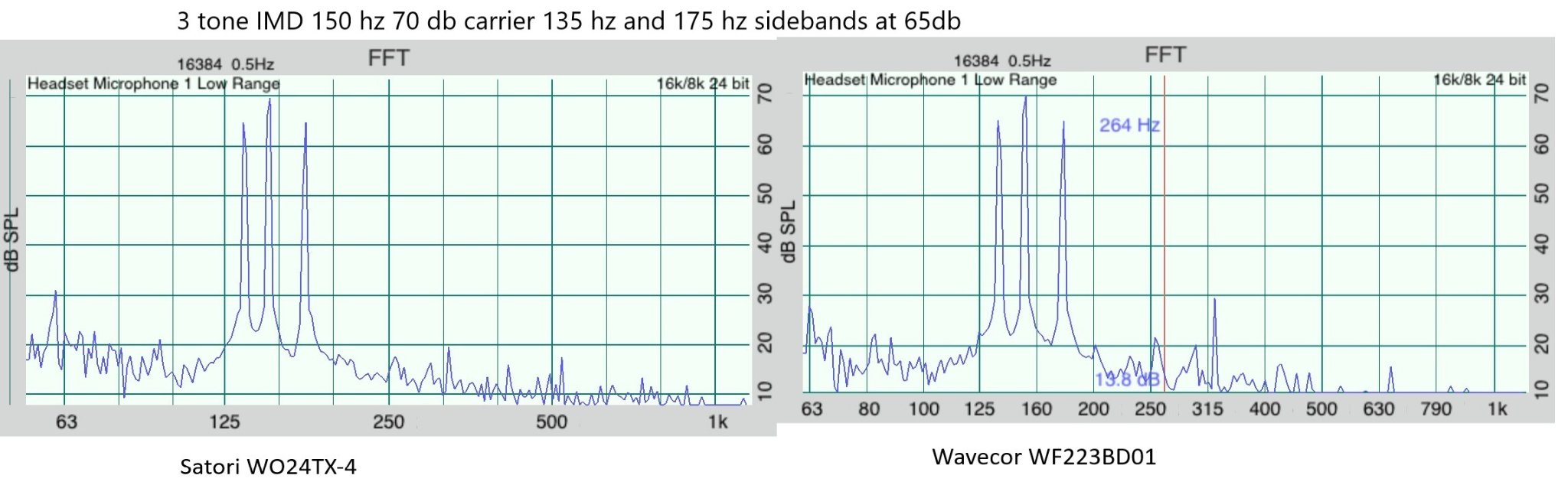

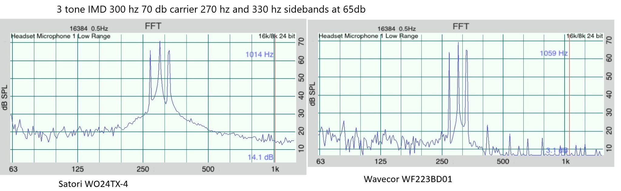

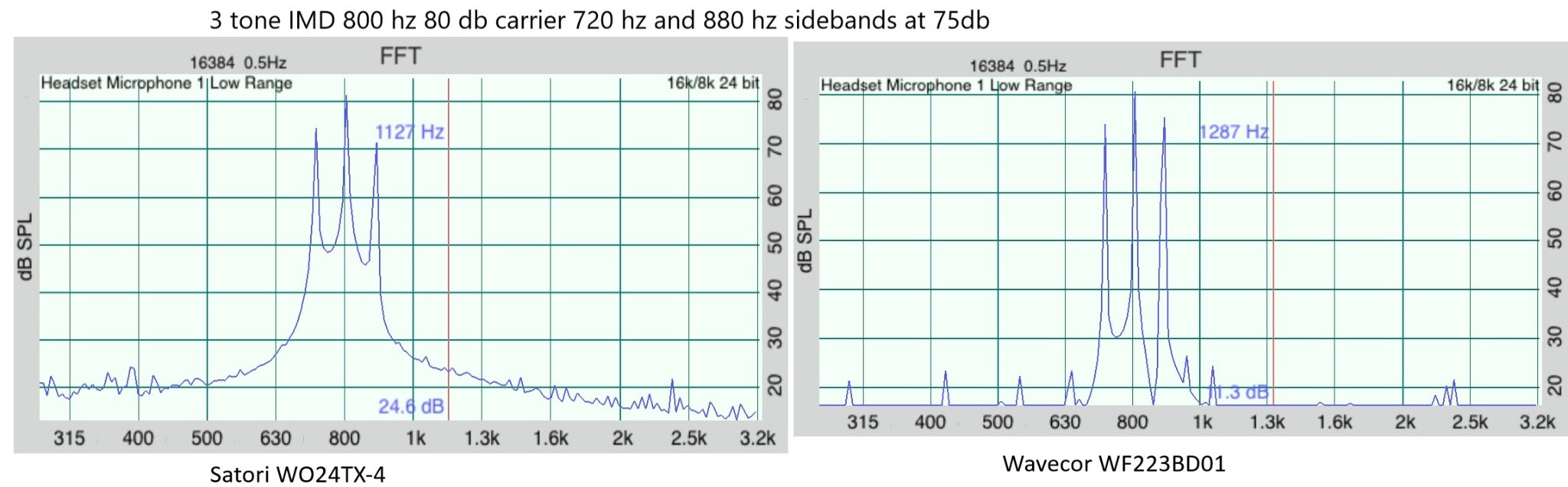

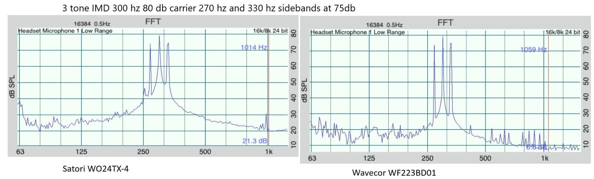

8" Woofer/Subwoofer Intermodulation Distortion Testing
Next up is the Wavecor WF223BD01. This driver is a good performer both in IMD and subjectively. Of all drivers 5-10" it is either 1st or 2nd in the bass 60 and 75hz IMD tests (depending on drive level) and is the best so far in the 800hz midrange test of 25 drivers I've tested. Subjectively it sounds very good to me, I especially found the cello to sound very natural and dynamic when listening to Yo Yo Ma's "Nature at Play". I've compared the graphs with the Satori WO24TX-4 which does better in the deep bass (40 hz IMD test) but is about even in the upper bass and the Satori is less clean in the midrange.
