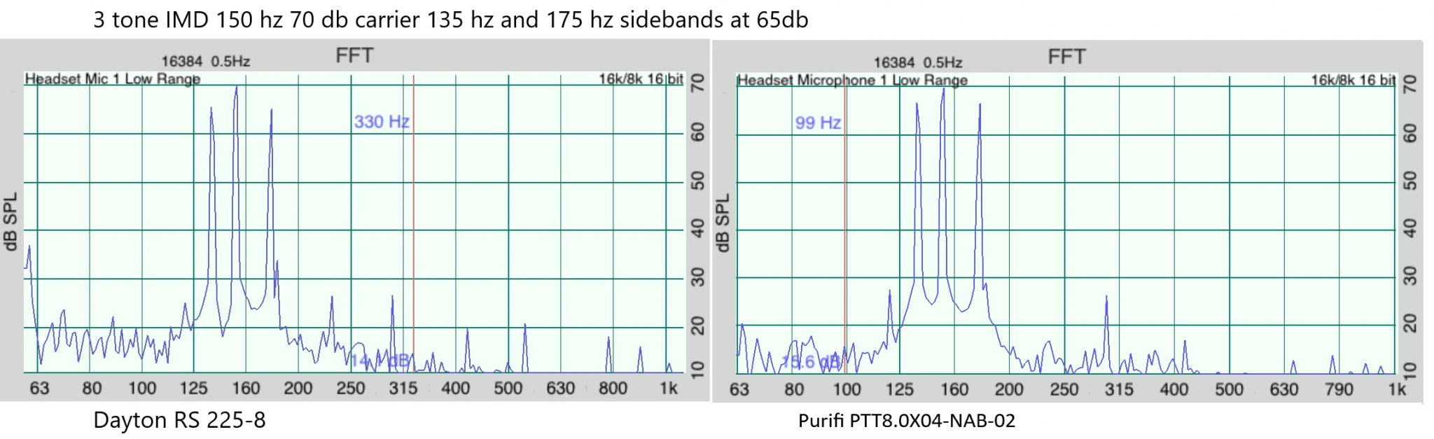

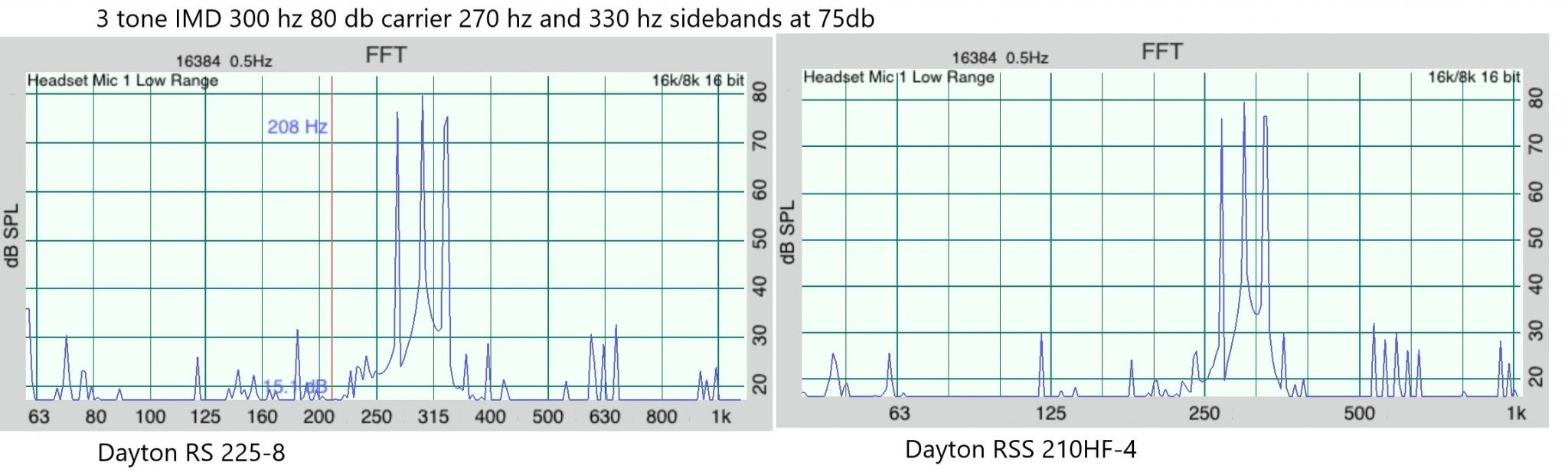

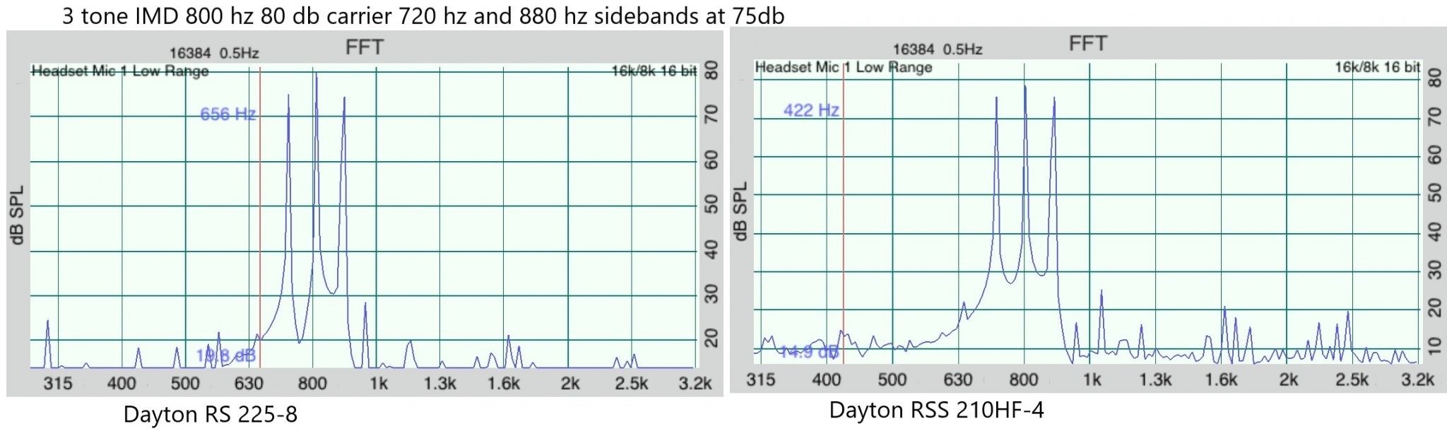

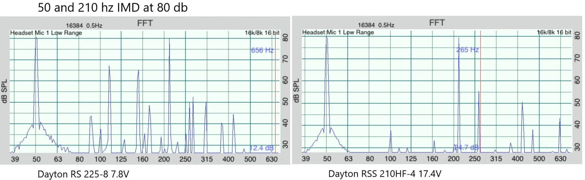

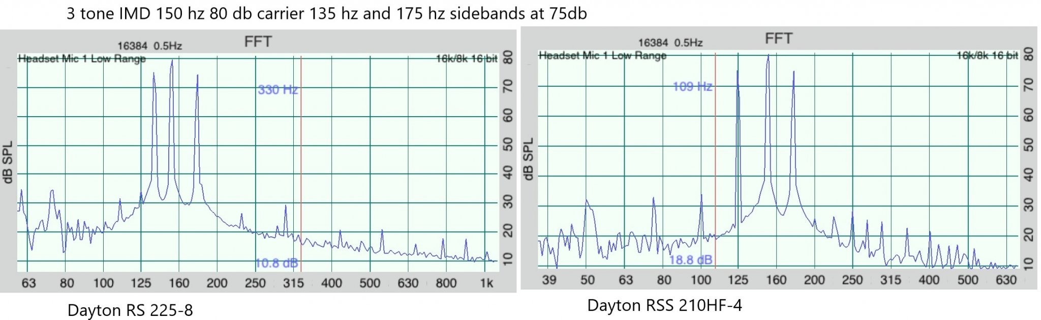

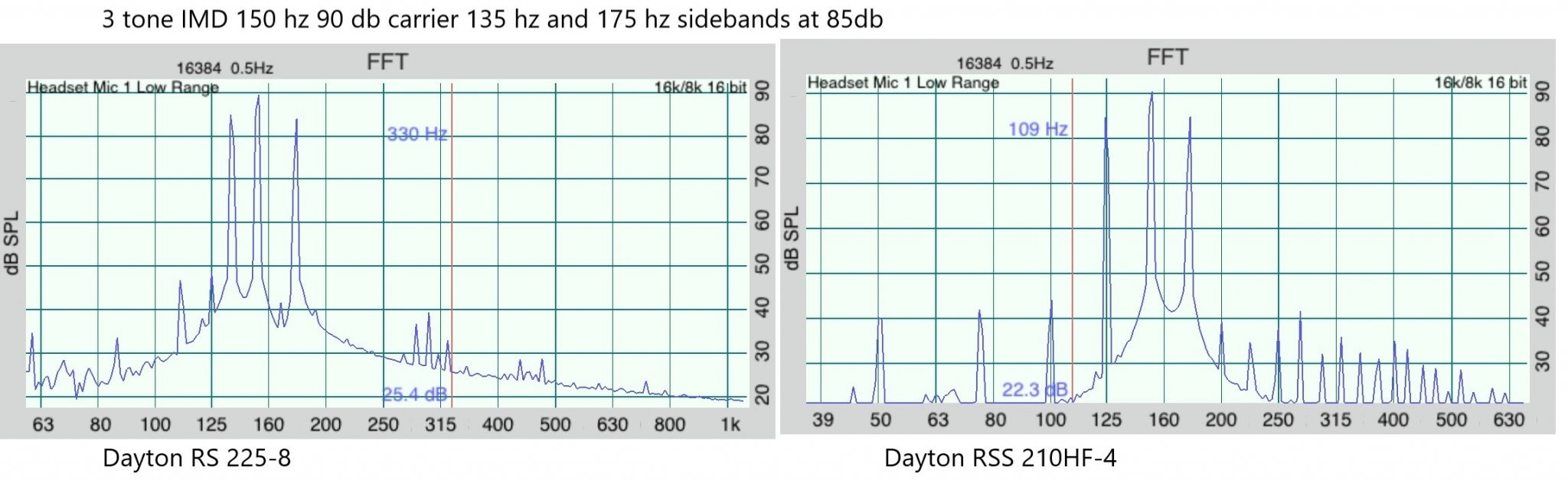

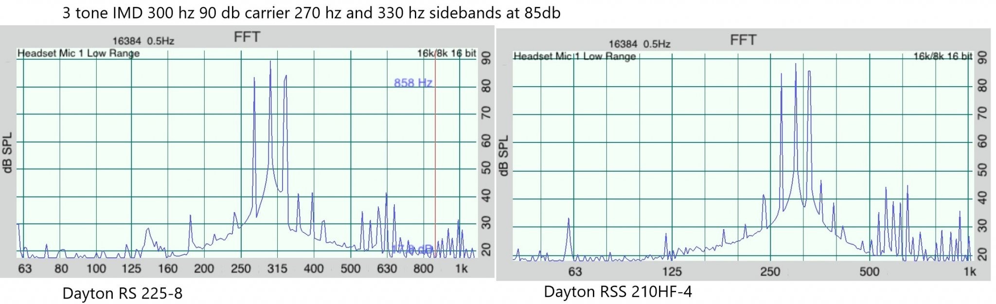

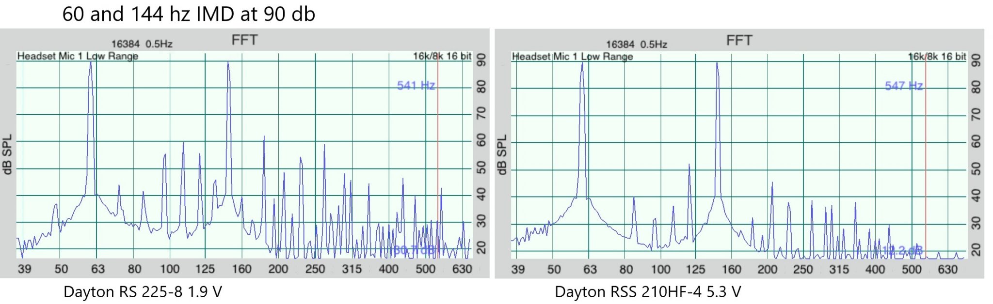

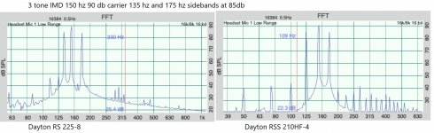

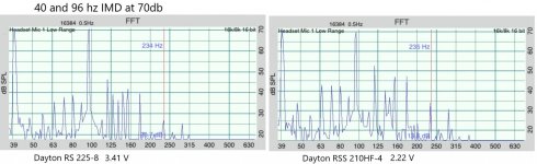

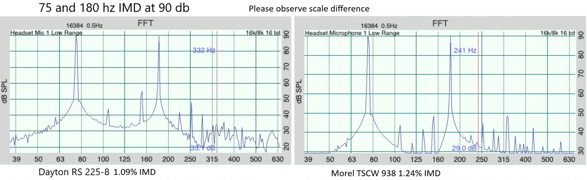

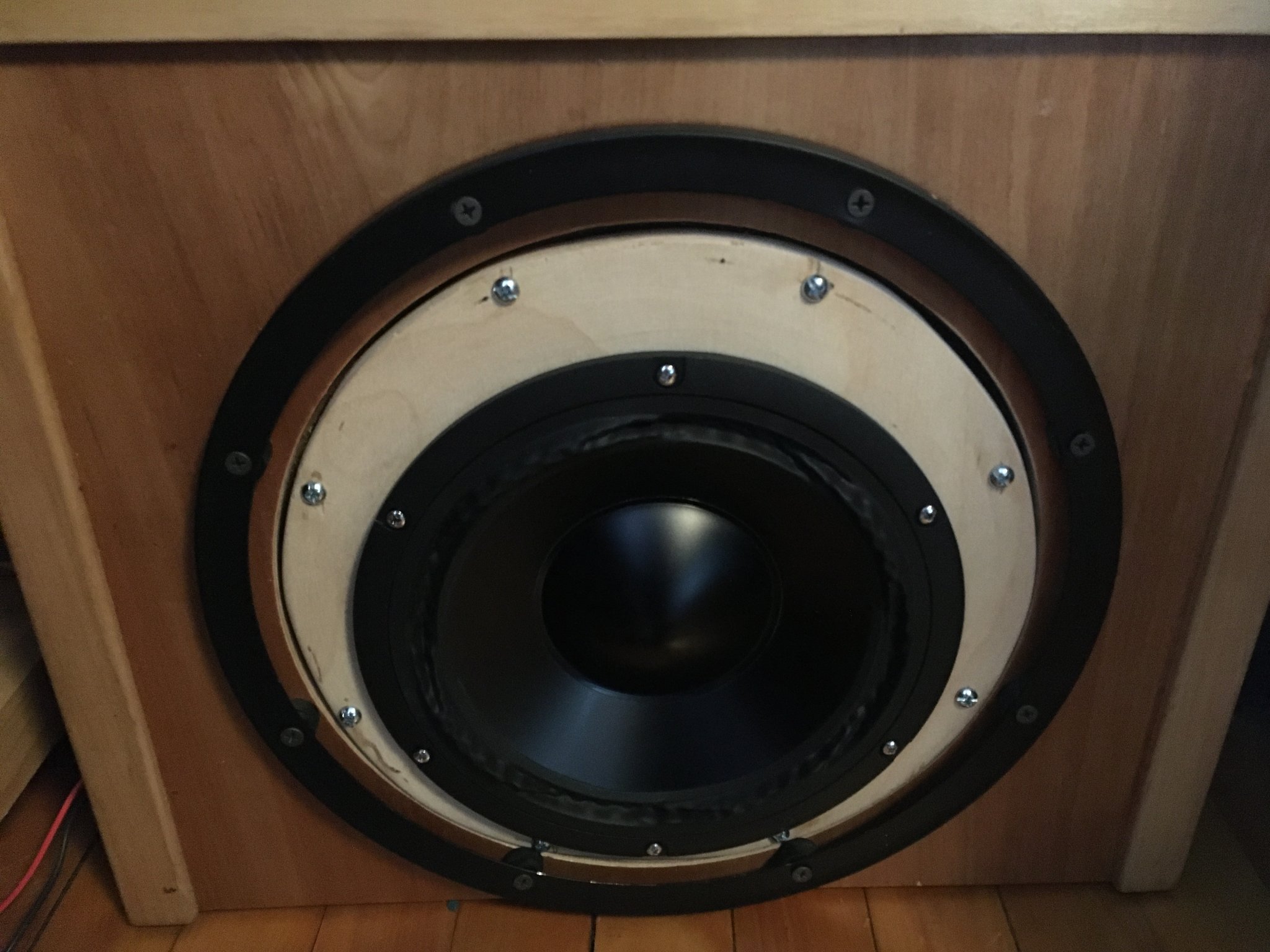

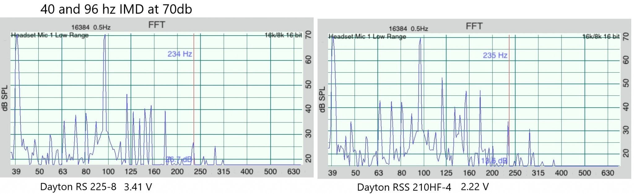

I have found that low Intermodulation Distortion is a good indicator of sound quality. The last couple of years I have been measuring 10-12" subwoofers and 6-7" midwoofers in IMD, I will now share some testing in 8" drivers.
The test enclosure is a .5 cu ft (14 liter) sealed box with the bottom lip of the speaker just 2 inches above the floor. The microphone is on a stand 49"high with the base of the microphone 33" from the driver. A distance of about 1.5m from the speaker to the microphone. As I'm not measuring in an anechoic chamber my measurements are not comparable to anyone else's but comparisons can be made between the drivers I test.
Feel free to make suggestions on what drivers you want to see tested.

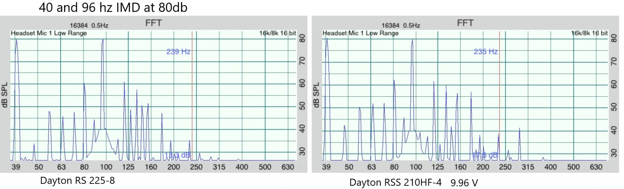

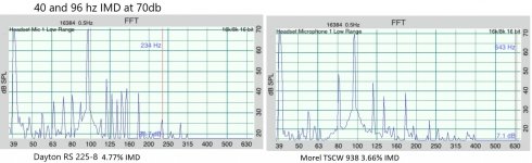

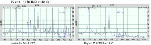

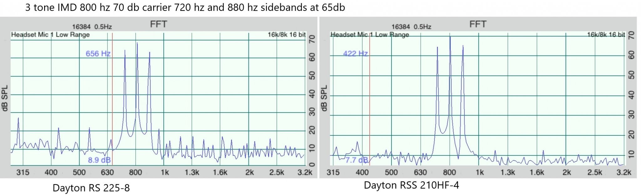

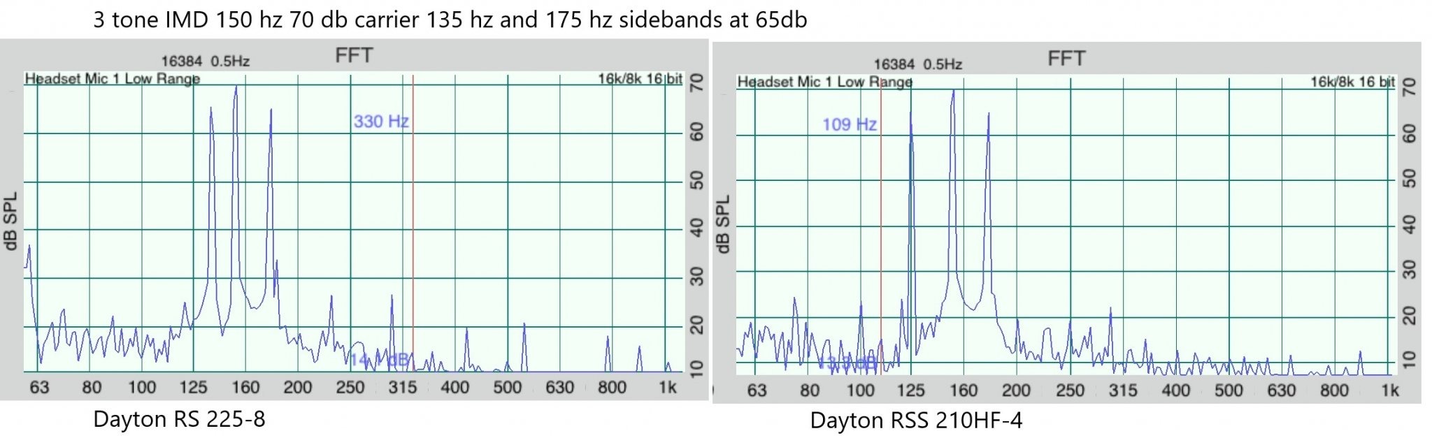

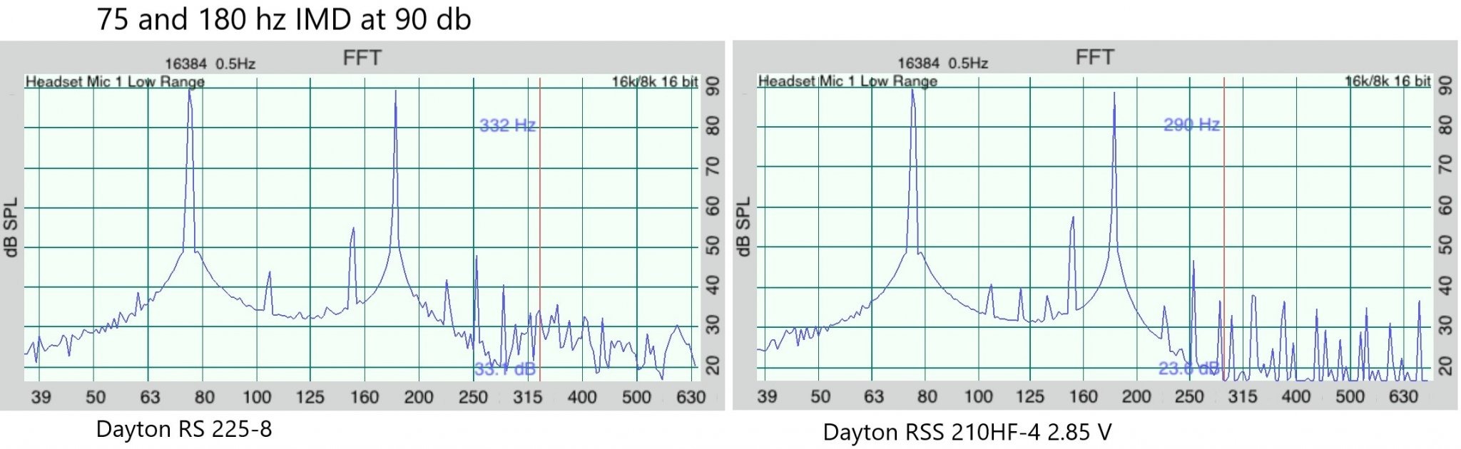

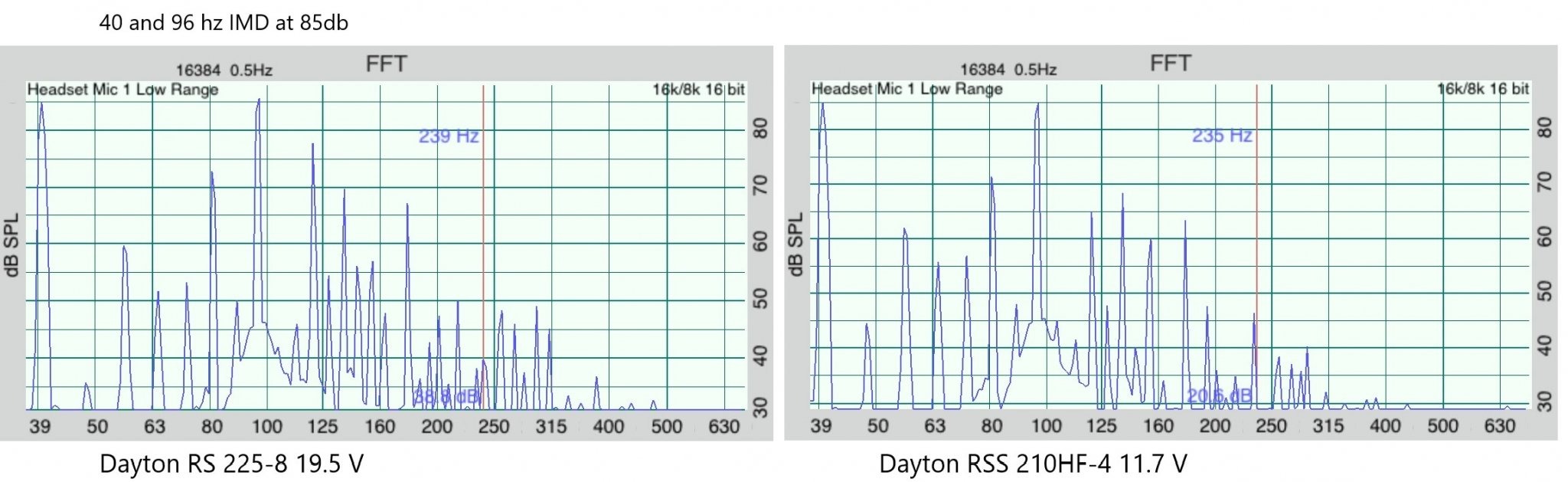

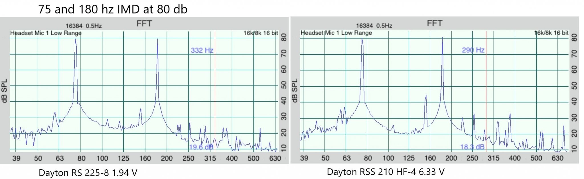

First up is the Dayton RS 225-8 and Dayton RSS 210HF-4. The Dayton RS 225-8 is very well designed and it's high frequency breakup is not as bad as you would expect from an aluminum cone, The Dayton RSS 210HF-4 is running super clean in the 60 and 144 hz IMD test.
Text above edited from it's as bad as you would expect to read is not as bad as you would expect

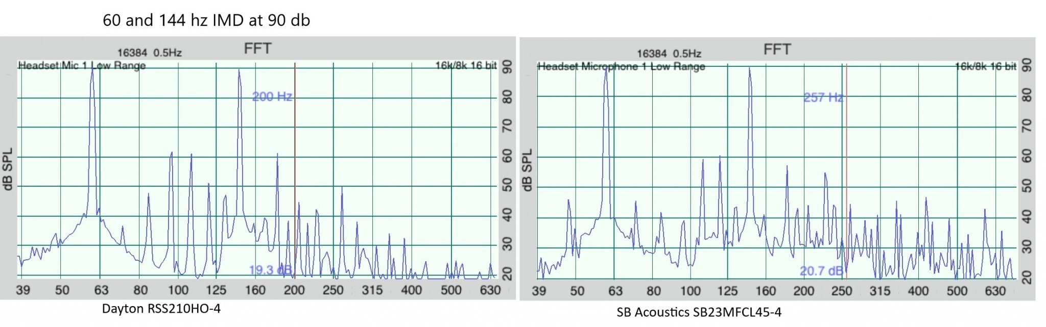

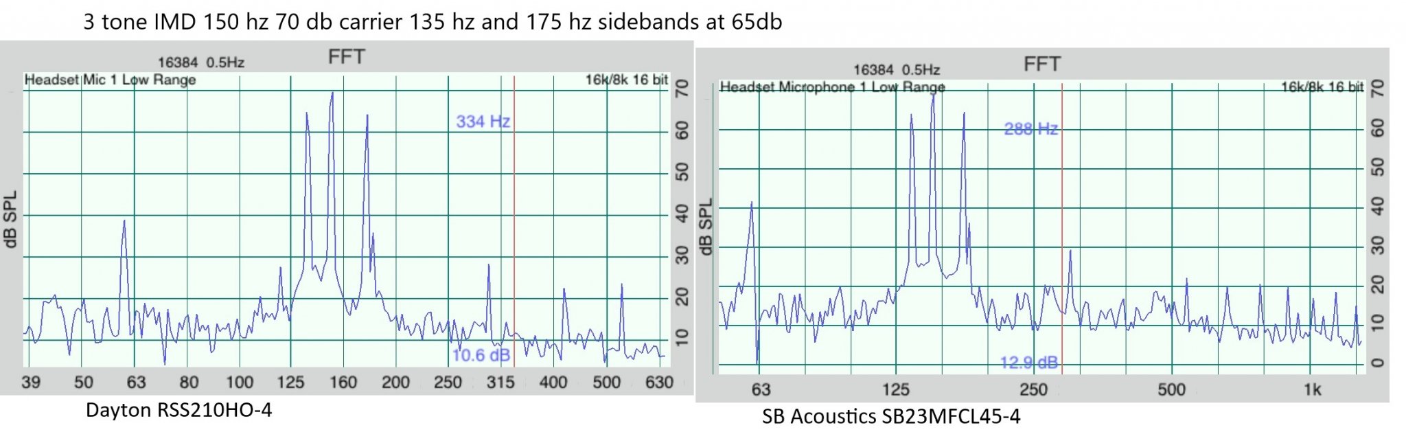

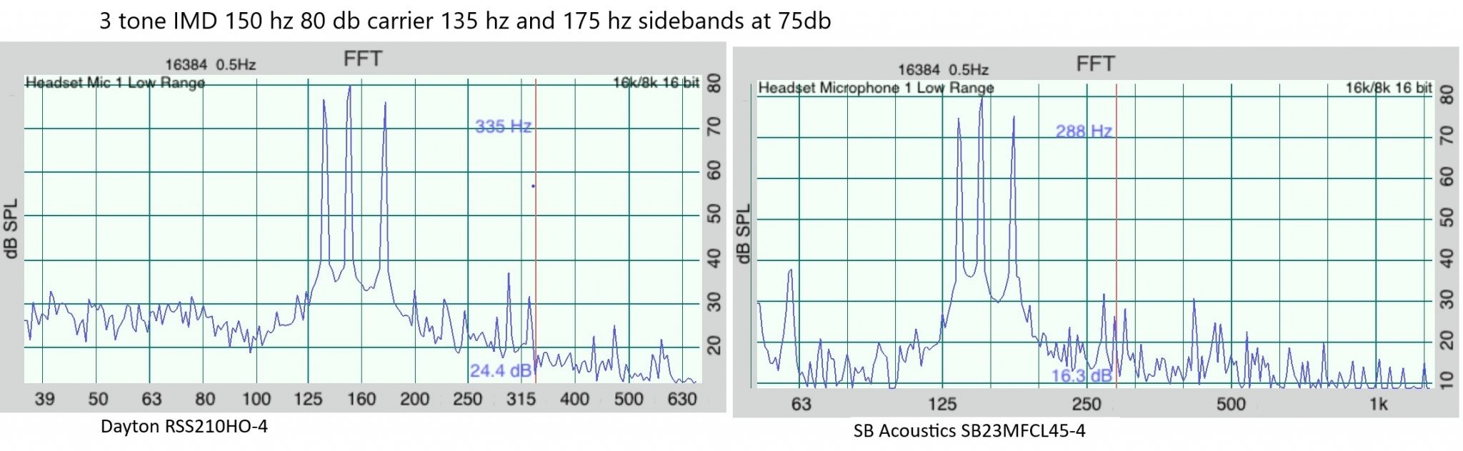

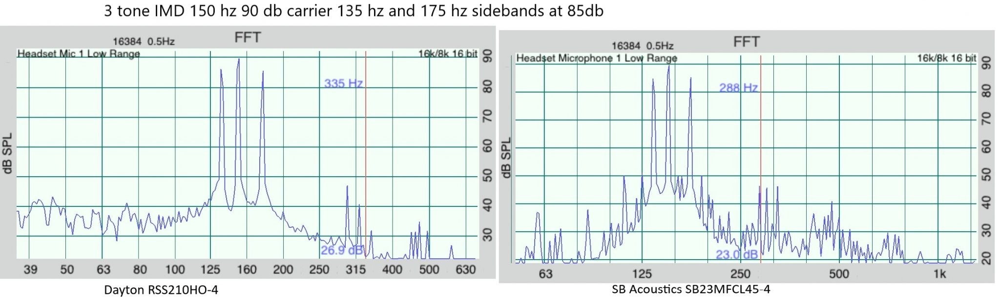

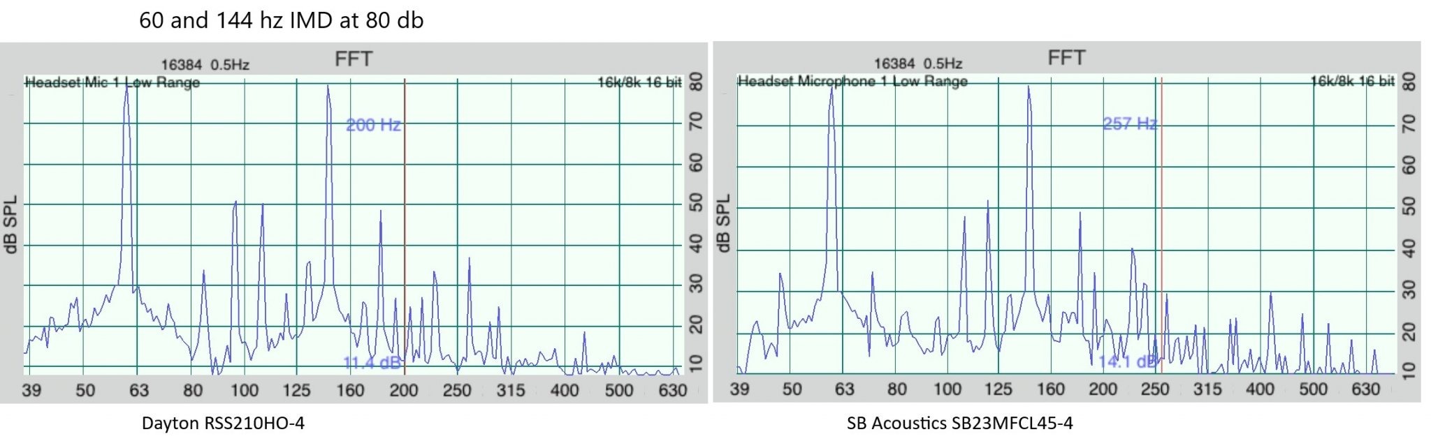

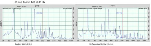

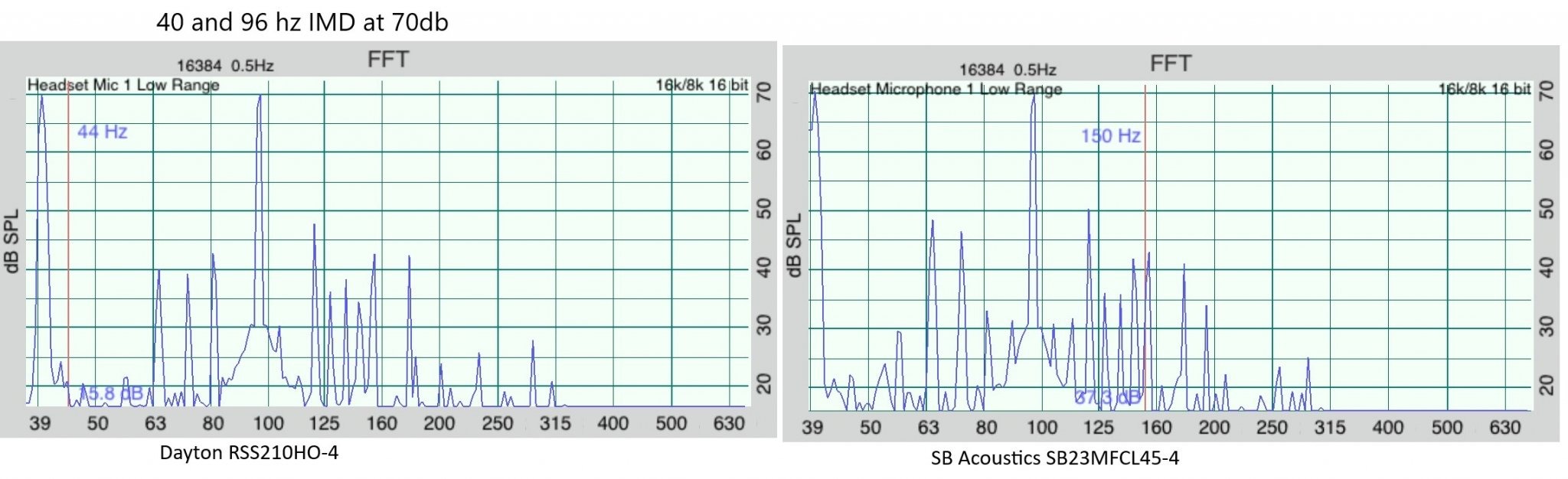

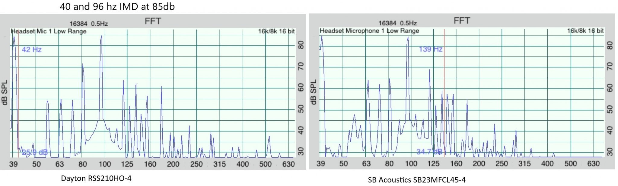

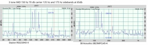

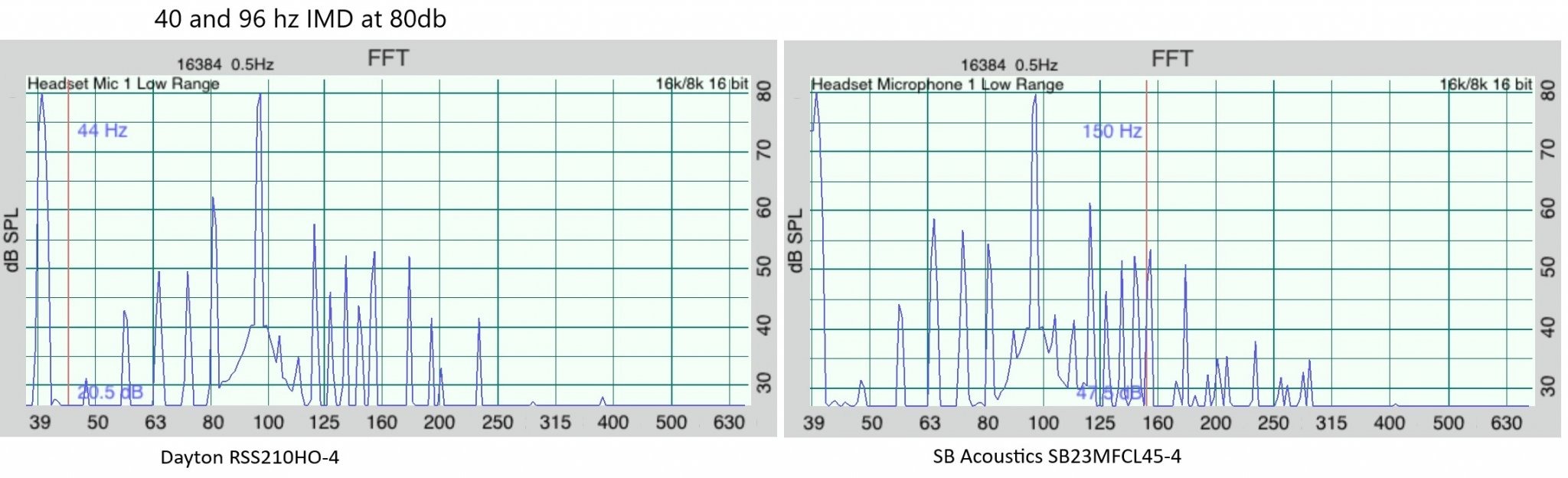

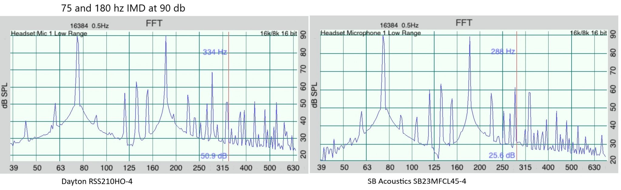

Next up is the SB Acoustics SB23MFCL45-4 and Dayton RSS 210HO-4. The SB acoustics does really well in my application. That is a small subwoofer that can handle a high crossover point of 100hz to blend with a 4" omni full range. Many subwoofers started to sound strained above 80hz (try listening to your sub only playing music and turn the low pass dial past 100hz and you'll hear it) but not the SB, it has a lighter weight voice coil so that it can play better into the midrange area but it also has a 32mm voice coil height that helps it do well in deep bass.
The Dayton RSS 210HO-4 has a few more mm xmax than the RSS 210HF and this can be seen put to work in a cleaner 40 and 96 IMD test for the HO.

For those following the thread the text in post #2 has been edited.
The Dayton RS 225-8 is very well designed and it's high frequency breakup it's as bad as you would expect from an aluminum cone now
Now reads as:
Since I level match all tones 32 would be too difficult but I could do 5. I probably won't get around to retesting any drivers though. What 5 tones can you suggest? They shouldn't share harmonics as I understand.+1.
I wonder if you have the capacity to do 5 tone testing. Or 32 tone testing?

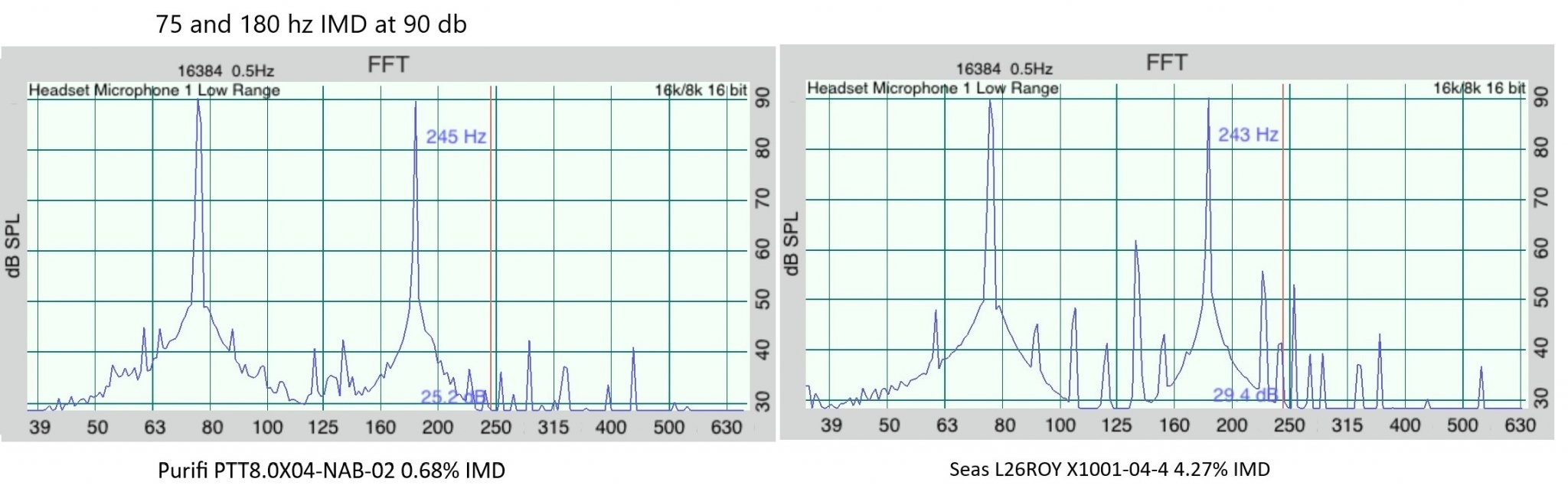

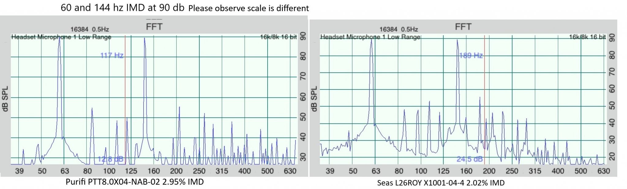

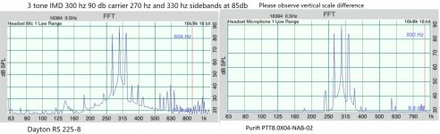

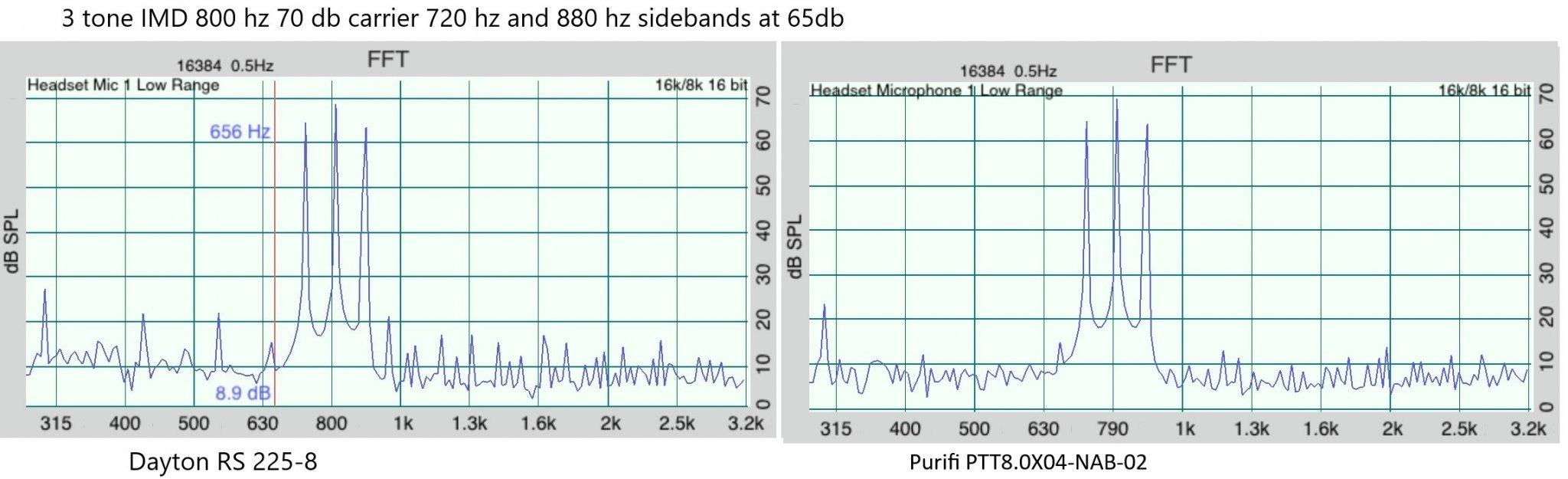

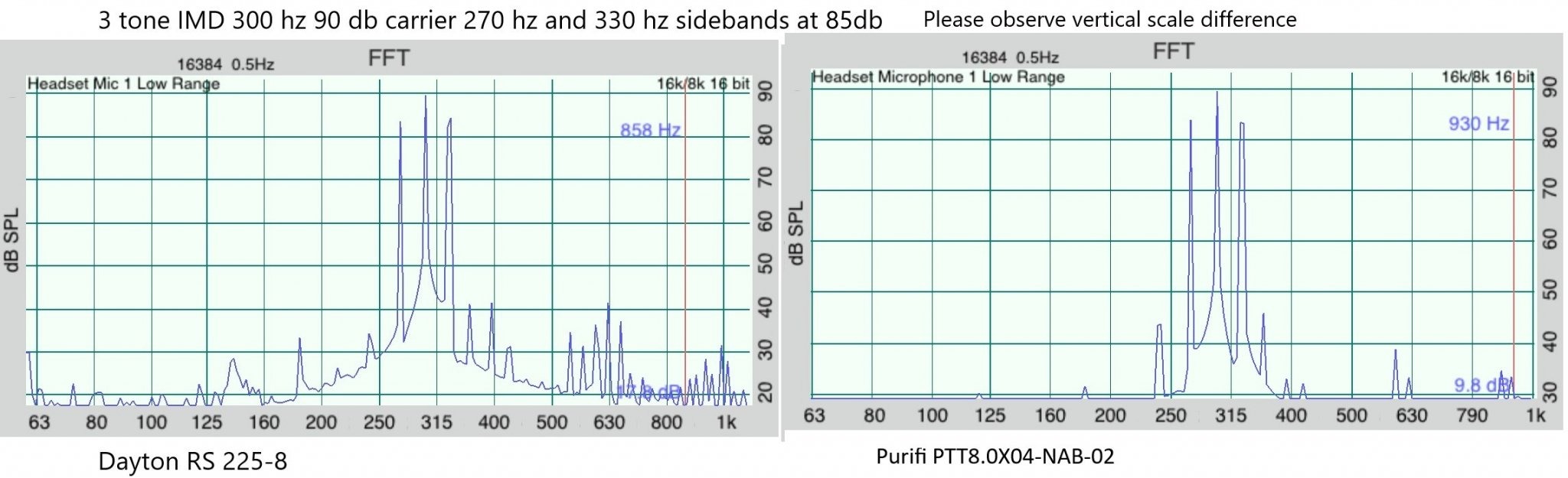

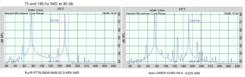

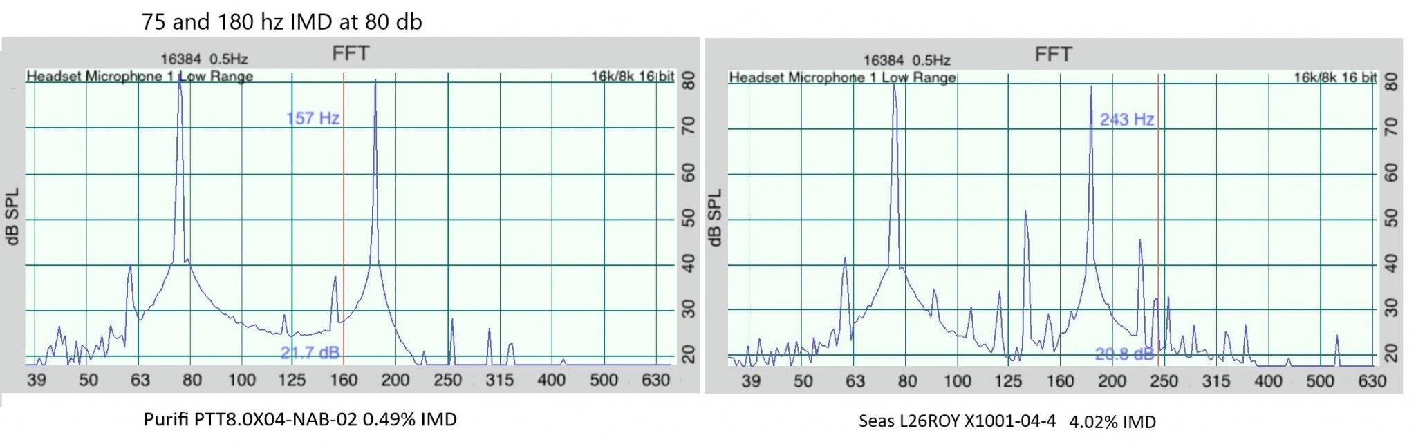

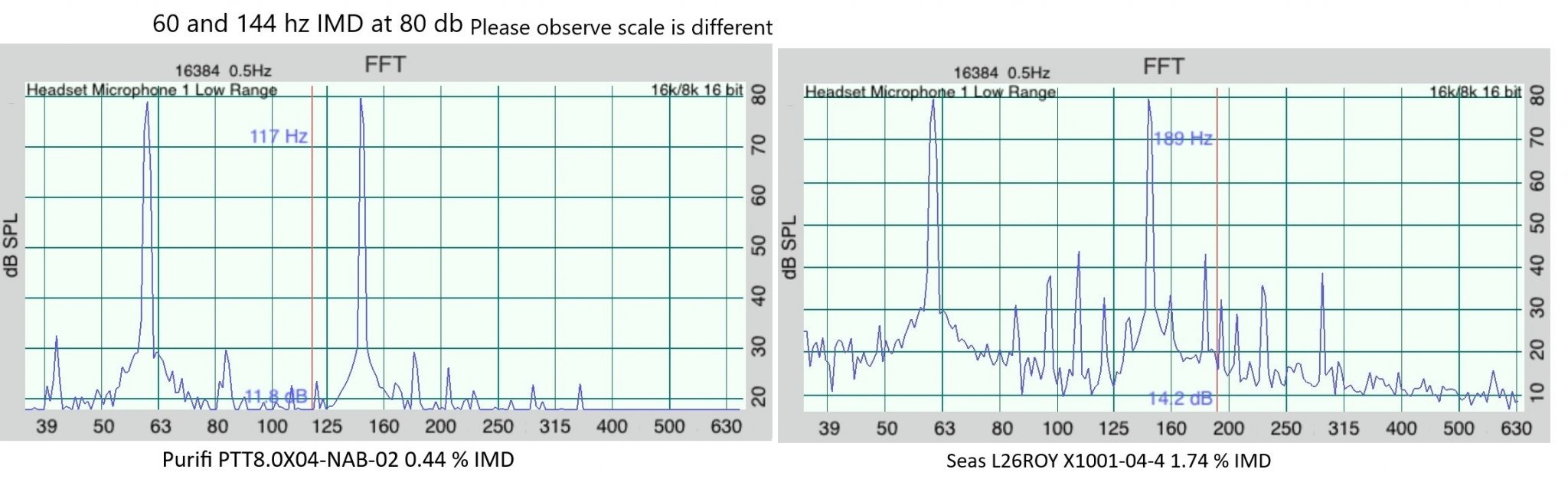

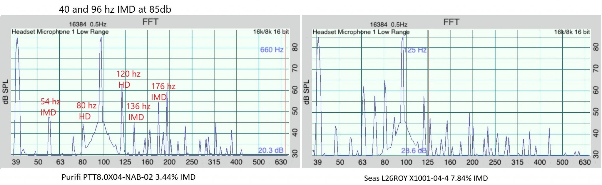

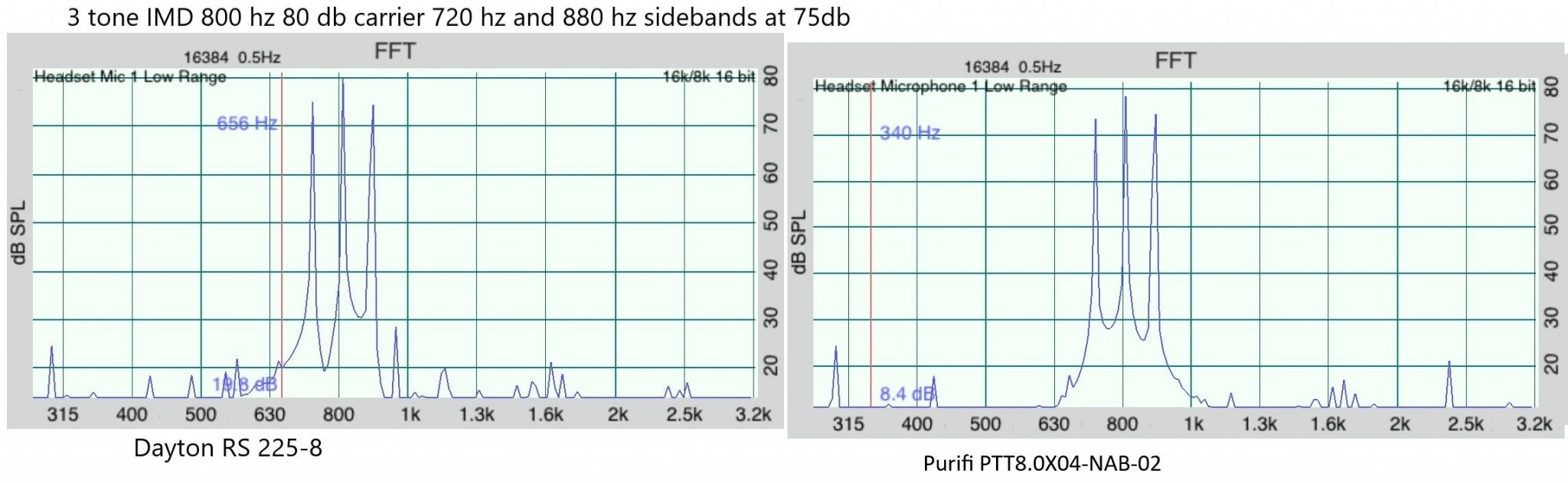

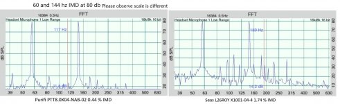

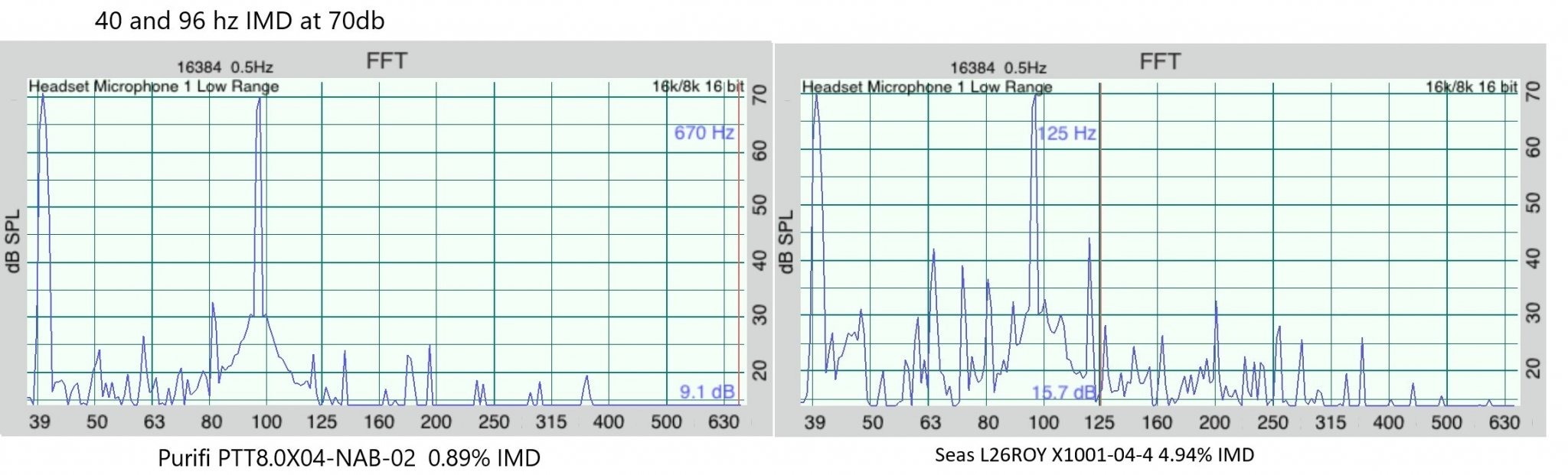

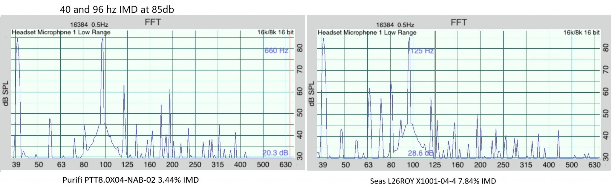

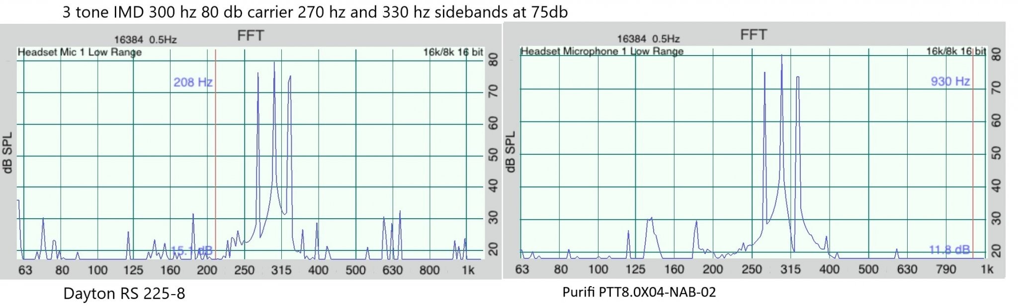

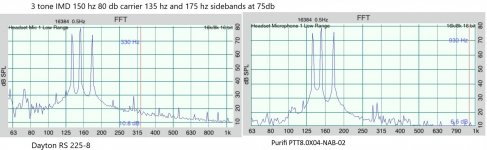

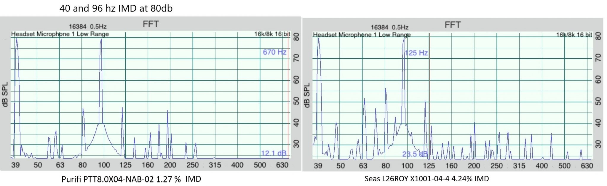

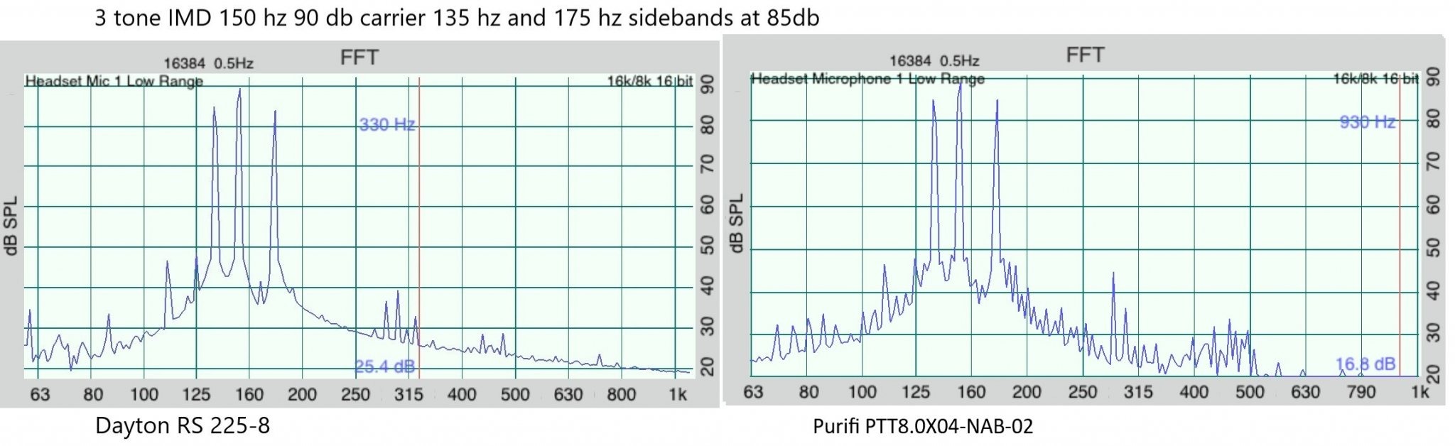

Next up for testing is this Purifi PTT8.0X04-NAB-02. I have given the Purifi a challenging test by comparing the IMD graphs in the bass frequencies with a Seas 10" subwoofer and with a 8" Dayton RS woofer in the midrange frequencies. Please note that the drivers are displayed in alphabetical order. The Purifi is a special driver it can belt out clean deep bass but at the same time it is nimble enough to reproduce the gran cassa or the string bass.

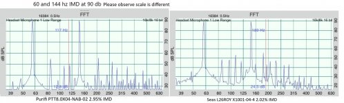

I missed this post. Amazing. So basically the 8" Purifi beats the 10" SEAS L26ROY, except when it goes really loud (running out of excursion). WOW!
Yes tktran303 the Purifi has incredibly low IMD. It also performs better than the Peerless XXLS but I used the SEAS L26roy for comparison in the graphs as the XXLS is getting harder to buy.

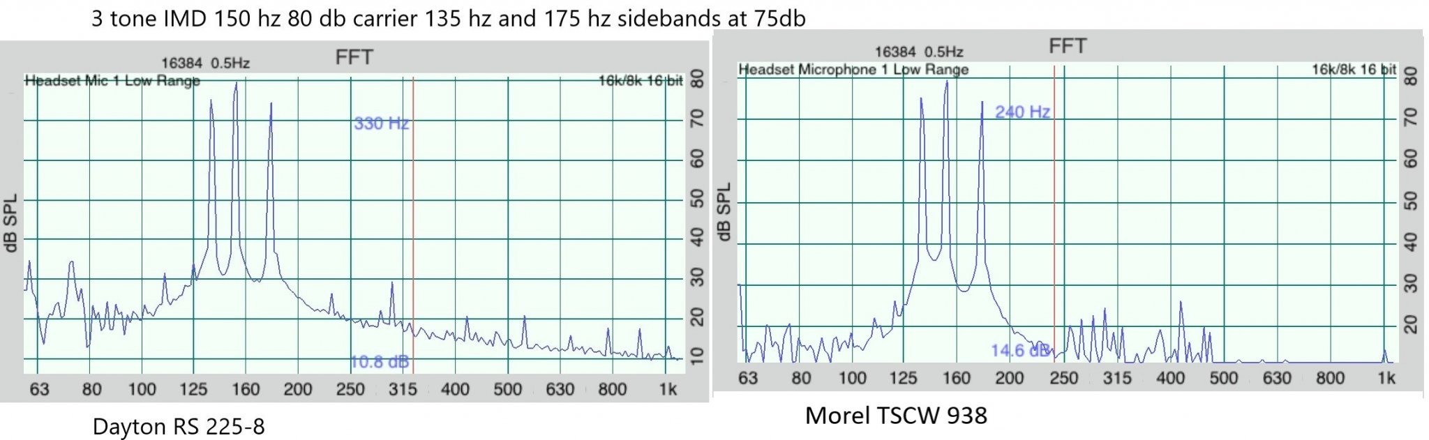

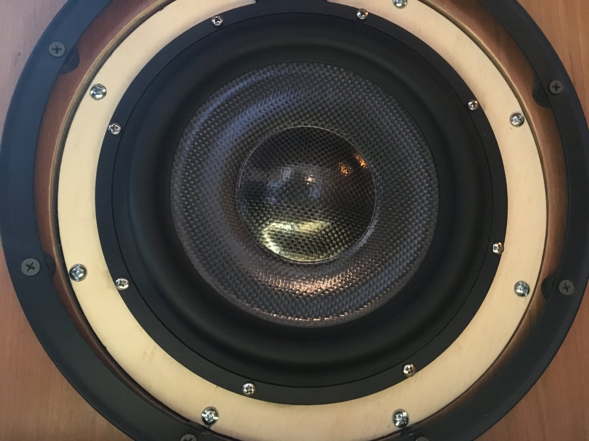

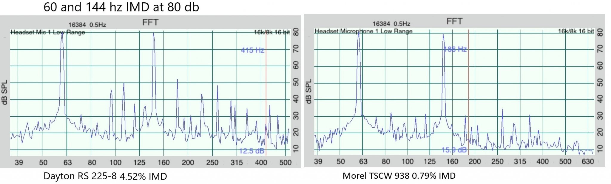

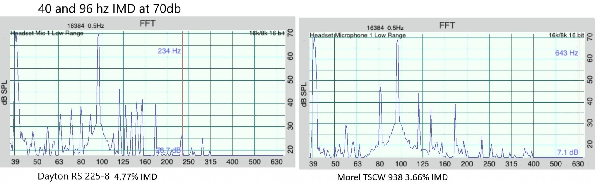

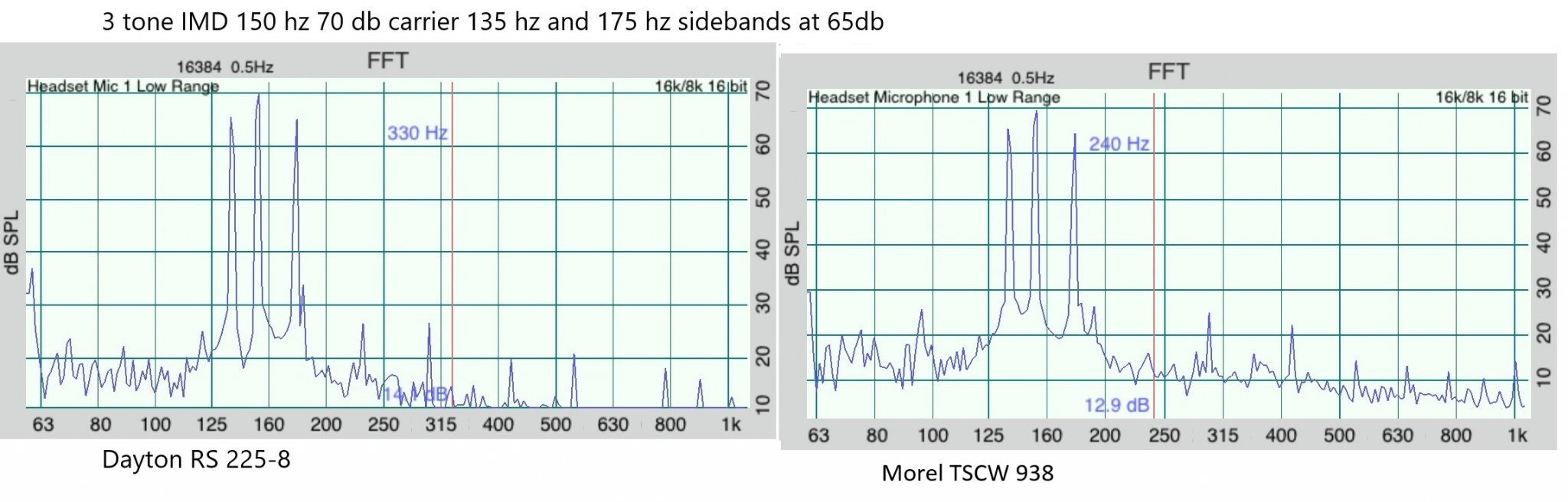

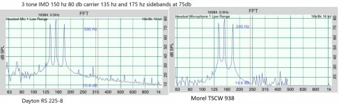

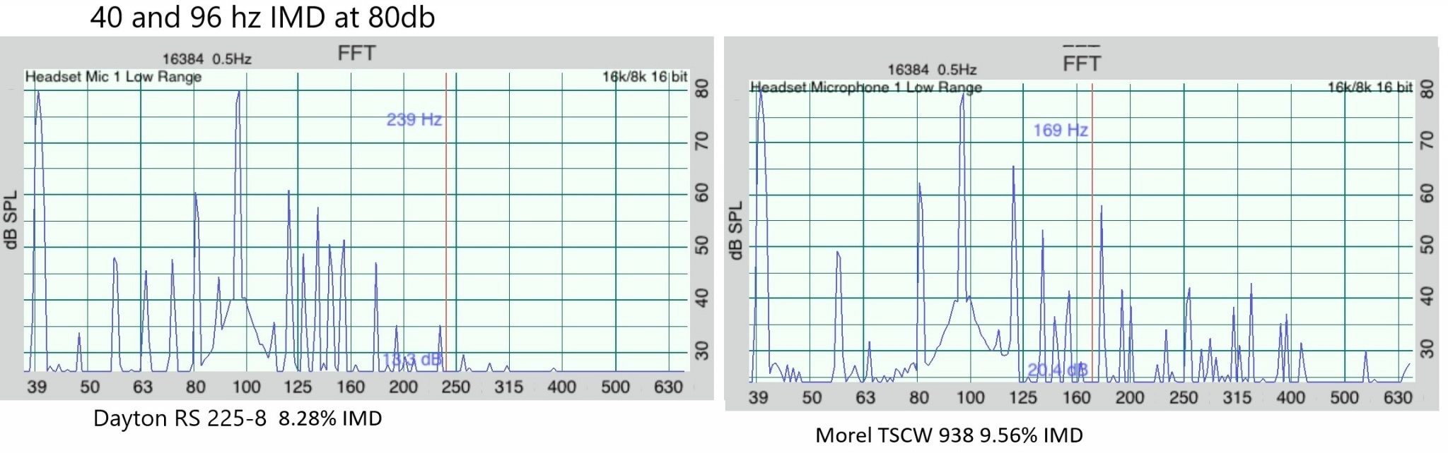

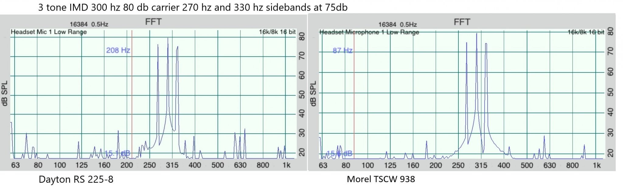

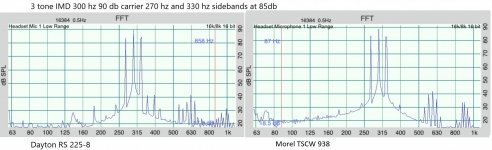

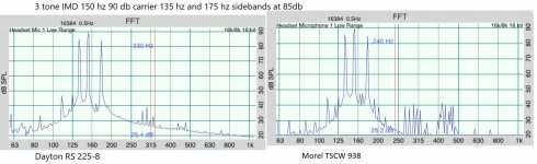

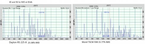

Next up in IMD testing is the Morel TSCW 938. The midbass through lower midrange is very detailed with this driver. Drums, bass guitar and string bass all sound very real. I've compared the Morel data with the Dayton RS 225-8. I've also plotted the modeled efficiency of the Morel in black with the Purifi PTT8.0X04-NAB-02 in grey both in 14 liters sealed. So far my experience has been that woofers sound best in the region of higher efficiency that is just below to just above the impedence peak.

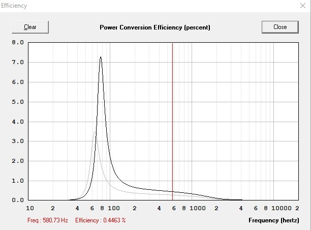

Yes 14 liters. In a cabinet to present a use case, I don’t think anyone would blast 40hz from a single 8” in a dipole.
Each frequency is level matched for example I adjust the input level on the 40 and 96hz tones until they are both 80db or whatever db I’m going for in the test.
I was worried about mic overloading so I test at 1.5m yes I know this allows the room to change the results but every driver sees the same testing conditions.
