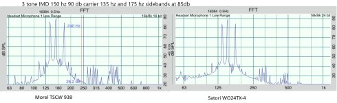

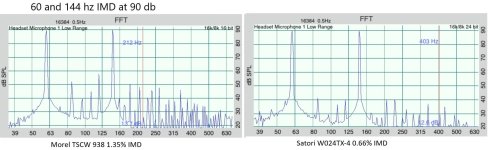

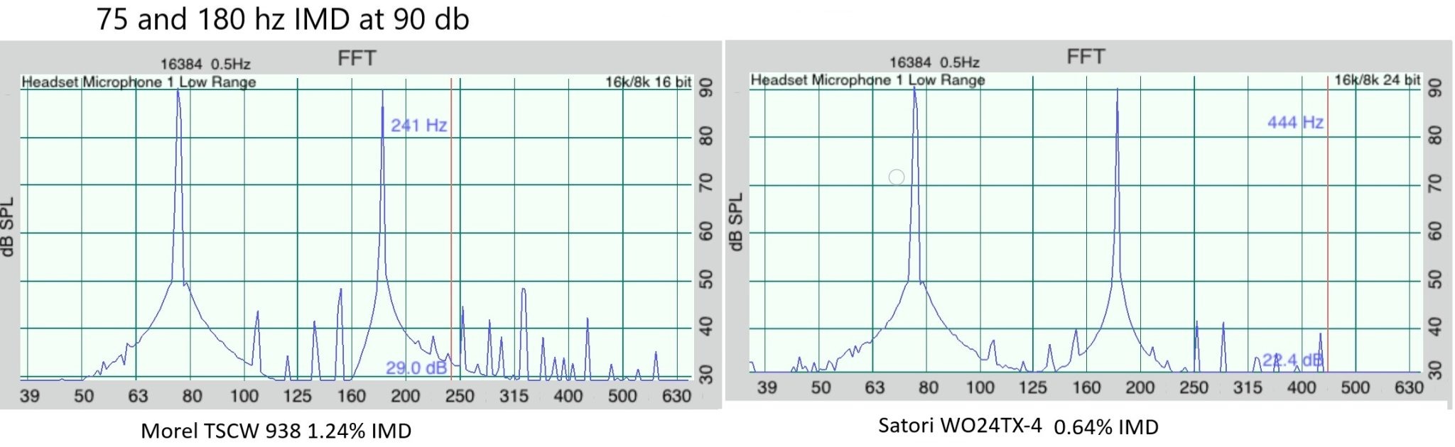

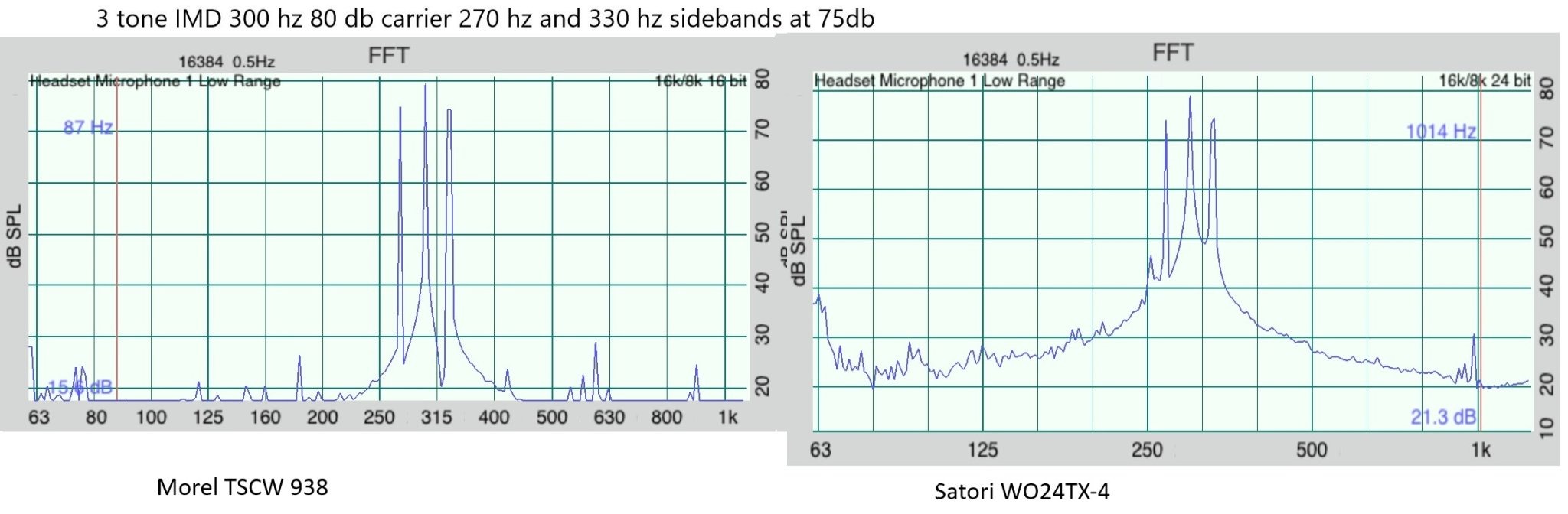

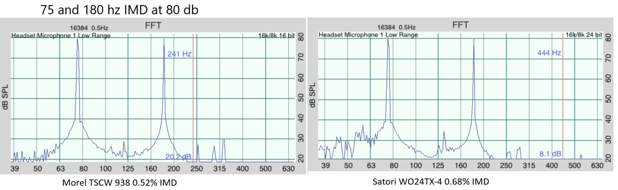

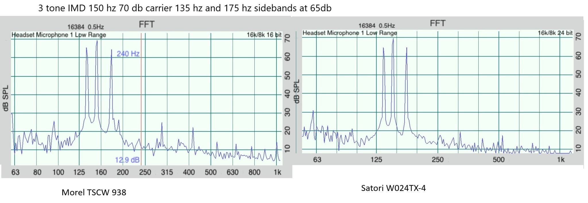

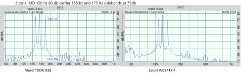

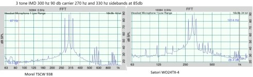

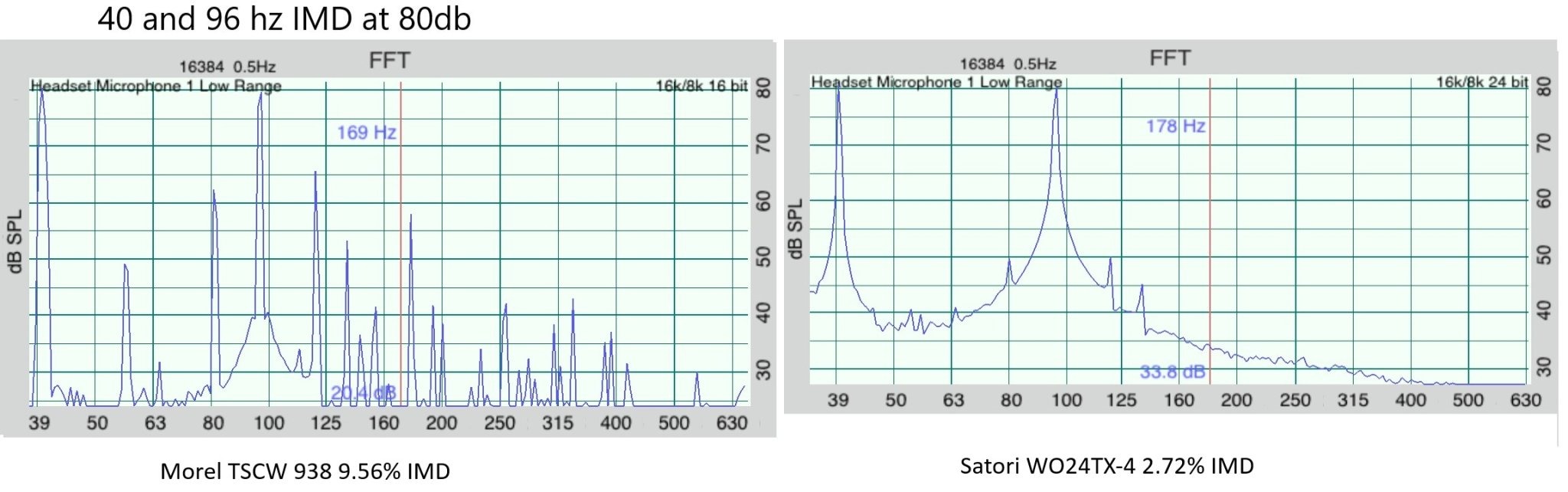

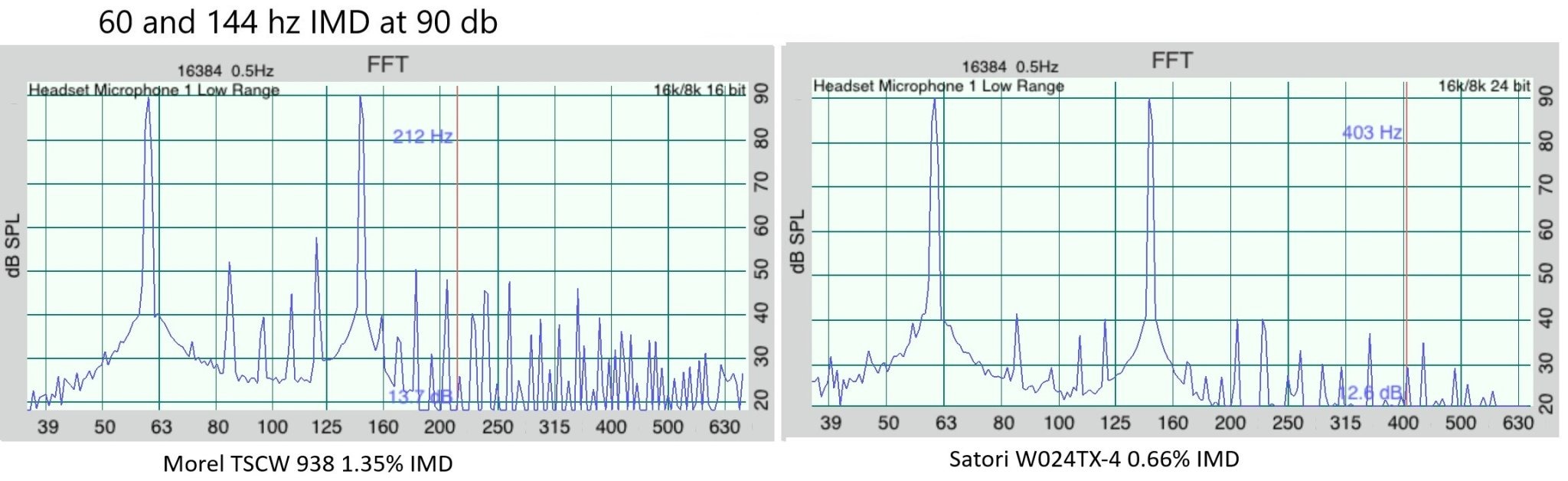

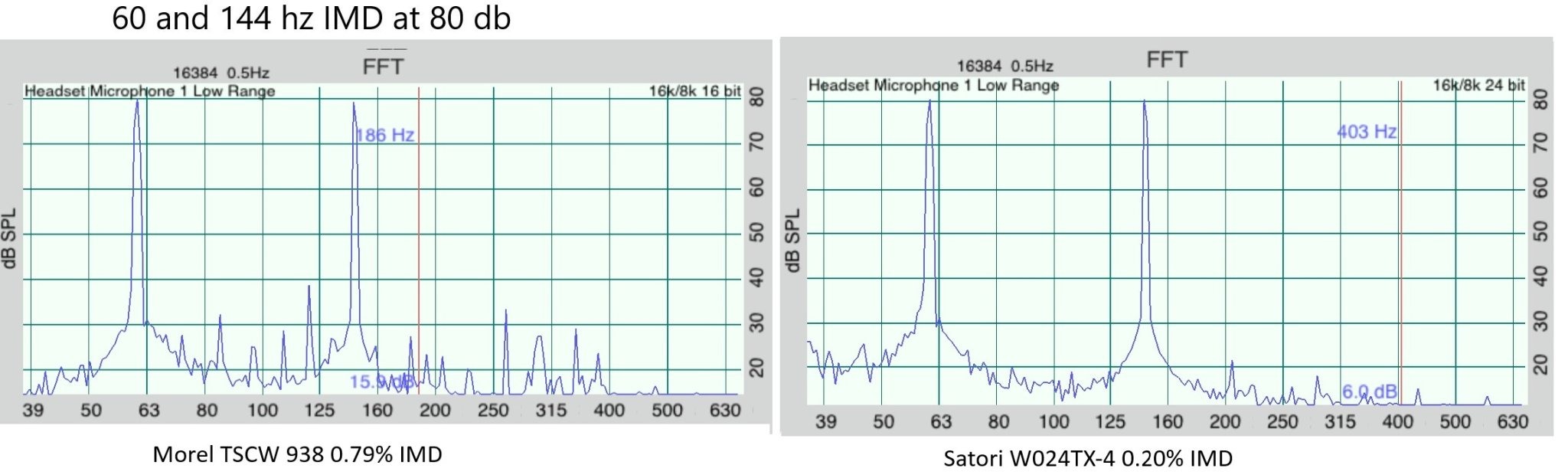

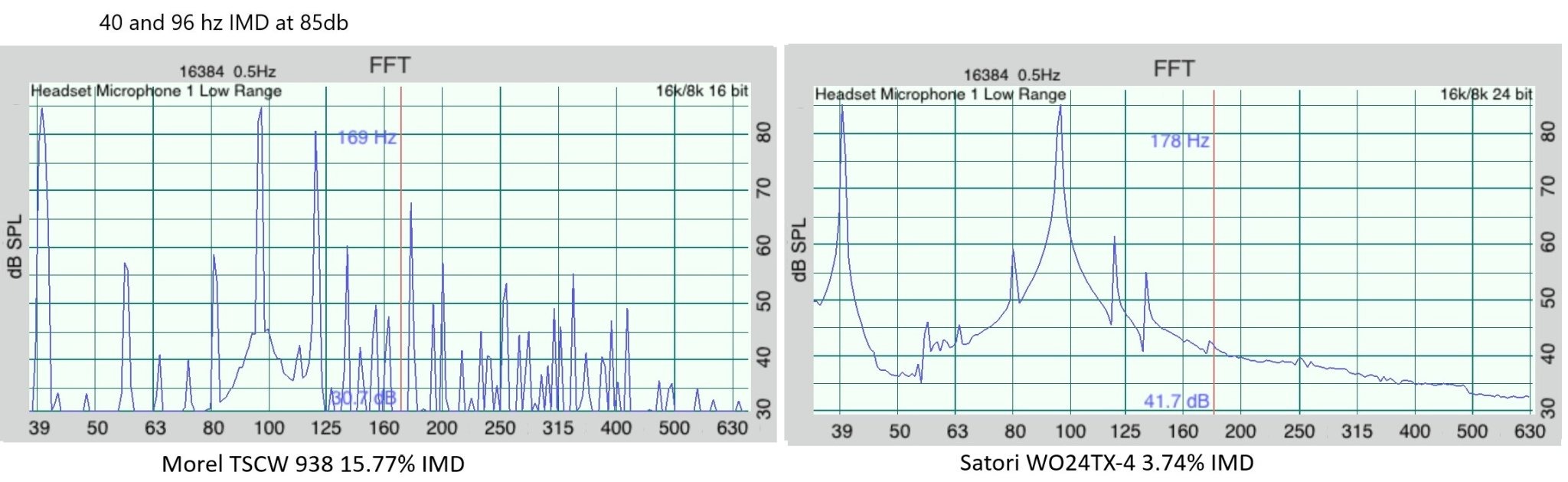

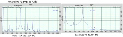

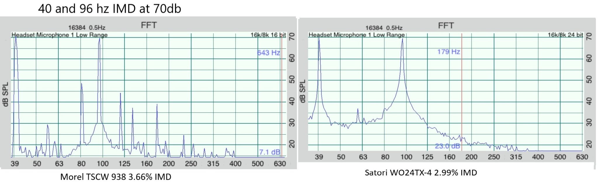

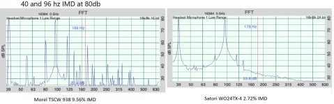

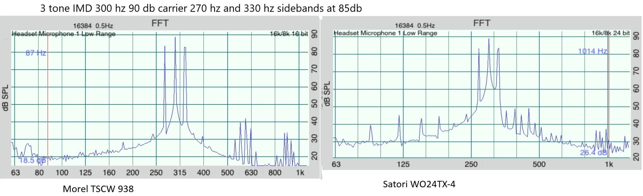

Next up is an IMD test of 9" woofers. This test will compare the Morel TSCW 938 and the Satori WO24TX-4. Both drivers have advanced cones, Carbon Fiber/Rohacell sandwich for the Morel and TeXtreme for the Satori. Same 14 liter sealed box testing method as the 8" drivers was used.
The Satori WO24TX-4 is very capable in clean bass output, average max output from 25-63hz while staying under 5% distortion it averaged 96.6 db while the larger 10" Seas L26 Roy averaged 95.0db. While performing listening tests, I had an issue with the Satori vibrating my light fixtures to the bassline of the music!
In most of the IMD tests the Satori was better, however the Morel was cleaner in the 300hz IMD test. I believe this is due to a higher efficiency and a larger coil. The Morel is less capable in deep bass, however it did excel in something I am unable to measure and that is providing a quicker decay or blank space in between mid to upper bass notes.
