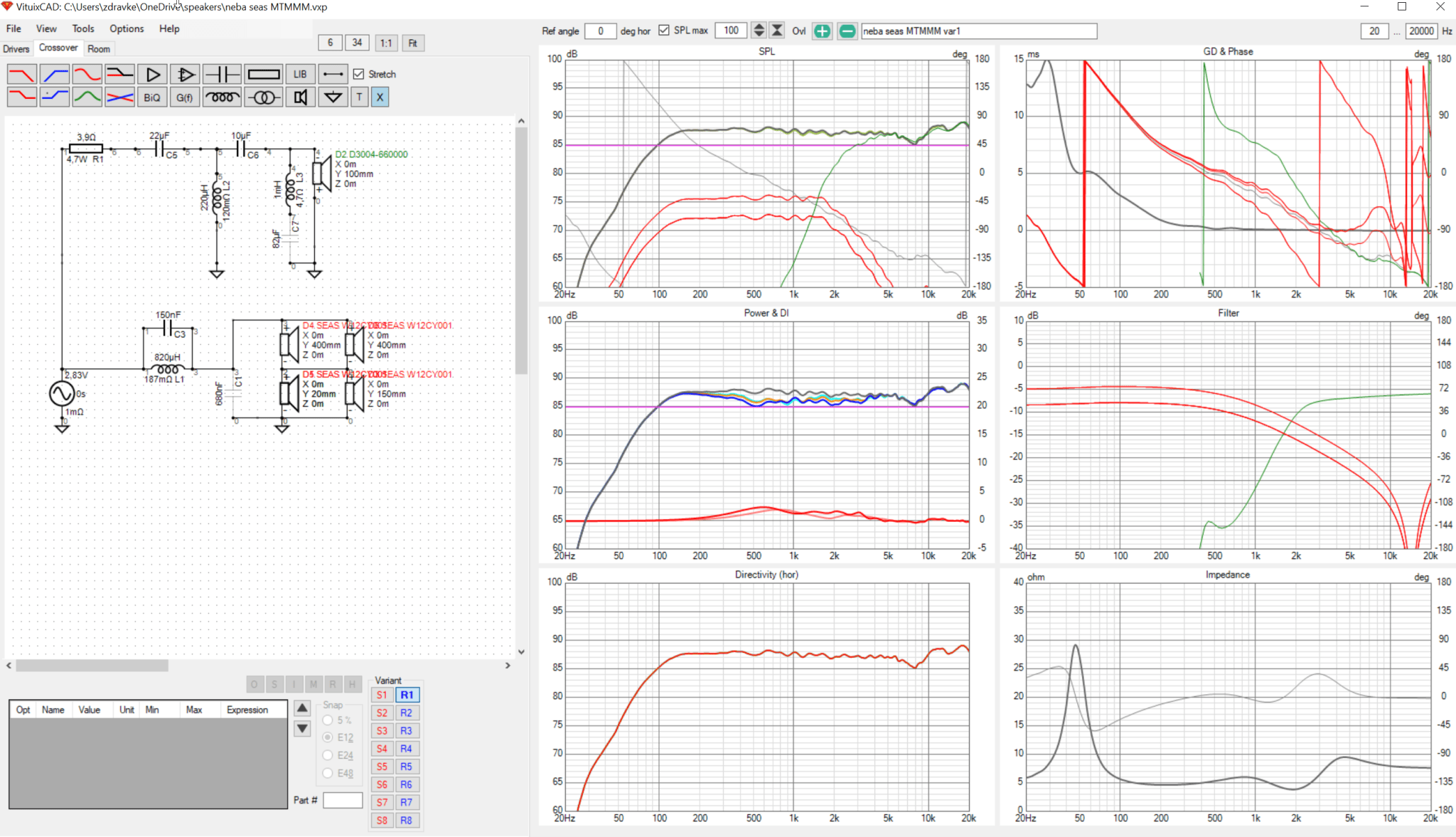

I have been fooling around with virtuix cad, does this setup make any sense at all?
Well, designing some narrow and tall MTMMM or MMTMM speaker requires prototyping and measuring the acoustic response so that you’ll get the crossover right. Baffle step can be a nuisance in such designs. Getting the MTM right possibly more so.
