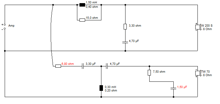

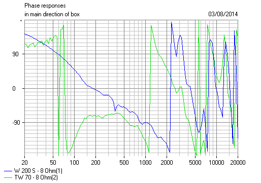

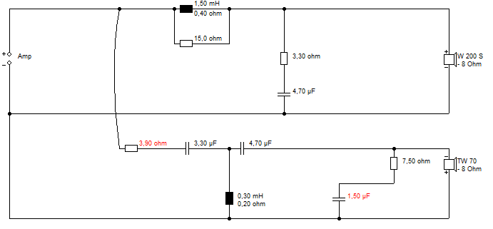

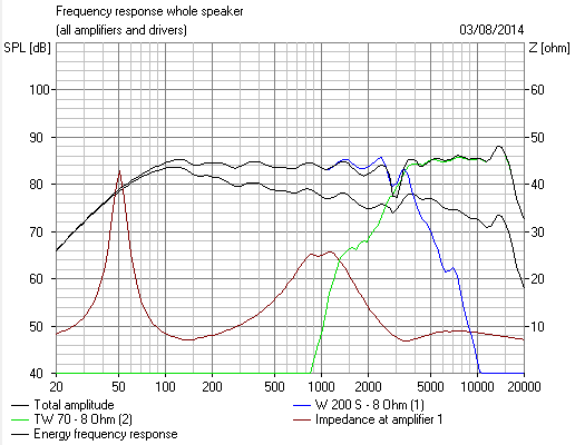

Both drivers can do LR2 at 2khz.....but directivity won't be a good match at the xo point and power response will suffer. The DXT isn't much of a waveguide where controlled directivity is an issue and that 8" woofer Sreten mentions will be narrowing and beaming like a lazer at 2khz so my suggestion to you would be 1.4khz thereabouts with a DIY or modified waveguide of some sorts for the Tweeter. I'm working on similiar with the Scanspeak Disco 8" and the thymphany HDS tweeter in a modded PRV tractrix guide.
IMO LR2 is strictly Mickey Mouse, mayhem13! I don't know why people think it's desirable at all, unless you like the rough sound. You should be using BW3 which has much better power response. LR4 is OK too, and suits 8" bass' steep natural rolloff, but I prefer BW3 which doesn't have the hole in power response at crossover and fills the room better.
If you want good dispersion you should be building a 3 way. As it is, 8" bass plus tweeter is a sweet combination even crossed over at 3kHz.
Look and learn how it should be done below. Sreten was right on the money with the SEAS U22REX. A lovely woofer, though I stick to my little old retro Monacor HT22/8 tweeters for the high end detail. Soft domes sound, well, just like soft domes IMO. Mush! 😀

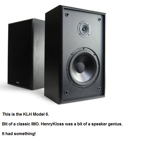

What's wrong with that? Suggests to me that it's got something right! McIntosh used cone tweeters too.
I LOVE this combination of 8" bass plus tweeter. Preferably with a KLH or AR style cone tweeter.
For a two way, it probably has the most balanced sound of good bass and good high end. The little 5" bass jobbies like the LS3/5A or Jeff Bagby's continuum can sound nice on midrange if you don't miss some thumping bass, but this is a sweet combination. I have been adjusting voicing this afternoon, and it's really just the job! One of my better filters, IMO. 😎
