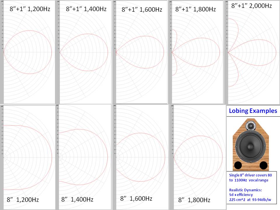

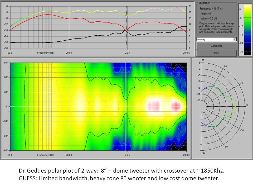

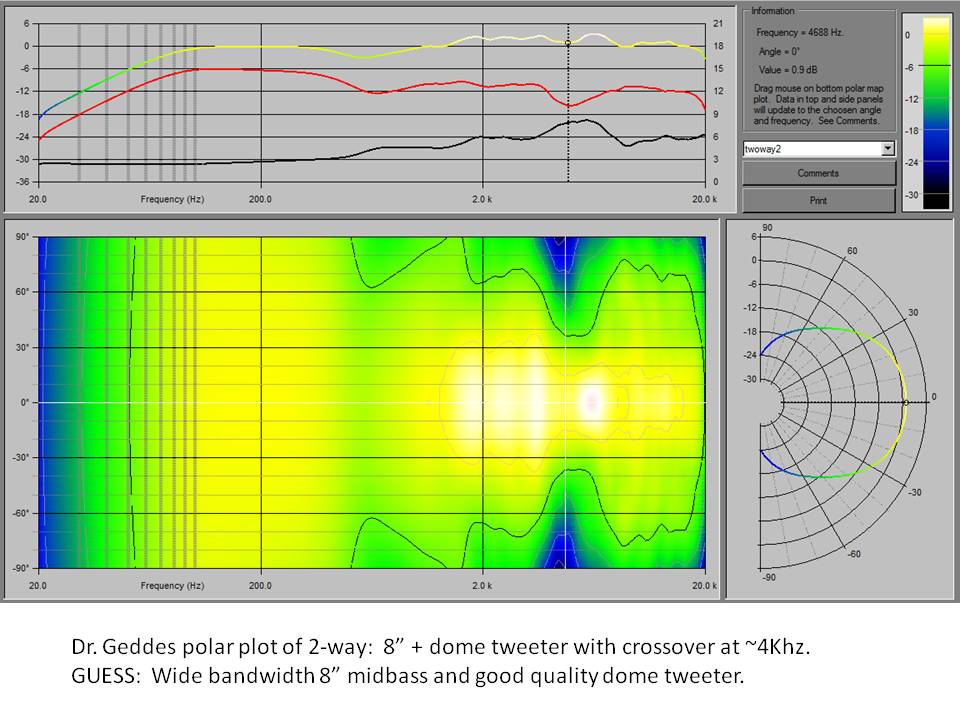

Polar Expedition:
Attached two polar plots that Dr. Geddes uses to illustrate directivity problems in typical 8" + 1" designs. 1) wide BW 8" midbass + good dome at too-high Xover; 2) limited BW 8" woofer with poor polar + modest dome.
A few example lobing plots for 8" midbass, and 8" midbass +1" naked_dome at different Xover frequencies using Xdir.
Naked_Dome vs. Waveguide_dome is one controlled directivity design decision for 8"+1" speakers. At what frequency do you start to narrow the polar response?
Curvilinear cone 8" shows modest beaming at 1,200-1,400Hz, such that with a steep LR6 Xover a robust naked_dome creates a "medium" polar pinch-in over about +/- 200Hz around the Xover frequency. FIGs. 8" polar at 1200 --> 8"+1" polar at 1400 --> tweeter polar at 1600 --> dome's natural physical width sets high frequency beaming for the upper polar response.

Can we see a plot of a wide bandwidth 8'' midbass and a good quality dome tweeter crossed at ~1850 Hz?

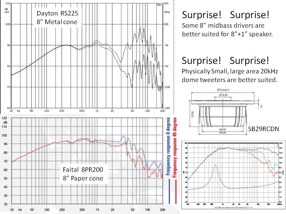

Careful examination of T/S parameters and SPL/freq plots illustrates that very few 8" speakers are great candidates for a 8"+1" design. Very, very few if you want to match the 94db @2.83V sensitivity of the better dome tweeters. Accepting a sensitivity below 90db @2.83V provides many more good options.
I use a 93db/watt Tang Band W8-1808 without a whizzer cone which can reach 80Hz -3db in a 2cuft sealed box, or -3db 37Hz in a 4cuft MLTL. I keep watching for similar full'ish range 8" speakers. Troels Gravesen, Denmark DIY Loudspeakers website worked with ScanSpeak on a custom high efficiency 8".
The new Lambda TD8M with 20g Mms and 76Hz Fs does not catch my interest. AES forum stated this speaker has shipped to OEMs.
