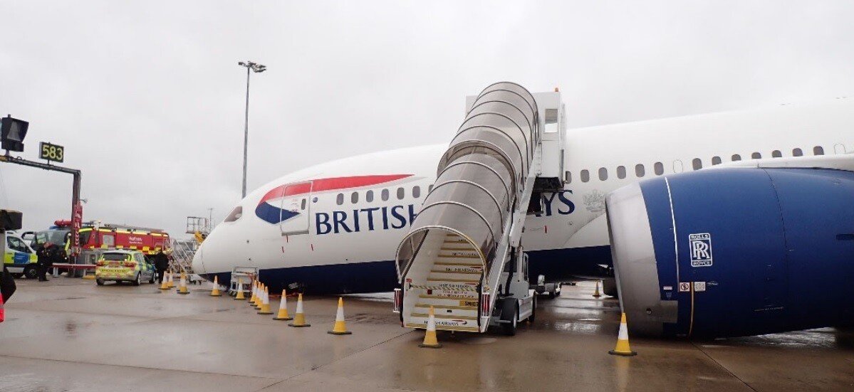

Just put this pin in that hole.
"Boeing 787's landing gear collapsed ... short mechanic asked a taller co-worker to insert a lock-out pin into a hole he couldn't reach – ..."
Engineers' Laurel and Hardy moment caused British Airways 787 to take an accidental knee • The Register
This had happened before.
It was very easy to confuse those two adjasent holes: the wrong one was more attractive.

Parker Hannifin make hydraulic stuff, pumps, valves, cylinders and so on.
One of the big names in that line of business.
It was part of Eaton, currently I did not check who owns and operates it.
Parker Hannifin is a publicly traded company and one of the largest suppliers of hyrdraulics, landing gear assemblies etc.
It's a first rate company, absolutely six-sigma.
A good metaphor for the political situation here quite frankly . . .
More worrying is that BAe had been given 3 years to sleeve the wrong hole and hadn't bothered.
