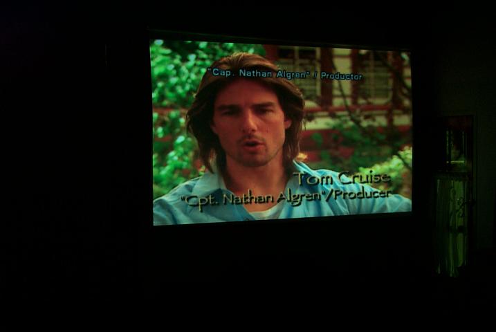

Hi Lesko !
Thanks, I´m using this one but beware of using it with the Lilliput with PAL signals. With NTSC component signal it generates a 720*480 VGA signal that works well with the Lilliput, but with PAL signals it generates a 720*526 VGA signal and the Lilliput cant display it. The Lilliput displays an OverRange message with this adapter receiving a PAL signal.

The screen is a Window Shade (I think it is normal BlackOut cloth) that I pick very cheap at wallmart. It´s 1.85mts wide and roll up completely by pulling the screen down shortly and releasing it. (like the pro ones)

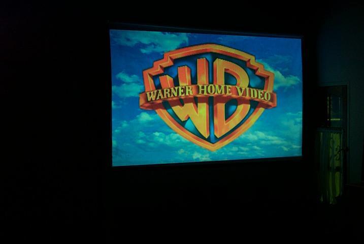

Flesh tones, Flesh tones!
Give us some bikini pictures in all the different lights so we can see the quality of the 400w!

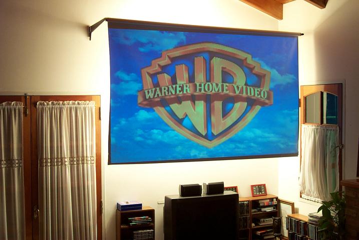

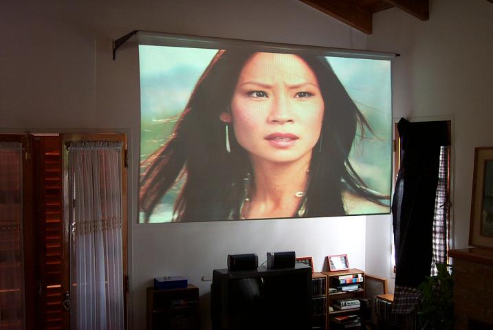

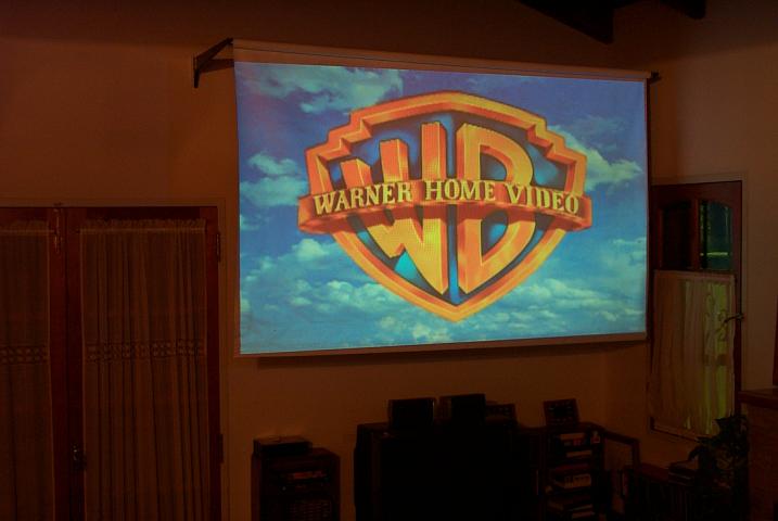

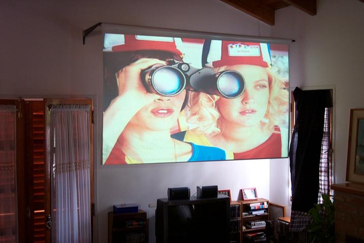

what are you using for the backlight, What is the main reason for it ?
Hi, MisledAaron, Thanks. The backligth showed in the pic it just part of the room light, but it gets covered with the screen when we use the projector. I put this pict just to see the diference in bright with diferents lights on the room.

The component to VGA adapter do not help on brightness nor contrast but it does a lot on sharpness and definition.
Lilliput Composite Video In is poor quality. I can compare it now using the same VGA Boxr with the composite out of the DVD player.
The same composite signal sent to both (the LIlliput via VGA box, and to the Lilliput via composite In) brings a much more sharp image on the VGA input than the composite in input.
So it means that the onboard controller on the liliput have a very basic support for composite video conversion.
But DVD COMPONENT signal to box and then to Lilliput VGA in brings a wide much better sharper and defined image (it´s like using an HTPC vga output but with my home DVD player !!).

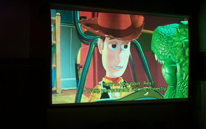

New pics
I've new pics from Toy Story.
Looking for Nemo have much better colours. I used it in one of the first run test with the composite video input on the LIlli and my wife and me get blowed away .
I'll try to get it again to watch it with the component to VGA adapter and take some pics.
