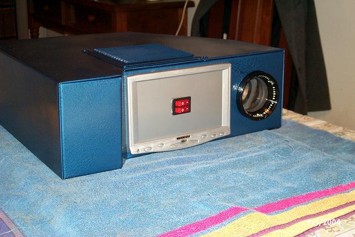

I have a few questions...What about the heat, does the lcd stay cool?... is that 2 planes of glass befor the lcd? ... are you using tempered glass?

I´m using an Asbestos replacement wich aisle the heat really well. I must tweak a little the air convection (I must add some intake holes in the back side and assure outgoing air is not retrofitted (feedback). I´m using 2 pieces of normal 3mm glass. I need to add some UV filtering soon to protect the LCD.
From condenser back to first fresnel the distance is 16cm.
What's the distance from the condencer lens to the lcd?

don't you have any thermal probs`? cos i cannot see where the hot air is going out.

The hot air is exhausted from the top side. There is a 10cm x 10cm vent hole.
In the first photo on page 2 you can see the Light box fan have an air convection tunnel towards the top (aisled with asbestos because the air coming out is really hot. The Panel Box fan only have a metal tunnel (without asbestos) because the air is just warm.
it´s on a test period, it may require some redoing with a better design.
You can see the top air vents here...

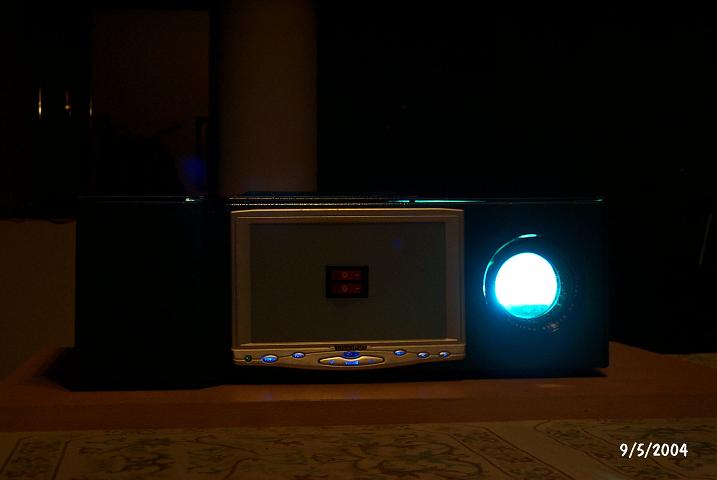

What is the result with light in the room,can you post a picture.

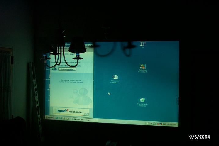

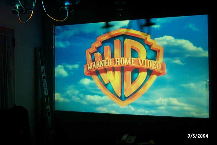

Thanks, Thats are test pics because I´ve not received the First Surface mirror and I´venot fixed the lens.
I´ve to build the focusing system and I´dont know how to make it yet.
i´ll be posting definitive results with a FS mirror and a well focused projection, as soon as the mirror arrives.

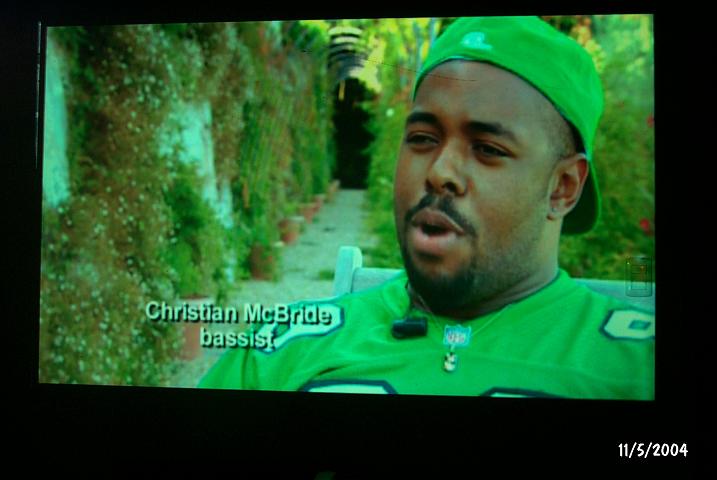

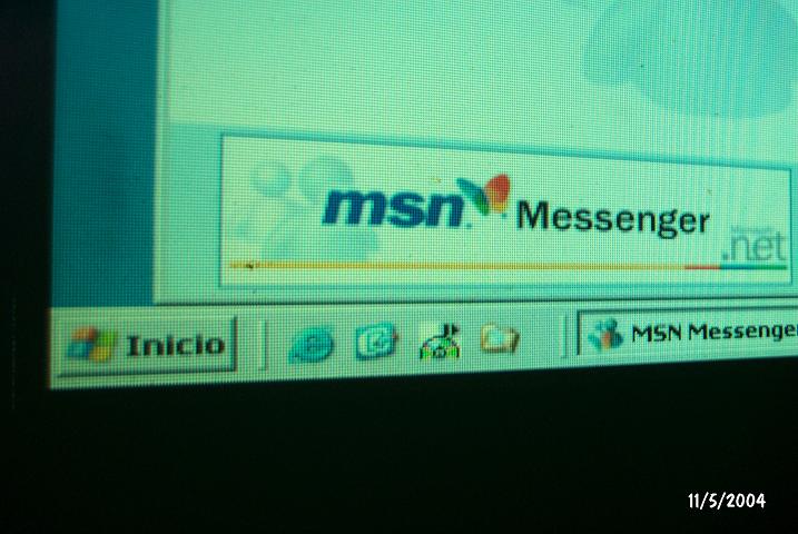

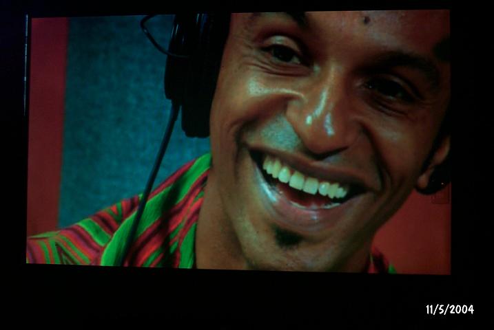

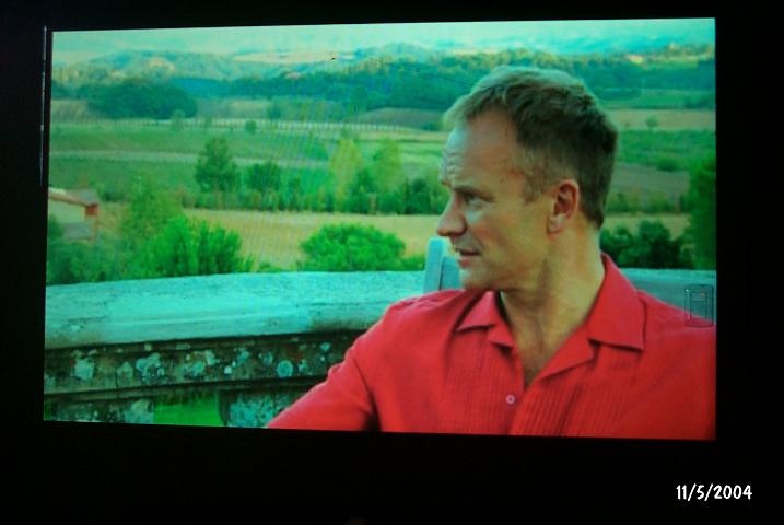

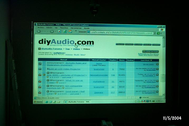

FS Mirror arrived !!!!!
I've taked some pics tonight with the FS mirror just arrived !
Thanks. Regards.
The mirror has just arrived today. So, I put it on the projector but I'm afraid it is not aligned perfectly at 45°, just for a test run.
The lens is not fixed nor mounted yet on a focusing mechanism, so it's hard to get the image completely focused.
