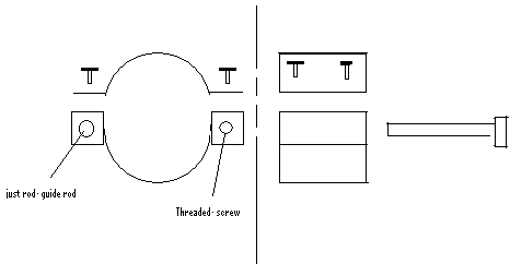

r u looking at having at mannualy moved or with a little motor.
I remember seeing someone doing a mannual one (prob ACE!!),
they had felt inside to help it move freely. and not let light through.
Sorry for the picture as i just quickly drew it up in paint.

MisledAaron : Thanks for the link and pic .
I´ll try to make some like this and add some kind of threaded rob with a knob to move the lens to the exact focus position easy.

Good work Bfourcade,
I have an idea that you may wish to consider for a lens mount.
Here it is:
Take a two pieces of 3/4 inch thick or 1/2 inch thick plastic like delrin or teflon or what ever you can scrounge up as remnents from the local plastic shop.
Then cut two exactly equal pieces of the same size so that they line up to make a mounting plate that is of the size that you want.
Then take an accurate measurement of the surplus shed 240 copier lens on the outside middle diameter of the lens body.
Mine is 3.112 inches or 79.04 mm. Most should be close to this size within a couple of thousands of an inch.
Then get an accurate compass and scribe a circle as close to the size of the measurement that you can with the center on the joint where the two pieces of plastic meet. Then cut out the hole from both halfs a little inside the line.
Then duck tape the ends of the lens shut to seal out anyuthing from getting into the lenses and wrap a thin piece of high grit sandpaper around the lens body and use it ot sand the holes to the accurate size. If you make the holes a little too big take a slight amount of material off from one or both of the plastic pieces where they meet each other. The mounts shoud fit snugly around the lens body with only enough play to let it move with some resistance.
Then drill holes into the pices to mount them in the closed position onto the projector body at the appropriate location.
The fit should be tight enough to keep the lens in place but be able to twist and move it to focus it.

Misled Aaron and Hezz: Thanks for your great ideas on the focusing mechanism I´ll be trying those next days. Thanks!

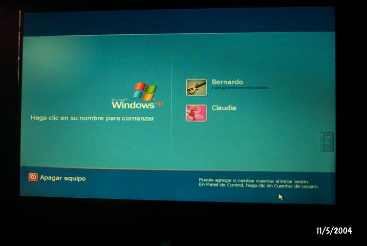

It´s 400w, 6000K and 90CRI so may be the blues changes a little due to the high color temp.
Or maybe is the normal glass sheets used to heat protection on the panel case.
Wich is the optimal color temp for a projector lamp ?
Hmm maybe, 6000k is getting abit blue, if you get a hqi-tsd lamp you get a better colour temp and another 11000lumens for the same wattage with a 90cri and up.

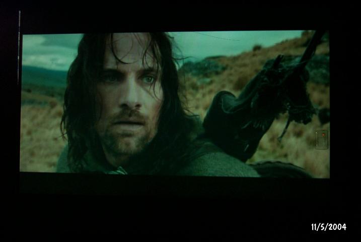

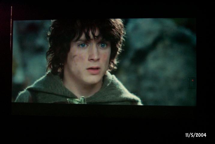

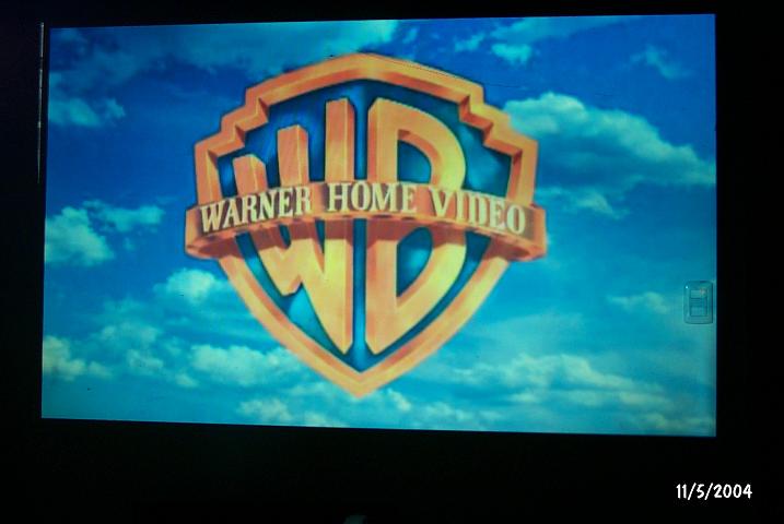

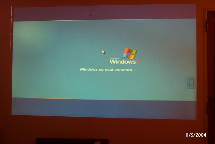

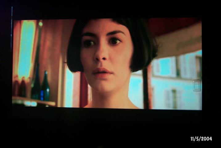

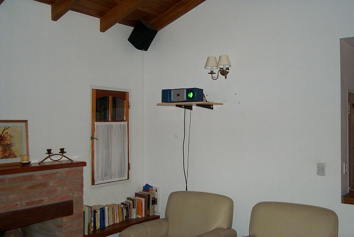

By the way, I´ve taken out the 2 glass pieces on the LCD box and the colors and brightnes get improved a lot. I´m watching for temp and at the moment it works very well.
So, the blues now seems to be much better but still a little greenish on sky images. I´ve seen this effect on some outdoor photograps when the camera doesnt have a UV filter. May be the lamp is puting too much UV light thru the panel.
The 2 glasses where in the original setup to form a tunnel for air convecting and aisle the light box from the panel, but it seems is not really necesary. The fresnels gets just a little warm. May be I´ll keep just one glass but with some UV filtering property.
I note that the Fresnels gets colder than the LCD so the heat is carried by the light itself and is more infuyent than the irradiated heat from the bulb. So I think it´s is more important a Fan in the LCD side than in the fresnel side (I hope it make sense - sorry about my english). I´ll try to add an small 1" fan in the LCD side. At the moment it seems not to be necesary but just in case...
I´ve taken some new pics of the proyector mounted in place and some images on the proyection screen. I´ll post some ASAP.
Bernardo.
