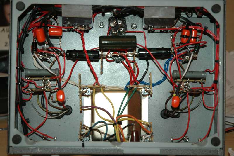

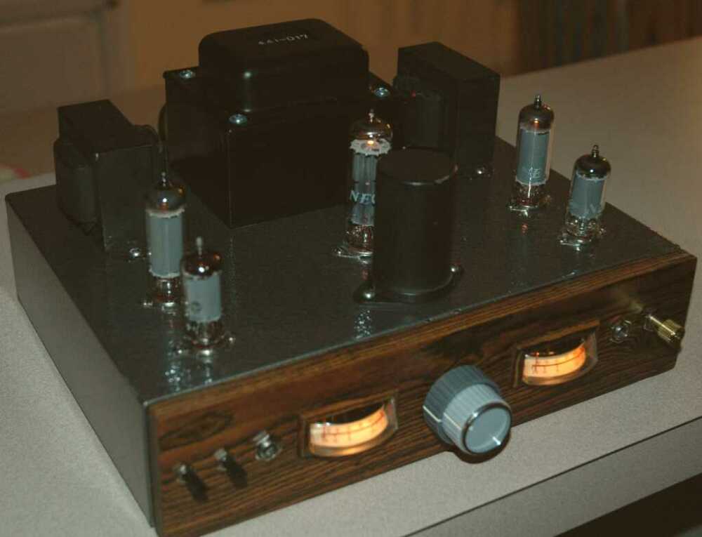

Ciscokid said:Very nice! I still have my meters. How do/did you plan on hooking them into the circuit? Any shots of the underside?
Danny
Here's one with the tubes and panel lit up and one of the underside. Not completely wired, but got the filaments and pilot lights and most of the wiring from the secondaries of the output transformers to the terminals.
Ohhh.. All that room 🙂
Also, I noticed that you are using the original POT. I did the same thing at first but found the unit to be defective. I tried cleaning and that helped some but the sound would degrade after a little bit of use so I replaced with a 100k from my parts box and sound really opened up.
ck
