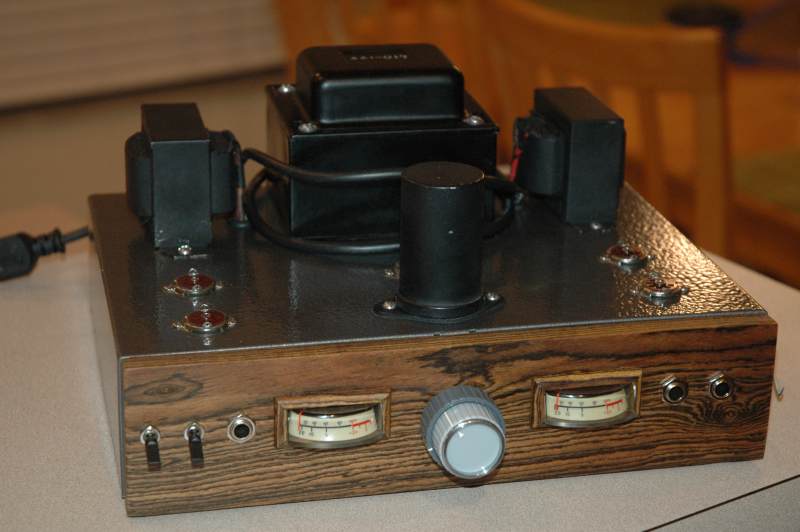

Hey Andy, Thanks for the complement! Here is a link to some early construction photos! I really need to bring the amp home and shoot a few more completed (relative 🙂 ) pictures.
My 6AQ5 amp.
Hope this helps!
My 6AQ5 amp.
Hope this helps!
dg
You got a schematic for that amp?
My site lists two circuits (click on the amp), one using Hashimoto iron and the other circuit from an old RadioTronics article. I believe I followed the older article and omited the tone control and NFB circuit. Not 100%, I would have to open it up and see exactly what I did.. However, I must say this is a very sweet sounding amp I use in the office.
Kind regards,
Danny
My Site

Very nice! I still have my meters. How do/did you plan on hooking them into the circuit? Any shots of the underside?
Danny
Danny
It isn't wired yet, but I'm using the output trannies from the recorder. I plan to wire them to the 600 ohm outputs with 10K pots as voltage dividers and a 100K pot in series just like it was in the recorder schematic.
Cool! I am using the 8 ohm for speakers and had thought about using the 600 ohm connections for driving a sub but have not hooked it up as of yet. Keep us posted of your progress..
