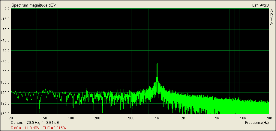

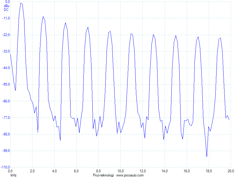

here is from my recent amp. Yours loks like dirty setup and noise issues

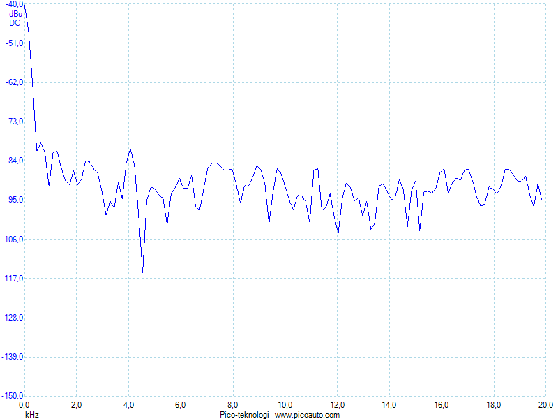

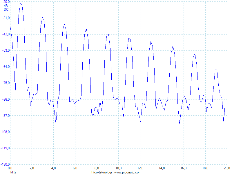

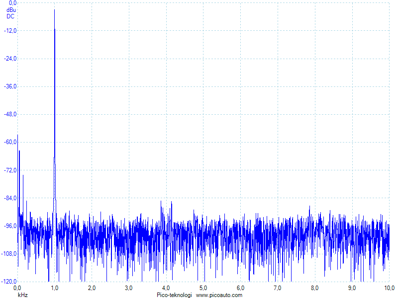

Why the first pdf has no harmonic noise and the other two a lot? Is it exactly the same circuit measured or it combines an amp?

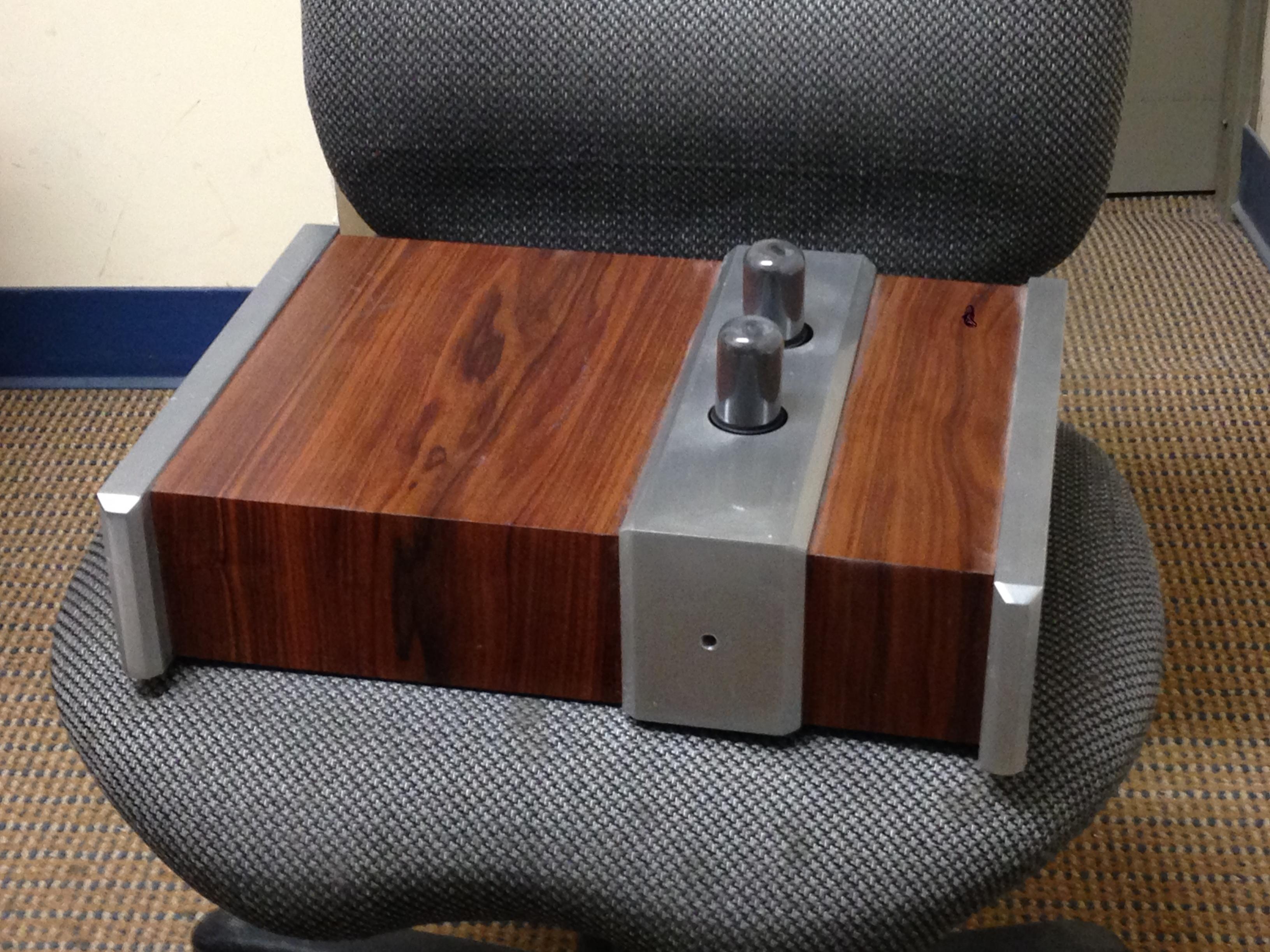

Why not, its a test bed, looks come last. Did you manage to listen to it or put it through scopings and the HP analyzer?
It performs flawlessy and i tried a few different setups like CCS but went back to resistor load.
The basic and simplicity is the beaty of it.
Basic current regulated heaters starved untill i got best performance.
Early SSHV board forced to become a later version.
I really like it.
Performs very well with non exotic parts.
A descent chassi is on the list of things......the endless list of....

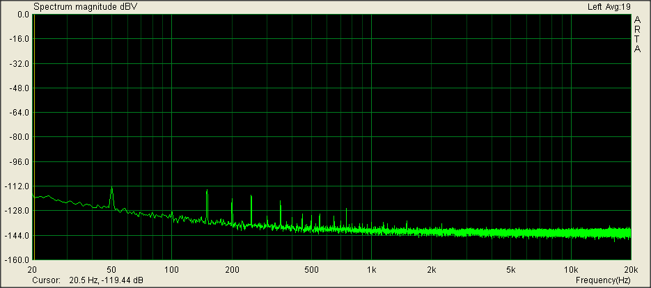

First pic is loopback showing baseline at output level to measure 1W performance of amp. I have some 60hz niose, but it was do to crappy test rig.
As for 6V6, RCA blackplates is my choice as well. New Tungsol was very good( have matched quad for diff version), but Military grade RCA was worth money and this amp is worth the upgrade.
