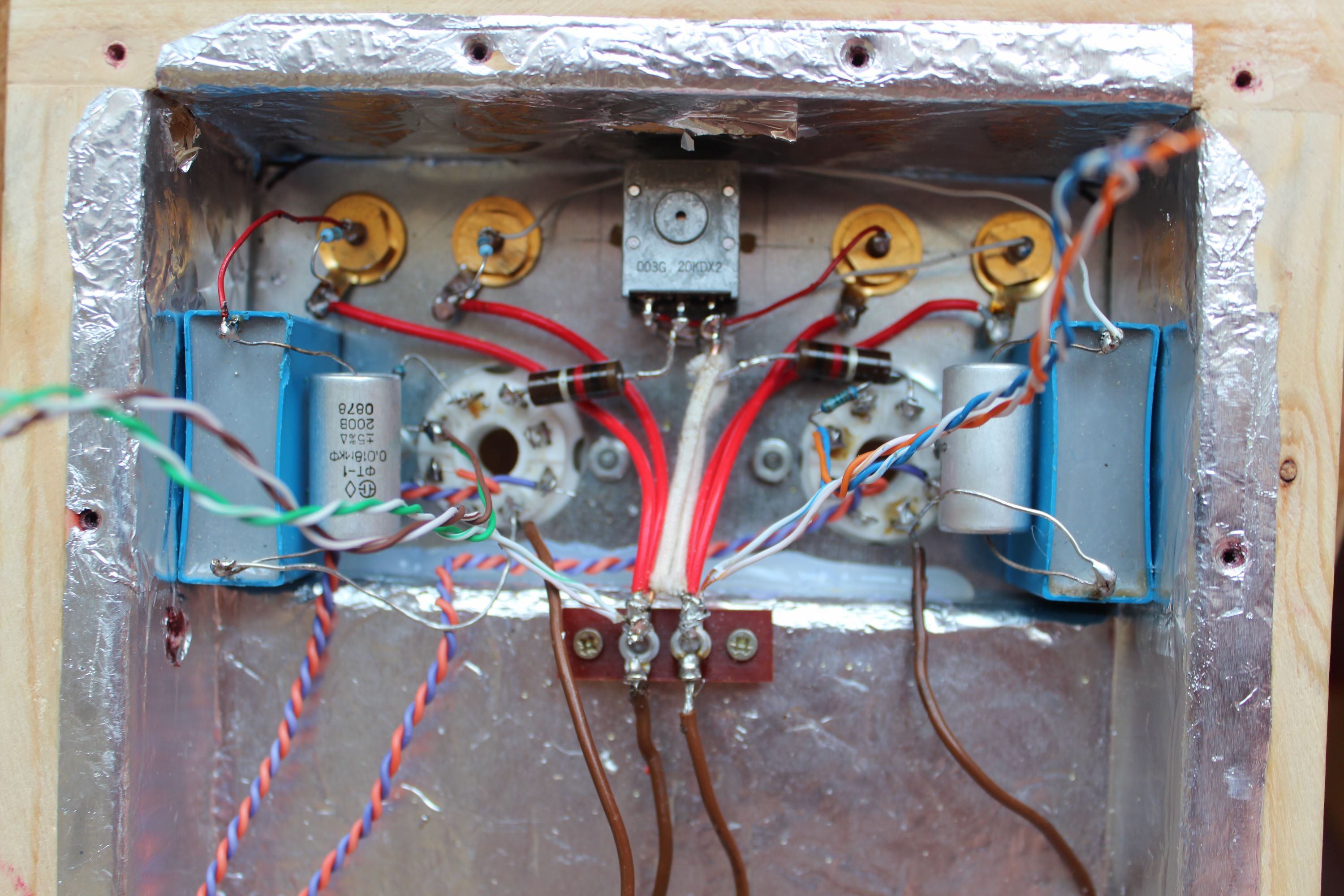

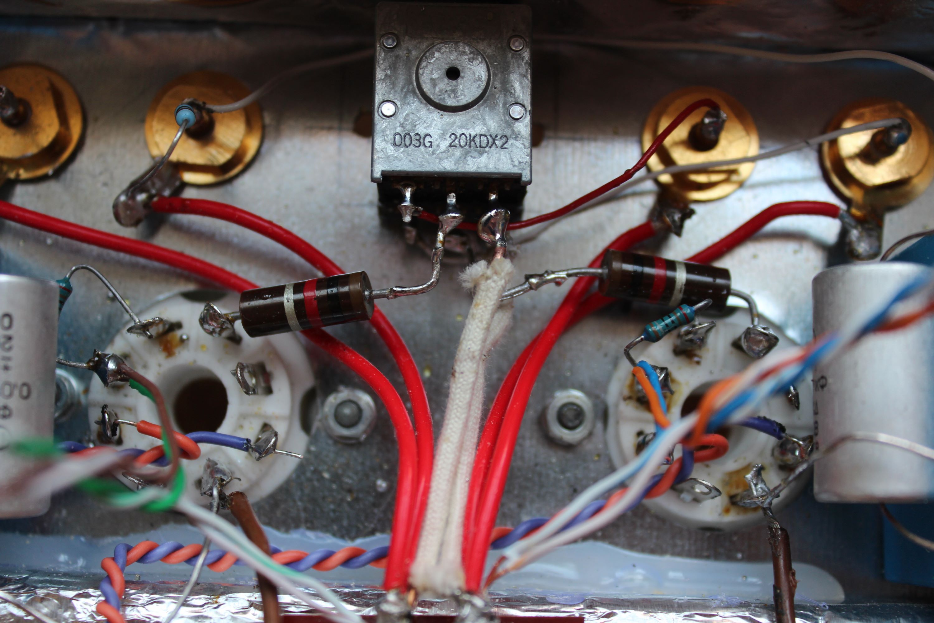

I grounded them from CSS zero to signal star ground. I found something else that is odd now. Right channel has a quite edgyer hum then left. In the right one I can also hear the wiper when moving. When I tap on the tubes I can only hear the tapping in the left speaker, mostly then I tap the left tube, but also when I tap the right tube (going through chassie probably). Needs som investigation of the audio circuit grounding, rca mounts etc. That one has been pretty much the same with all different PSUs and filament feedings.
They should ground to power return star or common. From there with one cable the power gnd should meet the chassis where the signal ground star meets it also.
- RCAs must be isolated from (any sort of ) chassis ; their GND must go to cathode GND return ...... usually main GND point
-1M from grid to gnd is must ; pot ( any sort of it ) is lousy grounder
-cathode GND return must be separate from grid GND return path ( meaning - separate wires to main GND point)
-local PSU decoupling must be as close to anode as possible ; if using shunt reg , reg itself must be close too - shunt regs don't like long wires , be it of high or low gain/feedback sort ( having error amp or no )
I must correct myself. Filament zeros was connected to PSU star. The audio star(s), one per channel is what you see on those pictures. Those connects at the PSU star wich is by the filter caps. That star then connects (or not connects, I have it so I can take it away since poweramp has a connection between audiozero and earthground) to chassie.

They are- RCAs must be isolated from (any sort of ) chassis
They are
- ...... usually main GND point
Depends how you define main. I have one audio cirguit gnd points (on pics), thats because they are after SSHVs. Those connects separately to PSU star.
I'll put one--1M from grid to gnd is must ; pot ( any sort of it ) is lousy grounder
Grid leak is now tru pot so they are separate from Cathode gnd--cathode GND return must be separate from grid GND return path ( meaning - separate wires to main GND point)
--local PSU decoupling must be as close to anode as possible
Its hard when using SSHVs

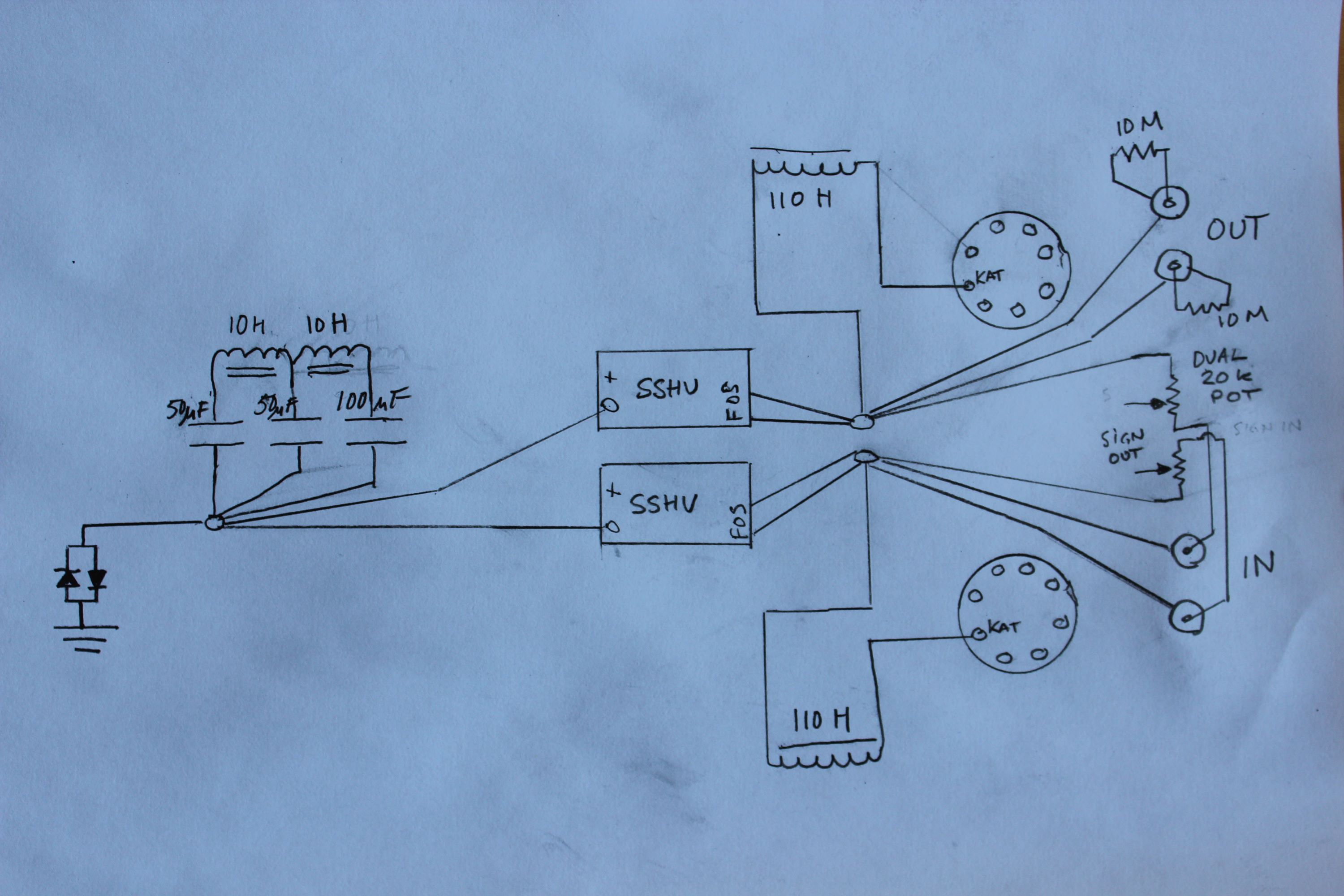

I'll contemplate and try to understand you, and ask questions when I have done. Heres a drawing I did on the grounding circuitry. It leaves out the gridleak which I will mount and aso the filament referencing, which Im contemplating where to connect. Comments on that?
dunno for SSHV ground in/out topology ( Salas is da man for that ) but it seems to me that you must have separate diode blocks to chassis on both GND points on right side , deleting that existing one
you can't make half dual mono gadget , then make gnd loop with (usually) source having same gnd on both outputs ; that's same as little pregnant
if SSHV is having GND traces organization in perfect way , you are not having difference in potential between in and out GND and you can make it as shown
if case is different , each SSHV must have separate rectifier and filter
