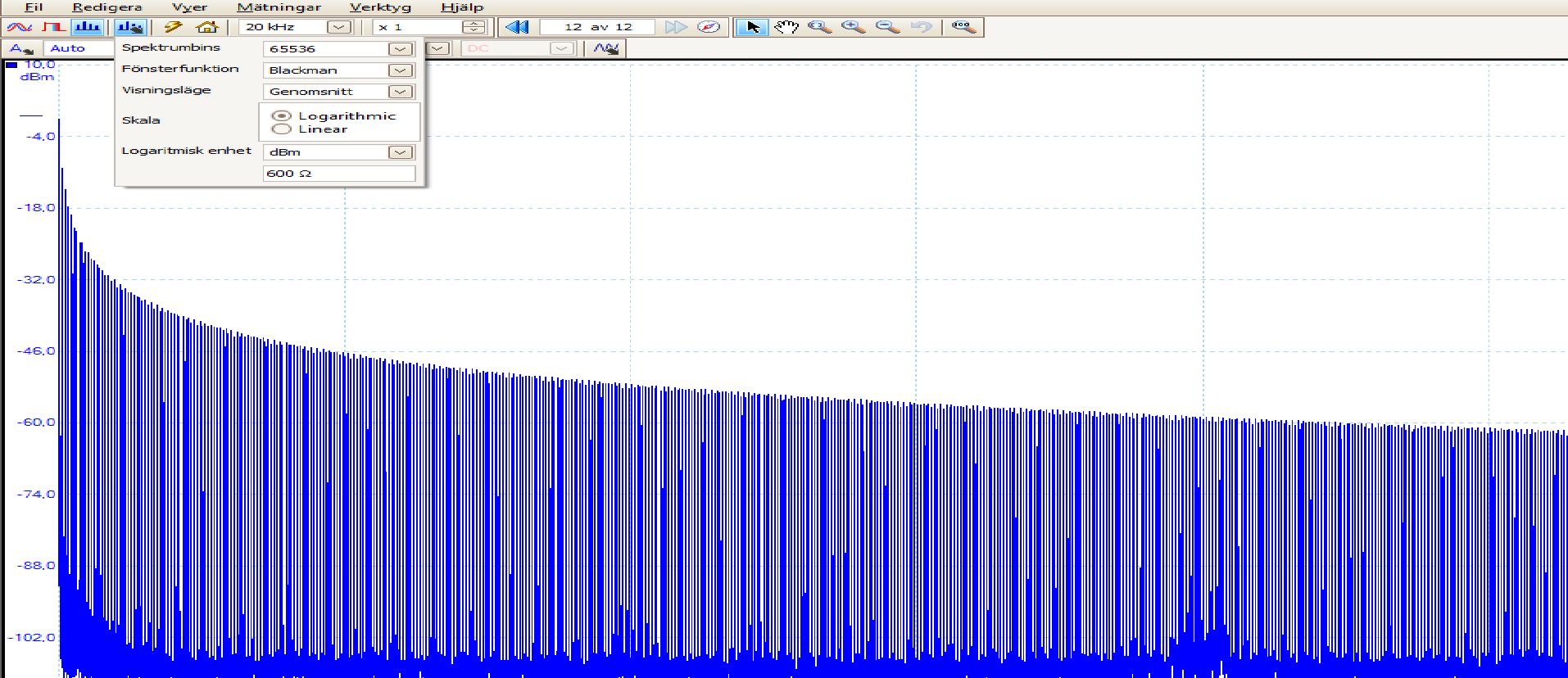

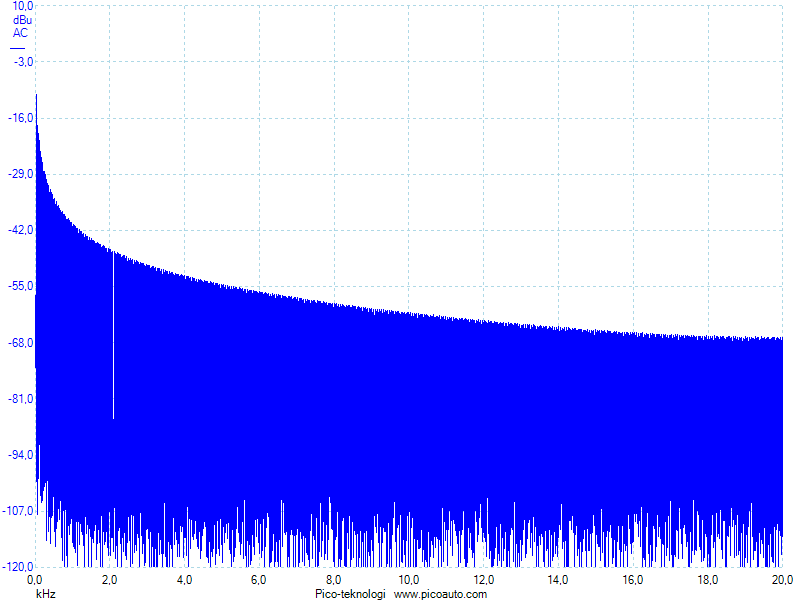

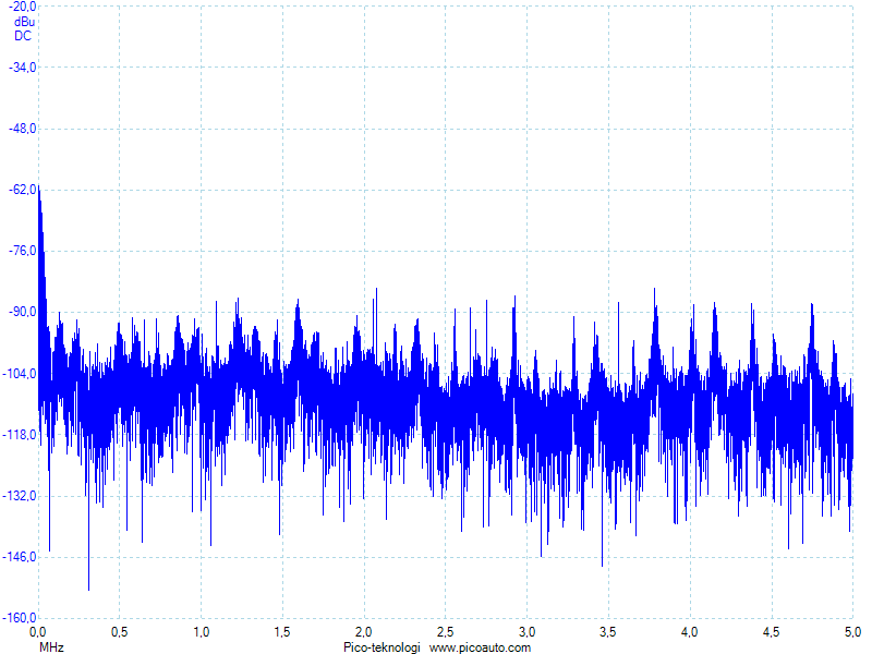

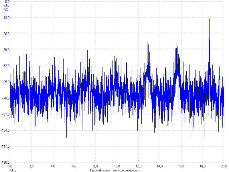

So excuse me fot the dumb question but I have to ask: What are we looking for and how does it show?
One thing about me: im unreachable if only telling me what to do, you have to tell me why, otherwise my cognition doesnt work.
We are looking for a clean high signal line and low harmonics on a low enough noise floor. Something in the general looks of the attachment. That one comes from a KT88 power amp I did in the past. You can see the 50Hz hum level, the harmonics of 1kHz, the interference, the general noise level.
