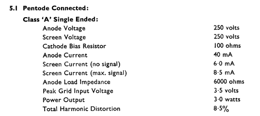

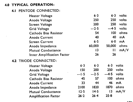

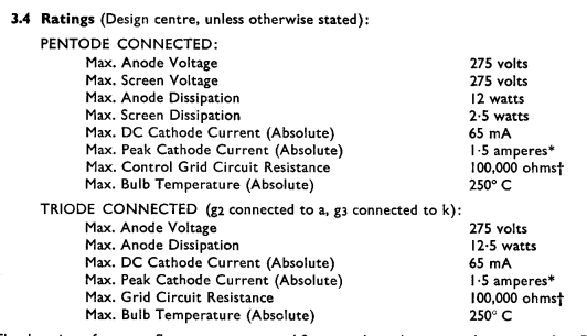

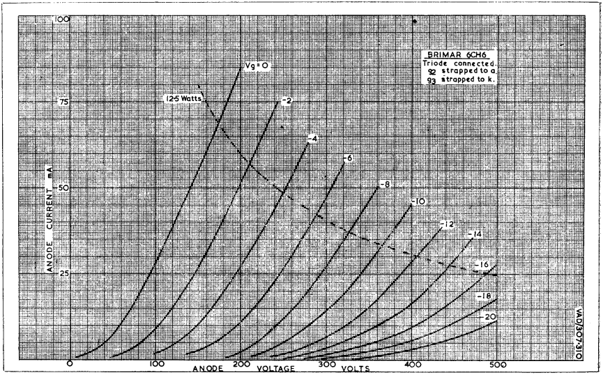

Hi, the point of 2.2uF is it can cover minimum phase turn coupling down to 10k-20k Zin amps. Which the CF and G3X versions can drive even better. They have 250Ω and 1kΩ Zout respectively. Of course lower (thus cheaper also) Cout values can do the job when for high Z input power amps. I originally used 0.68uF for example. In general I favor a -3dB high pass coupling point of 5Hz or less for minimum phase turn up to 100Hz.
A (cheap) tube like the 6CH6 might be better in this application with step-down transformer coupling. -3dB @5Hz should be easy with a LL1660 ALT Q gapped for 8 mA. Should be able to drive anything without CF's and without capacitors....
