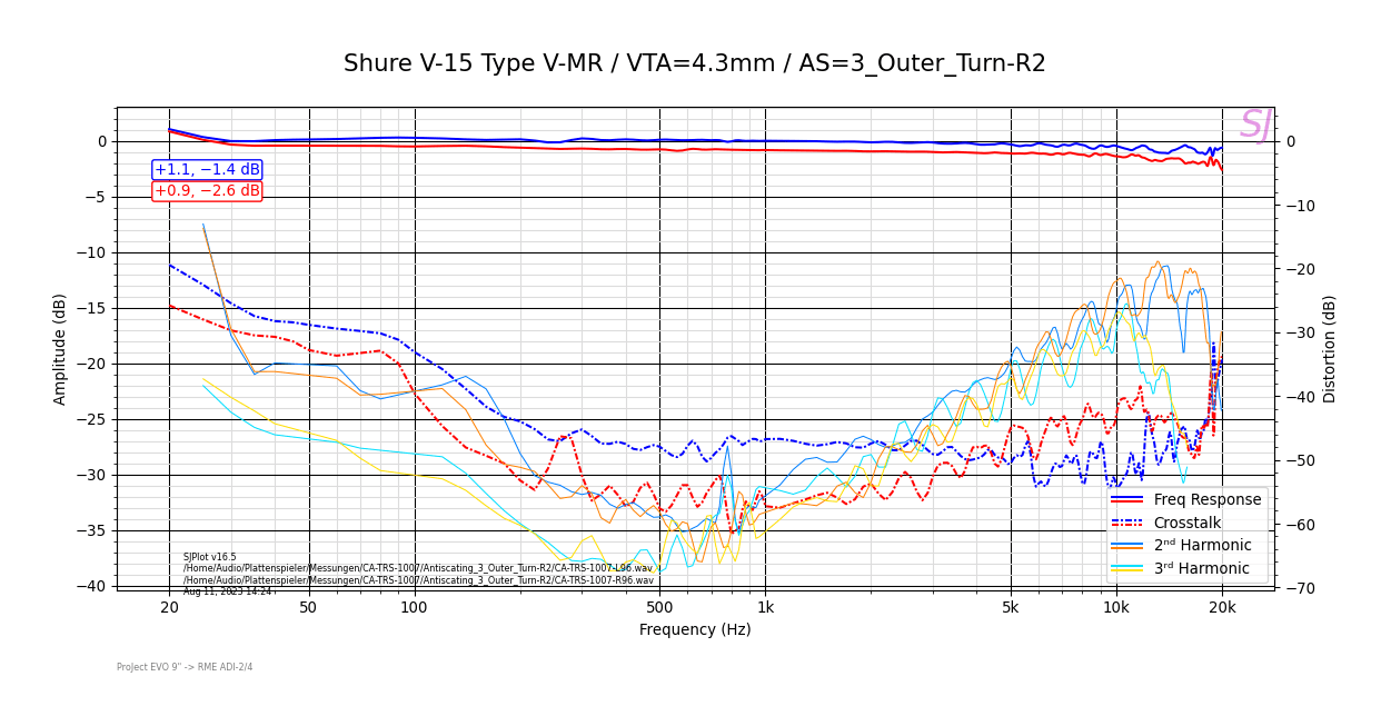

Lp playback systems sound Do very good.
But sometimes the measurement results would make you wonder how.
Here is one measurement setup example of the channel separation and 2nd and 3rd harmonic distortion of a Shure V15 V phono cartridge.
Your favorite phono cartridge, and your best Test LP . . . may give similar or different results.

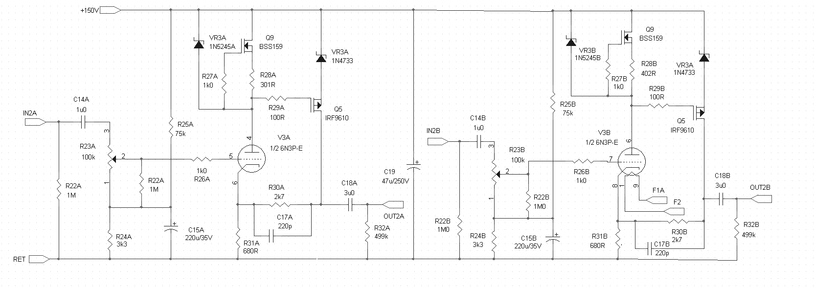

i did a 5X hybrid line amp using the 6N3P-EV - it measures well, though it depends on dreaded feedback to get its message across.
The circuit is shown below:

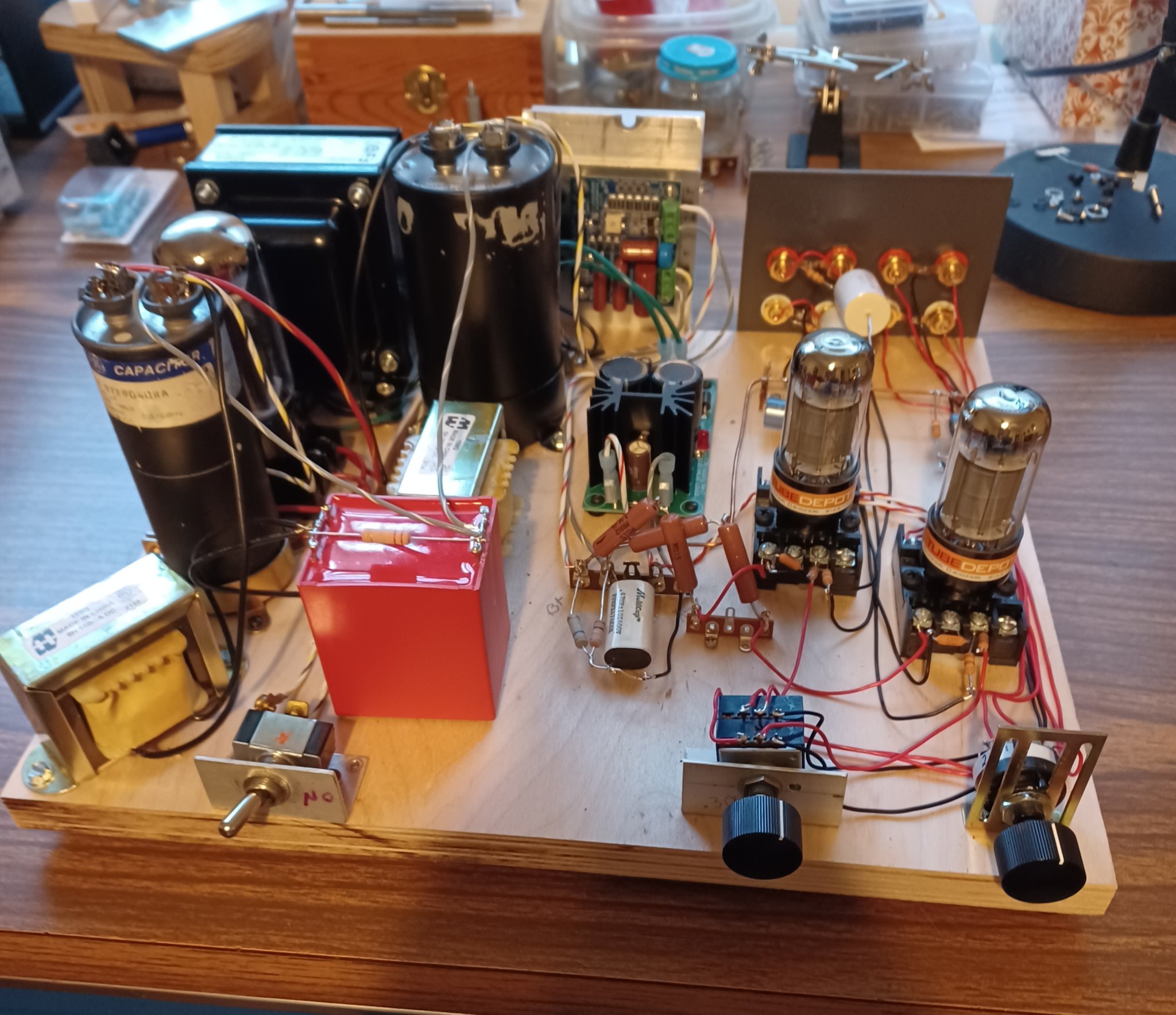

I put this together last week and am very impressed.
Thanks to Salas and all who have contributed .
Yes, read the entire thread...
I will definitely tidy it up in a proper chassis.
Can you tell us a few words about its power supplies configuration and some info about the audio system this 6V6 preamp plays in?
Elevated DC heaters and a Maida regulator for the B+
The power supply is a 5U4GB, clclc to the regulator, maybe over kill on filtering but is darn sure quiet.
Driving 2a3 amps, I have diy SE and PP amps, Lenco TT diy tone arms, Hagerman Cornet hybrid, pi streamer via diy dac.
Speakers are WE clones, bass with 12" Jensen field coils, Horns are from Lycan R&R with Altec cd.

Wow, that is interesting! Would you mind explaining the circuit a little for those of us who fail to comprehend it?i did a 5X hybrid line amp using the 6N3P-EV - it measures well, though it depends on dreaded feedback to get its message across.
I see V3 has a CCS on top (Q9).
But I'm not sure what Q5 is doing. Is that driving NFB to V3's cathode through R30?
What are R25 and C15 doing?
I guess R24 (bypassed by C15) lifts the volume control and V3 grid above ground. For what purpose?
I don't think I've seen anything quite like that before, and it's really interesting. Thanks.
Positive bias is applied to the input to help center the output voltage at around 30-50V to avoid clipping. The current source at the plate of the triode forces a constant current through the triode, so that any drive at the triode grid forces the p-channel mosfet to conduct and provide direct feedback via the triode cathode.
I've used this basic gain cell with both solid state and vacuum state devices - simulated THD (with solid state, I haven't gotten around to doing modelling for vacuum state devices yet) is very low(<0.001%) for such a simple circuit.
Nothing wrong with a little, properly implemented, feedback. Simple, elegant circuit!i did a 5X hybrid line amp using the 6N3P-EV - it measures well, though it depends on dreaded feedback to get its message across.
