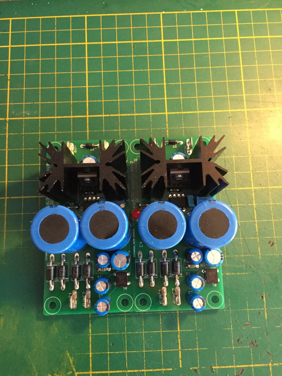

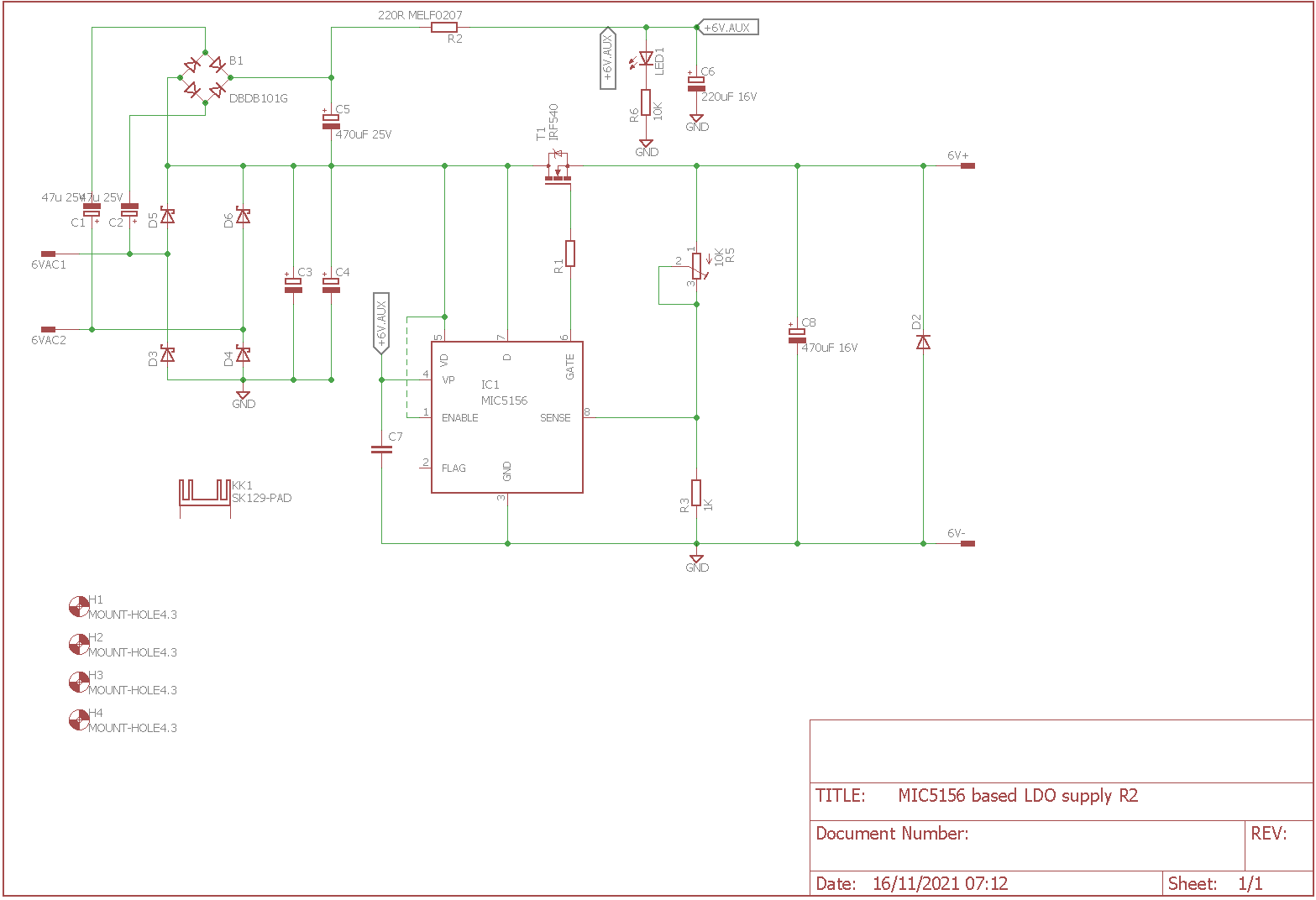

i think its my board MIC5156 based, 6.3VAC to 6.3VDCWhat you use for stabilizing DC on the 6V6 filaments? I saw a small board with a sink. Some low dropout MIC reg chip I would think.

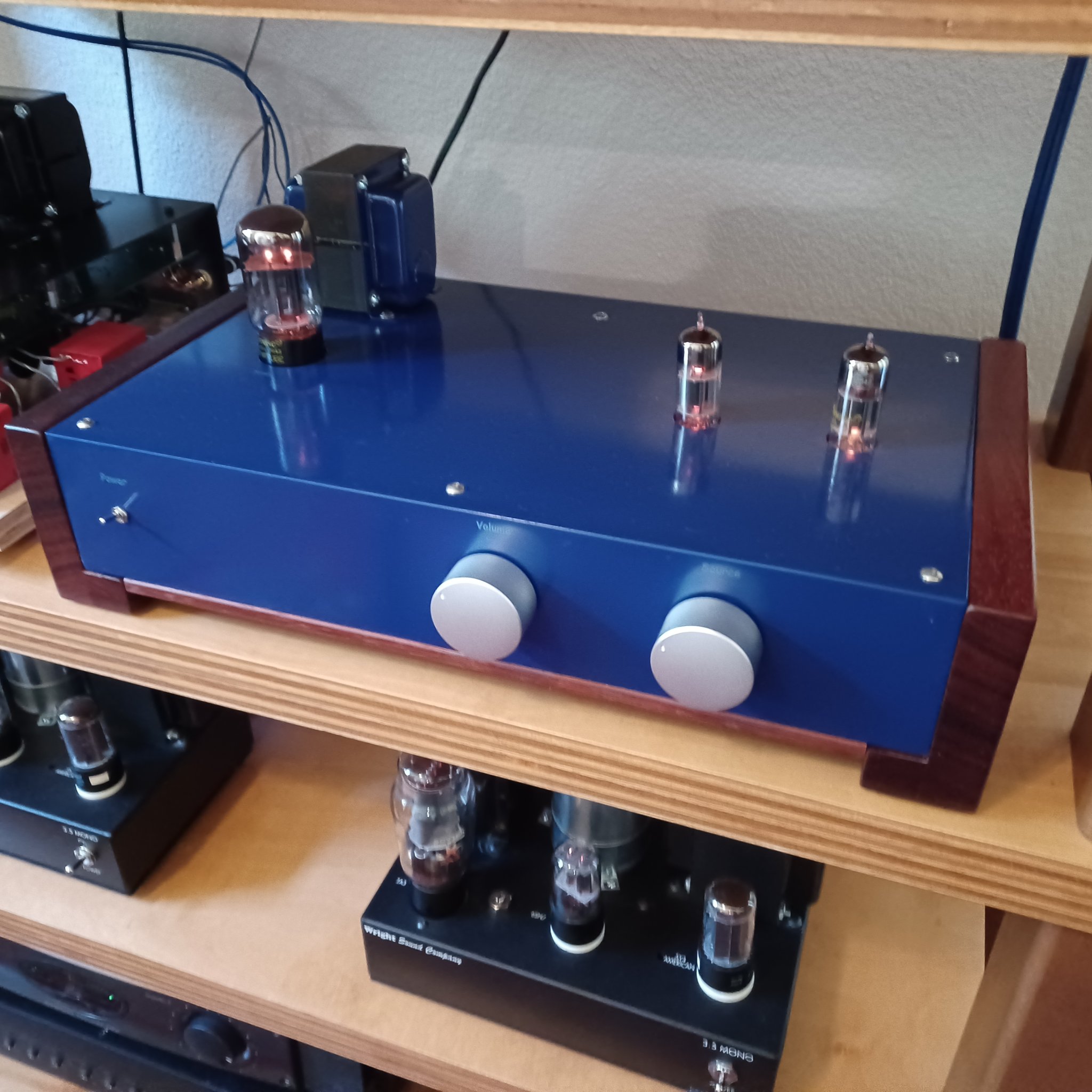

Thank youThis is a cool all-DIY system with real scale speakers. Lots of careful work. Some essential room treatment there too. Congrats.
Did you get the chance to evaluate your G3X version 6V6 pre synergises in this system against some previous circuit you used?
The DC heaters are boards from this thread
https://www.diyaudio.com/community/...pplies-mic5156-based-tube-amp-upgrade.382265/
I have a 12b4a preamp based on Eli's schematic in that thread, but it uses Al's gyrator.
They are both very good sounding and quite similar.
The 6v6 is a simpler build to get quite. I went through a few sets of 12b4a to get a quiet pair.
Nice DIY chassis. I like the color scheme. 12B4A with gyrator is no slouch. Bold and clear. Must be careful avoiding noises indeed due to its high gm. My old experiments and findings posts with the 12B4 and a gyrator I designed for it.Thank you
