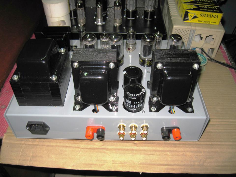

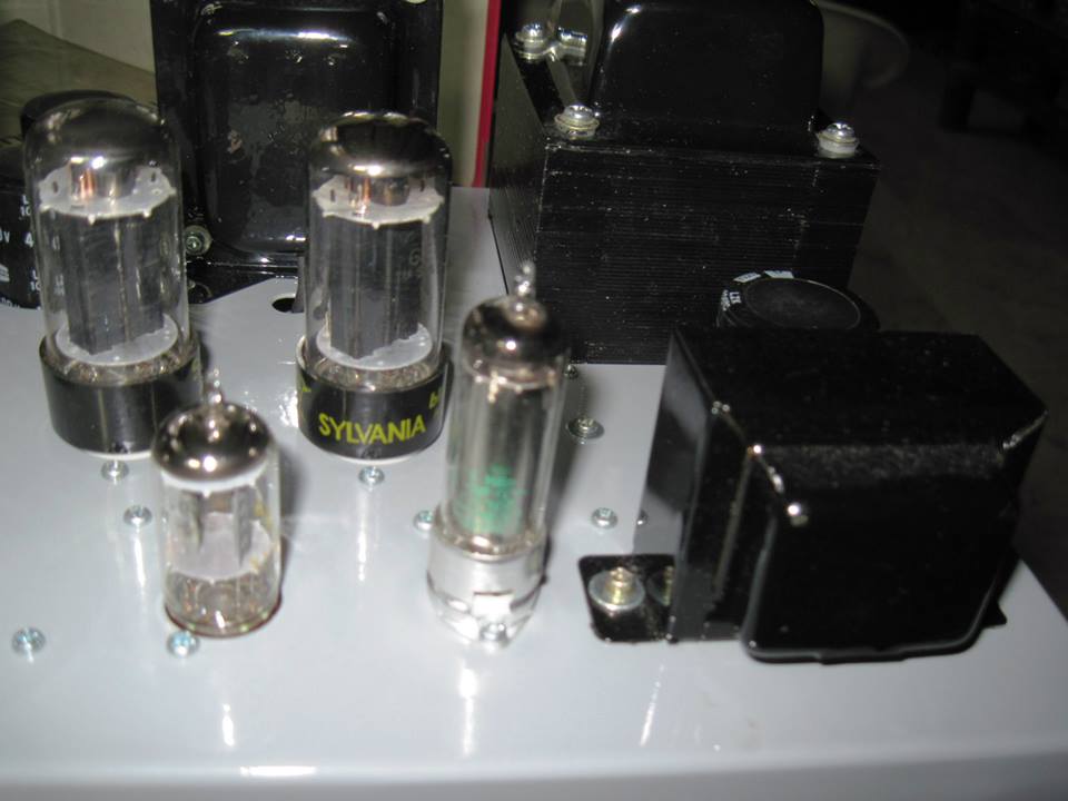

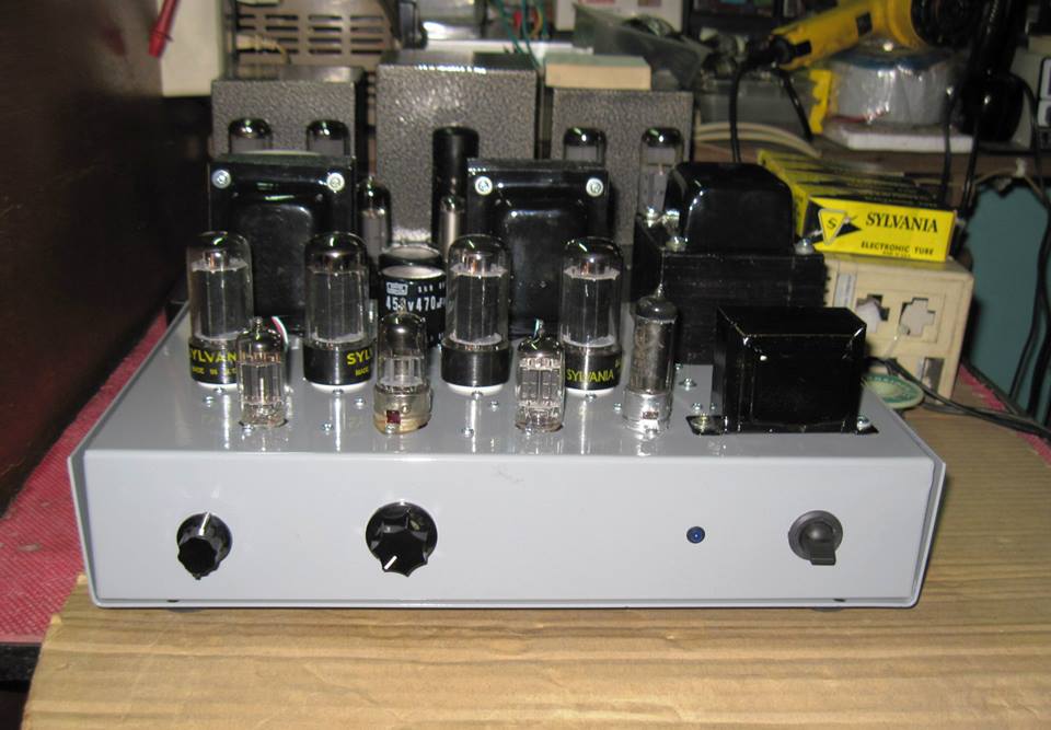

i bought a lot of them for $1 each, 12en6, along with the 12w6 beamers...i assumed that there could have been a 6 volt version... https://tubedata.wernull.com/sheets/127/1/12EN6.pdf
do not let its plate dissipation ratings bother you...i made a pp amp out of pairs of these many many years ago...
how did it sound? a lot better than a 6v6 to my ears...
