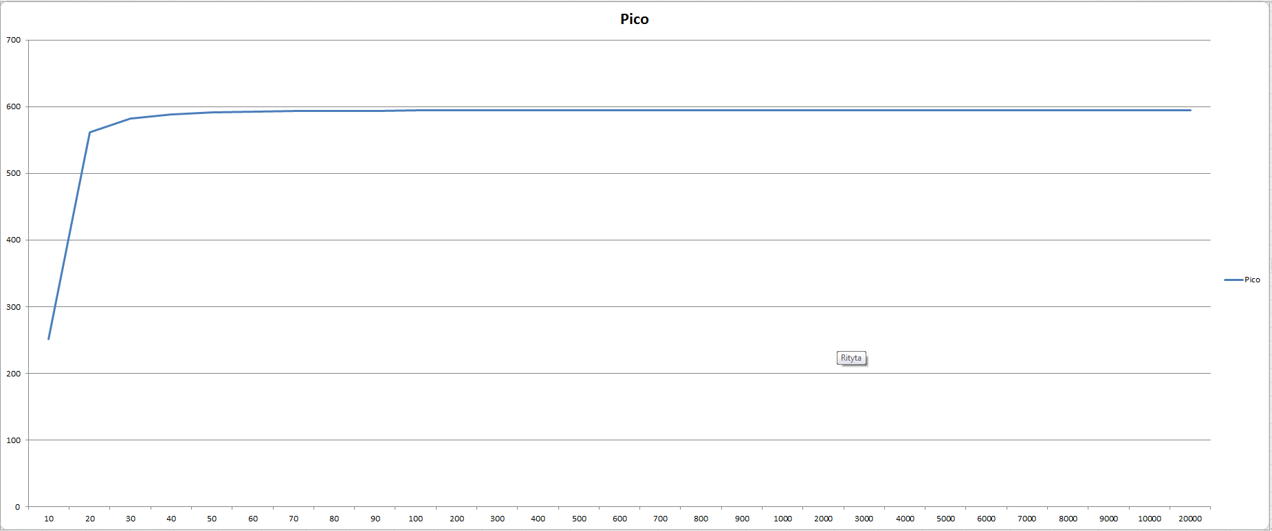

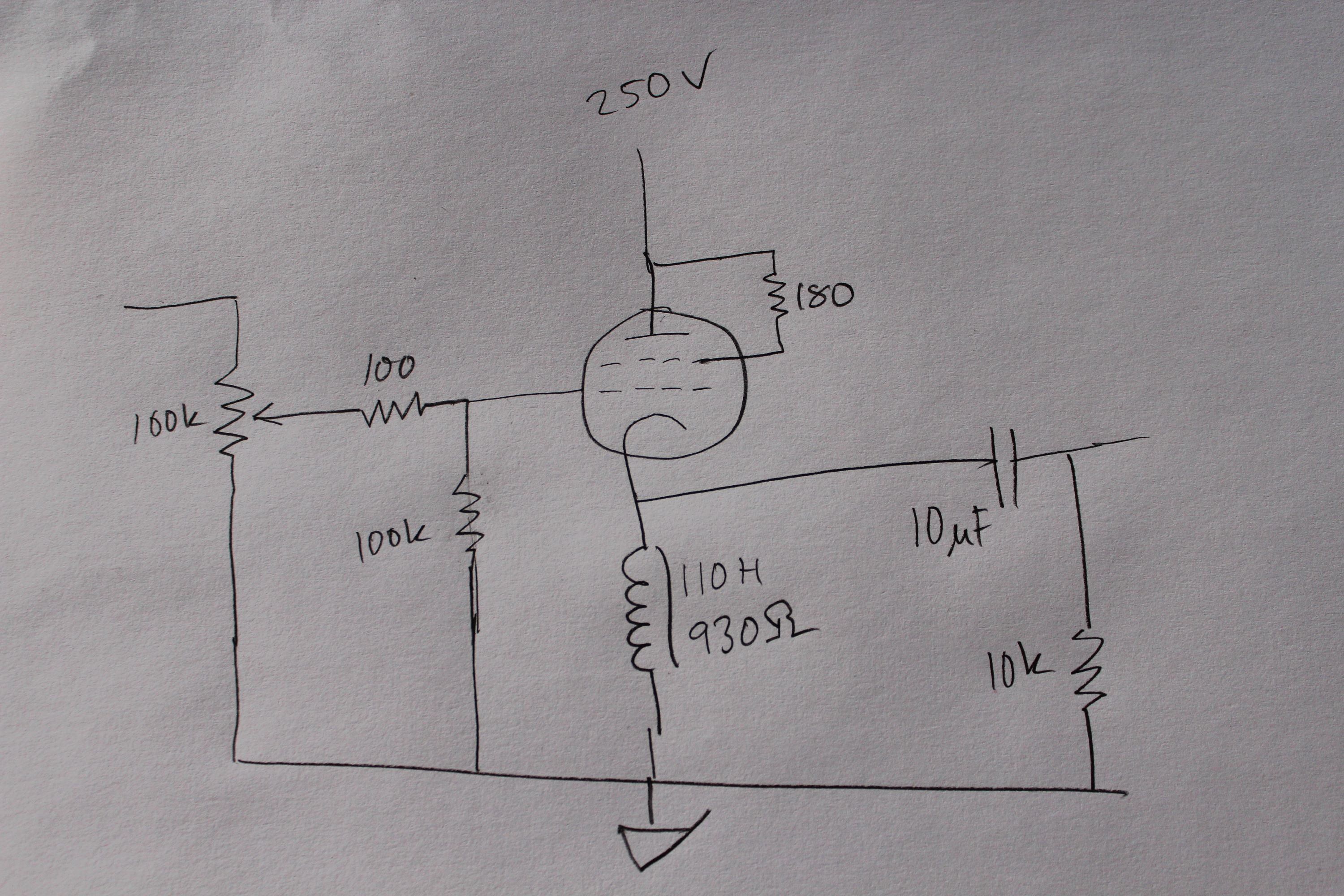

Pot max volume = zero resistance in series to the grid so the BW should be at its max. When pot is at low listening volume the BW should shrink. But never a slope in audio bandwidth across the full rotation.
Btw I have a 100 k gridleak also, I should post a schematic maybe.
You should not get any attenuation in the audio band. That cathode follower thing has way too wide bandwidth on any setting if working normally. See if you need some gate stopping when the pot is at max and presents no additional series damping. Check your measurements again. Showing 1.5MHZ at one position and then a dip in the audio range at another does not compute. Or its some trouble happening. Set your ref pk-pk at 6 divisions. When falling to 4 divisions its roughly -3dB. That will help you sweep fast the gen knob and spot the BW limit fast in all vol pot positions.

P.S. If you end up adding gridstopper value, move it after the grid to ground resistor so not to create a significant signal divider. See what your pot value does divide with the input value too.

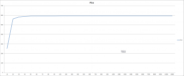

Something is fishy. I added 100k on the output that already had 10k which ends me up to 9k9 and I have a straight line. What am I doing?
New graph 100 k load pot on max
That is with the internal Pico gen I guess. OK, I see no problem.

Yes your right I should contemplate and remeasure but now all systems are go right? Or should I get other measures?
Suggest me a good output leak/load.

You should get no other measures than a logically high output resistor (much higher than the amps you gonna drive) if your measurements are confirming OK response and squares after revisiting the procedures in good control. Check that your vintage Wavetek has no intermittent buttons or pots that may drop its Vout suddenly at times. When you see weird dip, measure the gen output with your UNI-T DMM that I saw a glimpse of in your photo. If its the 61E I just measured its reliable for AC RMS up to 100kHZ for one digit after the decimal dot at 2V.

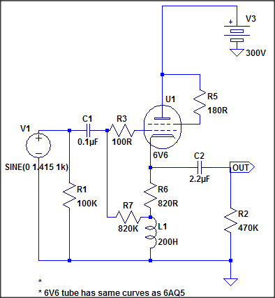

One thing I will need to feed soon is this http://www.diyaudio.com/forums/pass-labs/169323-semisouth-donuts-8.html#post3440081. I am waiting for parts. My first sandbuild maybe.
I could move up the chokes to the anodes maybe.
