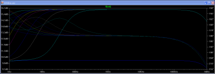

P.S. See what happens to freq. resp. and phase for 0uF 1uF 10uF 47uF 100uF 220uF 330uF 470uF 1000uF Ck values. 1000uF is light blue to graph's left and the rest are as we go down lower the values list moving to graph's right. 10dB bottom blue line is no Ck.

If you will have no cap across Rk you are introducing full band cathode degeneration, i.e. local feedback. With a small film you introduce it just in low freq.
So do you mean that a small film in parallel with the 1000uf is bad or does something different? I didn't mean to say that I was only going to use the small cap with no electrolytic.
So normalize the SPL on pink noise with a slowly integrating meter like the Radioshack one if you are to compare with an electrolytic there, without is gonna be less gain and different THD.
Ok, you lost me. 😕
Ok, I understand what the different values do now in this circuit. It also looks that 470uf will be 'close enough' to the 1000uf that it will get me going without it being too different. Yes?
-I don't mean its not gonna have good enough voltage, it will not dynamically maintain it is the difference to a real reg, but don't bother its just a remark on the schematic's taxonomy. if its recommended to exchange a specific R with an L by Welborne then try it and compare, why not.
-Clarifying it was about simply bypass, ignore the very small values graph lines then, still see the value progression phase lines, how it turns down low. That is nice to keep in mind when auditioning this or that brand cap when the values are adequate but not the same.
-If gain is different between any circuits or there is bass region energy extension difference we should normalize the SPL with care to they surely sound exactly as loud for proper AB comparisons is what I was talking about.
Correct.
Yes, it is not a real regulator, more of a capacitance multiplier and voltage reference. Sorta. Anyway, it should help make the PSU quiet, if all works properly... 😀 I mainly want to use it, just to use it! It's been sitting in a box for about a decade.
After looking at the (current version) schematic on the Welborne website it actually isn't substituting a choke for one of the resistors... It's showing a CL before the regulator. Which is quite easy to implement, so it will be tried.
And that is a very good point that might be missed by some people.
Ah, yes, I understand. I thought you were talking about something electrical in the bias circuit, not the overall gain due to the bypass.
